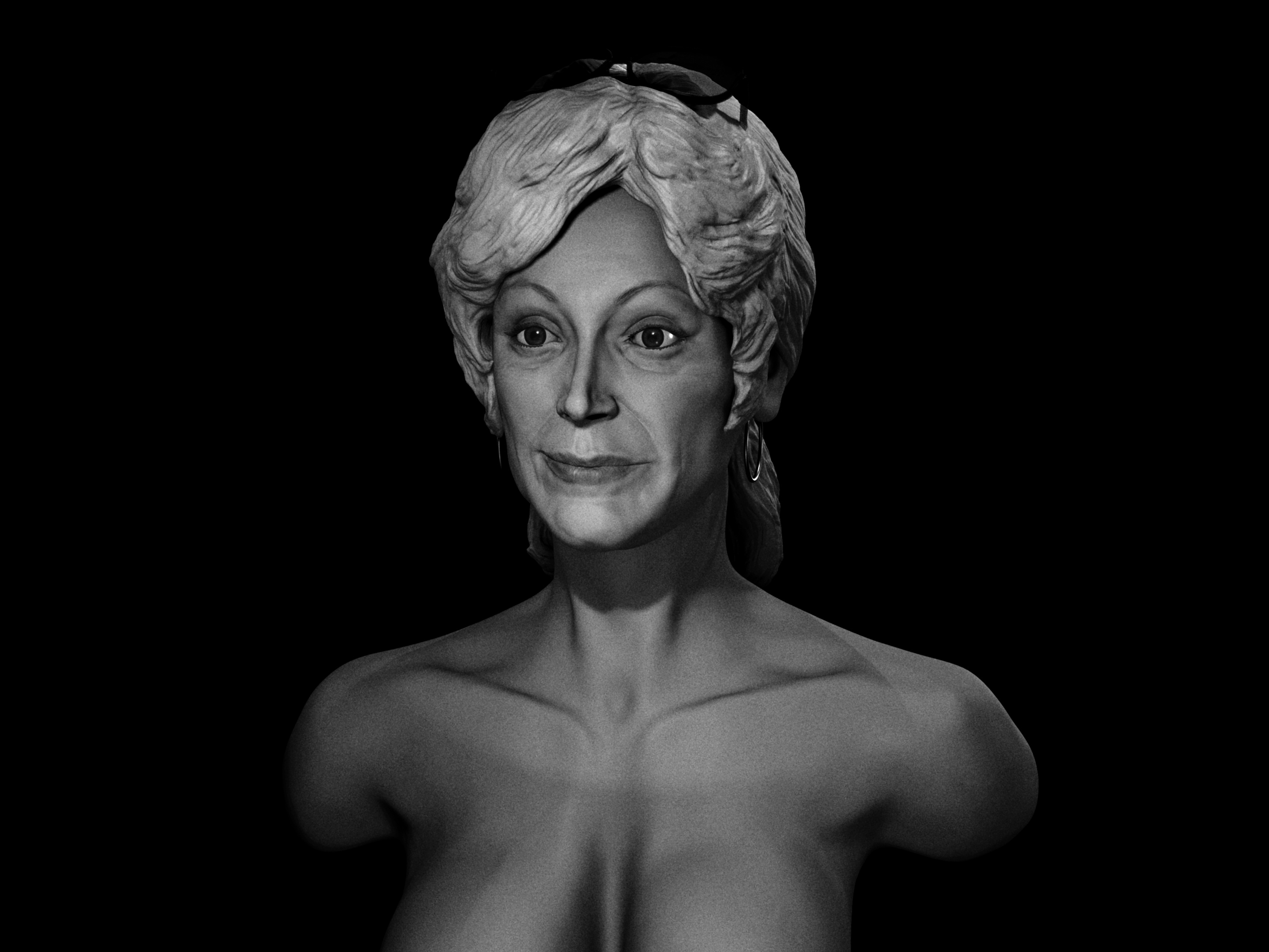

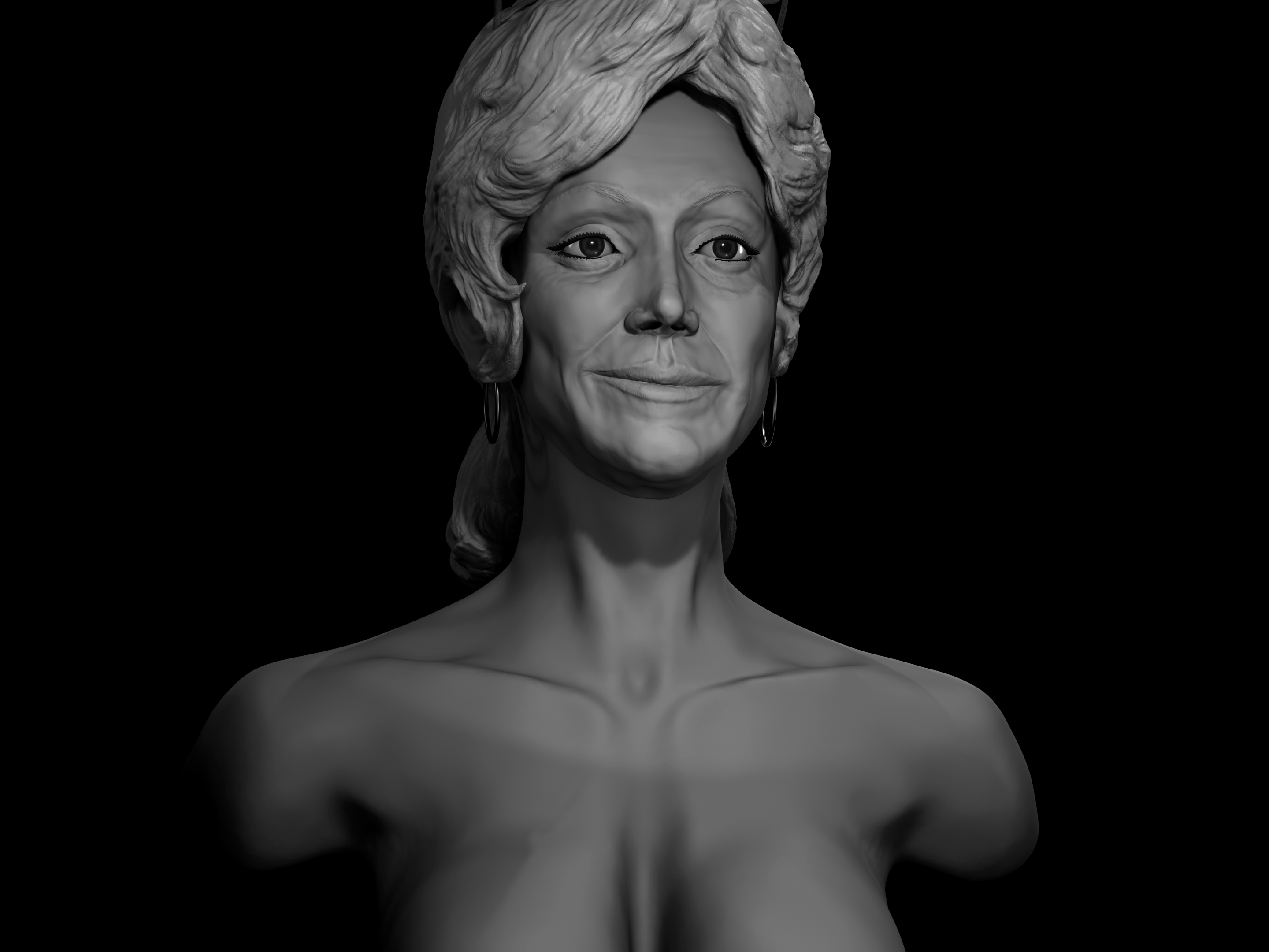

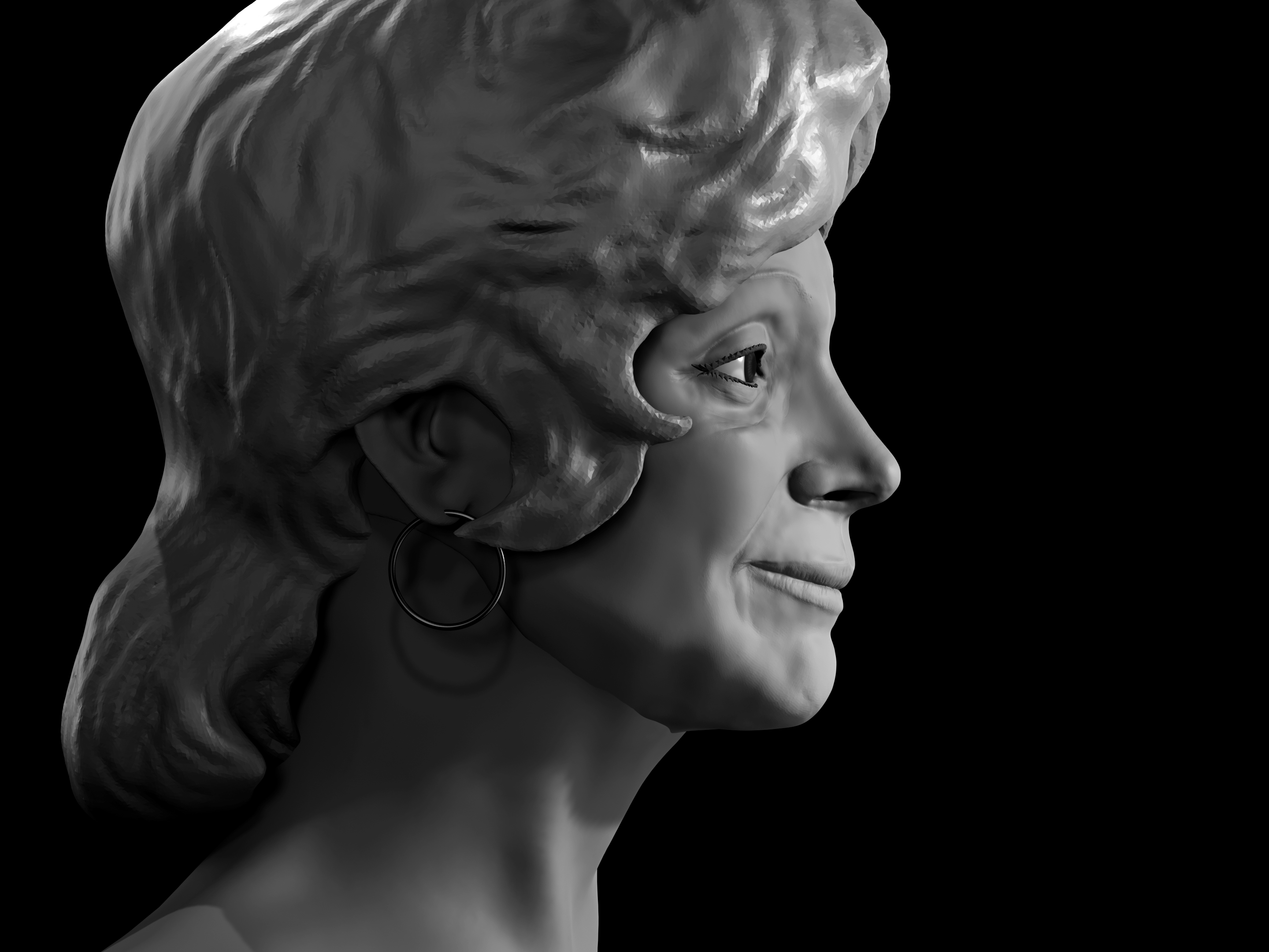

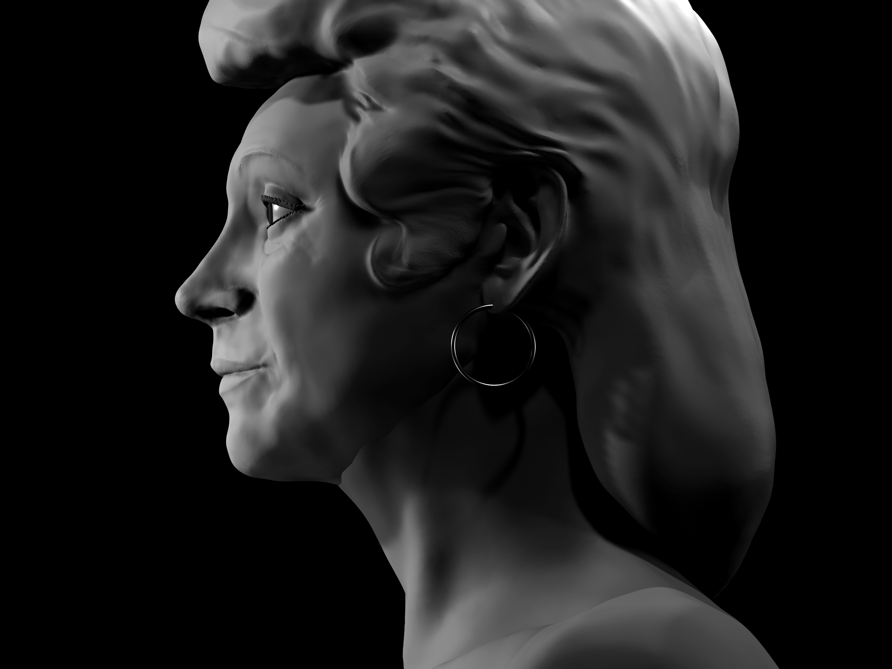

Update:
Color Edit:
I changed her nose quite a bit, mostly narrowed it, along with the overall shape of her face. I made her smile less, more subtle. I think it's improved the likeness to Lorraine Gary. I still need to make the sunglasses properly, but maybe I'm closer to a test print. I don't have any time limits on this - though I'd like to get it done sooner than later - so I want to get it as good as I can before calling it "done."
Another color edit:
EDIT: I can see that her eyes are a little off now - I think they both need to shift over towards the right (her left). I think I need to increase her jaw again, seems like it's a little to scaled-back. Hopefully, not too much work to fix it, but it'll have to wait until tomorrow.

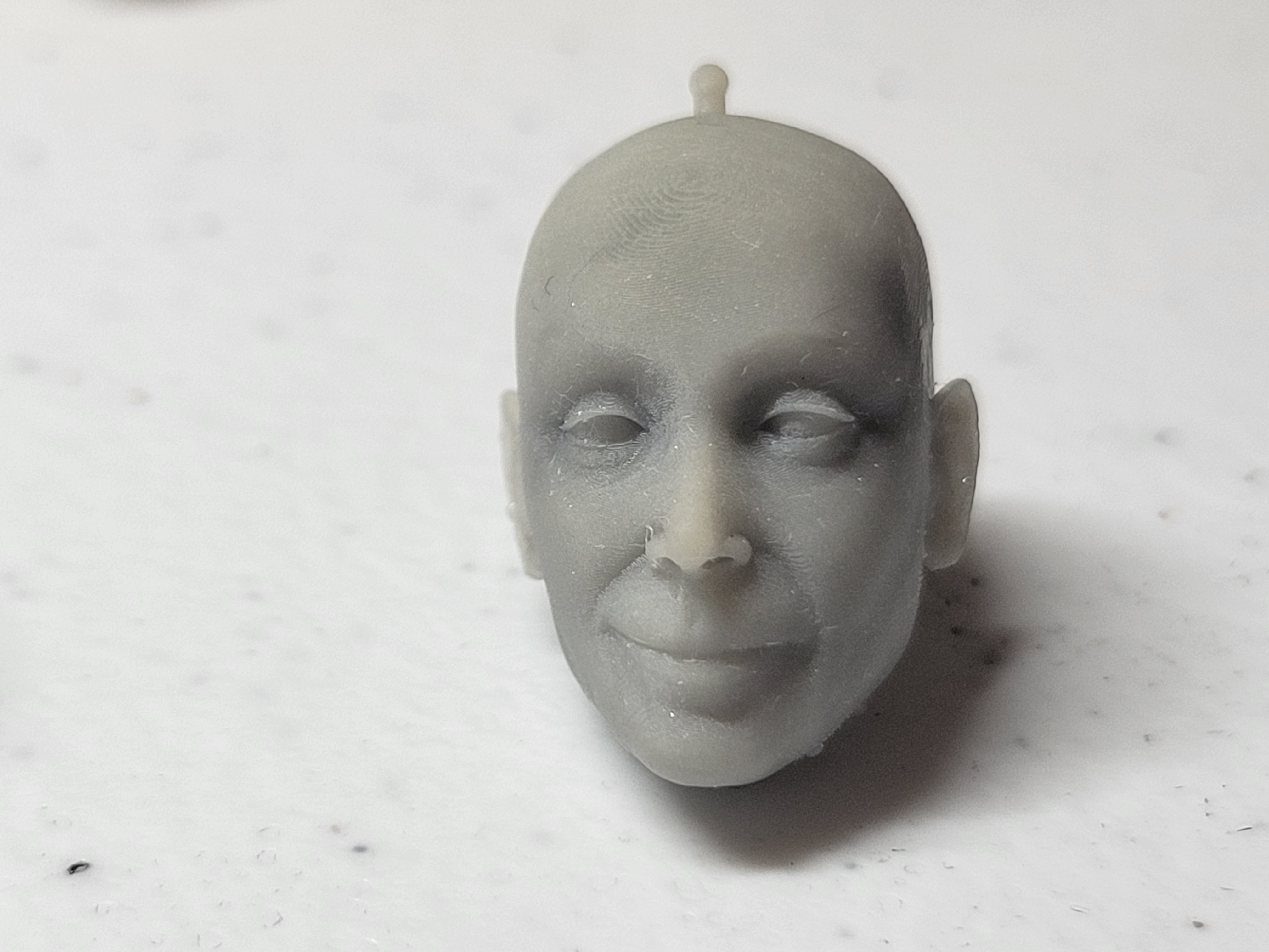

UPDATE: Test prints! I finally got some prints done, though the first set had several issues. The scale was off for some reason, and ended up being too small. Also, the separate hair didn't really work. It printed fine, but I couldn't get the head to fit inside properly (broke one of her ears trying), since the resin is too rigid. I also tried printing the earrings and sunglasses separately, but they were also too small, so they didn't work:
20250308_204344.jpg20250308_204418.jpg20250308_204912.jpg20250308_204917.jpg20250308_205004.jpg20250308_204924.jpg20250308_205010.jpg
For the next prints, I measured the Elvira head from the NECA figure I'm using for testing, and scaled up the Ellen models by 15%. I also decided to merge the hairdos and earrings to the heads, and tried prints with the sunglasses merged to her face - I already made the hairstyle with the sunglasses on top of her head into a merged object. I also printed the sunglasses separately - with and without lenses. Unfortunately, the sunglasses and earrings were still not quite thick enough. I also forgot I printed the earrings on the heads, so I was pretty rough when cleaning them off and broke them more. I already started fattening the object for the next prints.
I also made the mistake of having the heads too close to the build plate when I put them in the slicer app, so that they merged with the rafts. For all these reasons, I decided not to do much cleanup on these prints, since they need changes (the old, small print is in the lower right of the pic for comparison):
I decided to try an extra hairdo for the bandana, to make it more accurate. It still needed work too, but you can see the difference. I used some tissue to make a temporary bandana to get an idea how it would look and see what needed to be altered:
I cleaned up one head a bit and snapped some shots on the Elvira body (it's the shiny red dress version because it was the cheapest new female NECA figure I could find). A little too glamorous for the beaches of Amity Island, but it shows the scale of the head with the body. Ignore the air bubble in the chin:

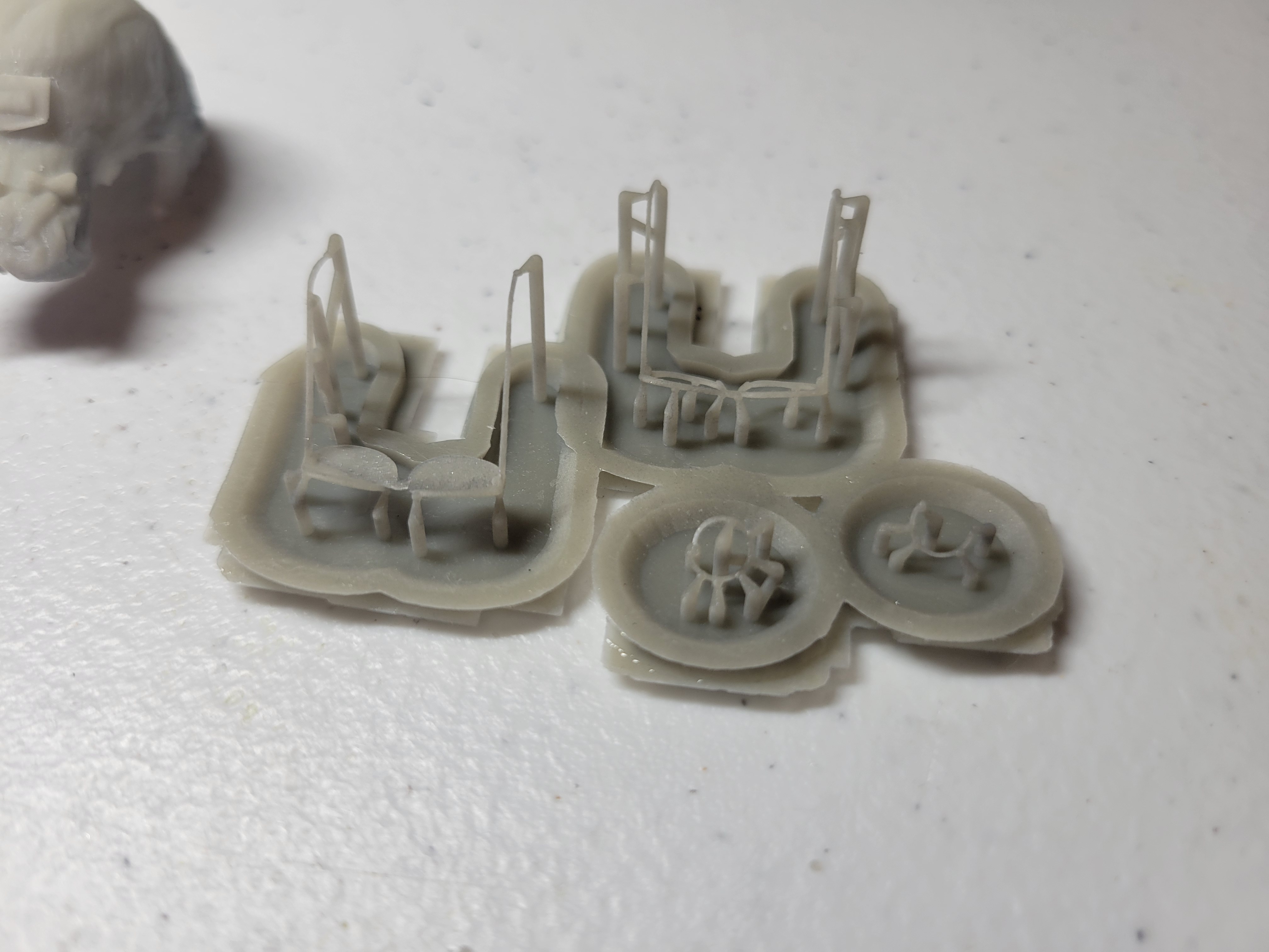

All the sunglasses with lenses were too thin and ended up folding on themselves, but the rims by themselves came out okay, though I also broke them while trying to remove the supports. I had originally printed the full arms, but they needed to be trimmed to fit with the heads with the hair attached:

Maybe a head hair one piece print is the way to go. I think the print looks great, and the bandana is going to make the sculpt pop. Motion of the head on most female neca figures is limited. Earrings, could a small metal loop, like they sell at a craft store work, If the revised print with resized earrings still causes problems?

The head with the sunglasses joined to her face had some fails. The sunglasses needed more supports, as did the back of the hair. I just did automatic supports, didn't add any additional ones. But even though I think I could get the model to print correctly, I don't think I'll keep going with it. It really doesn't help much, since the sunglasses can be printed separately. It just makes it harder to paint. It's harde to see, bu that head also has the "bandana-ready" hair, which I reduced in size sone more to accommodate a fabric bandana on top.

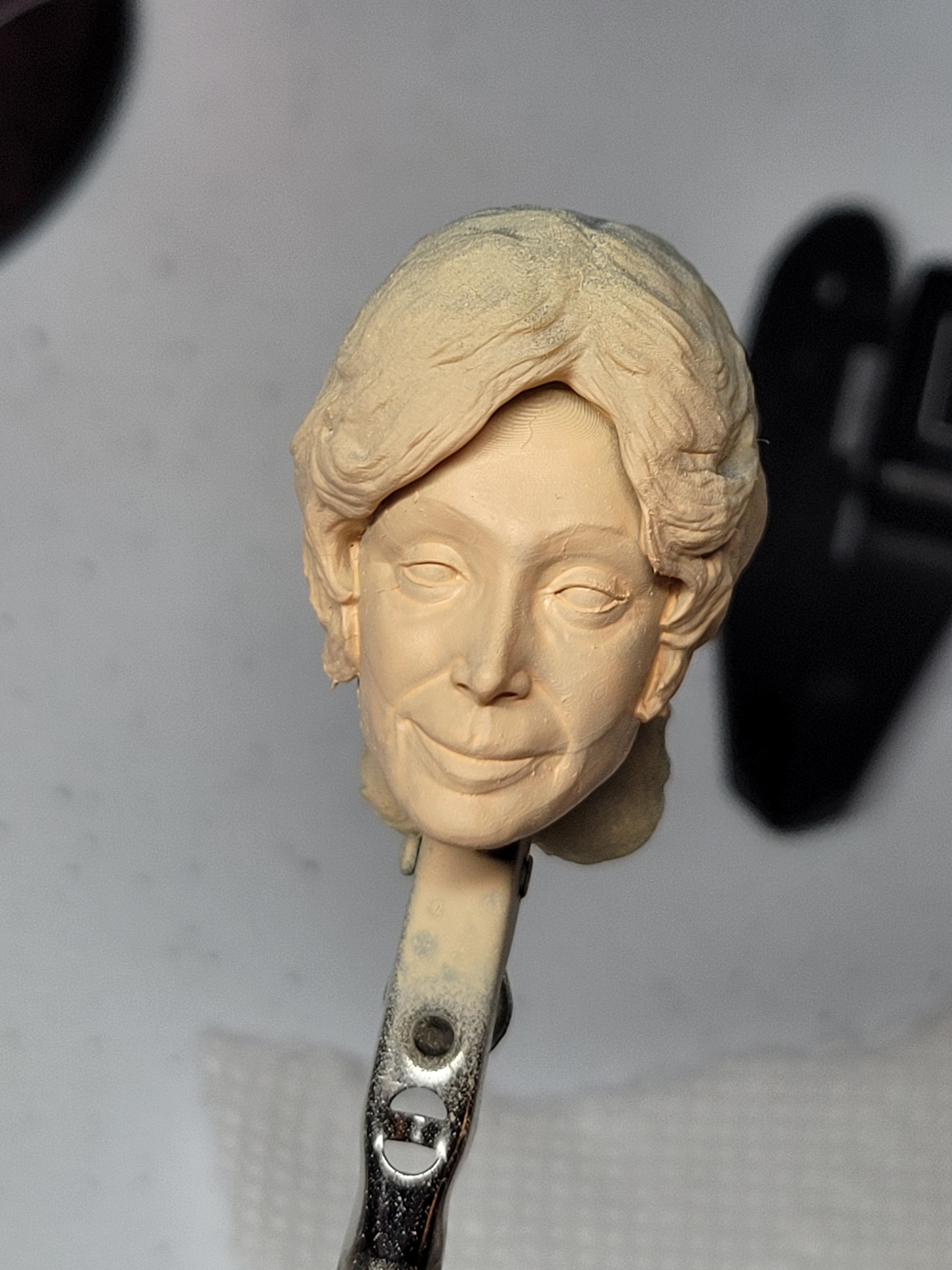

I bought a cheap battery operated airbrush, the kind with a small compressor built into the device and charges by usb. I've never airbrushed before, so I figured this would be a low-cost entry into airbrushing. Here's my test with Vallejo acrylics:
It took me a little while to figure out how much to thin the paint - I started by thinning it way too much.I didn't do any priming, filling or sanding because I wanted to see how much detail would be seen, and if it would cover well without primer. It turned out alright for a first attempt - you can see all the flaws (which is good and bad, depending on your point of view). I'm not sure exactly why, but the prints had some bad lines running along her face. It could be because some of the resin had been sitting in the printer unused for months (though I cover it so no light gets in). I also tested out some powder that's supposed to work for coloring resin, but I found it never dissolves completely and ends up gradually sinking to the bottom, which seemed to make the resin grittier.
I started adding filler to the other head, on the face and on the sunglasses on top of her head. I had sprayed it, but ended up wiping away a lot of the paint, trying to get a smooth surface. I trimmed the temples of the thicker sunglasses (printed separately) and tested the fit.
I'm hoping to figure out the airbrush more as I continue to work on this. I should have the 3D model files finalized for sale soon - just a couple small adjustments yet.
