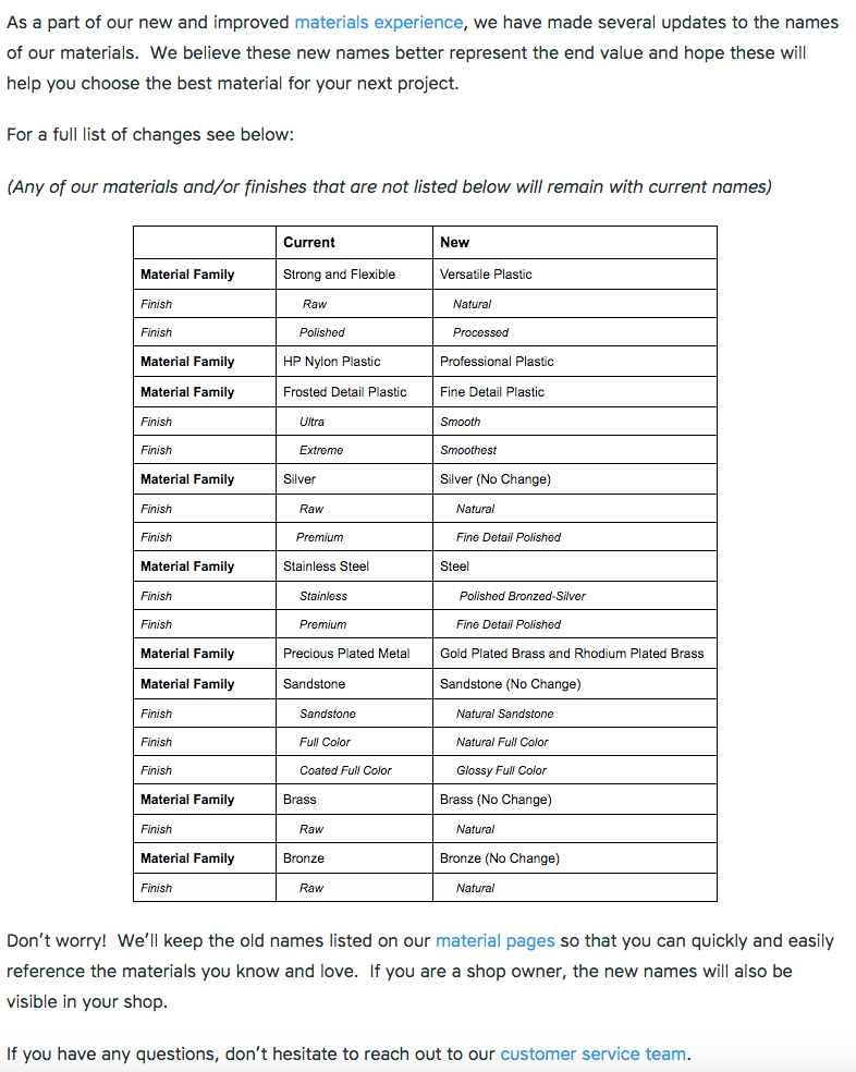

I thought I was going nuts when I was placing orders on SW yesterday. Several items were literally disappearing from my checkout cart, as well as some items from Dave's SW shop. The blow explains. As my luck would have it, SW implemented the following materials changes just as i was placing my orders:
https://www.shapeways.com/blog/arch...ew_Names)&mc_cid=c085b1e82c&mc_eid=299626d41b
Seems any parts listed as FUD have been dropped and most likely need to be listed with new ones. HP Nylon or SWL still their with new names. Moreover, any items available in Clear Acrylic are gone. Seems they've may have done away with that material. The project just got more expensive having to use FUD (now called Frosted Detail Plastic) for all parts required to be clear.
EDIT:
Now SW has made FUD items in marketplaces available for ordering again, and automatically re-listed them to new materials name.
No joy on clear acrylic though.
