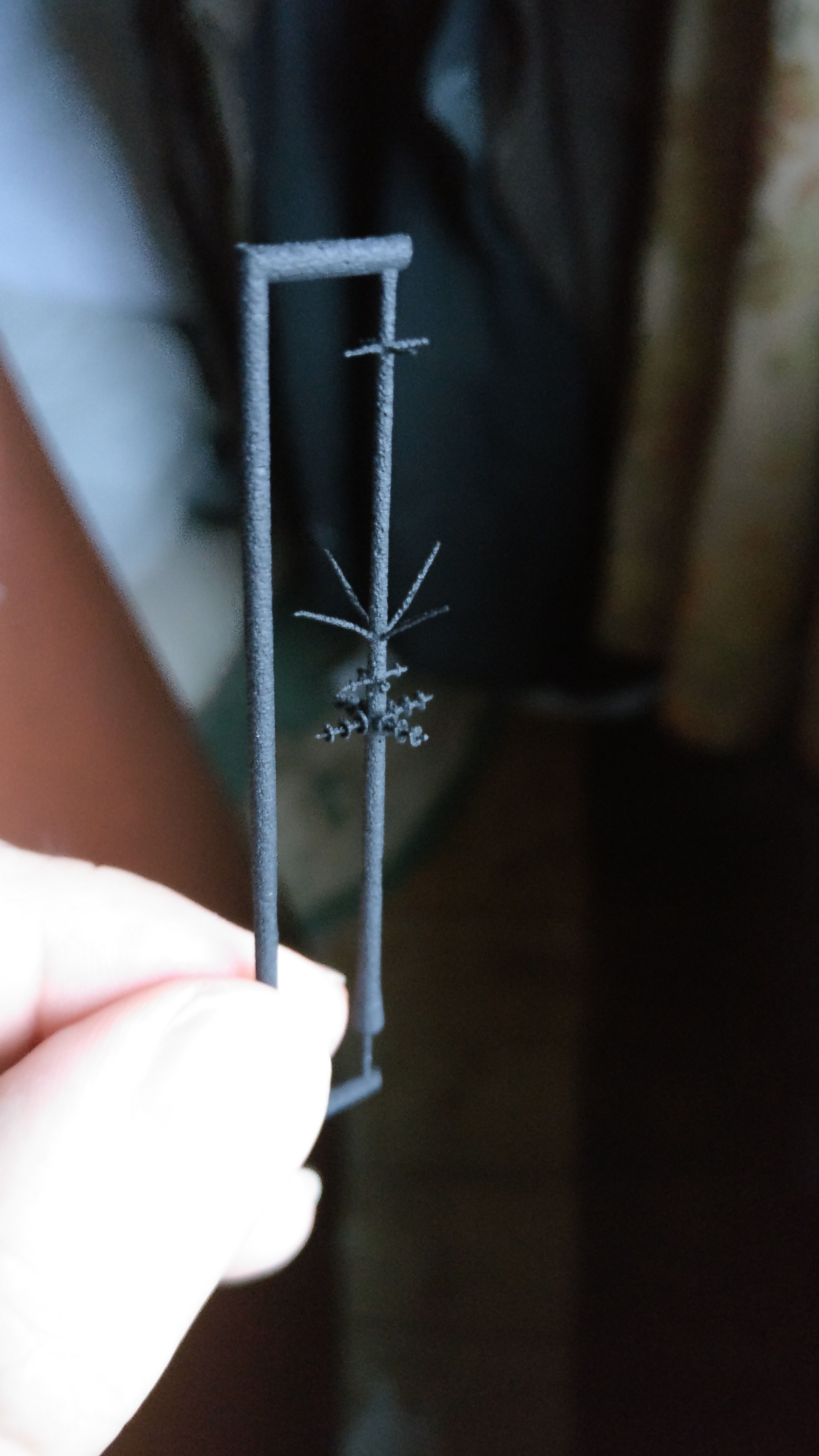

I re-ordered the broken section again, on Tuesday evening. This time in a different material( Black HP Nylon plastic).
I received an email about an hour ago, telling me it had been printed and was on it's way. There were some thinness issues with the part-shapeways talk for broken bits, so we'll see what happens in a few days when it arrives.
On the plus side, I've went and bought one of those dremel type thingies, with the flexible drive. It's pretty fine, so should invaluable when drilling out the remains of the old mast.
I'd rather have something the size and weight of a pen in my hand when doing the drilling, than my old black and decker......
So it's official-Black hp Nylon plastic is good to go!
The part arrived today in one piece. Considering the fine level of detail, I'm surprised it held together. Just a few bends that were easily straightened out.
Much better than the old frosted extreme detail plastic.and not much difference in price.Grey plastic mast.jpg
Result,

How is the nylons'f flexibility? There are some sections of the build that really go under stress and twisting during the build and the "soft and flexible" material was a godsend for my build...
It's VERY flexible. If you look at the picture I posted, the four main antenna "twigs" were all bent over. I simply moved and corrected them ,with the end of a paintbrush, until they were squared off. Any time the part was set down, they would bend and need "fixed" again. So- flexible and able withstand repeated fiddling(I won't say abuse, as it wasn't beat with a hammer...).

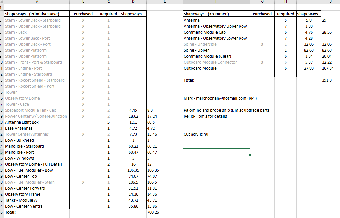

Not sure if this is helpful, but here is my spreadsheet of parts, prices, shapeway store and what i still need to purchase. Although I would defer to 32buds as he has been at this for a while.
