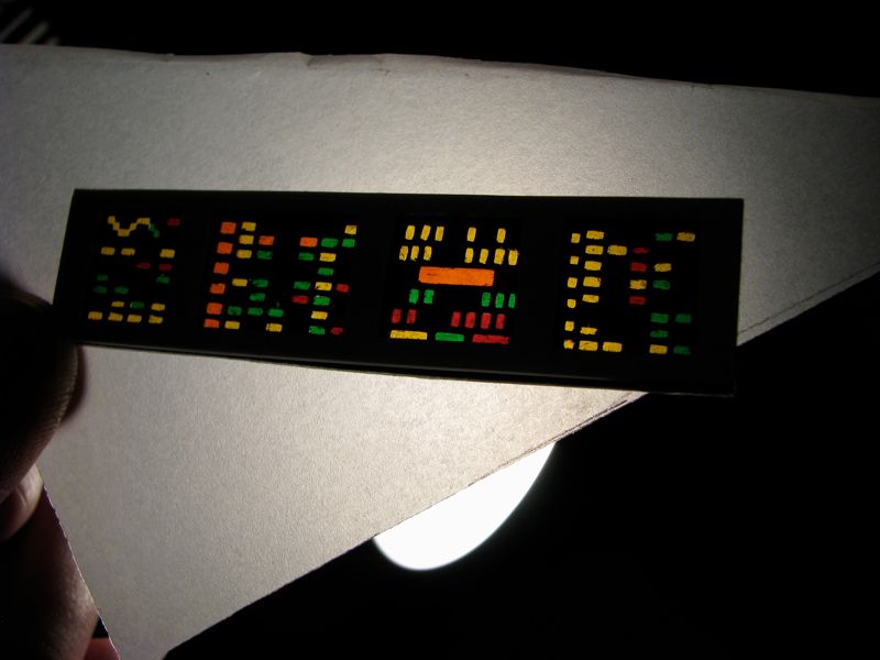

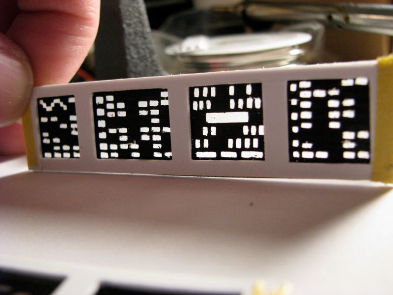

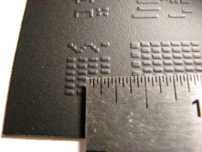

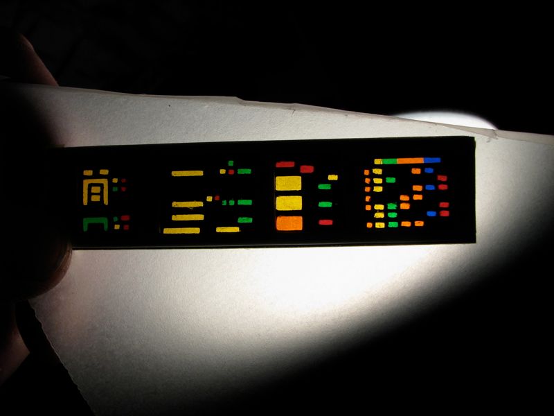

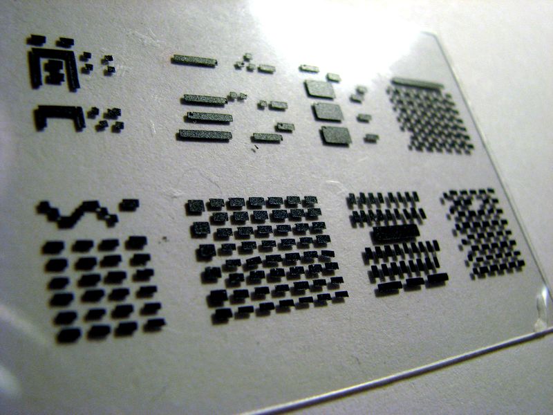

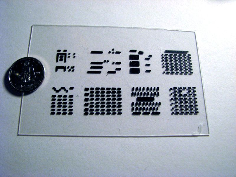

I was able to find a sweet deal on a Silhouette Cameo die-cutter on amazon. If you don't know what a die-cutter is, it is basically a printer or plotter with a knife instead of pen or print head. You can cut paper, cardstock, fabric, vinyl and other thin materials very accurately. They sell them at Michael's to the scrap-booking crowd.

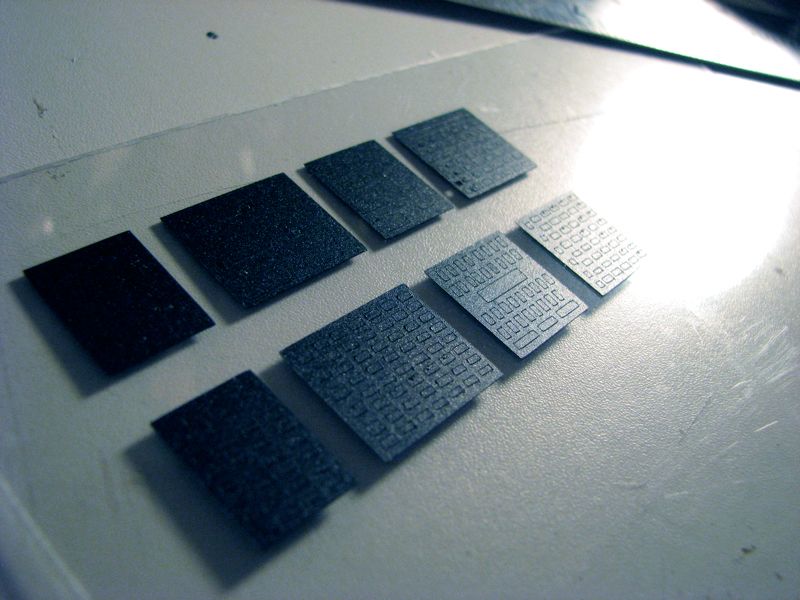

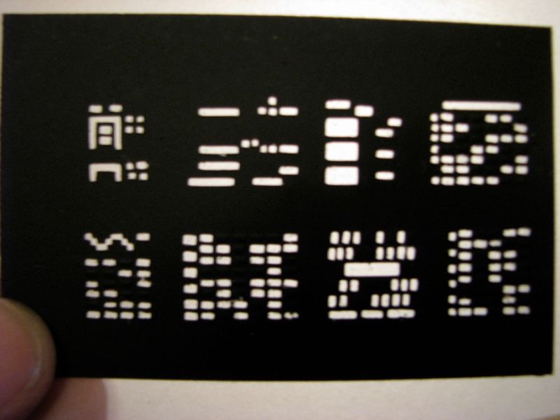

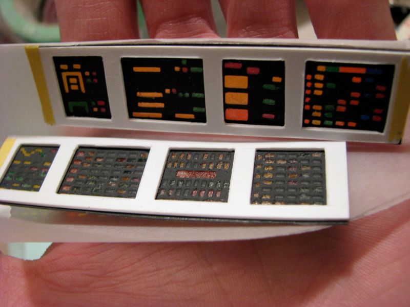

Anyway, my goal was to create awesome backsplash panels. So last weekend I sat down with my new machine and started the learning process. I spent the first half of the day creating my graphics in photoshop. And the second half was spent with the Cameo. When I first brought in my graphics and tried to trace them in the Silhouette software I was getting poor results. And I wasn't surprised because I was certain I was going to fail anyway. The scale I am working in is just so darn small that I didn't know if the machine could even handle it. It was a total crap shoot from the beginning. The trace feature just wasn't doing what I wanted and I ended up having to redraw the whole thing in Silhouette Studio. Thankfully it was fast and easy to do.

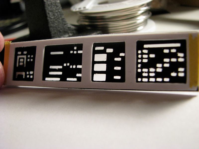

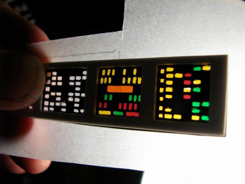

With the graphics done I then got to know my blade. Again the first few tries were complete messes but after some playing I found the settings that works and, voila, I was able to produce my own vinyl masks and transfer them to some clear styrene.
This thing cuts like a dream. To give you an idea of just how finely detailed it can cut bare in mind that the smallest little squares you see are 1/32" x 1/32". I hit the whole thing with a few coats of primer followed by a few coats of black paint until it was completely light blocked.

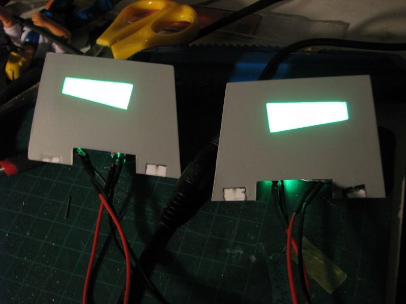

From there I just pealed the masks off where I wanted.
I glued in lighting gels from behind with spray glue for colour.
And there you have it. Still a lot to go but I am having a ball.
Thanks for looking.

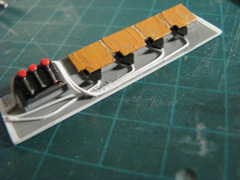

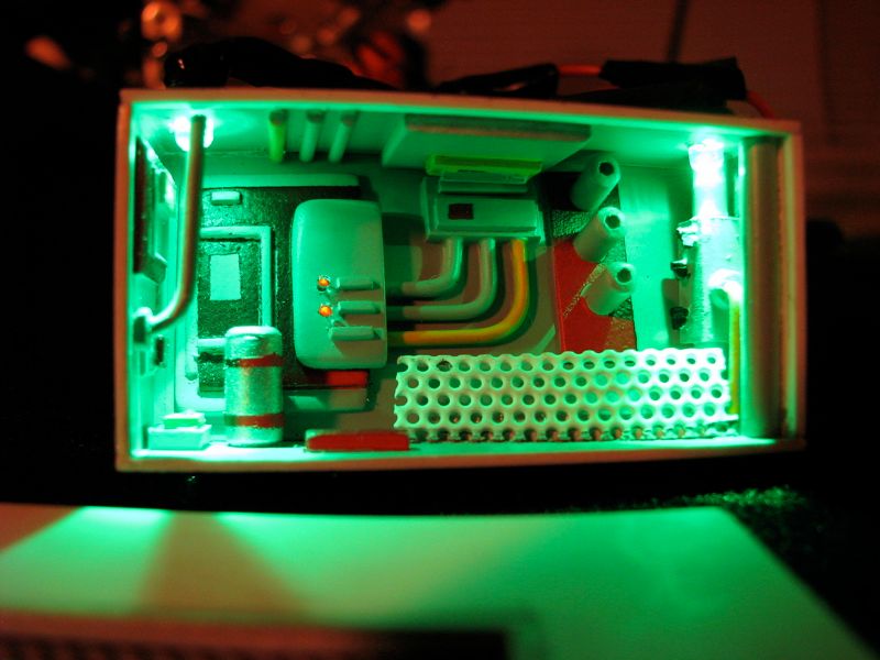

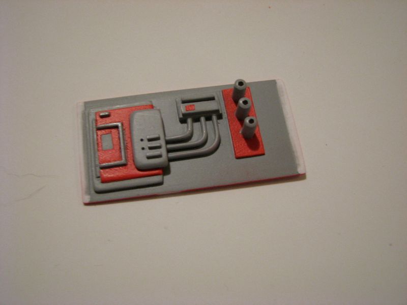

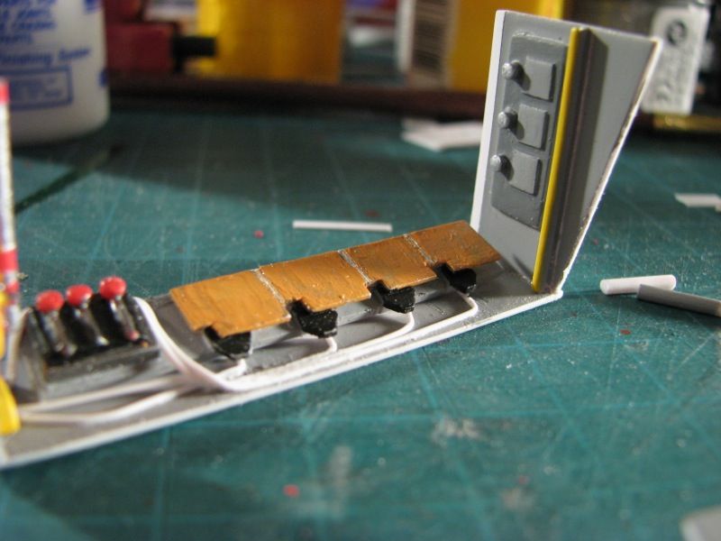

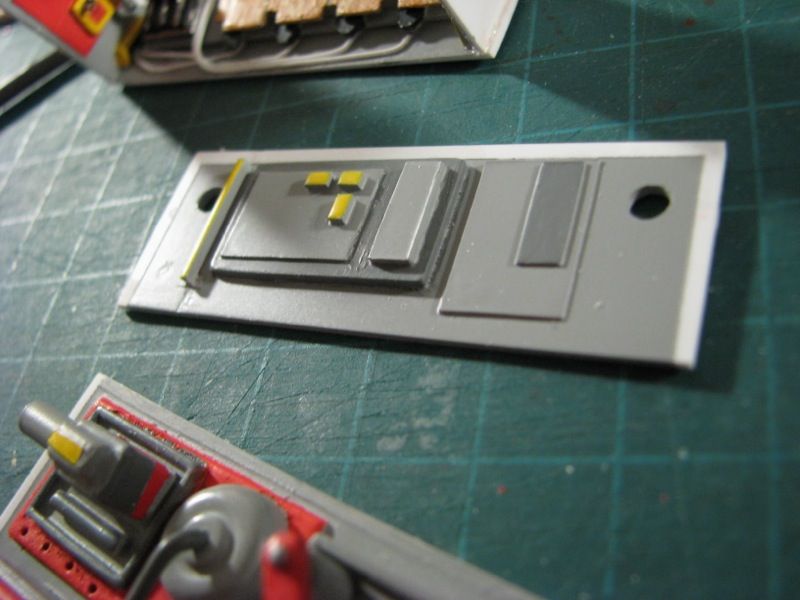

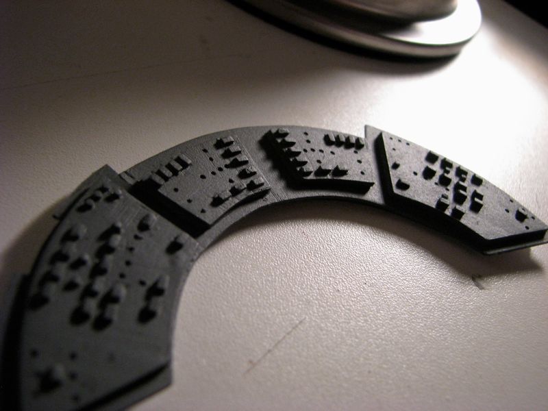

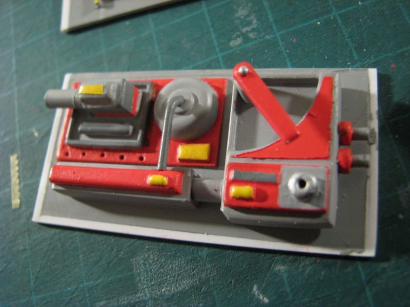

Finished up the buck for Uhura's controls. If all goes well it'll go into silicone tomorrow. Then I'm going to cast it in Easy Cast clear casting epoxy.
Well, it appears that this will not be going into silicone today after all. The Oomoo-30 I have is so old that that part A has completely solidified. Gotta order more. I am a little bit sad now. :cry

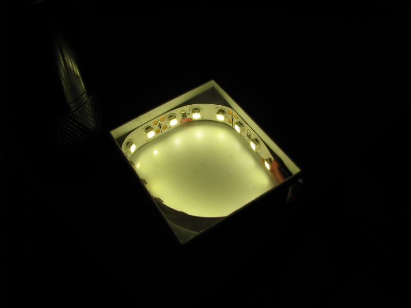

Mate! That's bloody Trekkeriffic!!! I seriously need some of those lighting gels. As for the lighting, it cast me $19.50 US. And will light my whole bridge...all will be revealed soon....keep up the awesome work, Mate!

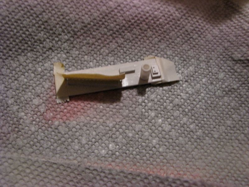

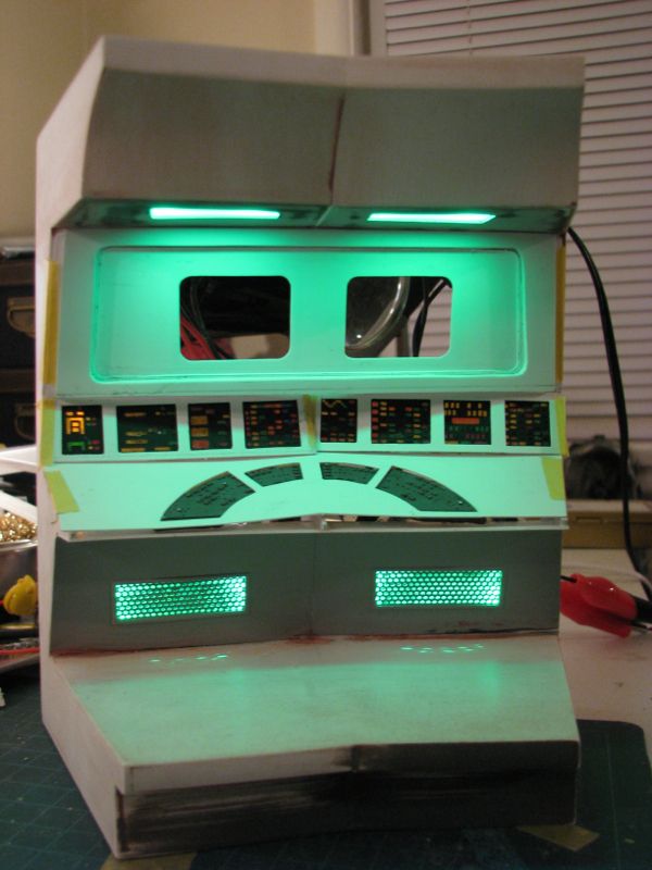

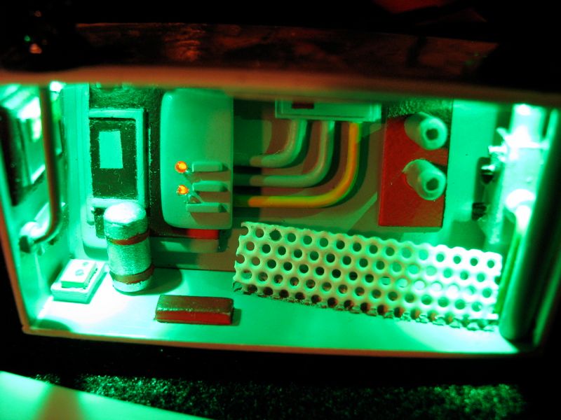

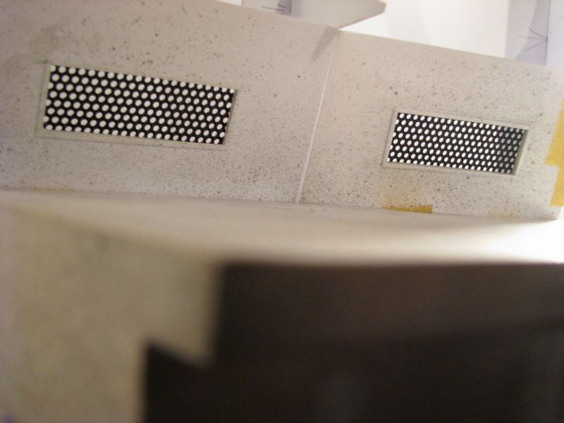

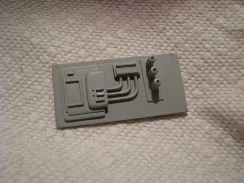

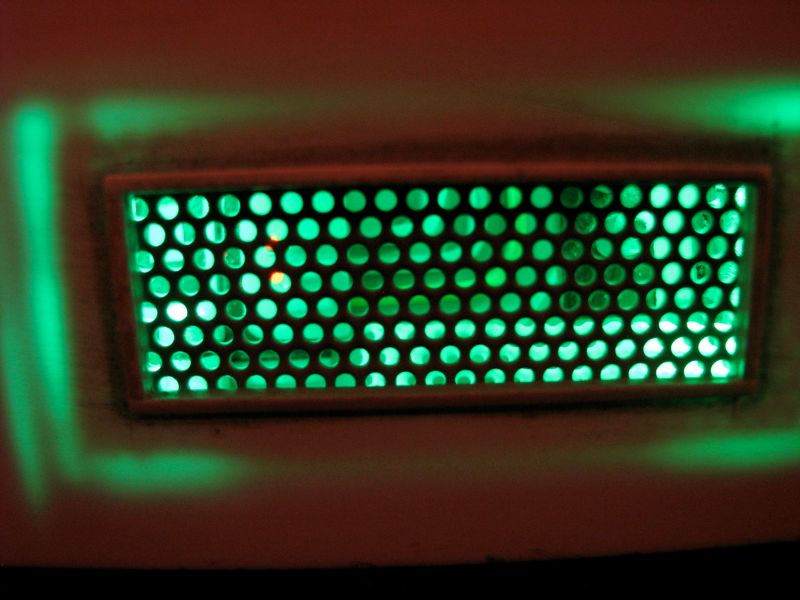

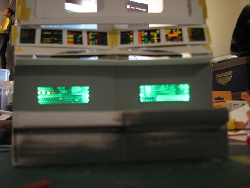

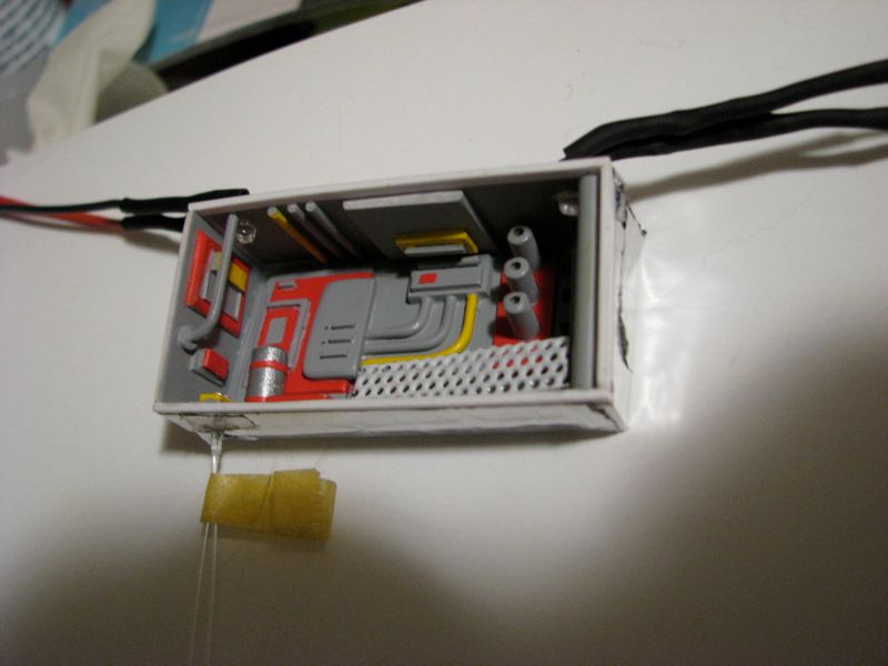

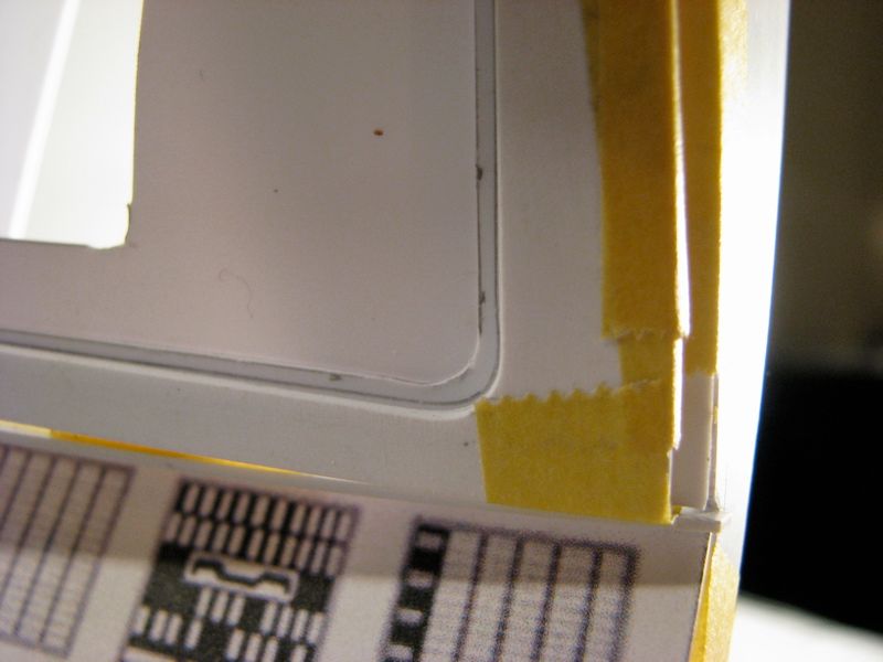

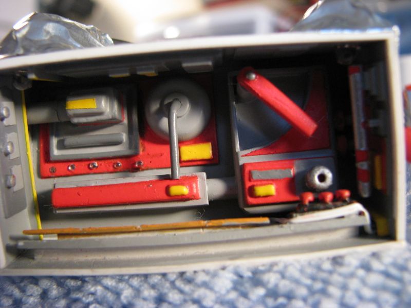

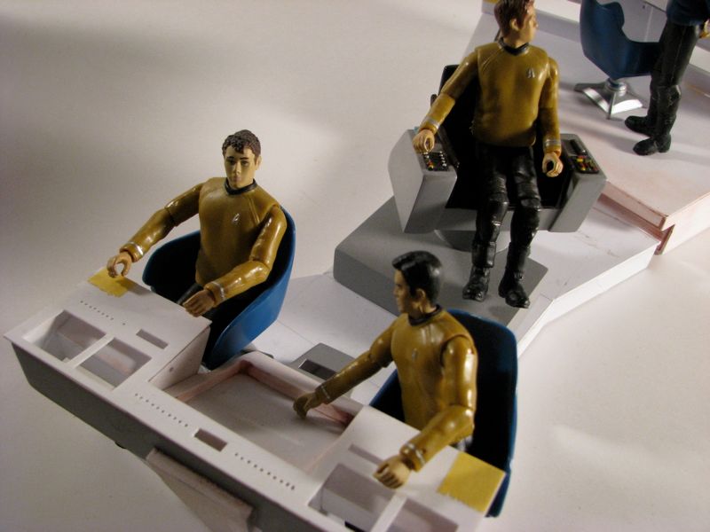

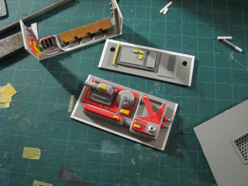

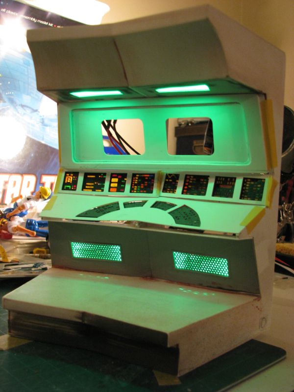

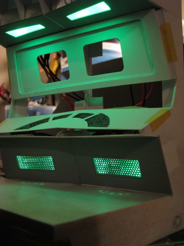

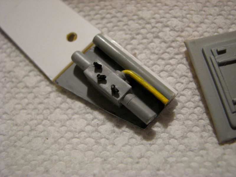

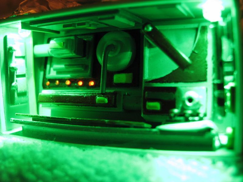

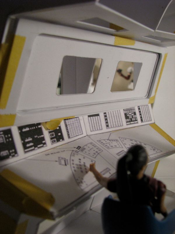

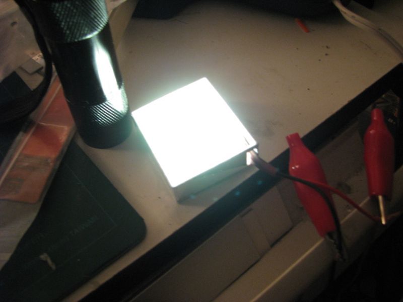

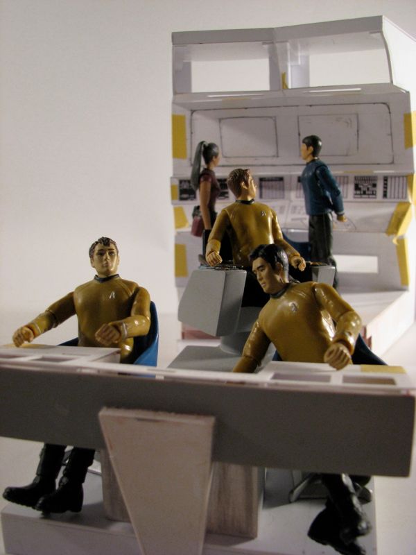

Hey guys, it's been a long time since I have been around these parts. Unfortunately my last computer died (the one that replaced my first computer that died) and it put me out of touch with the world. Little did I know that I bought a lemon. Anyway, this new one is much better and should last me a while *knock on wood*.
I've been busy with several projects that I will be happy to share with everyone, of course. And I've made progress on this one as well. I had a set back that took the steam out of this but I am now getting back on track.

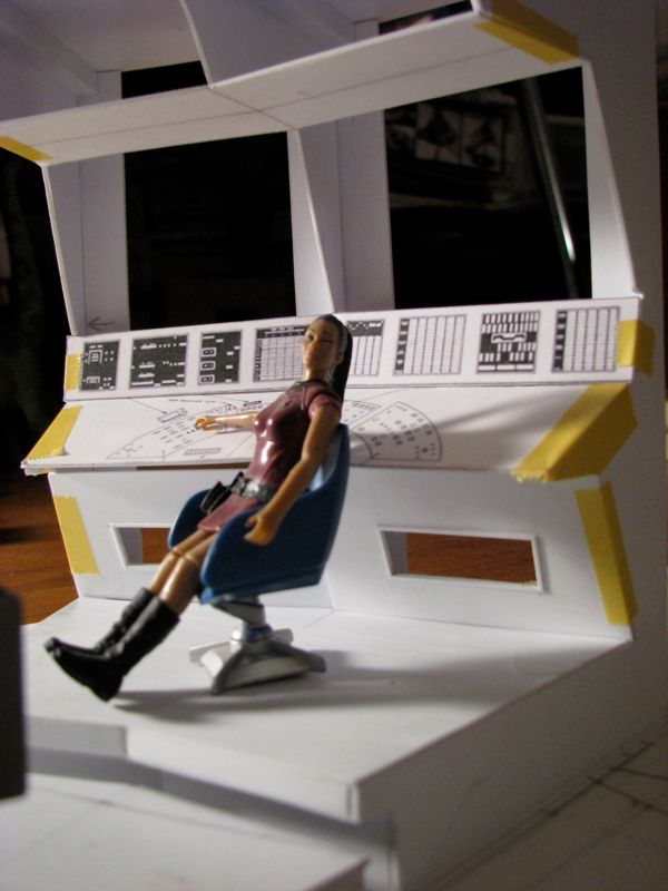

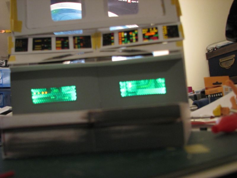

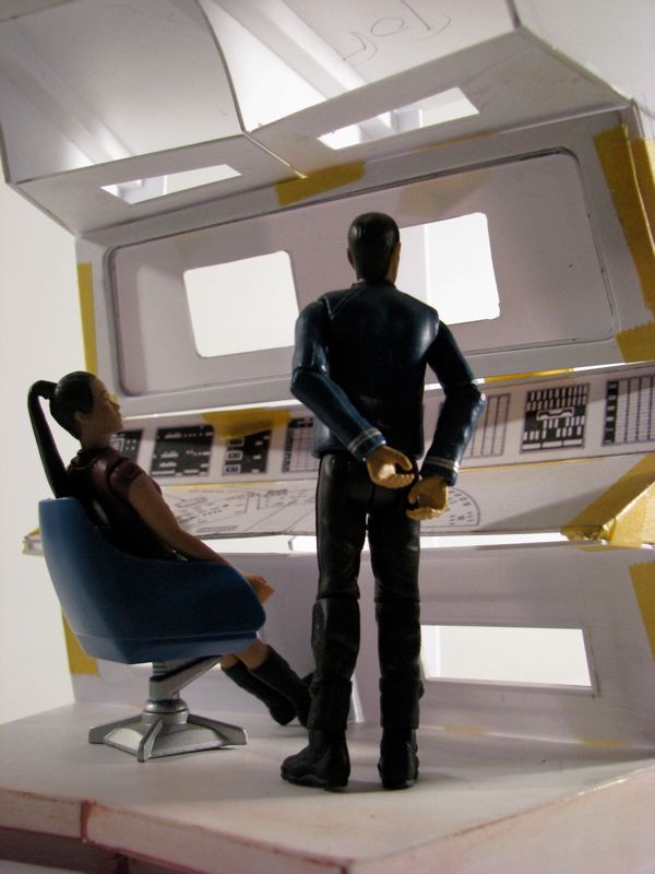

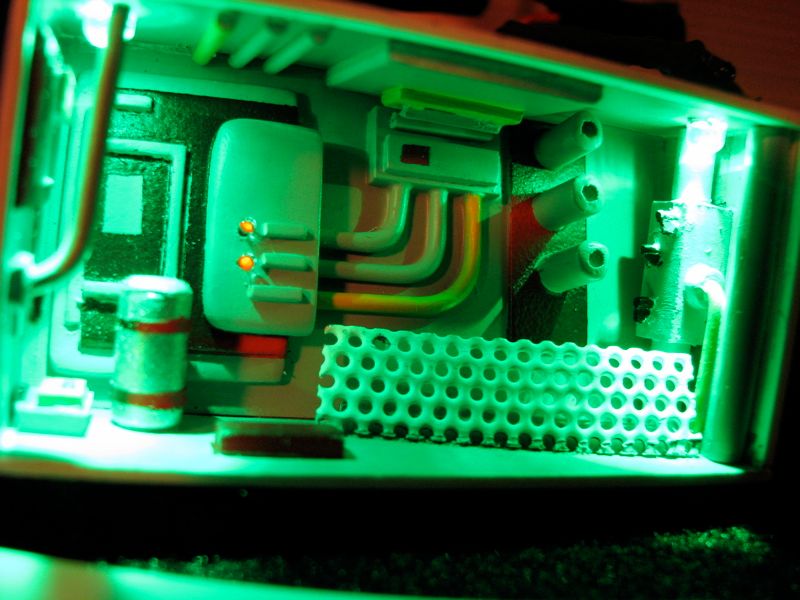

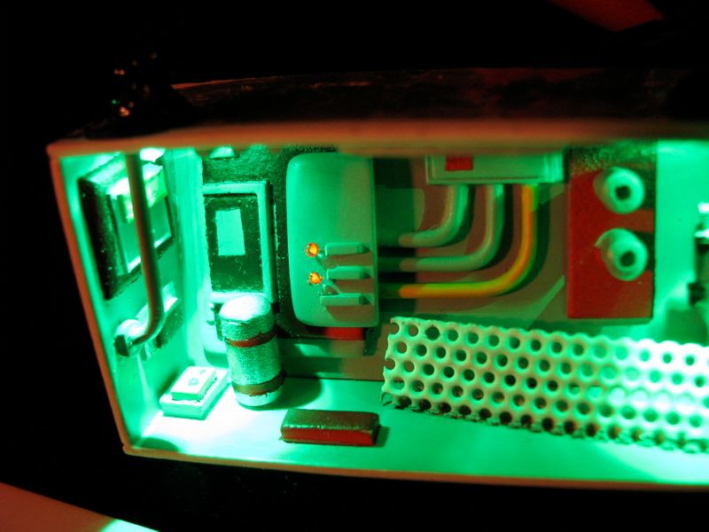

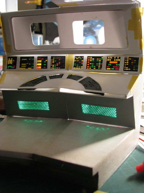

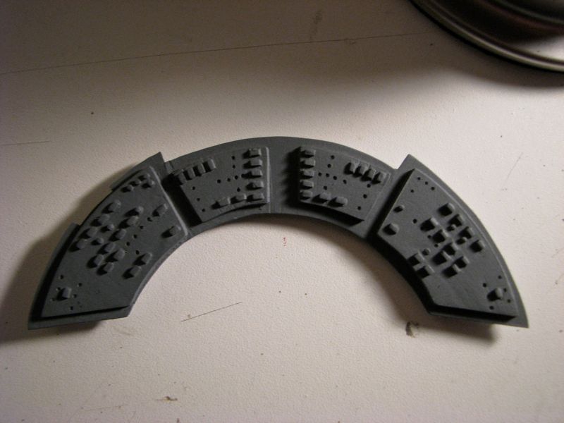

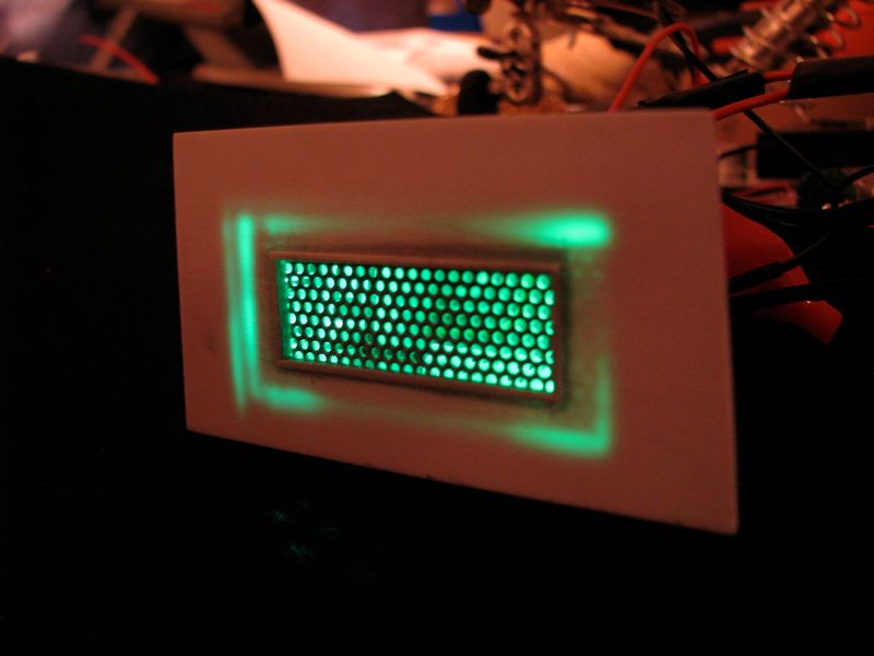

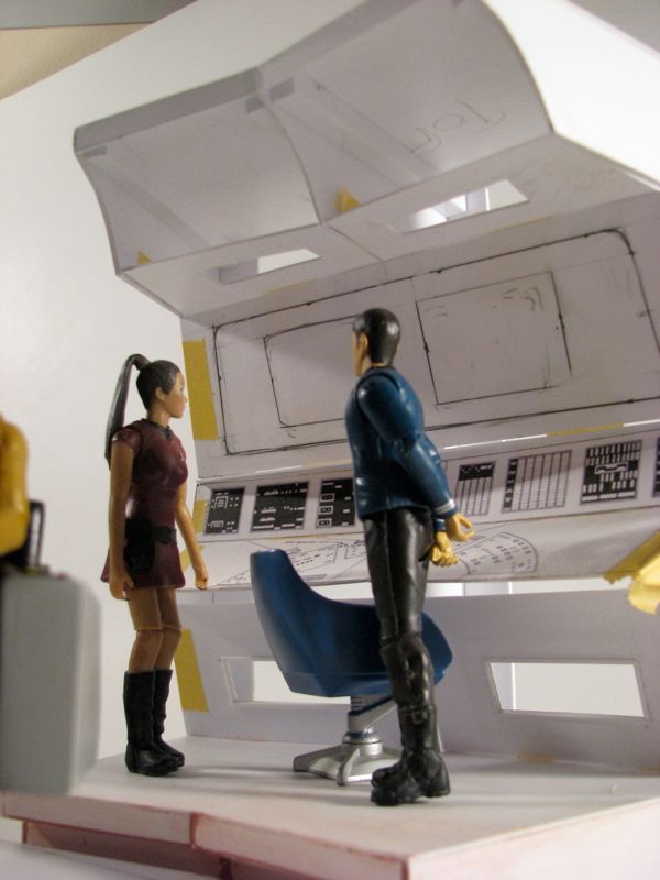

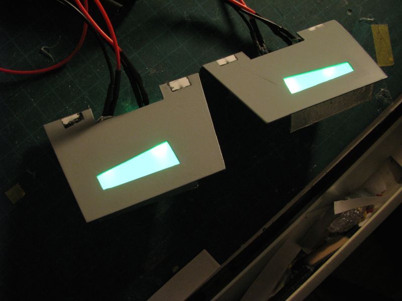

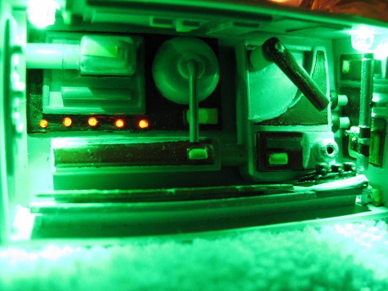

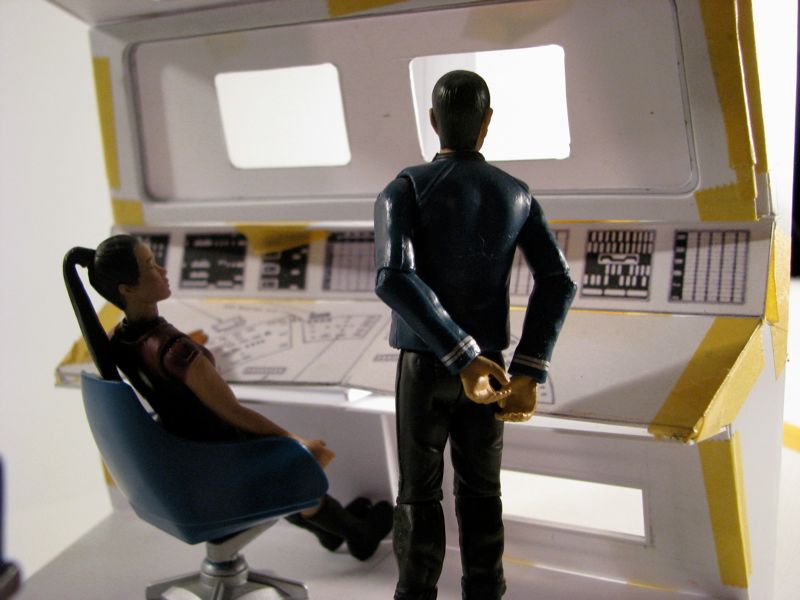

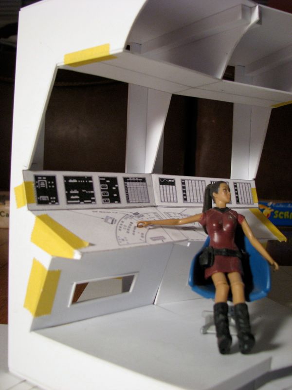

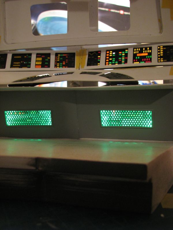

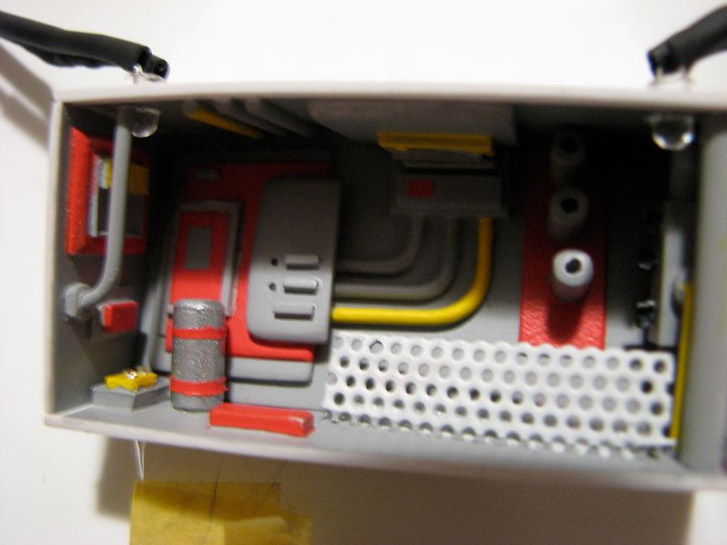

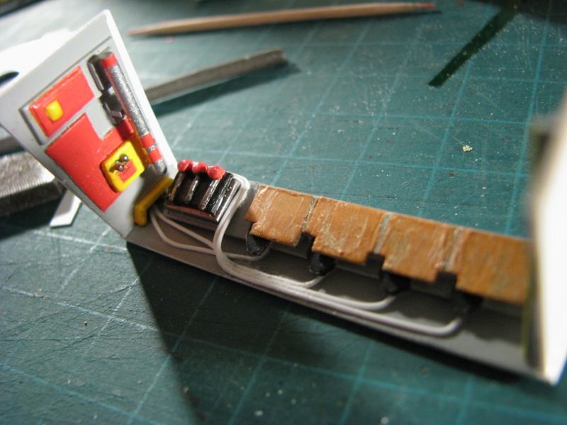

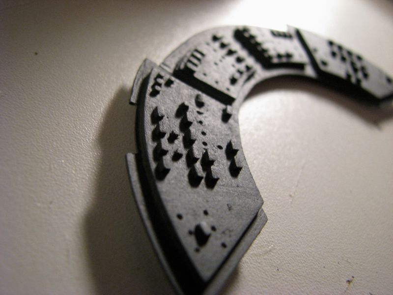

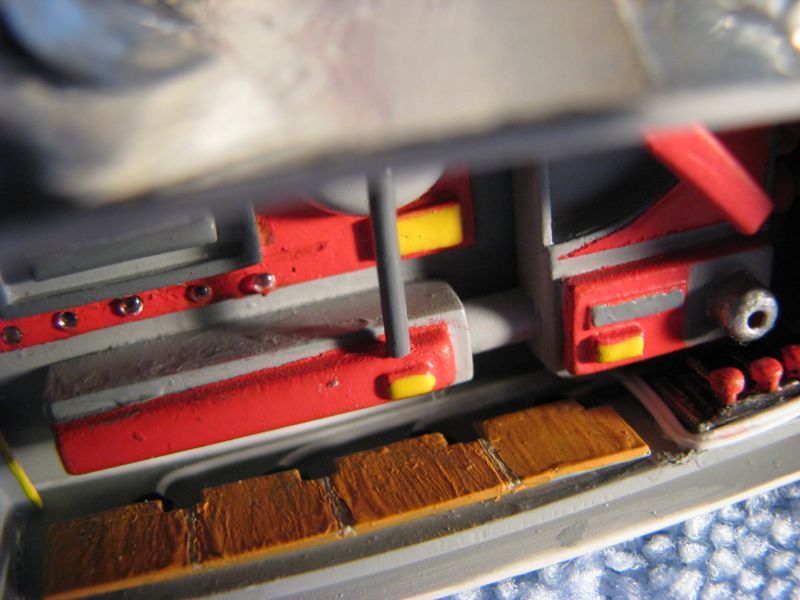

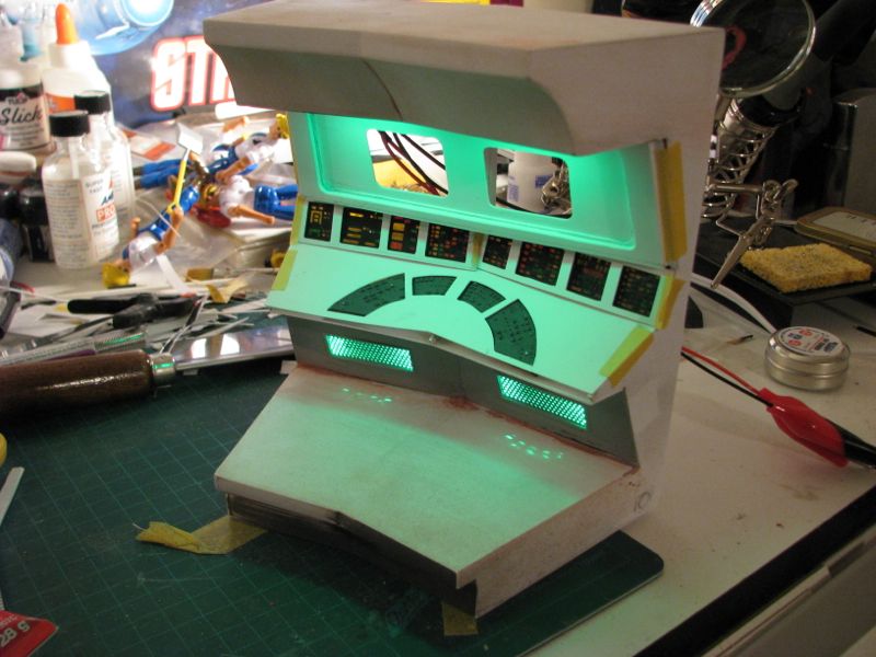

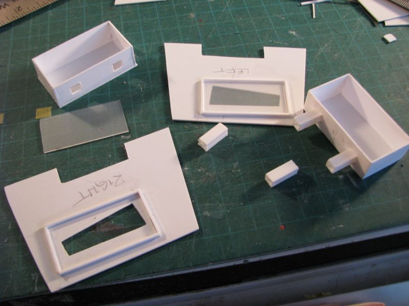

Well, here are a few pictures of what's been happening with the bridge since you've last seen it.
Hope you enjoy the pics, apologies for my absence.
