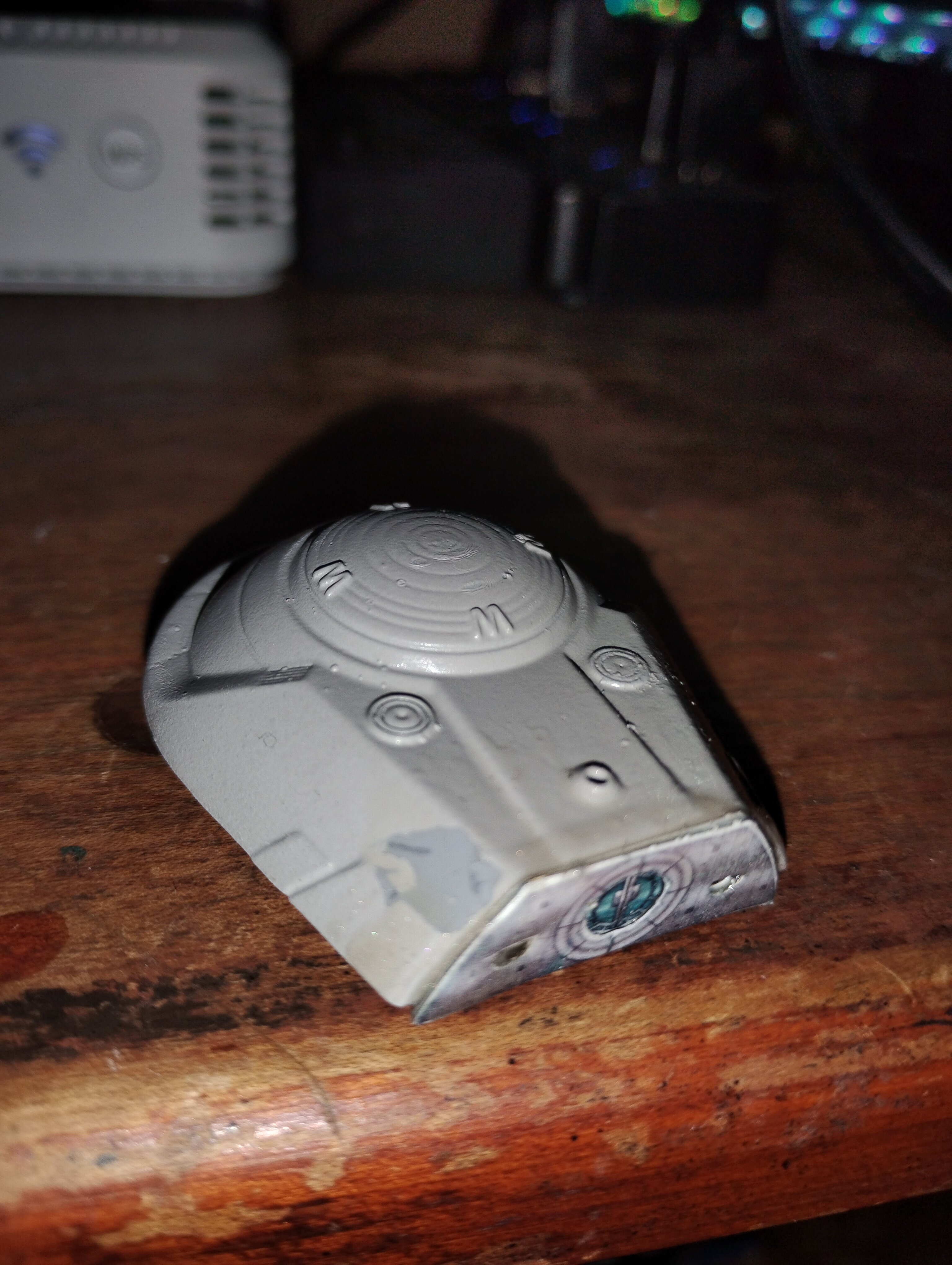

First two layers of the 3 layered rear dock are decaled and its fused in place with clear resin instead of super glue because its sandable but maintains transparency. This is roughly fit. I have a lot of cleaning up to do before I ad the final layer and paint the rest of this section.

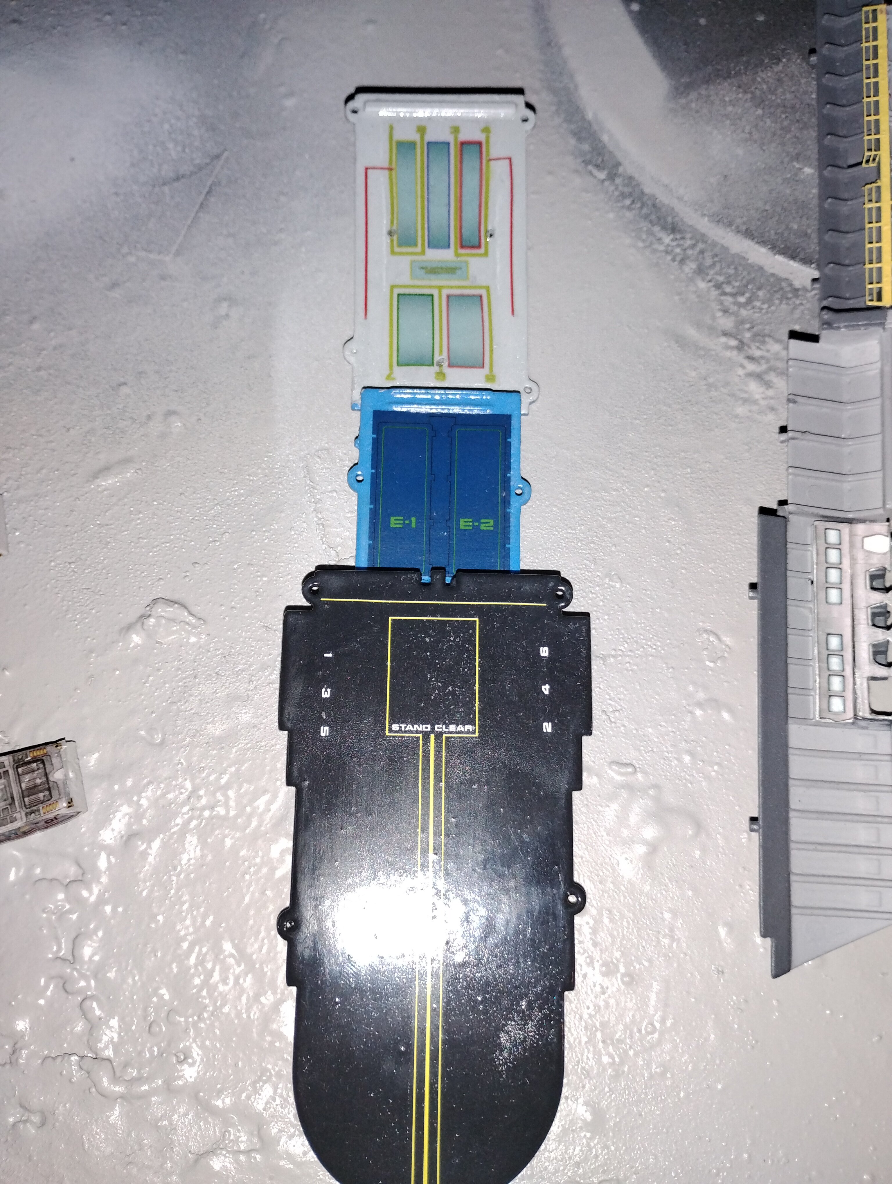

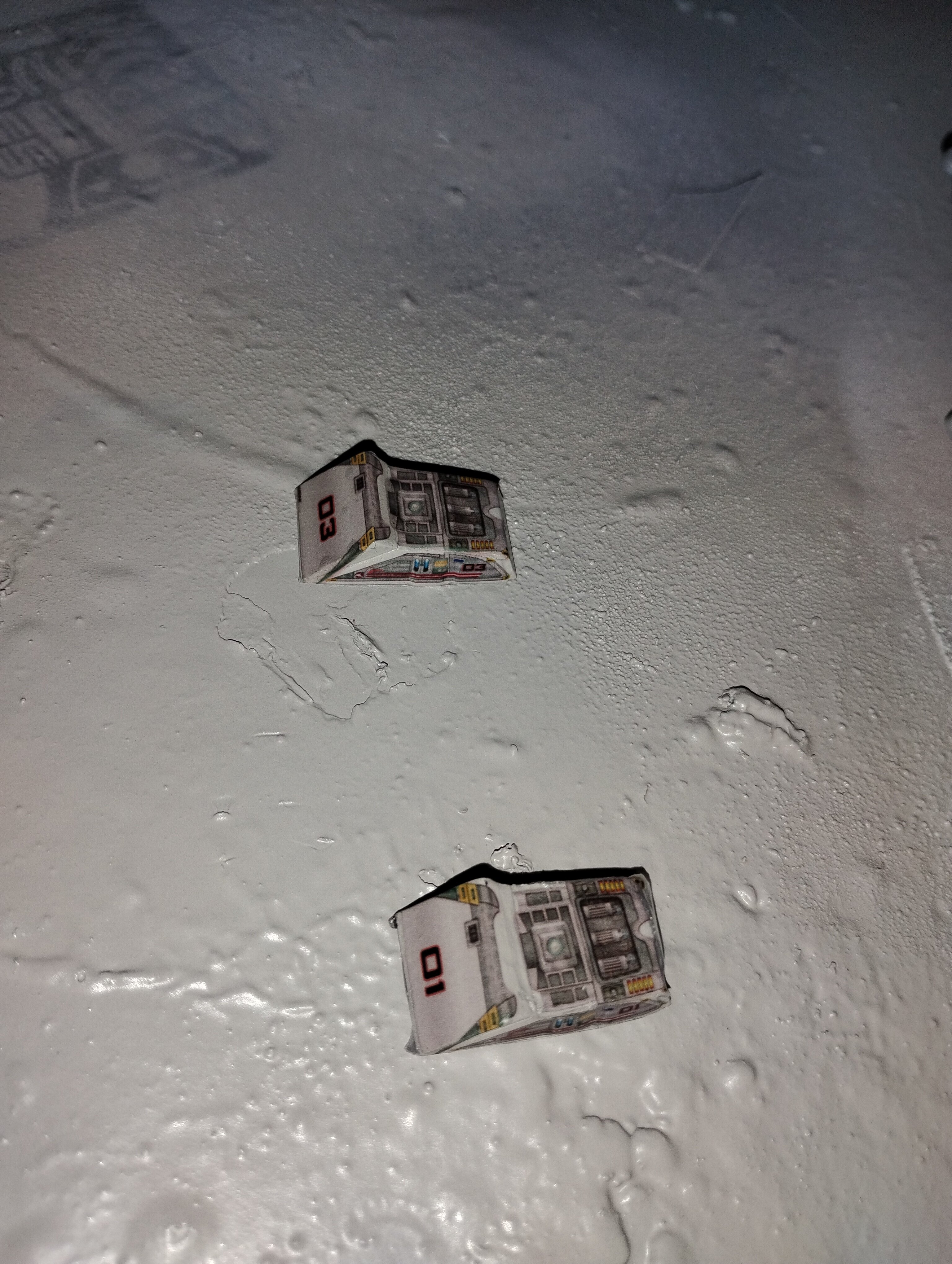

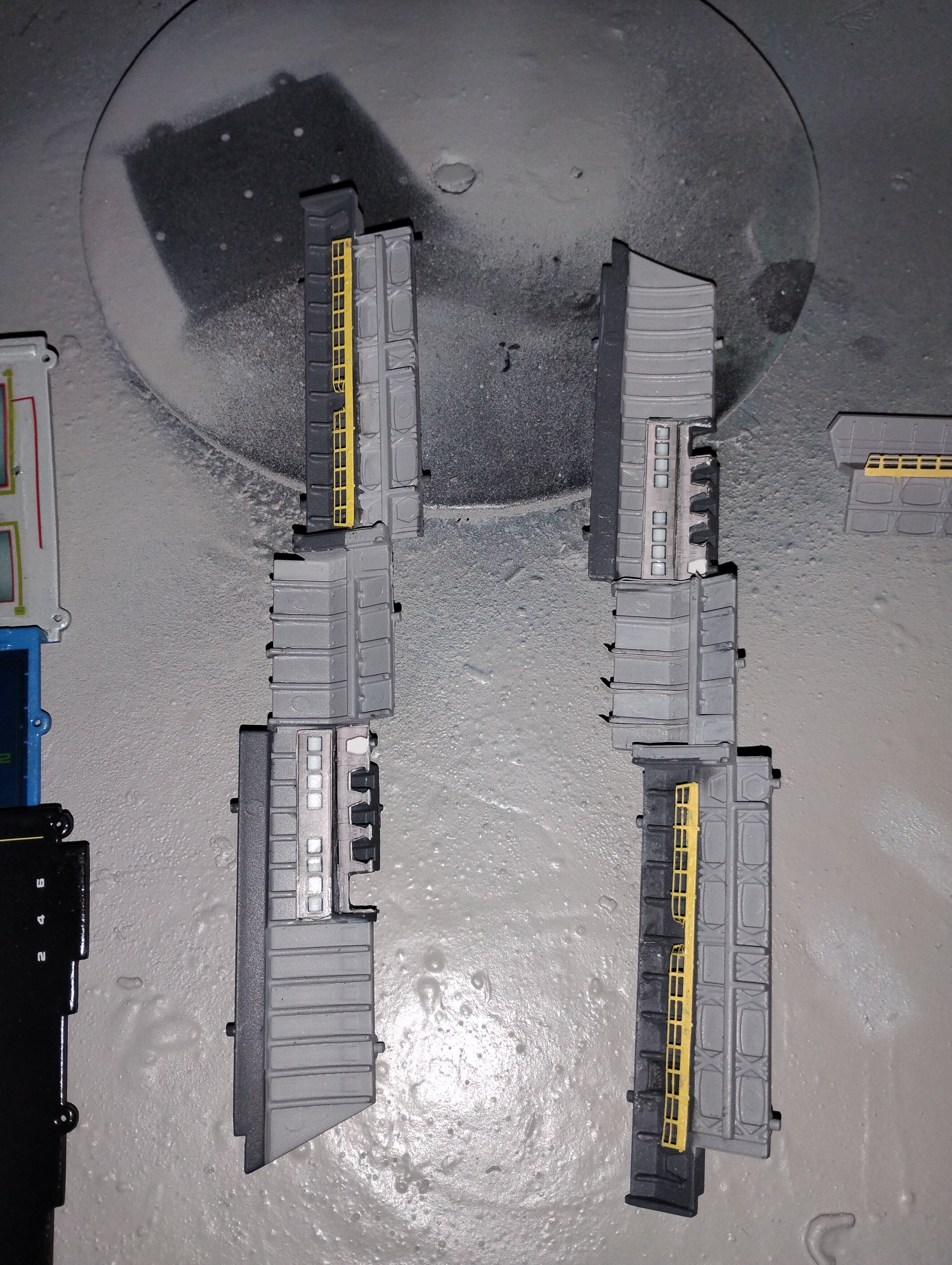

Ok, after a couple of weeks of designing more decals for the photoetch, I applied said decals after rigorously painting the shuttlebay walls and shuttles. I made specialty decals just for the shuttles requiring just a base coat of primer gray. I painted the photoetch for the railings and put them on as well. Still working on the beam photo-etch pieces which even with tweezers are hard as hell to place so Im limiting what I put on.
