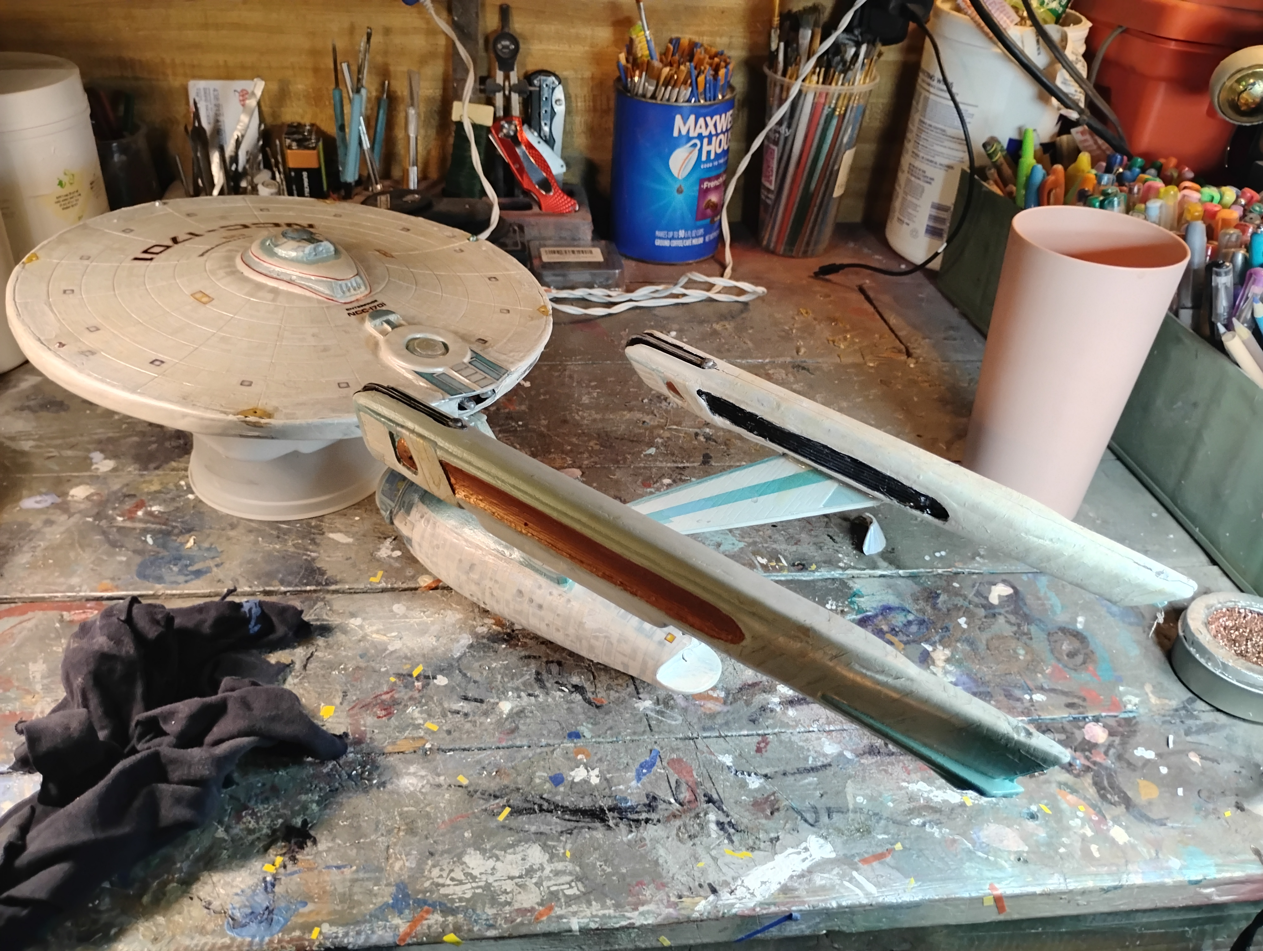

Ok the 1/537 was completed as best as I could get it. No finished pics available bc I rushed off to customer who wanted it. Anyway, The 1/350 build begins at long last. The moments I have been prepping, training, and practicing for. First thing, prime all the pieces light gray, then mask the areas off that are eggshell blue and paint those, finishing part prep.

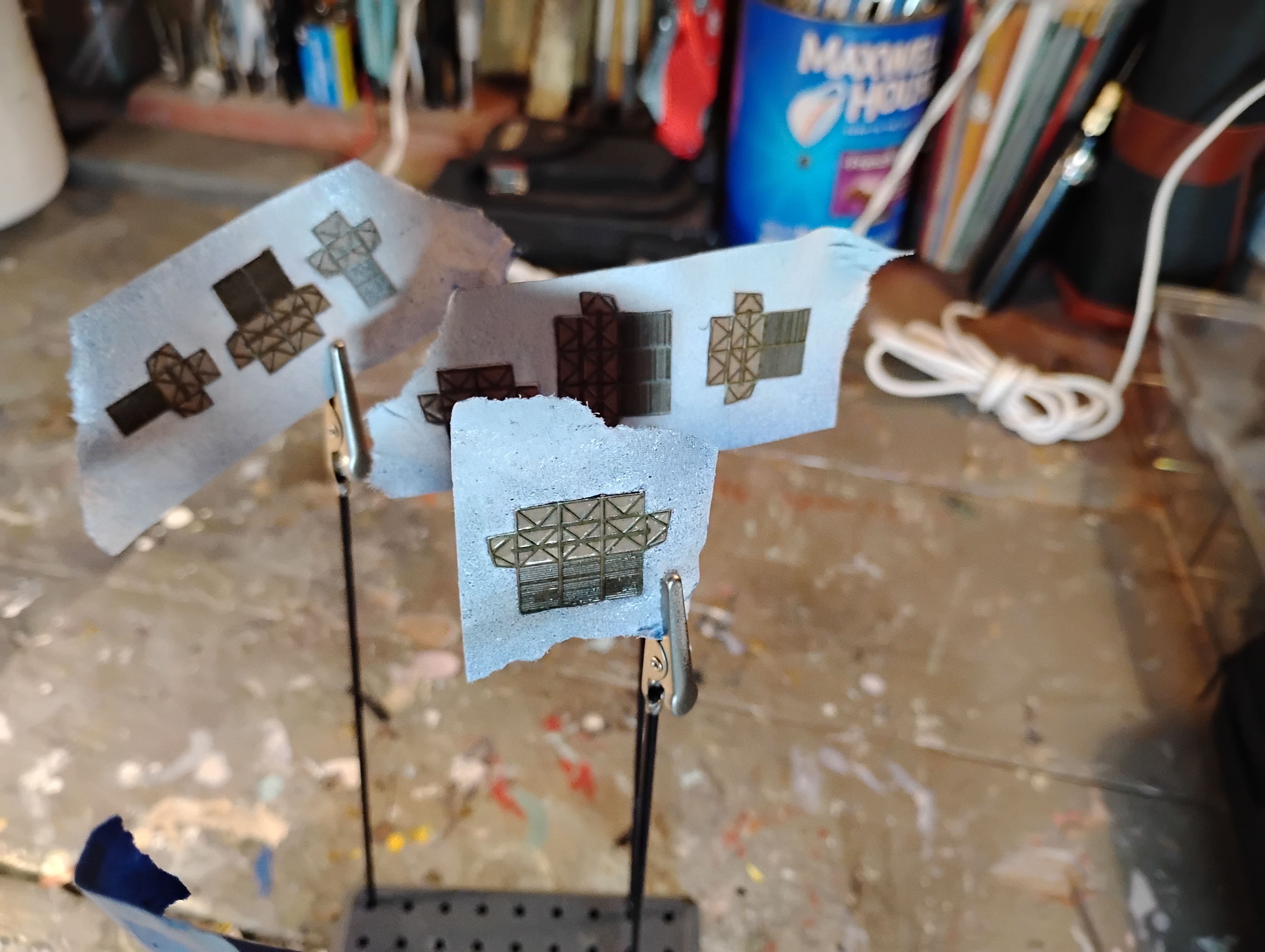

Next, I got the photoetch for p[art 1 of the shuttlebay, in which is the cargo containers by Green Strawberry. I made a photo-realistic decal set that fits each of the cargo containers perfectly! I am so happy how well they came out and they are designed with the same color scheme as used in Star Trek: The Motion Picture.
Even the cross-bar lines conform as well perfectly!! This decal is one to save!

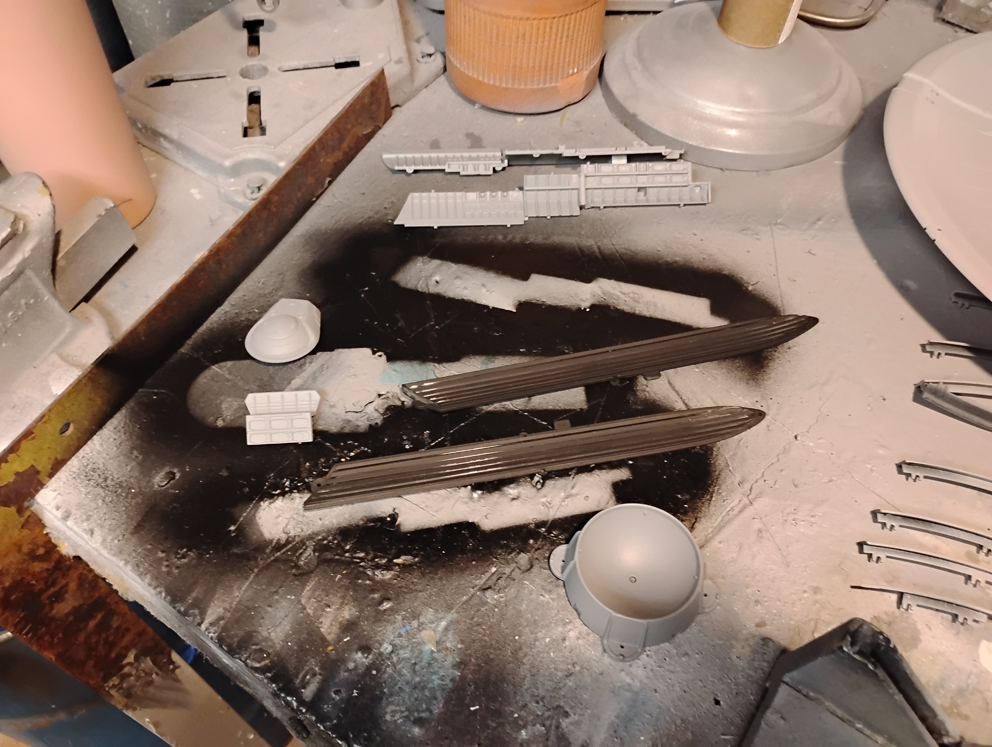

I primed the shuttle bay pieces and then I used the Elmer's glue trick to mask the in-between areas of the inside warp engine panel, that way you can still achieve a pinstripe masking without the tape. The procedure is really simple, one trick while teaching myself all i needed for this kit. It came out perfect for both sides as pictured here.
Got to work more on the inside of the shuttle bay, while waiting for the rest of the photoetch to show up. I have multiple kits coming from multiple areas across the globe. Now that I know how to airbrush, I dont do anything in regular paint can or paint brush unless I have to. Its so much easier and cheaper to mix, use and clean with your own custom homemade paints and supplies. Far cheaper than buying airbrush paints, thinners, reducers, and cleaners. I make them all with component chemicals at home and they work fabulously! Especially reducer and thinner for cleaning. I even reduced a big can of clear gloss 2x rustoleum to use in my airbrush and it coats so well plus i get way more use per ounce than with a brush. I spent a lot of time during the 1/537 build perfecting my paint reducing and mixing as well as my reducing of mainstream paints as well for airbrush usage.
While painting the Shuttle-Bay floor, I masked off the areas of the outer engine nacelles that are to be painted black so that way I can prep airbrush for 1 paint, multiple uses before cleaning and changing the color.
The final pic of the prep work. All done with airbrush. Just need my masks to do my main iridescent pattern painting. Now that I know what I am aiming for I know how to achieve it. My paints for the last model were too dim and not bright enough. I solved that problem by REALLY adding ALOT more mica powder to each where not a drop cant be used without significant shine and immersion.
I designed decals for the bridge rear airlock 3-piece, from Green Strawberry, In which to make more Ultra-realistic, I did hyper-texturized decals for all 3 layers. This is a pic of the decals I made for the arboretum deck and the rear-airlock 3 piece. Anyone who wants the full page of decals to size for the entire areas of the Green-Strawberry Photo-Etch, Its available for sale. Comes also with the cargo containers as well as other sections of Photo-etch not mentioned yet here.
