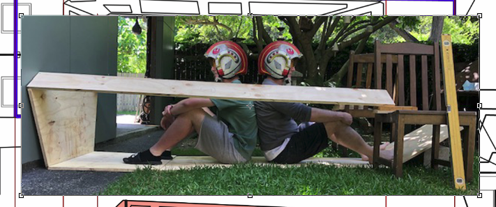

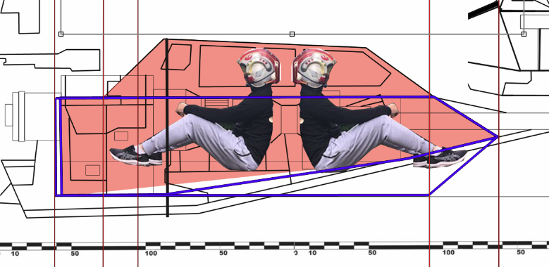

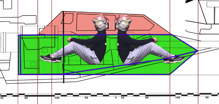

I started to cut the cockpit sheets following some deep thought about the practicalities of the depth of the cockpit area. The red area in my diagram was my ideal design but it forces the pilot to sit too high. As such i had to go with the green version which is probably closer to the prop as seen in the screen capture below. I want a nice detailed front skid so that will probably sit between the pilots legs.
