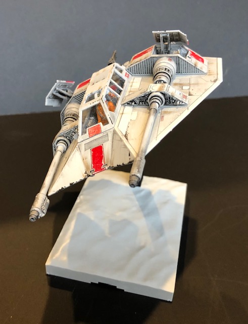

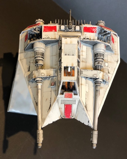

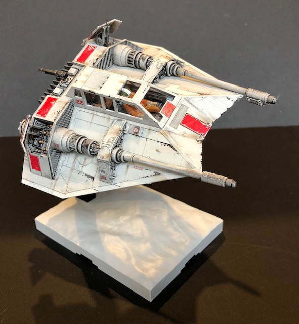

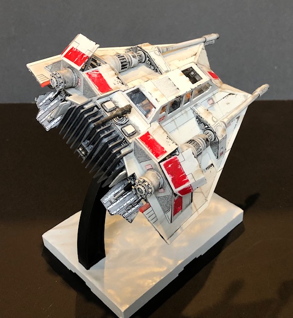

To show the end goal i made this Bandai 1:48 (Great kit) also to get some idea of colouring i want to achieve. It is whiter than the prop scale model but to my eyes the prop scale models never matched how dirty the full size prop was.
My build plan is to have folding wings so save on space and help make transporting easier. There is a panel line on each wing that should provide enough clearance to leave most of the laser cannons attached for transport.

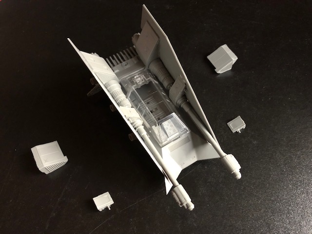

Yesterday i totally butchered a Revell kit just to test my design. I got some small radio control plane hinges for the build. It appears that it should work. I can easily hide the hinges under the wing bulk heads and the hinge line/folding edge can use the existing panel line on the prop.
The only problem i can foresee is the front edge and trying to hide the join. Provided i build this area accurately and strong it should match up OK. I will hide the long join with flexible rubber.
So the only parts that will need to be disconnected for transport will be bulk head covers and probably the rear laser. Provided i build it no wider than 1600mm (with wings folded) i should be totally street legal for transport purposes.

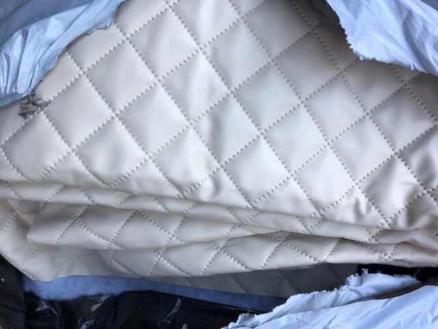

The collecting continues. I sourced this really nice quilted pleather for the cockpit lining (it also features on the cockpit roof). Slightly off white and the size of the squares is a pretty good match. I got this from our local fabric chain (Spotlight) for $60.
The Gio style water bottles are taking a little longer to source. I found a cheap supplier in Saudi Arabia but the postage was going to be $150USD ! .

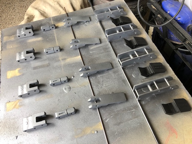

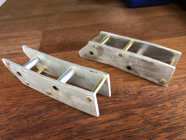

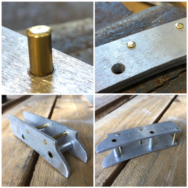

Started on making the latches for the cockpit.
This part is brass and aluminium and was fairly easy. The other sections of this latch will need to be sculpted and cast.
I used a brass rod and tapped the edges down to create a rivet type seal that stopped the flat plate from falling apart. Tube inside keeps the spacing consistent.

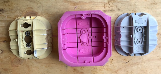

Productive weekend. Molded and cast my Ford escort speedo dial. There are definitely four of these in the copilot leg area. Ill be putting some in the pilots area also. A) because i have them and they are a nice greeble. B) no photos exist of this area so prove me wrong:).

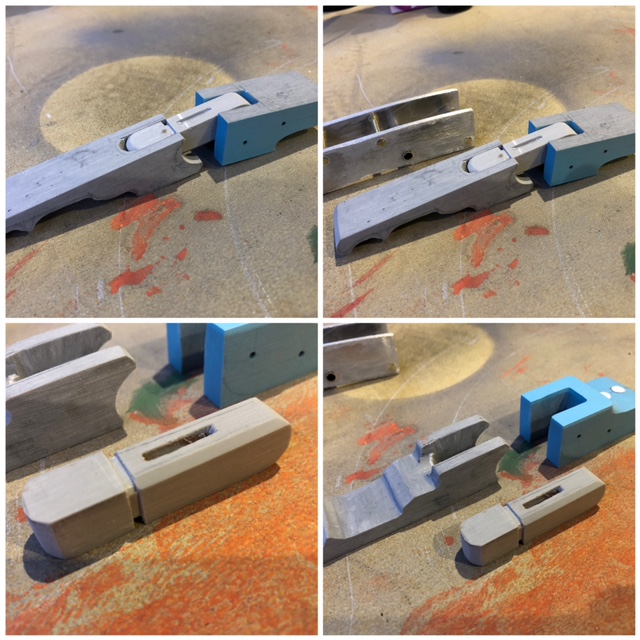

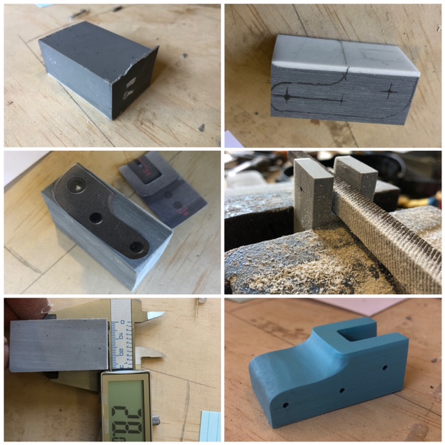

The canopy latch is coming along nicely. I cast some blocks of resin and started carving away. With my digitial calipers i was able to get some pretty accurate measurements. A little more refining then time to mold and cast. The sanded finish on the resin should give a nice texture of burnished aluminium once i have painted it all.
First canopy latch mostly completed. Couple of flaws in the cast as the resin went off too quick (yes, i was rushing). The 'Press' detail i had engraved by a local engraver. Before i could ask him for a quote he had it done for $15, exactly matches a photograph and made to the correct scale. It is perfect. I incorporated this into my sculpt and provides some realism to the piece.
Very happy with the finished piece. Ill finish it with some metallic paint but leave the brass rod details.
