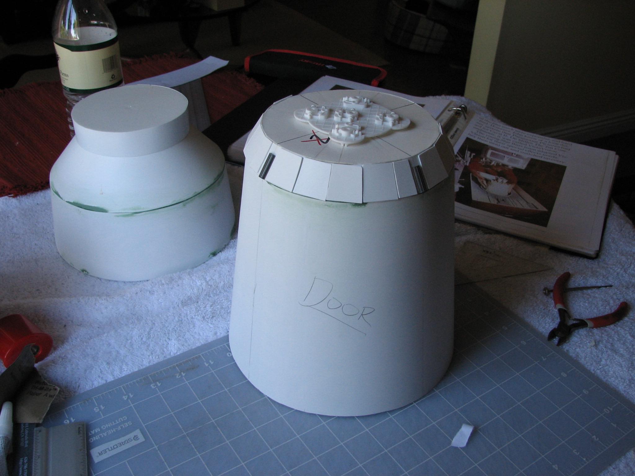

The escape pod has been a bucket (literally)list/white whale build for me that actually started almost 20 years ago.It's my equivalent of Phil Tippett's "Mad God" movie. Inspired by what other members of the RPF were doing in 2006 and learning the lore of the original model using paper buckets as the foundation, I naively took it upon myself to tackle building my own.
I made my own body sections from paper paint buckets reinforced with foam core and wrapped it in thin styrene. It was solid AF. I made a very meager investment in maybe a dozen available donor kits but very far from what would be needed. Plus I knew zero about casting.
Over time things got busy. My wife at the time and I moved cross country and the escape pod was packed up with the other kits never to be completed but sold on the RPF Junkyard.
All of this was documented but back then we had to use photo hosting sites and the photos no longer exist except for one. (Those little wire cutters are still in use to this day.)

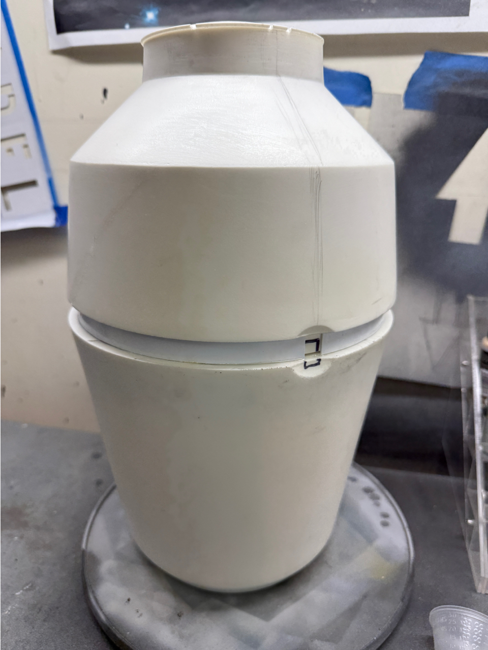

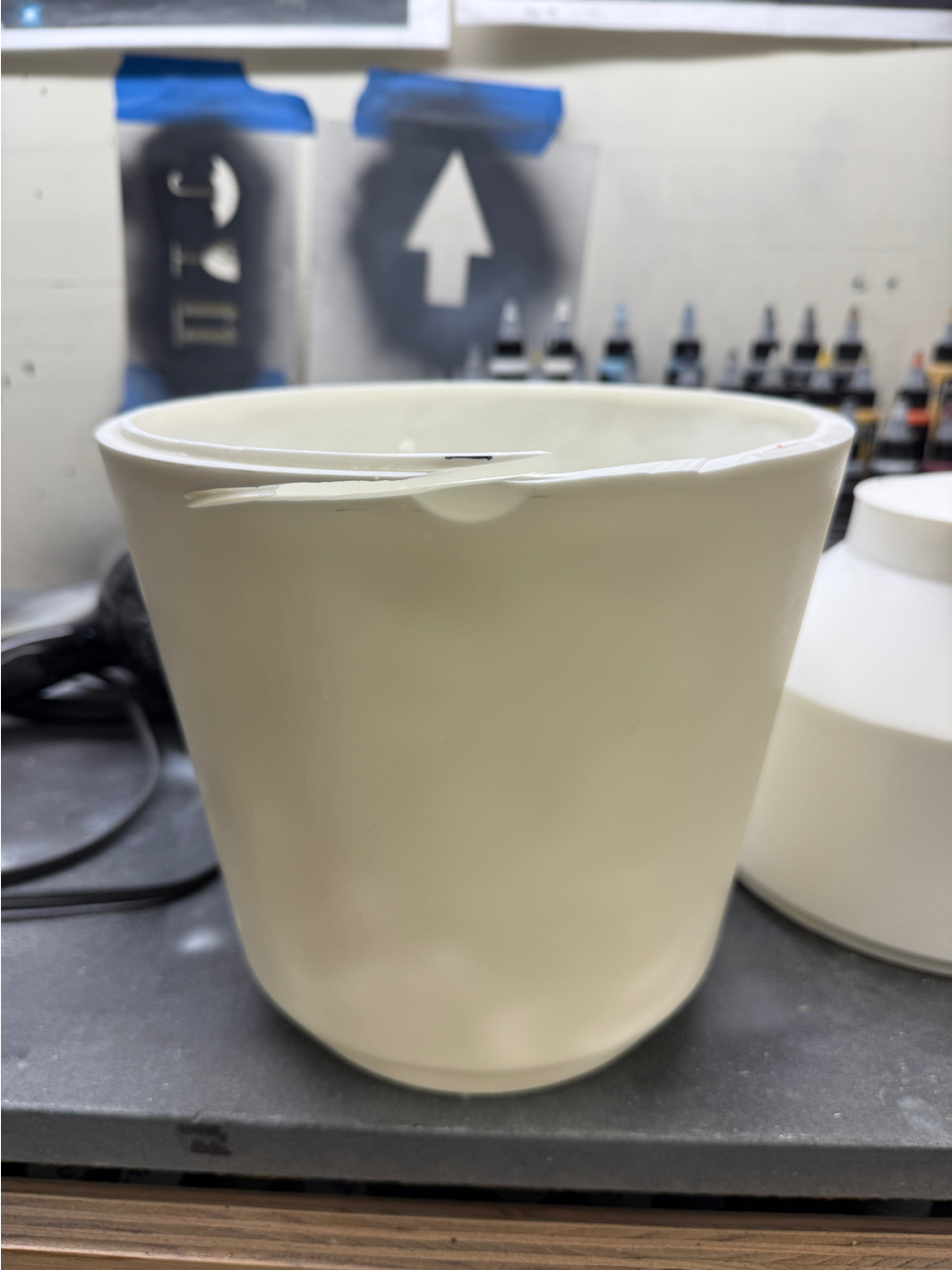

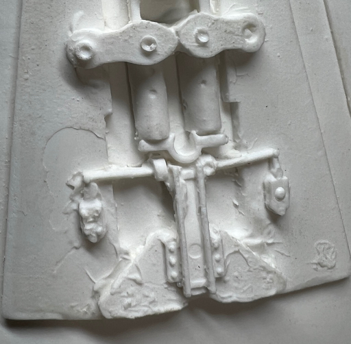

The kit arrived and was sent back the next day. A picture says a thousand words:
Eventually Masterpiece Models got up and running and in the fall I finally ordered my kit. It's arrival was somewhat anti-climatic as I had moved on to doing scratch built studio scale models, ironically out of frustration from the lack of quality I was seeing out of resin kits.
When it arrived I was neck deep in the TIE Bomber so it got put in the closet but not before a quick inspection. The hull looked fine but all the parts had a texture on them. Like so much release spray was used that it resulted in a texture on all the parts.
With a sigh it was boxed up and put in the stash. After reading Vectorzero's great build log of the pre-selling of the company kit I learned that the laser cut styrene panels for the hull are too short and would require modification or remade altogether. Another reason for me to leave it in it's box.

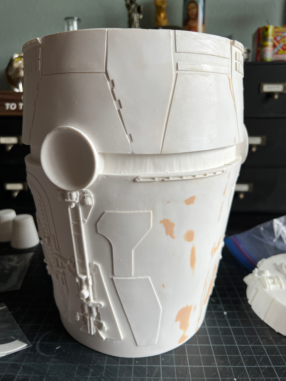

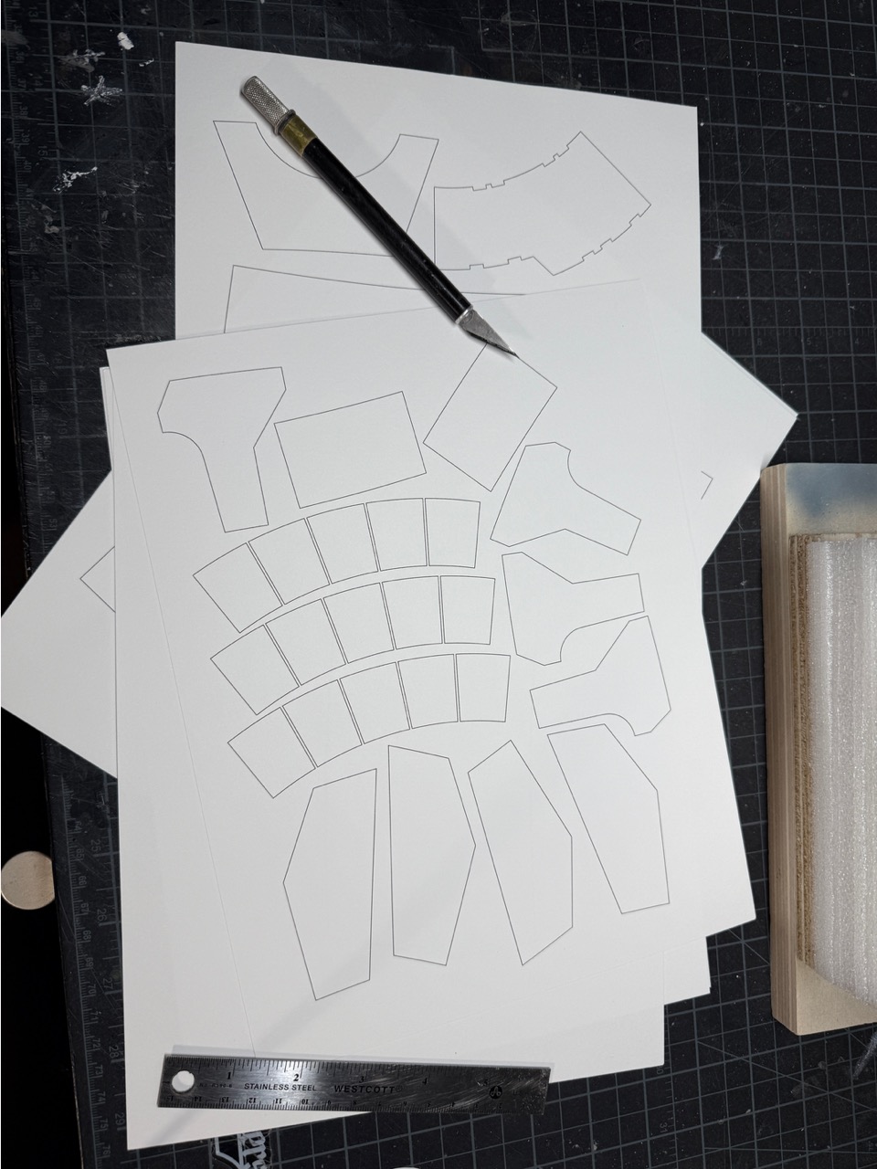

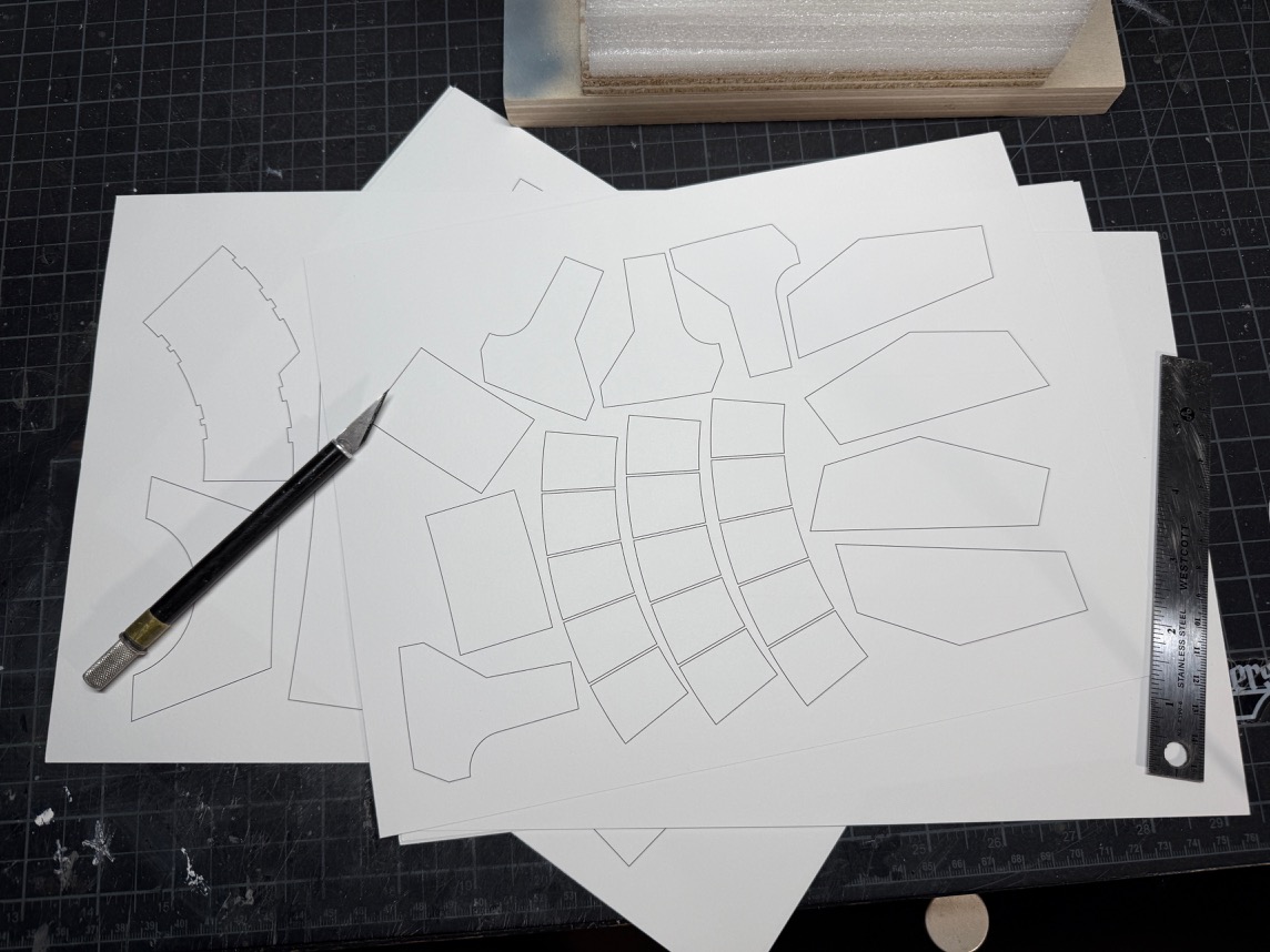

The plan is to use the exiting hull and I'll cut new panels for it while replacing as many parts as possible with original ones. I've already received some donor original parts from some of the great people over at the Nerf Herder's Facebook group.

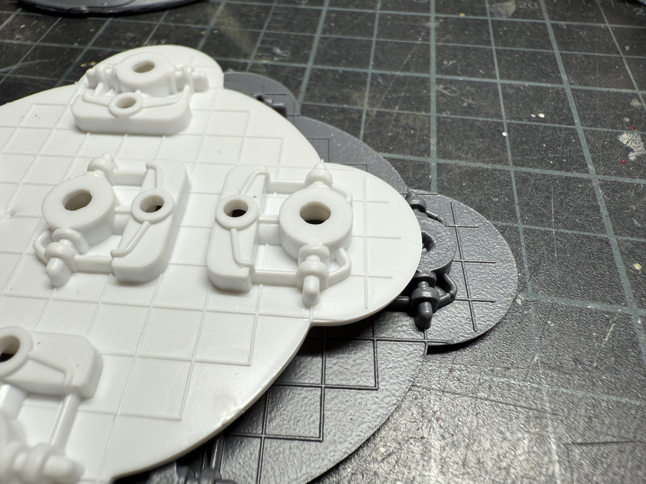

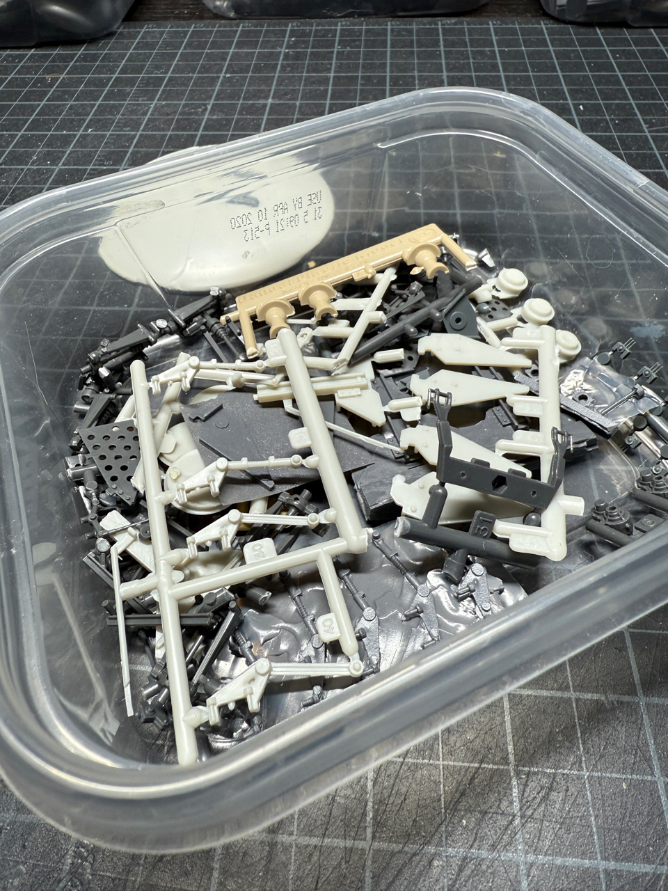

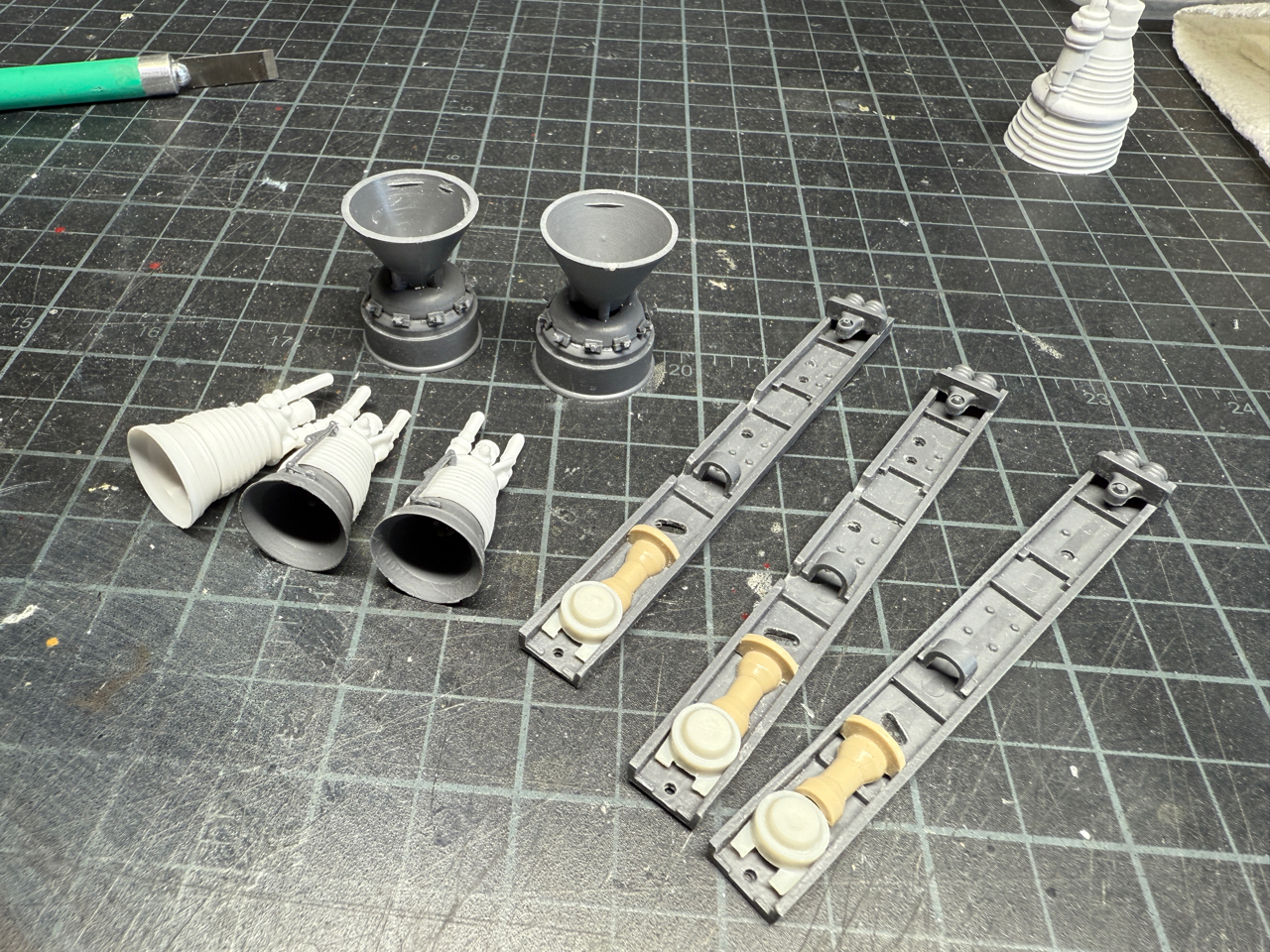

In the past week I've began going through the stash and snipping parts and gluing greeblies.

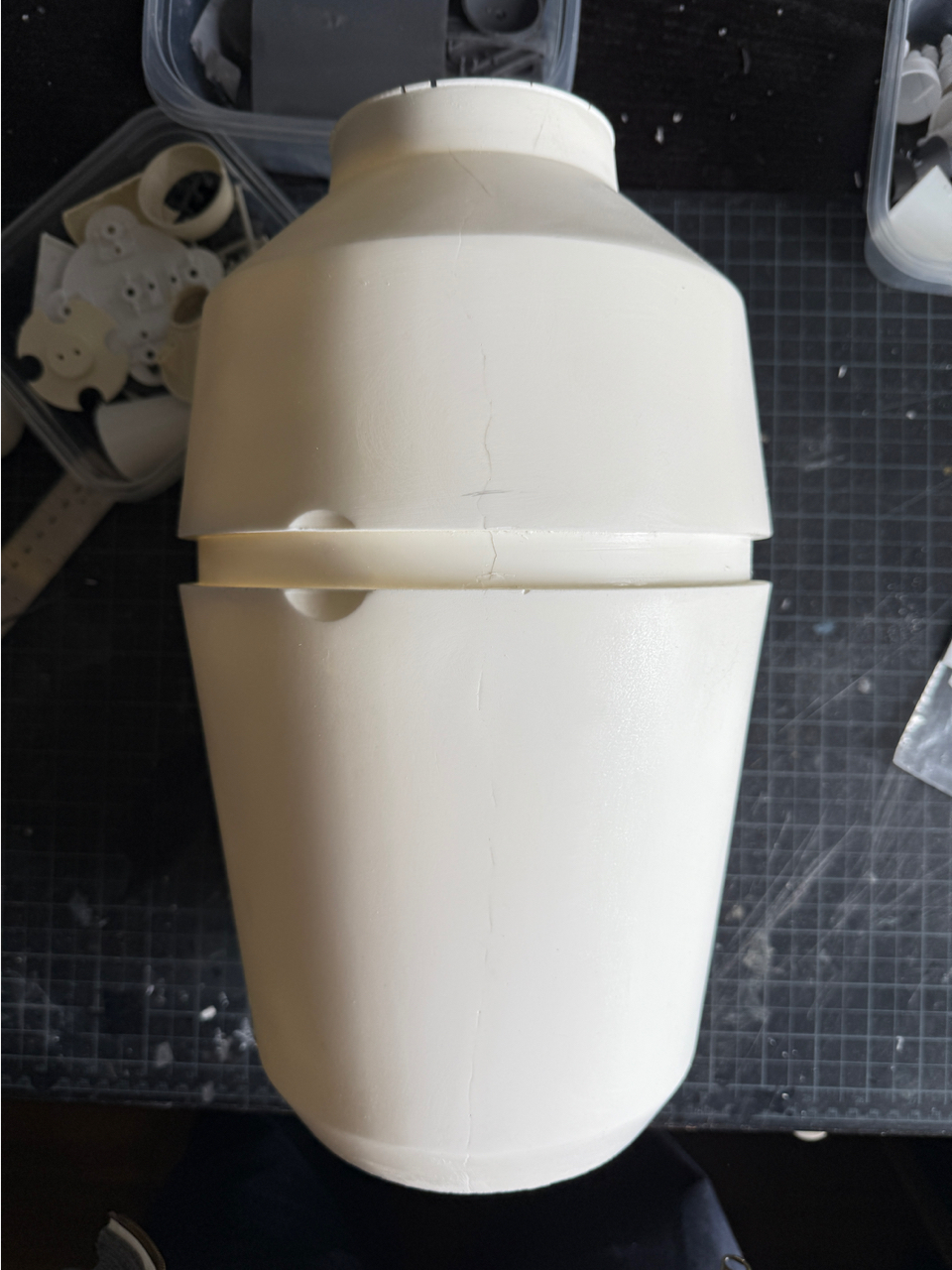

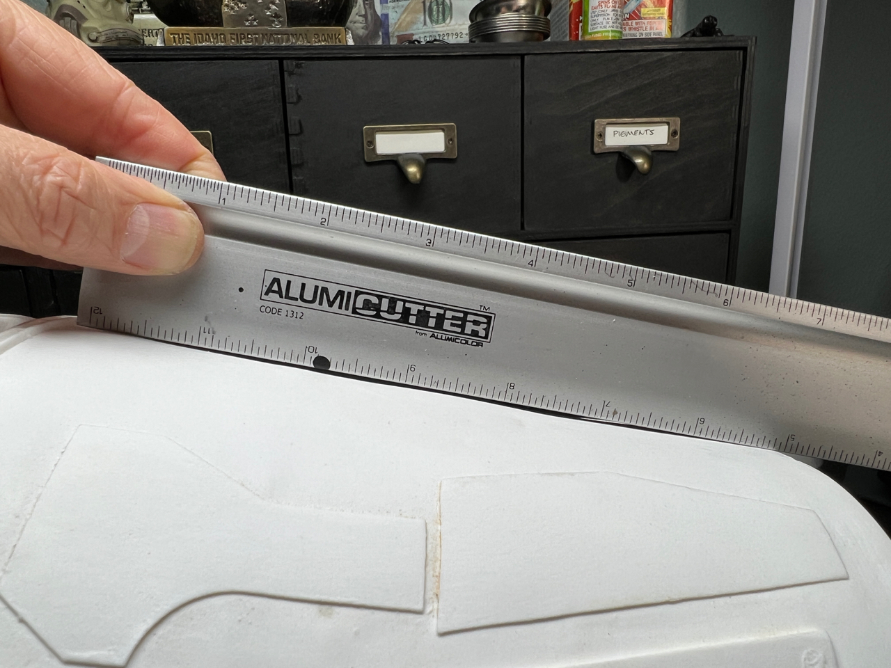

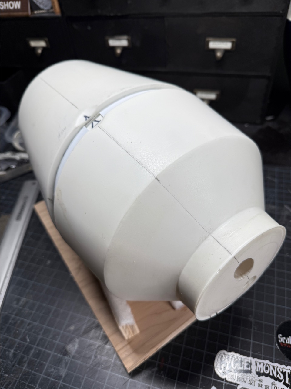

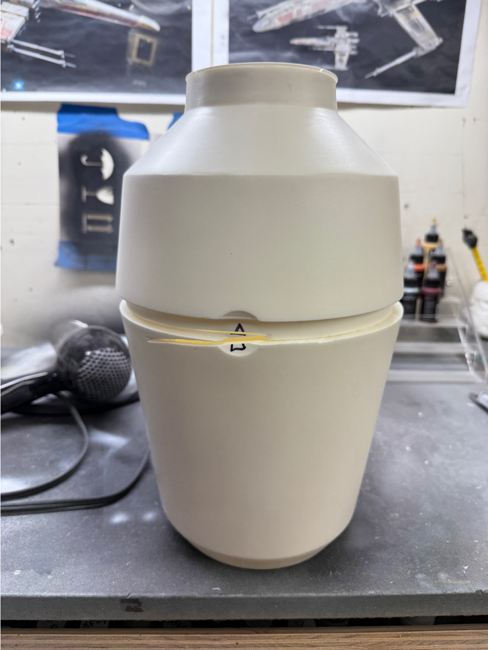

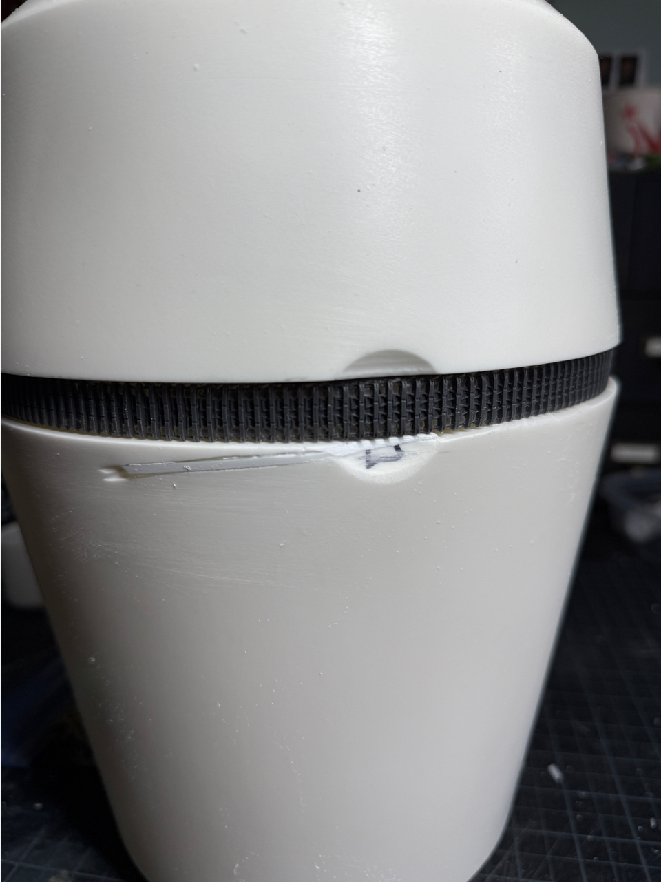

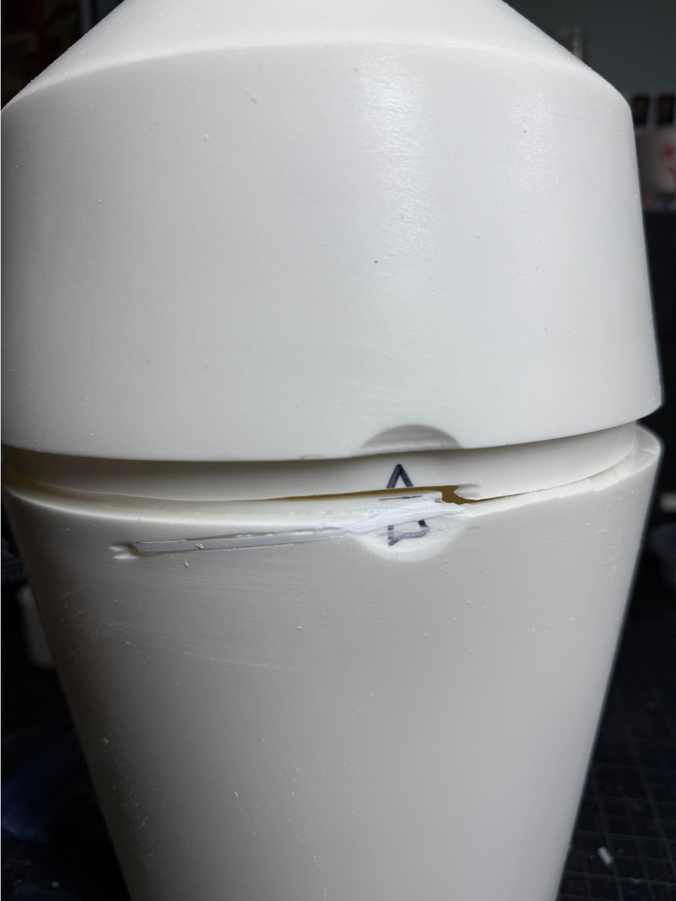

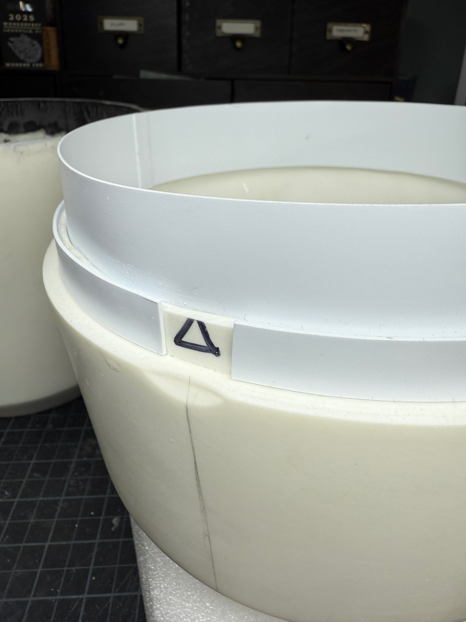

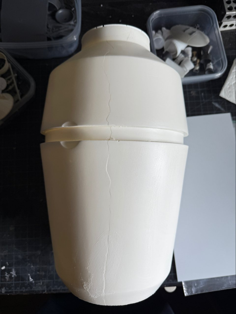

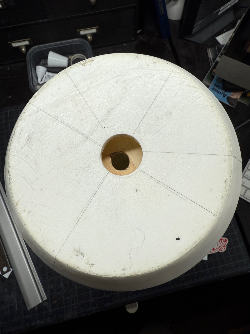

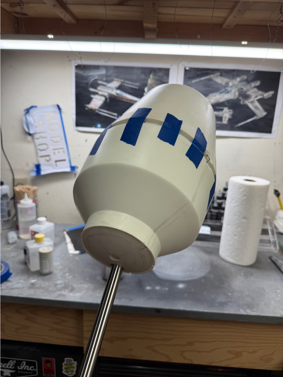

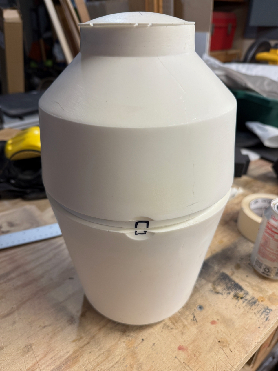

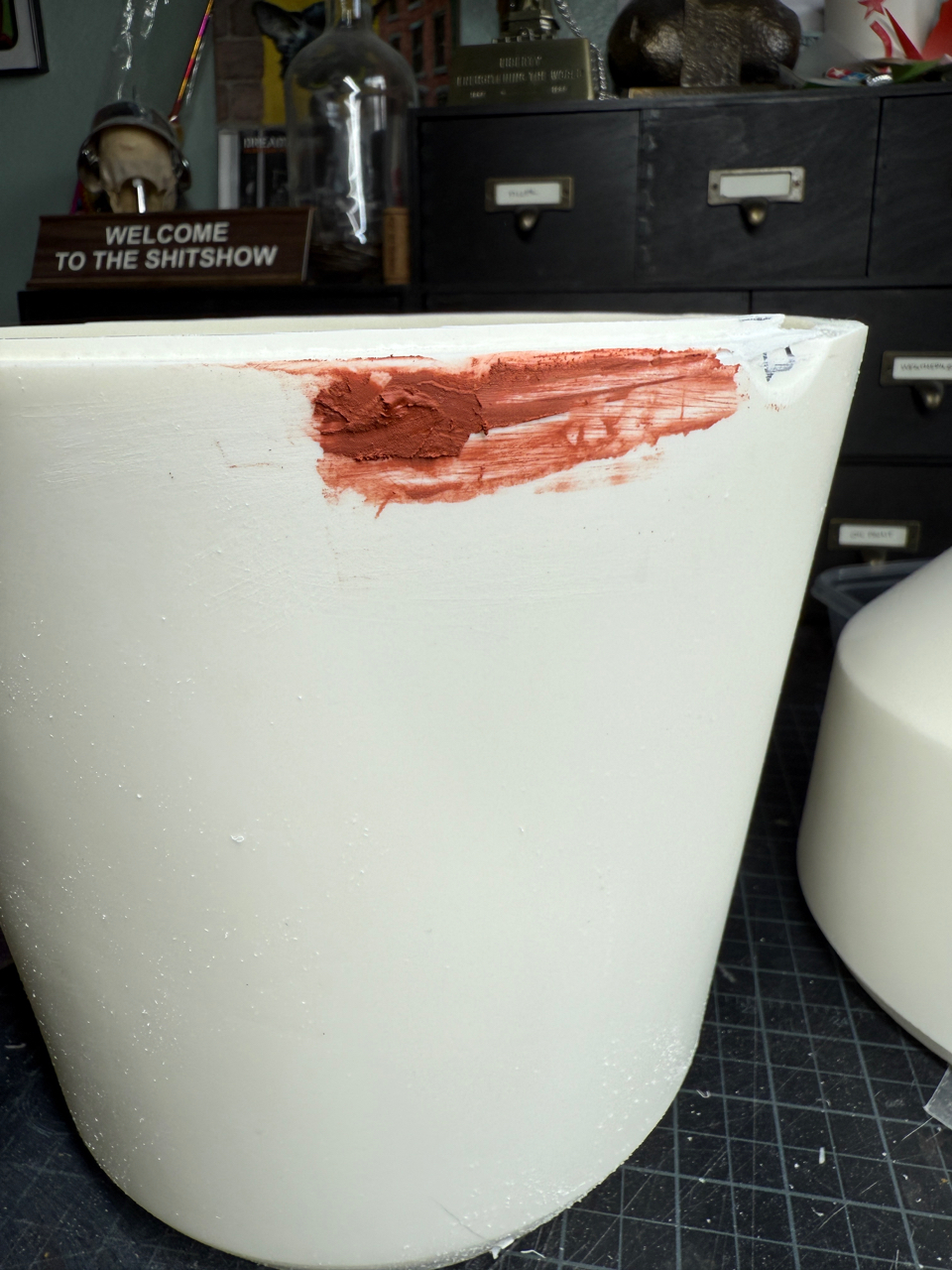

The body had a mold mark that ran the length of it so that was knocked down with some 150 sandpaper. That was enough to remove any edges that would be problematic in the future since the whole thing will be clad in .030 styrene plating. I also went over it with a chisel blade and removed any weird spots. The whole thing then got a once over with a 600 sanding sponge to give it some tooth for parts adhesion.

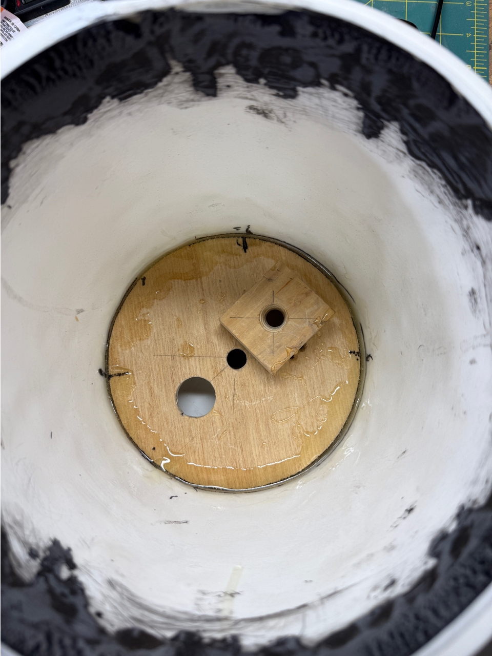

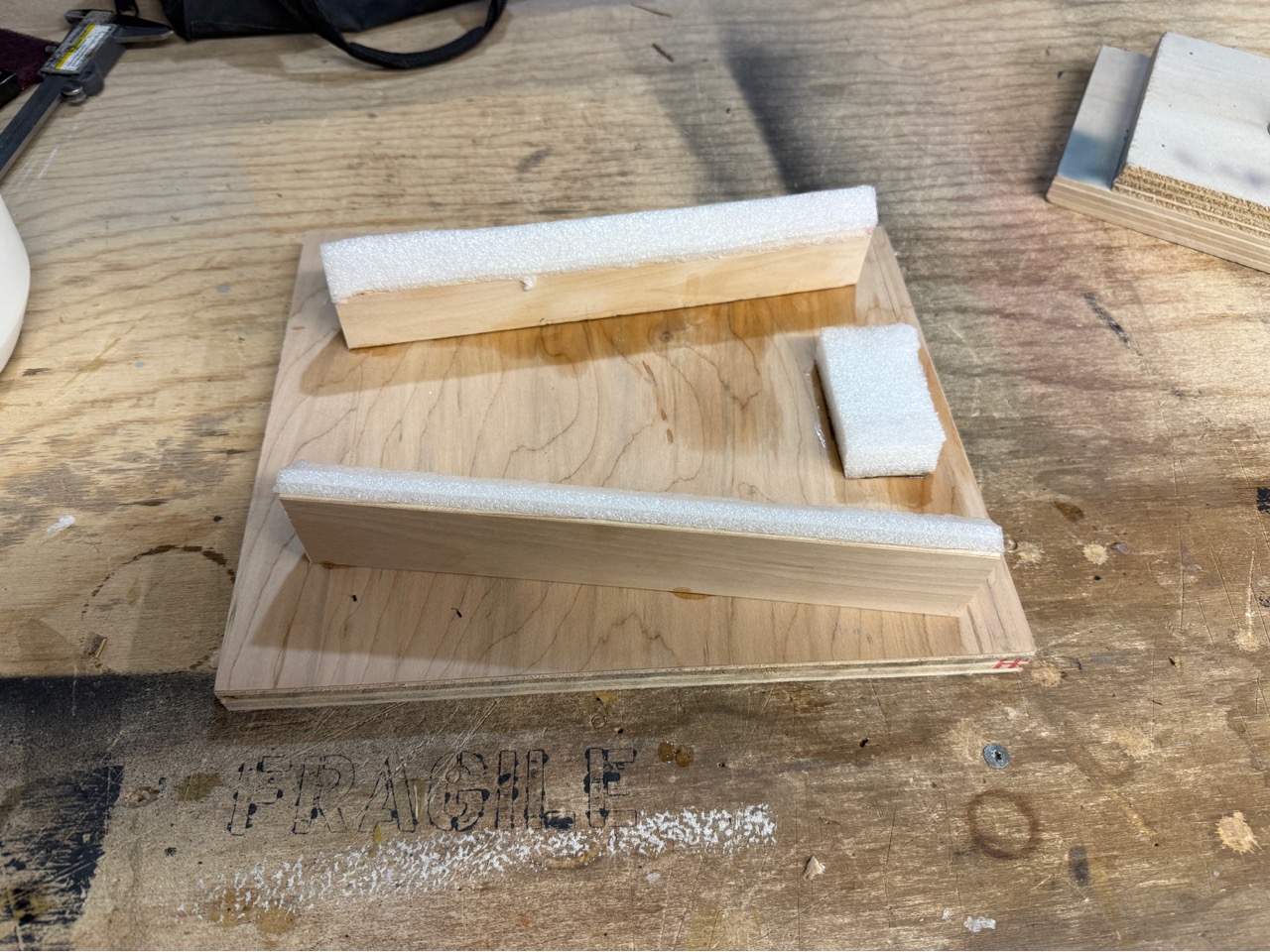

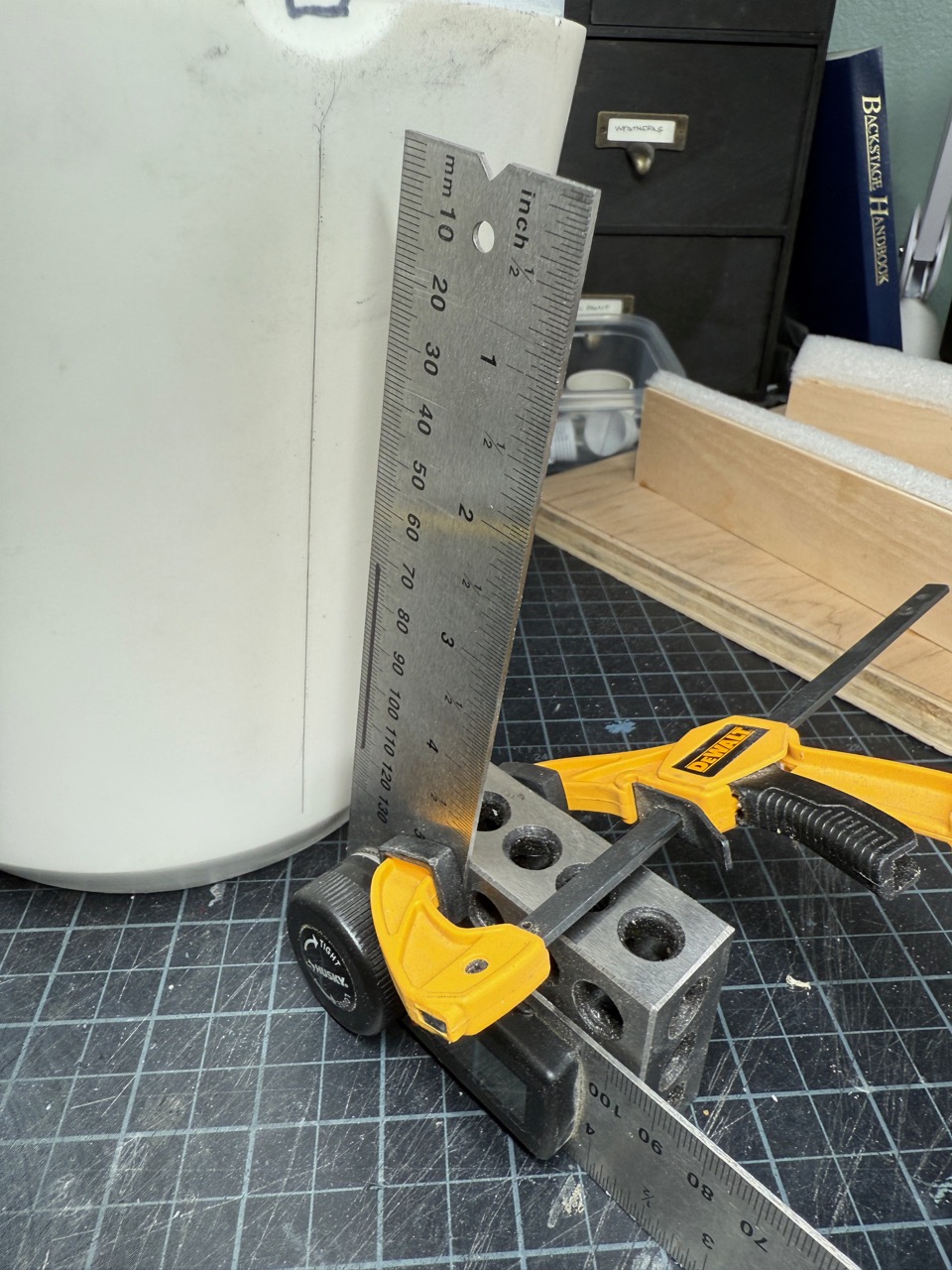

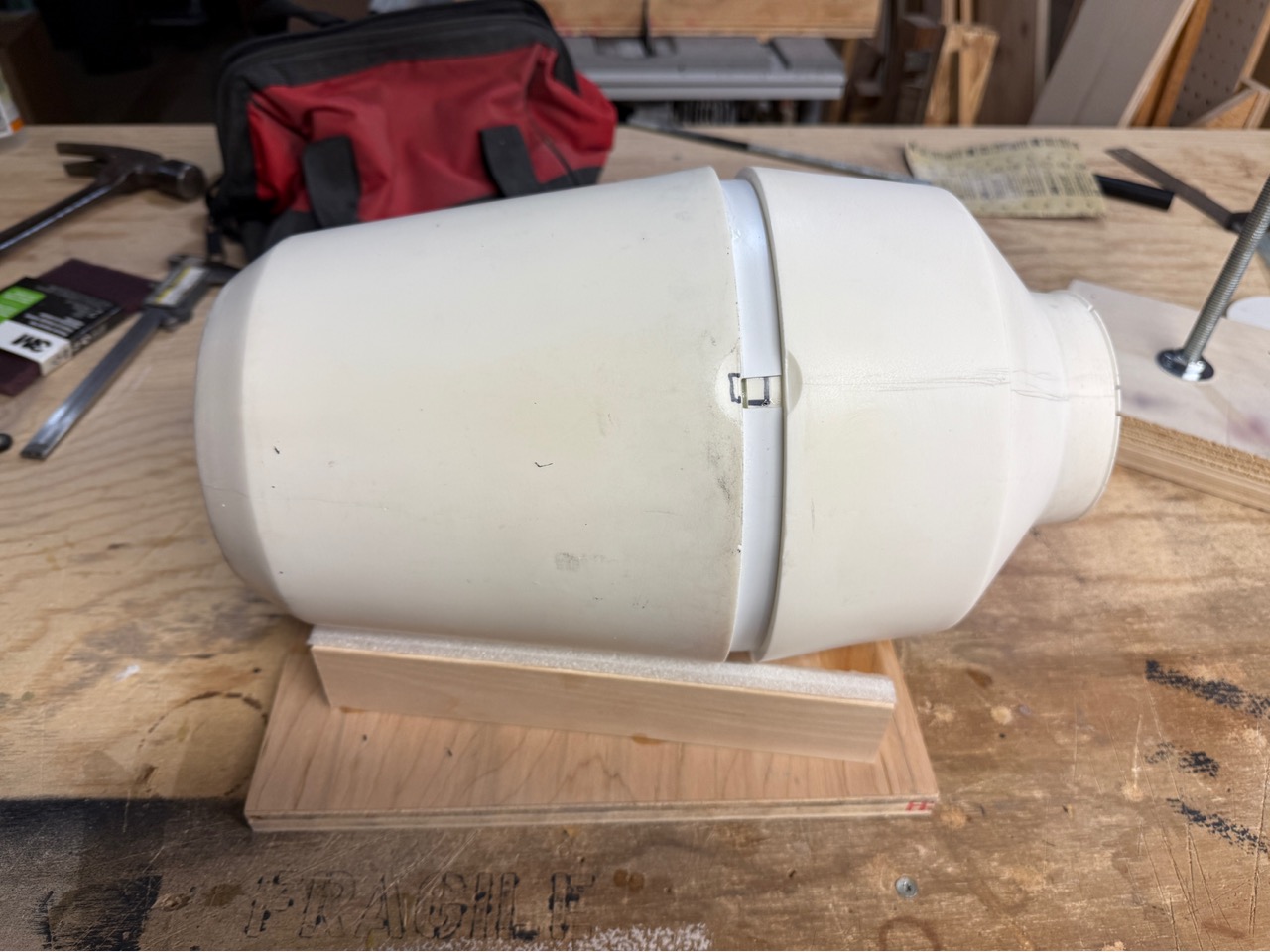

The next steps will be to build an armature for the inside. Nothing as elaborate as Vectorzero's but something out of plywood that will give it multiple mounting points.
