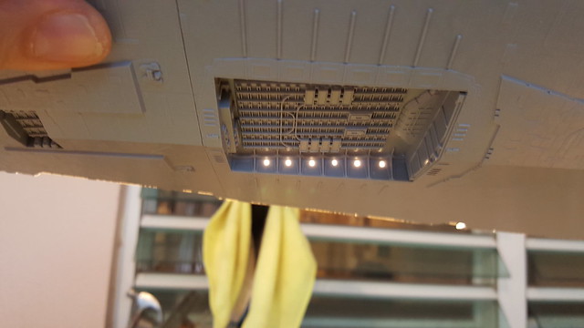

Hey Robiwon what are you planning for the underside bay? After looking at a few images I settled down on a series of 1.0mm lights (FO of course!) down each side. Took a bit of thinking and planning since I didnt want to ruin it and wait a whole month for a replacement from Russia! LOL!
20170131_181939 by Oscar Baez Soria, on Flickr
I still dont know if I would keep that section with an independent circuit or not. It would then have 3 circuits, one for the engines, one for the multiple little lights and one for the bay....
