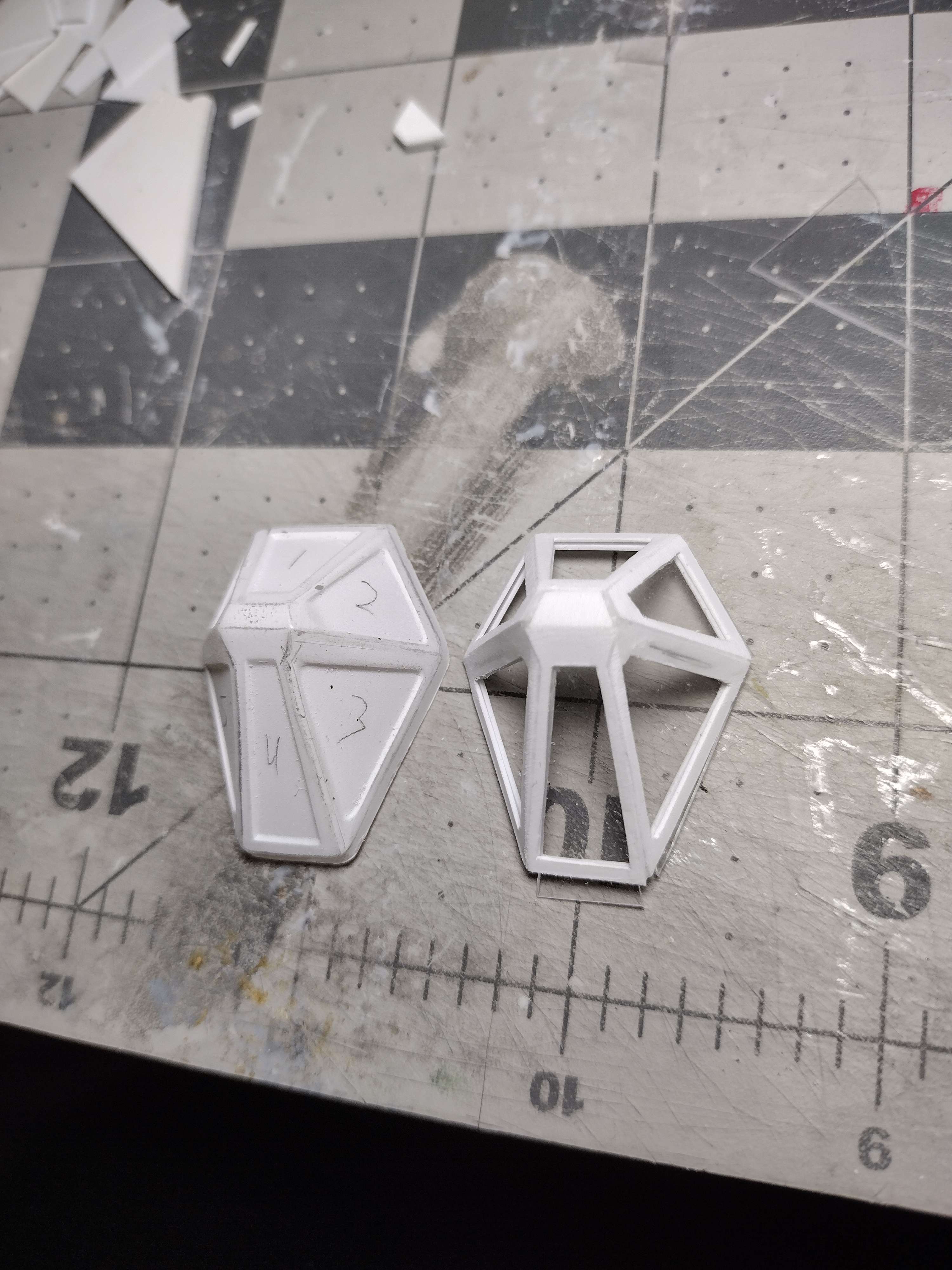

Anyway, I cast up a copy of the model, and then tried to vacuform the canopy. Well, that didn't turn out very well. I tried pulling it several times and each time the clear parts of the canopy were bumpy and not clear. I was running out of time and knew I could scratchbuild it faster than figuring out how to do better at vacuforming, so I just cut some .010 styrene using the kit canopy as a guide, being sure to layer the pieces so I could slide sections of clear styrene between them after painting.
