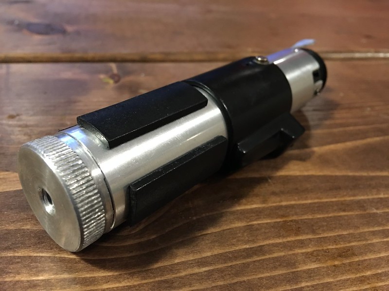

Nicely done Speed. the machining on the pommel looks great! how did you grab it when you lathed it? i am curious as i was thinking of doing the same to mine but because its externally threaded i couldn't see a good point to grab it on my lathe without messing up the threads.
There's a 1/4-20 hole going through it, right?
Just thread a bolt through, grab the bolt in the chuck and go to town.
Bingo. What Dann said. Whatever you do, take your time and ensure you don't get chatter like I did. Or your knurling will turn into gnarling like mine. You only get one shot when doing it.

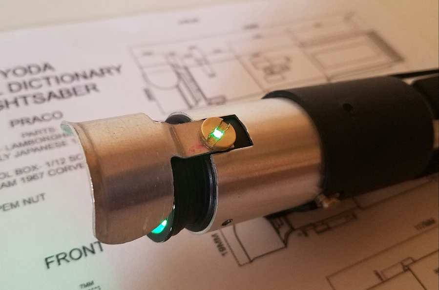

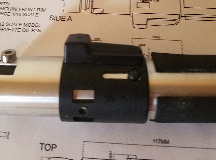

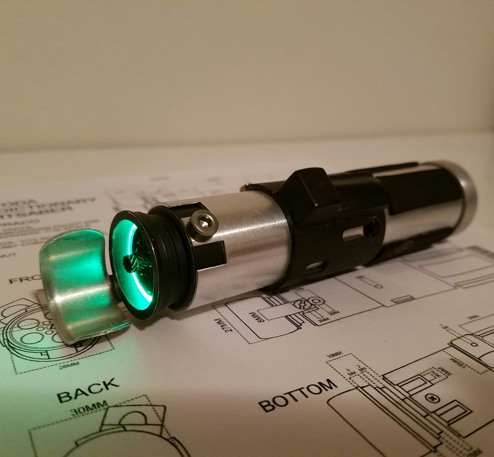

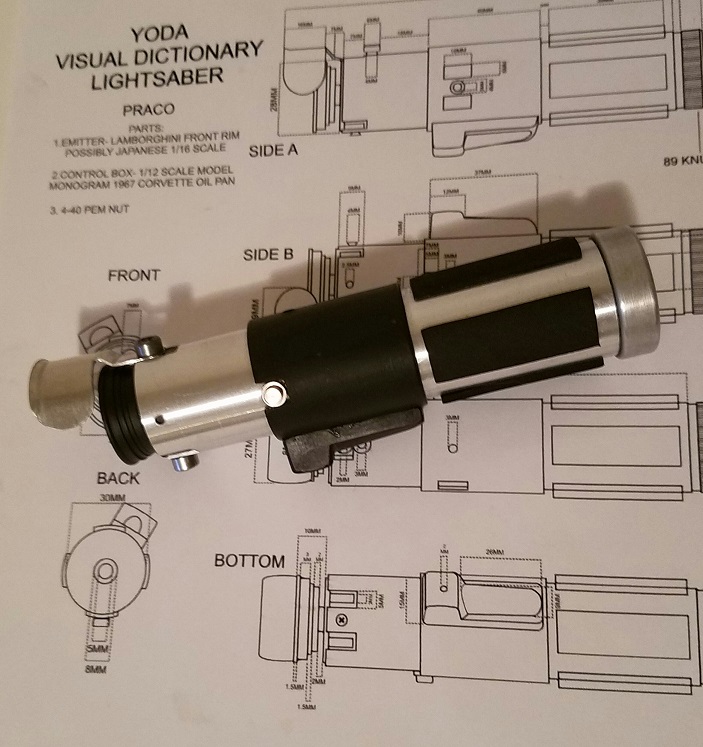

Sjanish was gracious enough to sell me an oil pan activation box that required a bit of work and did not make the cut for sale but i was more than happy to make repairs as needed. The part was amazing as is and really tied everything together. i decided to keep everything in line for ascetic reasons and for switch placement (see below).
i picked up the proper brass screw for the top and the last step is the PEX. i am not sure if/how i am going to install this one yet as i have electronics to deal with and not sure if i would be able to secure it properly. After that, the last step before i am happy is going to be to redo the grips and respray the activation ring. I might hold off on milling the pommel cap. I am pretty sure i could do it with what you have all told me but if i did mess up, finding a replacement would be damn hard (took me 2 years to find this Bolsey to begin with and i have a feeling the prices might go up as time goes on).

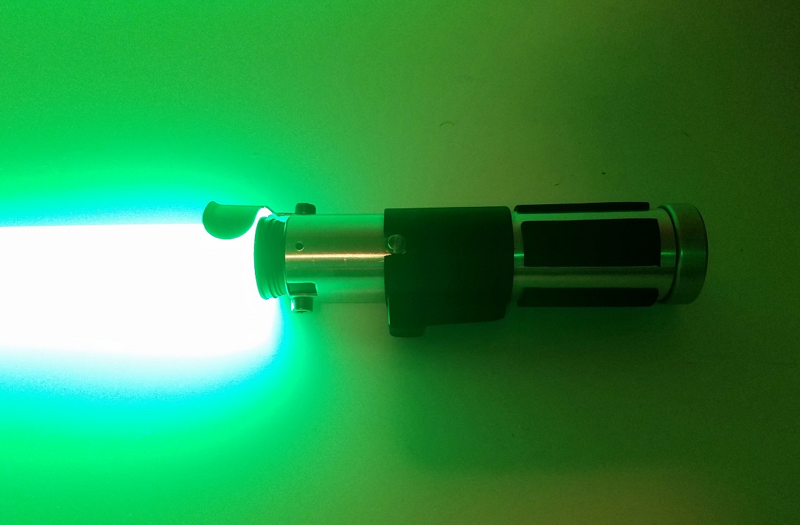

I know this isnt the correct forum or topic for electronic installs but i thought everyone might enjoy seeing a bolsey with some action! in case anyone was wondering, yes. you can fit a full sized 18650 3.7v battery, Tri Cree LED, heat sink, board, switch, recharge port, and speaker in this lil guy. its not easy at all but it will fit. For the switch, i used a pre existing hole and made a momentary switch cover from a 5mm led. i wanted to keep it as discrete as possible.
View attachment 700856View attachment 700857View attachment 700858View attachment 700859

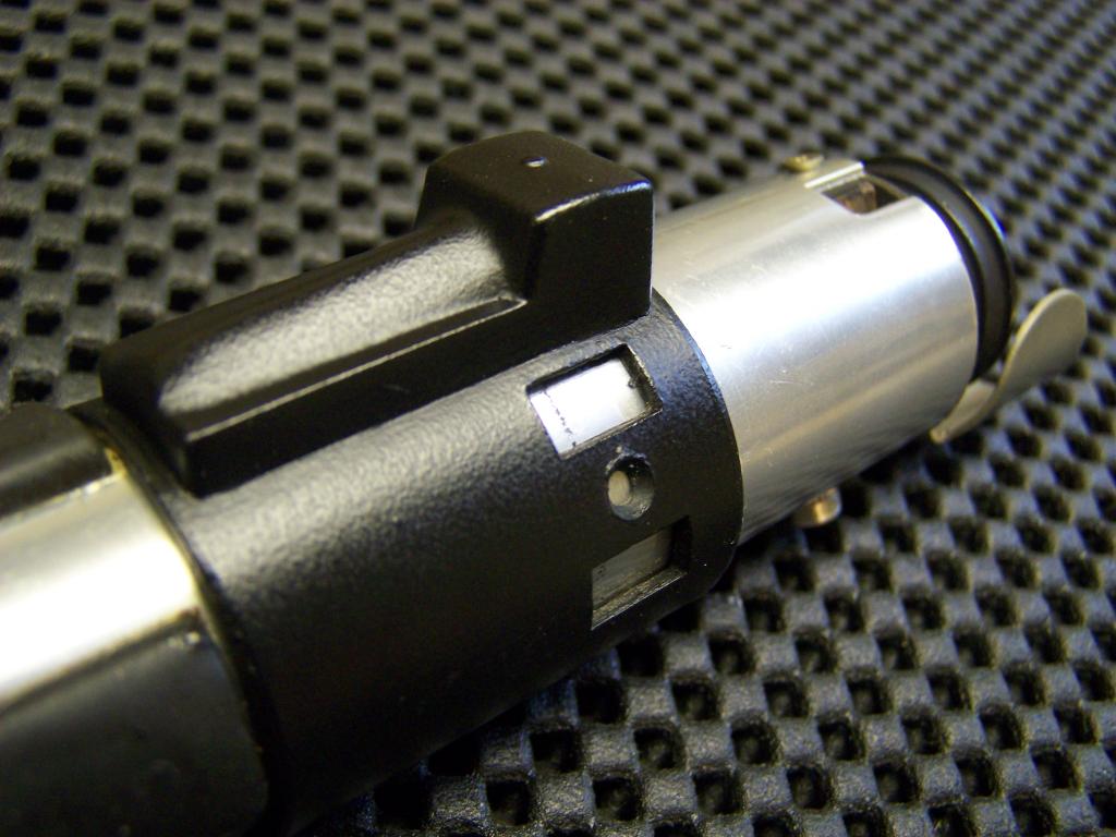

What type of paint did you use? I'm finally putting mine together and used a satin black spray paint, but I feel it came out too shiny...
Now looking at yours, it doesn't look to bad.... I assume that's satin?
Or....?
Anyone think they know what was on the original?
Or....?
I used Krylon satin black on mine, but I would say that their "satin" seems a bit too glossy - I just used some on a ROTJ Hero but stripped it off and went with flat black instead.
Here's the original for reference:
I guess that could be a satin. I'm not sure if it's just the application, but it *almost* looks like one of those hammered finish paints.
Agreed. I'll have to pick up a different satin and try again (my can broke halfway through the job anyway, so need a new one)
Flat just seems wrong. But if this doesn't work, I may just spray flat and put on a semi gloss clear coat or something.

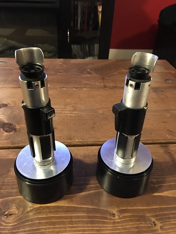

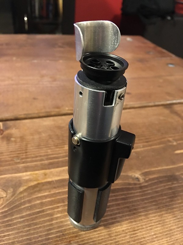

Here is my finished Yoda on a Praco... correct wheel...
And here his is with his ugly scratch built twin with incorrect lambo wheel
