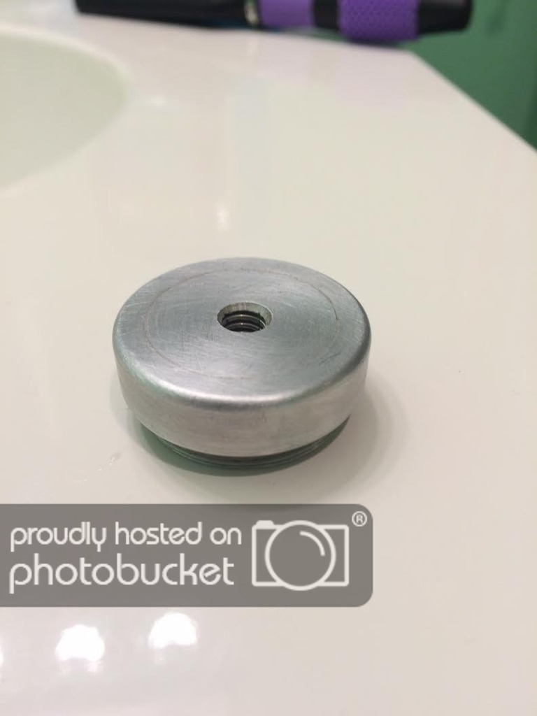

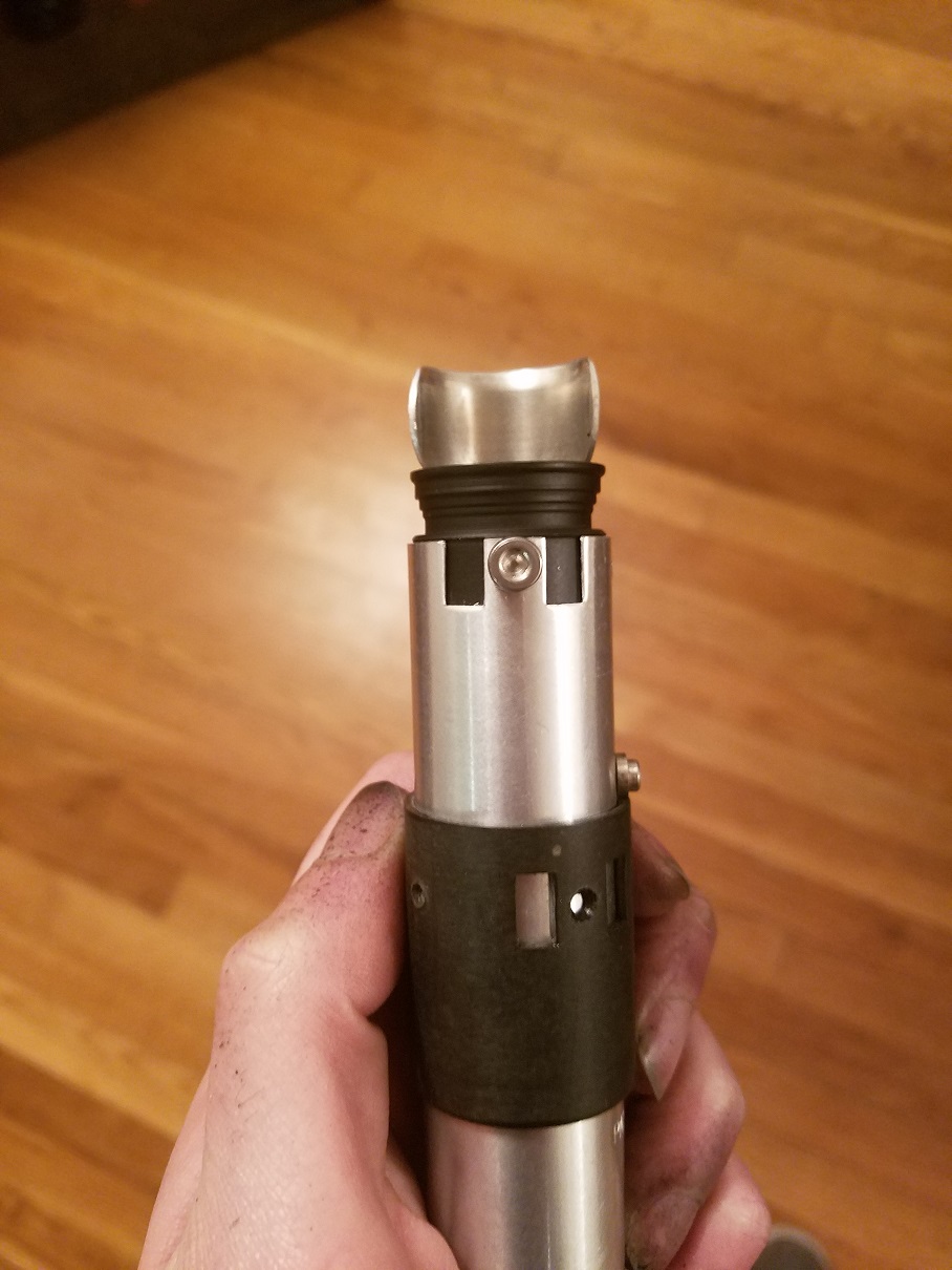

heres my cap
heres my anodize removal
I did cut down one of the oversized black anodized endcaps on the little lathe, it's not knurled, but it's the right diameter, for what it's worth. I don't have a big enough knurling tool for my tiny lathe to press the knurls into it!!
Up to you. You don't need but a few threads poking out to thread the PEM nut on.

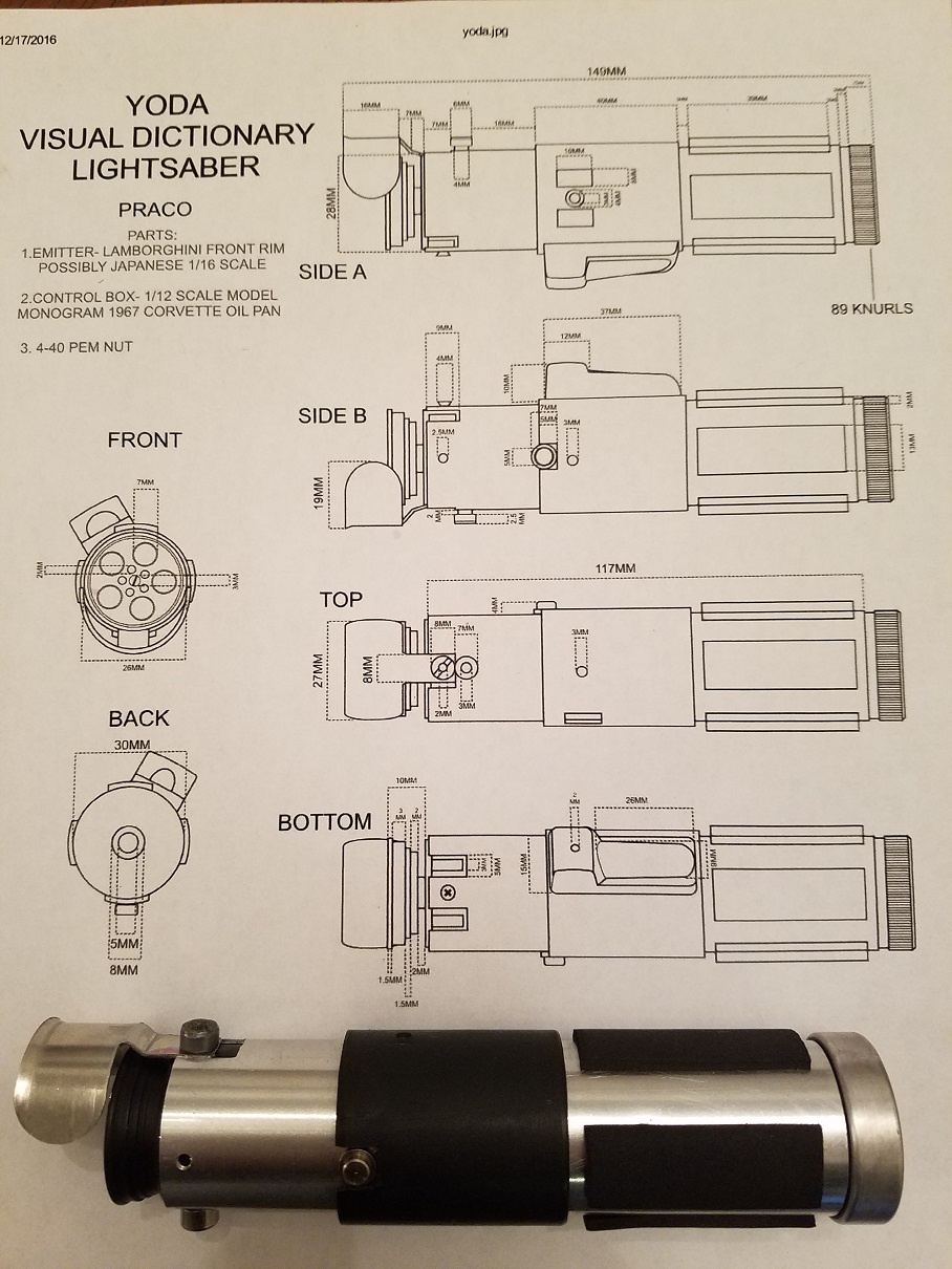

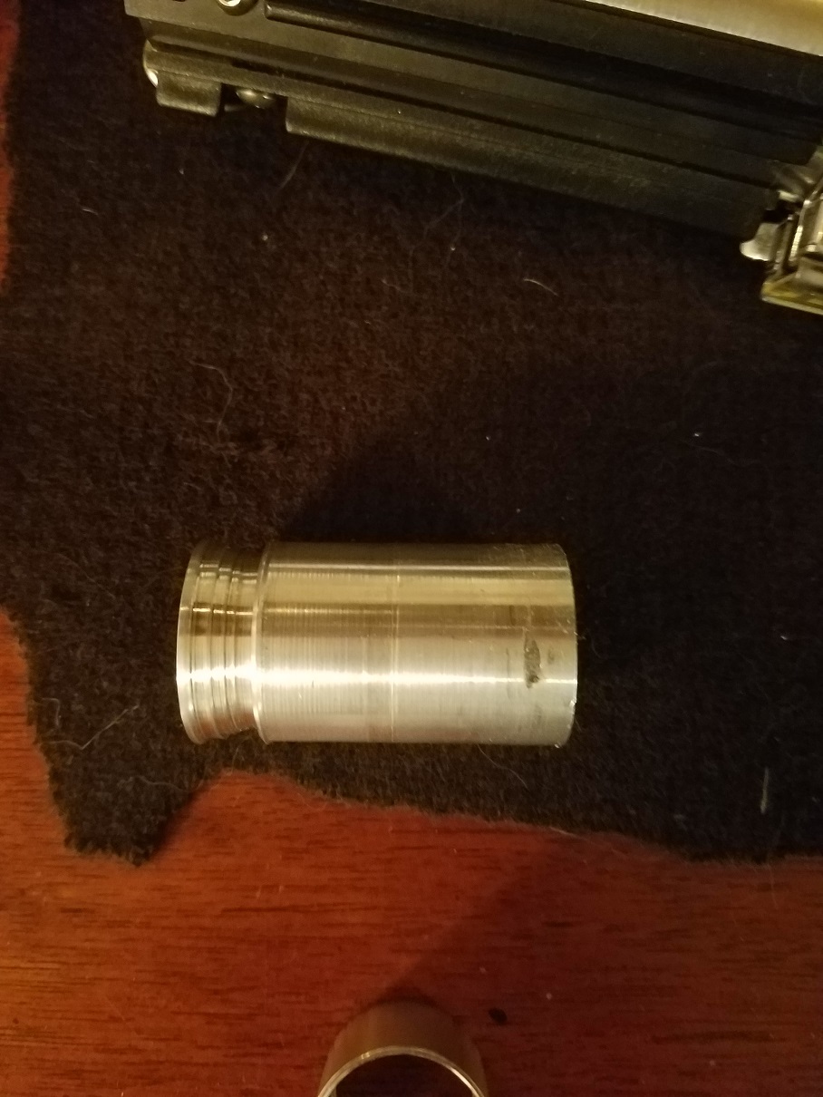

The i was able to get the paint off the pomel easily using oven cleaner, however, i noticed that the button on the side was flipped from the praco version (not sure if they are all like this). The other thing i realized is that i wanted to make mine functional (because i am a glutton for punishment), so using the dimensions given in this thread for the lambo wheel, i machined a blade holder to the exact specs with a lip that will not allow it to slide down the flash tube.
Little coat of paint and im pretty happy with how it turned out!
ive seen many ways you all are making grips but i was trying to find the best and fastest way for my build to keep cost down. i was able to find 2mm black foam with adhesive backing at my local arts supply store that seems to fit the bill and only cost a dollar (you can see in the below picture how the side button is flipped from the Praco).
I still need to get the proper set screws for the top, the oil pan activation box and fit the electronics but reading this thread has really saved me soooo much headache thus far so thank you all for the info and keep in coming!
-Sho
Thanks Neo for easing my worries on the Bolsey being mirrored. That was messing with my mind when i got it and was too eager to go through the pages to see if it had been addressed. i just went with it. haha. and i feel you on the wait on parts as well. I made the emitter to pressure fit into a .875" heat sink but everyone is out of stock so im stalled as far as progress is concerned :cry.

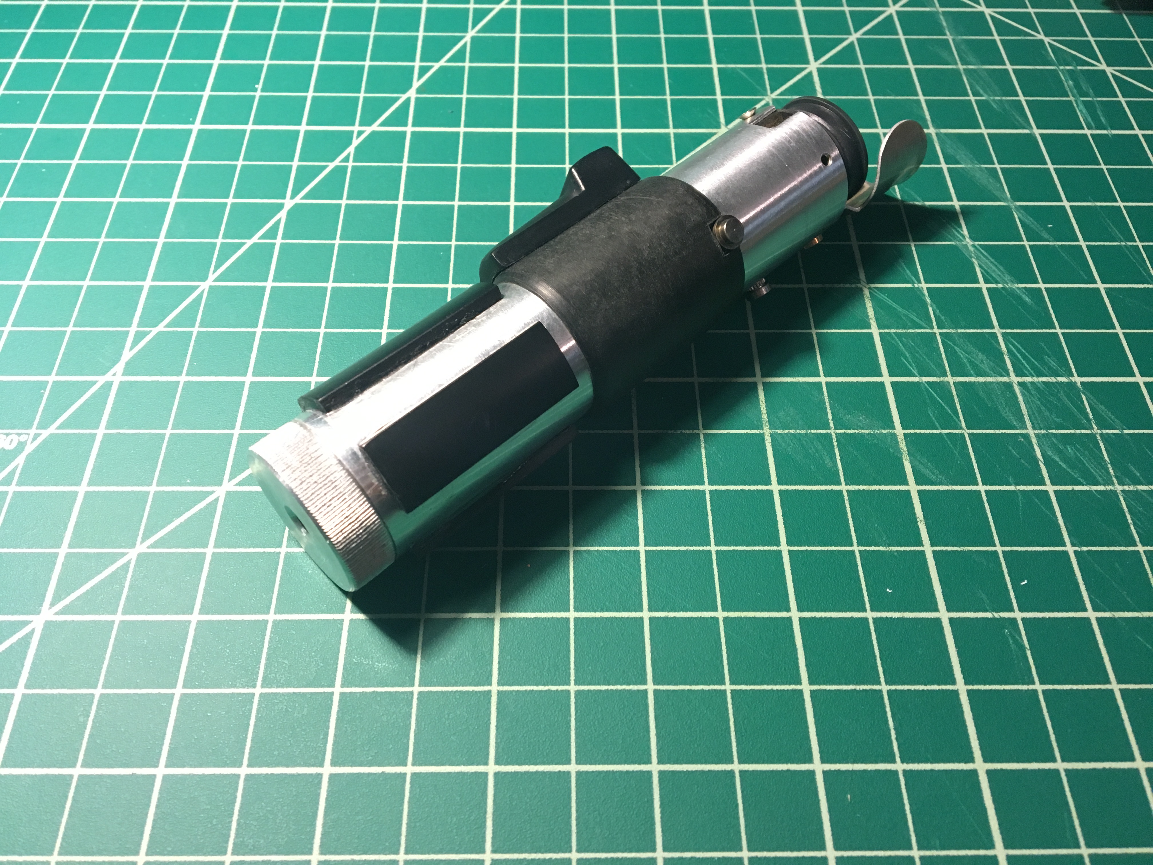

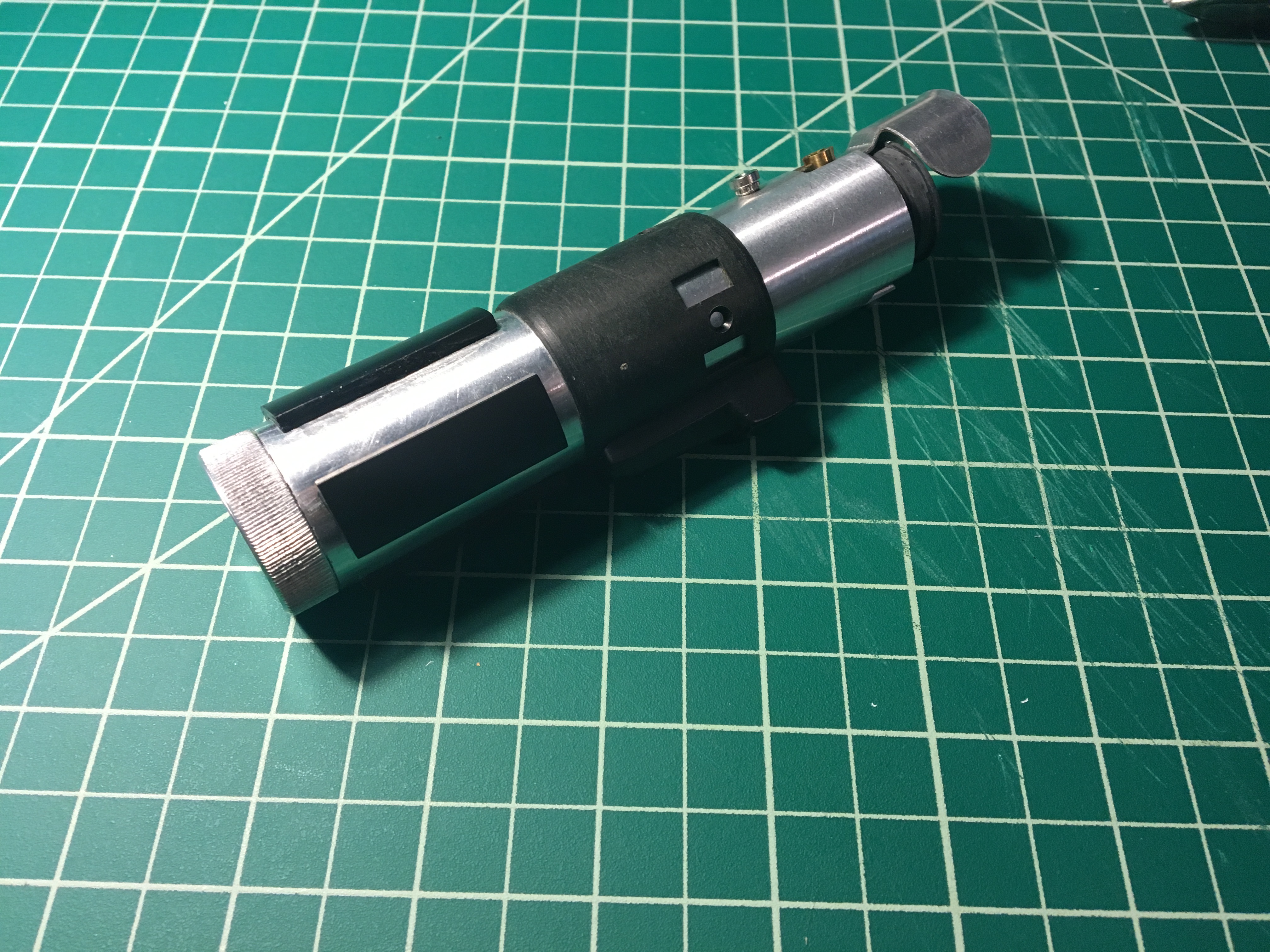

I recently realized I never showed my completed Yoda VD Saber from last year, so here it is:
Notes:
1) The PEM nut is too low. I measured twice and drilled once, but measuring from the wrong location does no good. Oh well, it's just a Bosley.
2) The end cap knurl is messed up. I machined down the black anodizing and added the knurl. But the cap chattered during knurling, so it ended up a bit "gnarly"...
3) I'm also currently using the Lambo emitter that I recreated in 3D and had printed. I'll save the real wheel for a real Praco one day. (If I'd ever be so lucky)

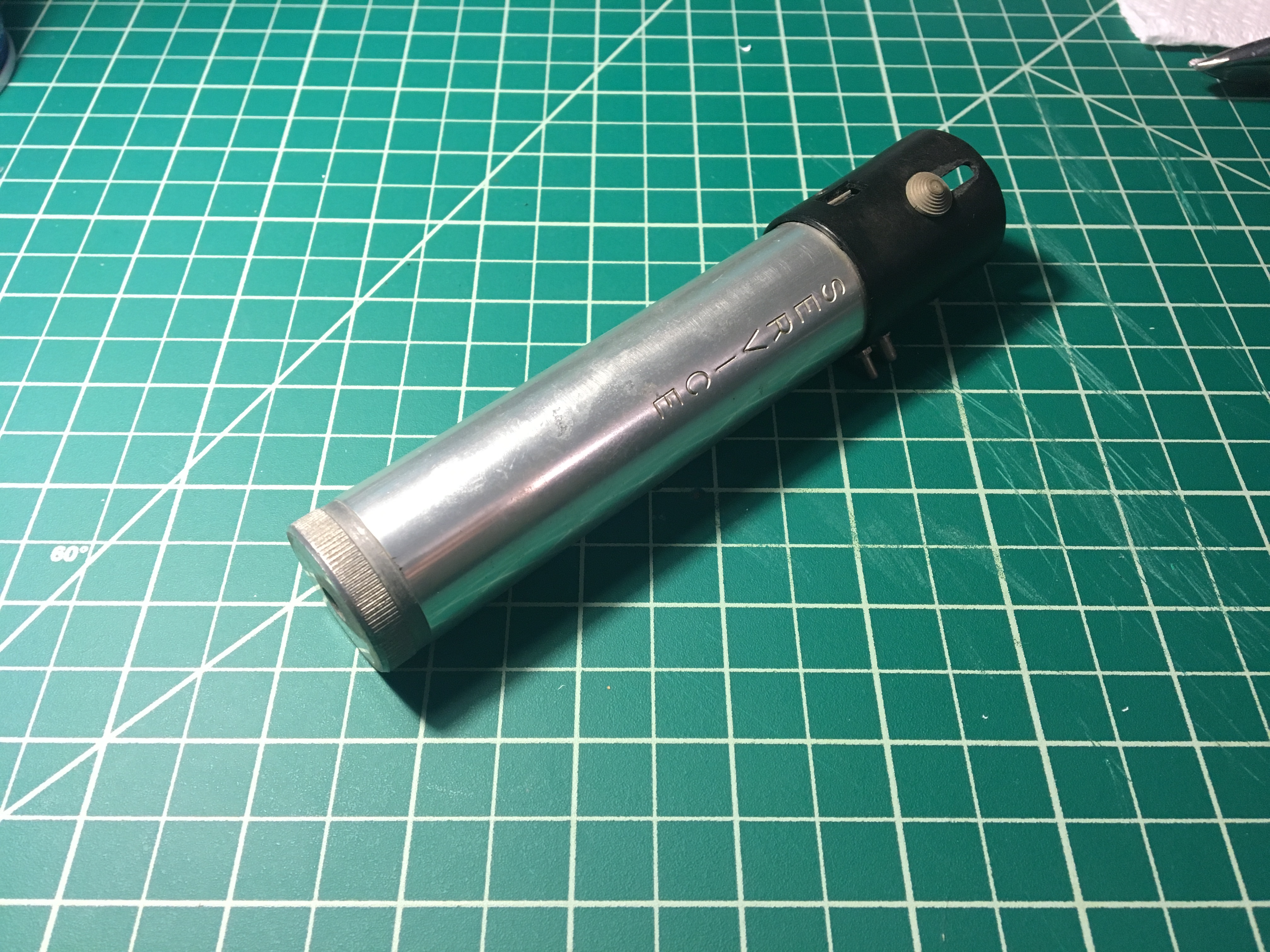

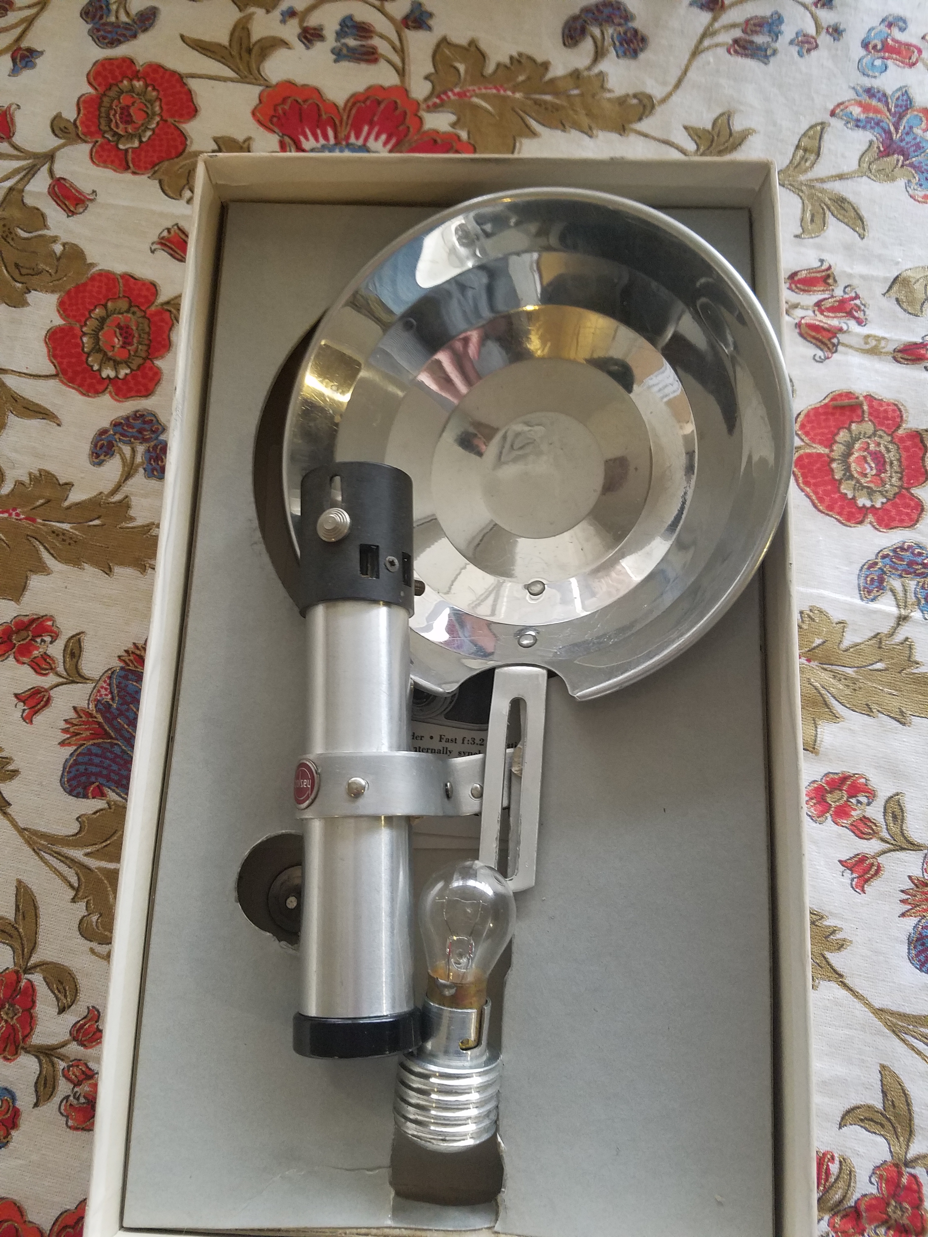

And then there's the Service Flash I recently acquired. So close to the Bosley and Praco, but not quite...
Notes:
View attachment 698031View attachment 698032
looks spectacular. the whole point of a prop is that it looks good from 5 feet away. Yours looks good from at least 2 inches!
Nicely done Speed. the machining on the pommel looks great! how did you grab it when you lathed it? i am curious as i was thinking of doing the same to mine but because its externally threaded i couldn't see a good point to grab it on my lathe without messing up the threads.
