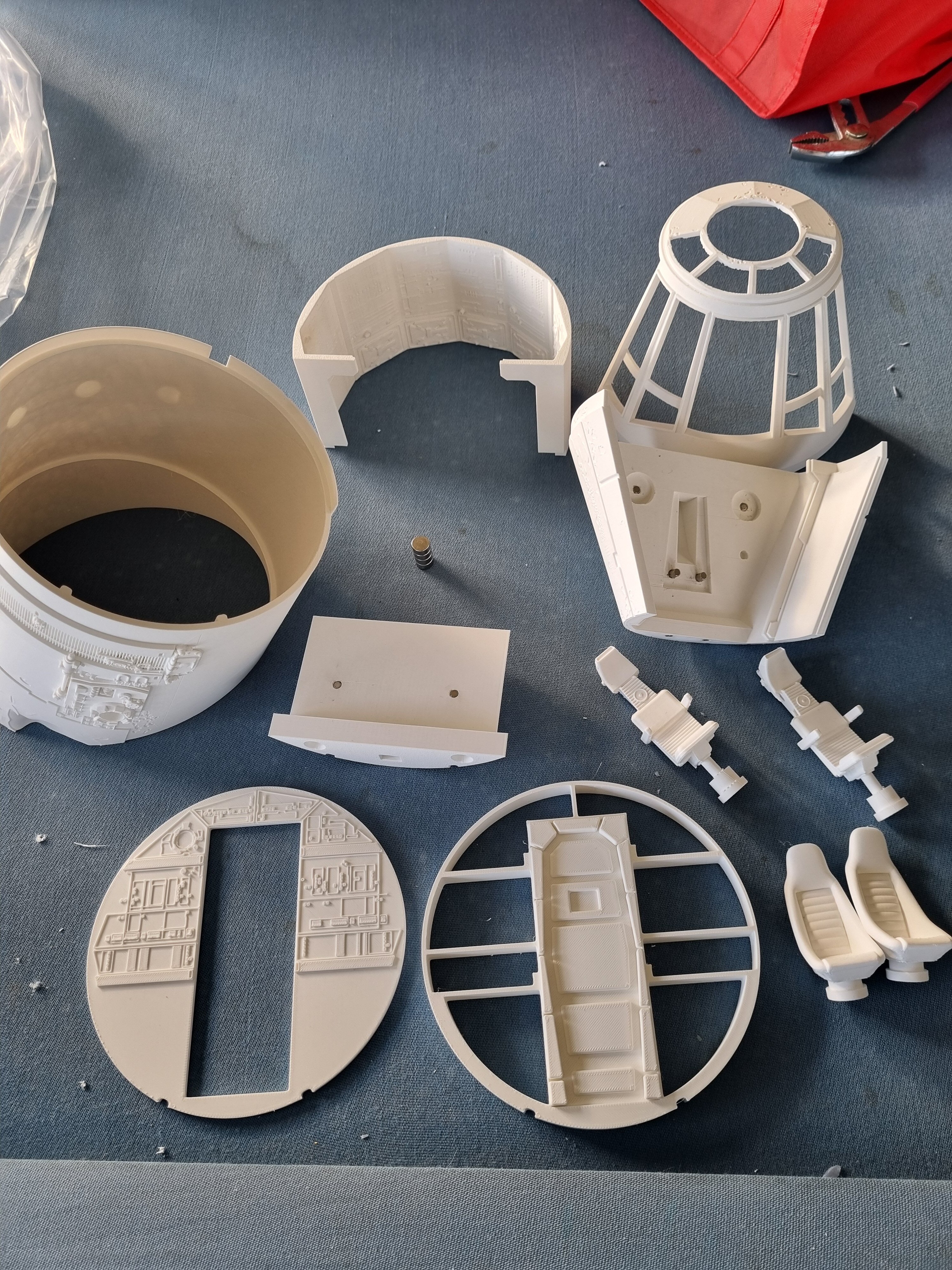

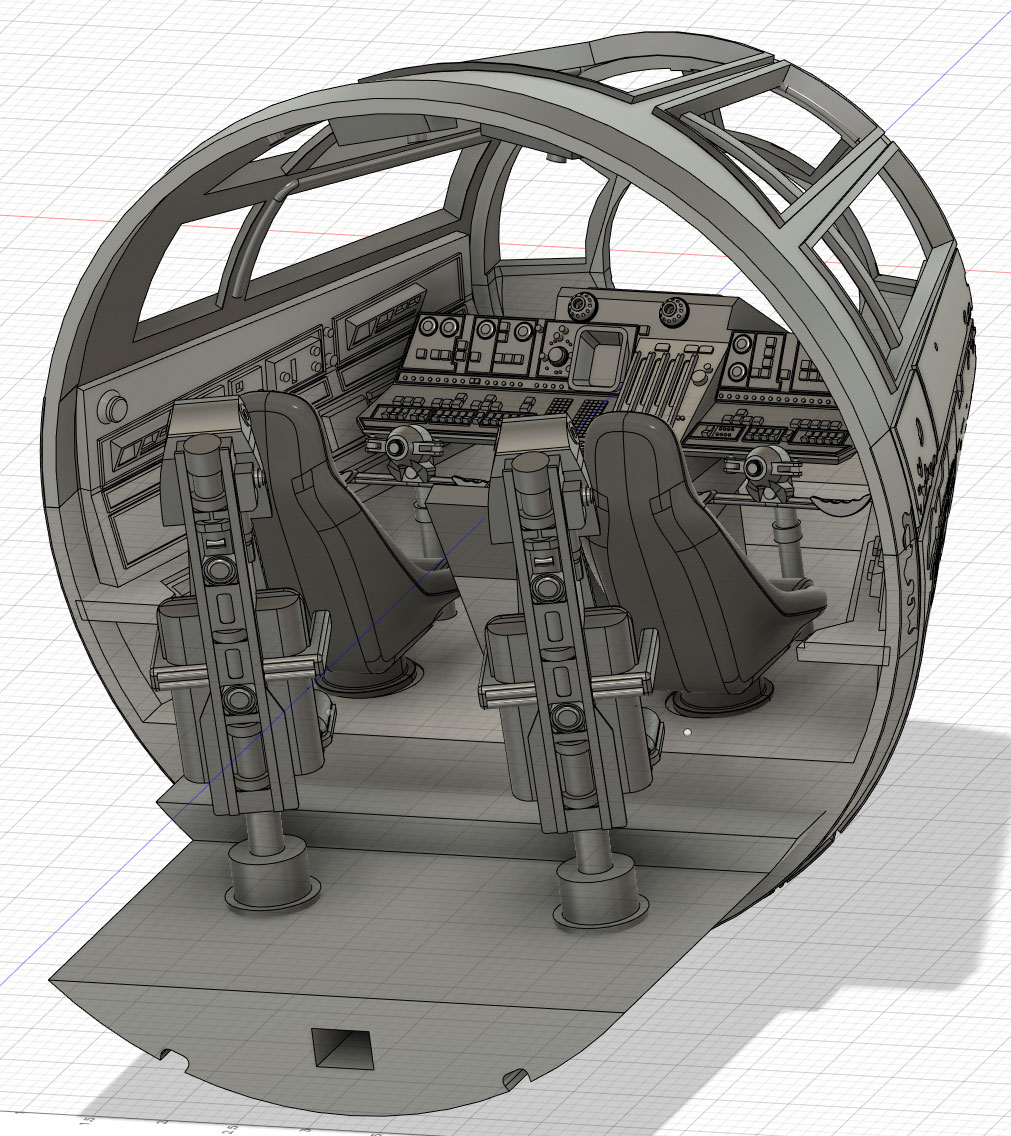

Nearly there - I have broken the main components down for printing and have some nice looking prints off so far.
Ill post those picks soon.
Really only main part is the detailing on the edges of the grid. The good old Panther G Bandai.

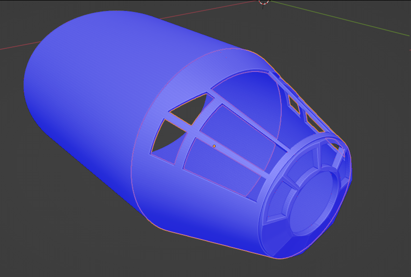

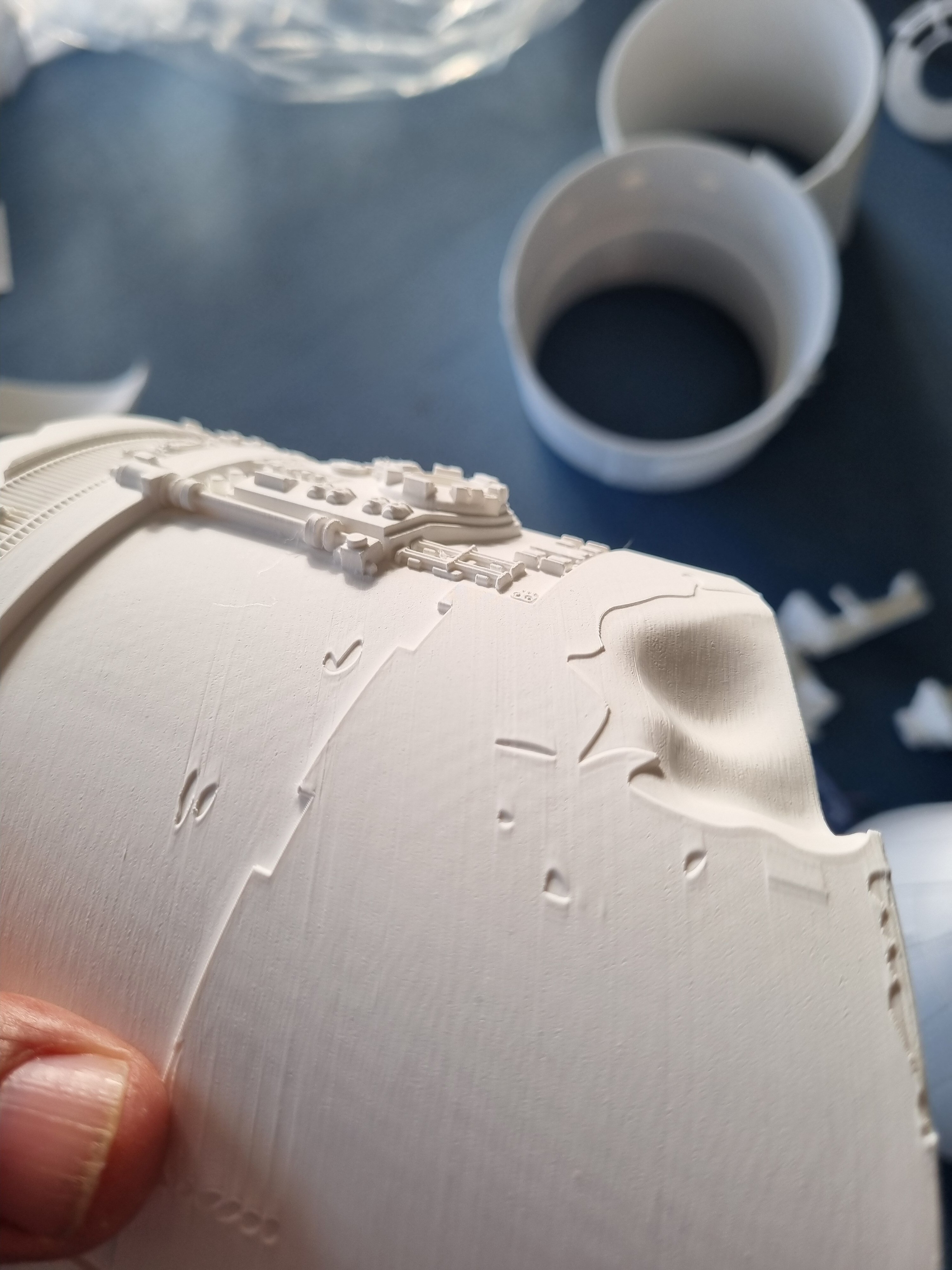

The Damage was a little tricky - due to the complexity of the damage shapes, they came out looking a little nasty when exported to my Slicer. Solved this by making sections a lot smaller - so you will see some lines in the picture that don't actually print, but are just there to compensate for this. It does look really nice in the prints.

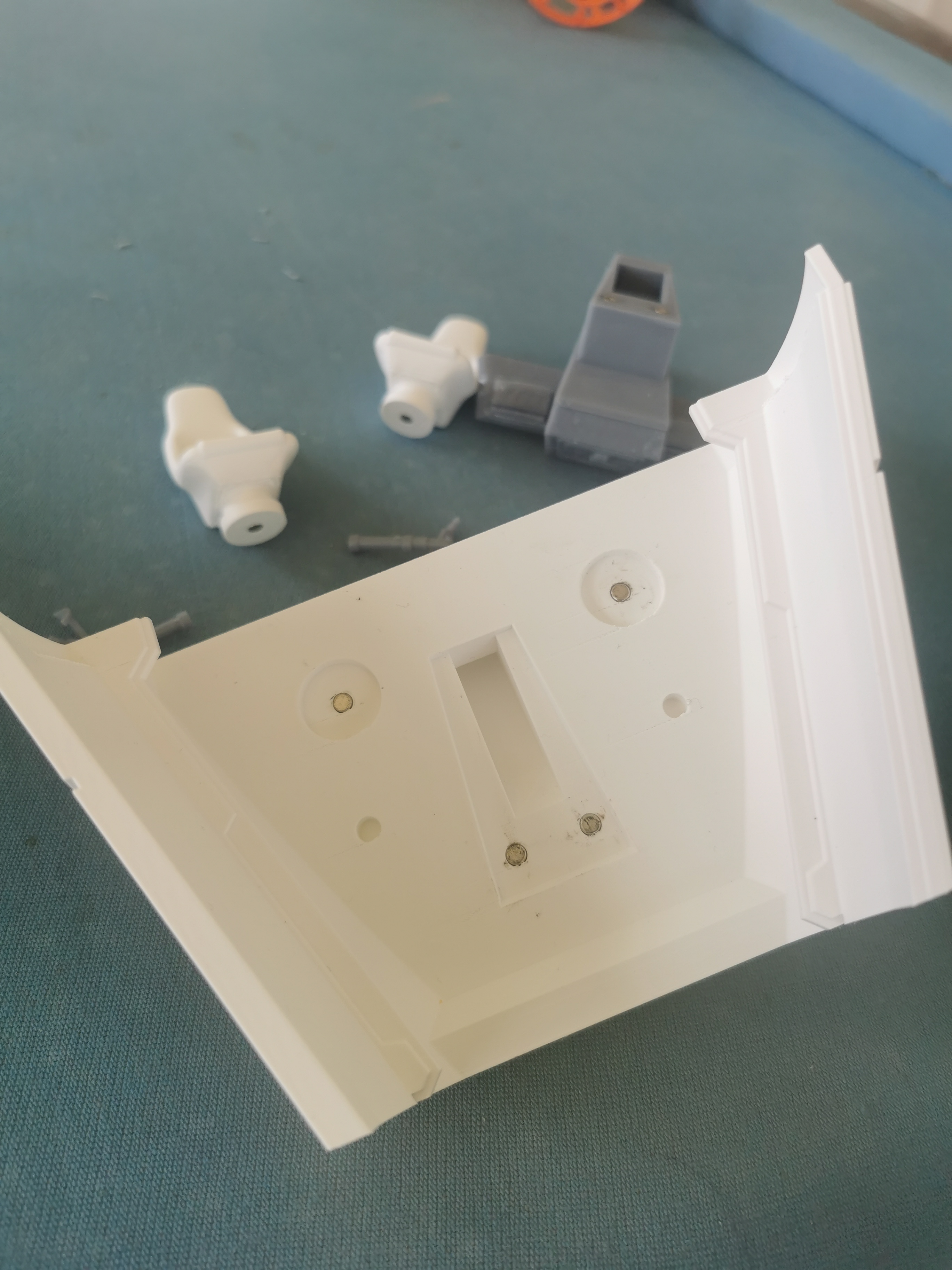

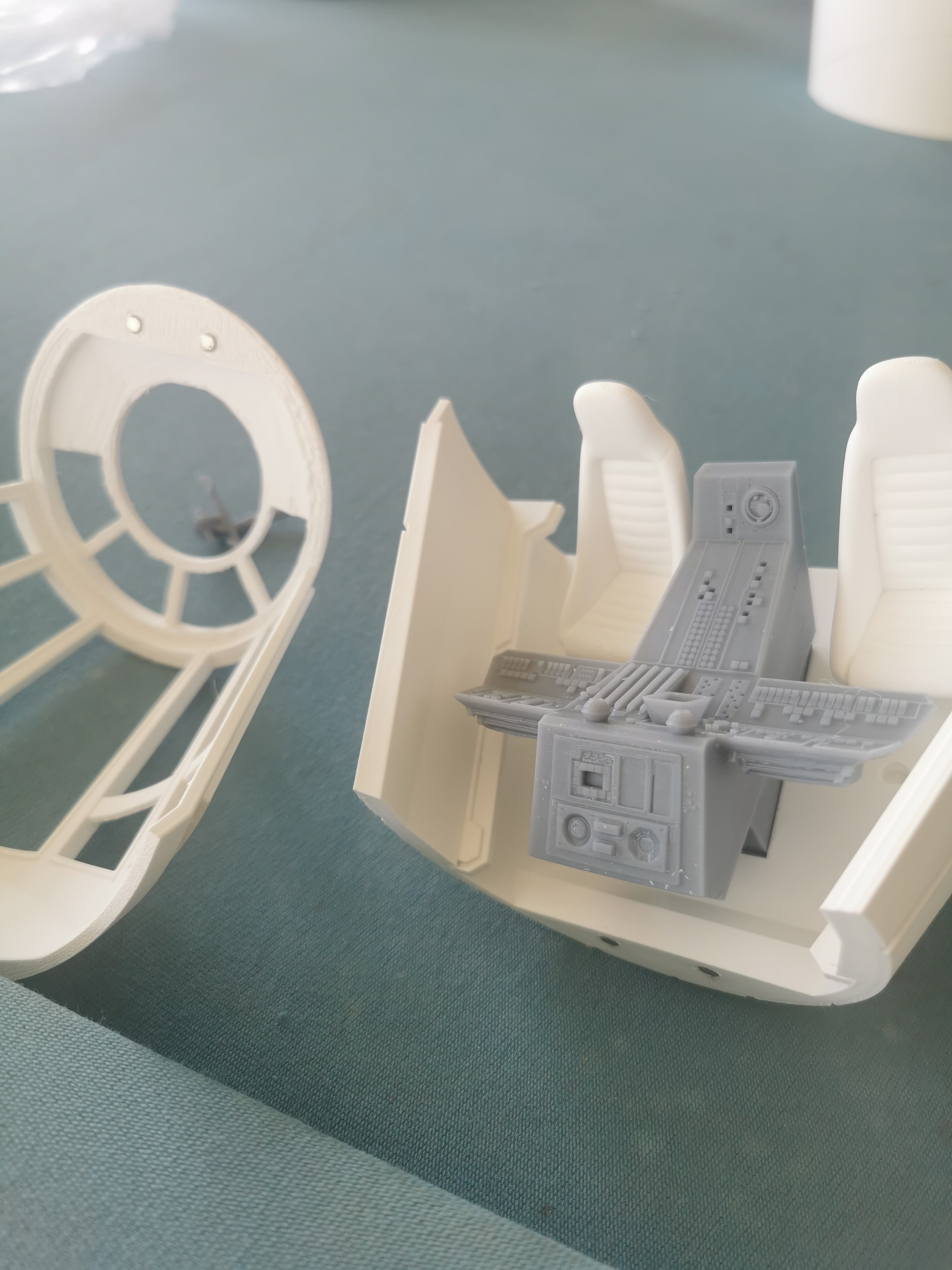

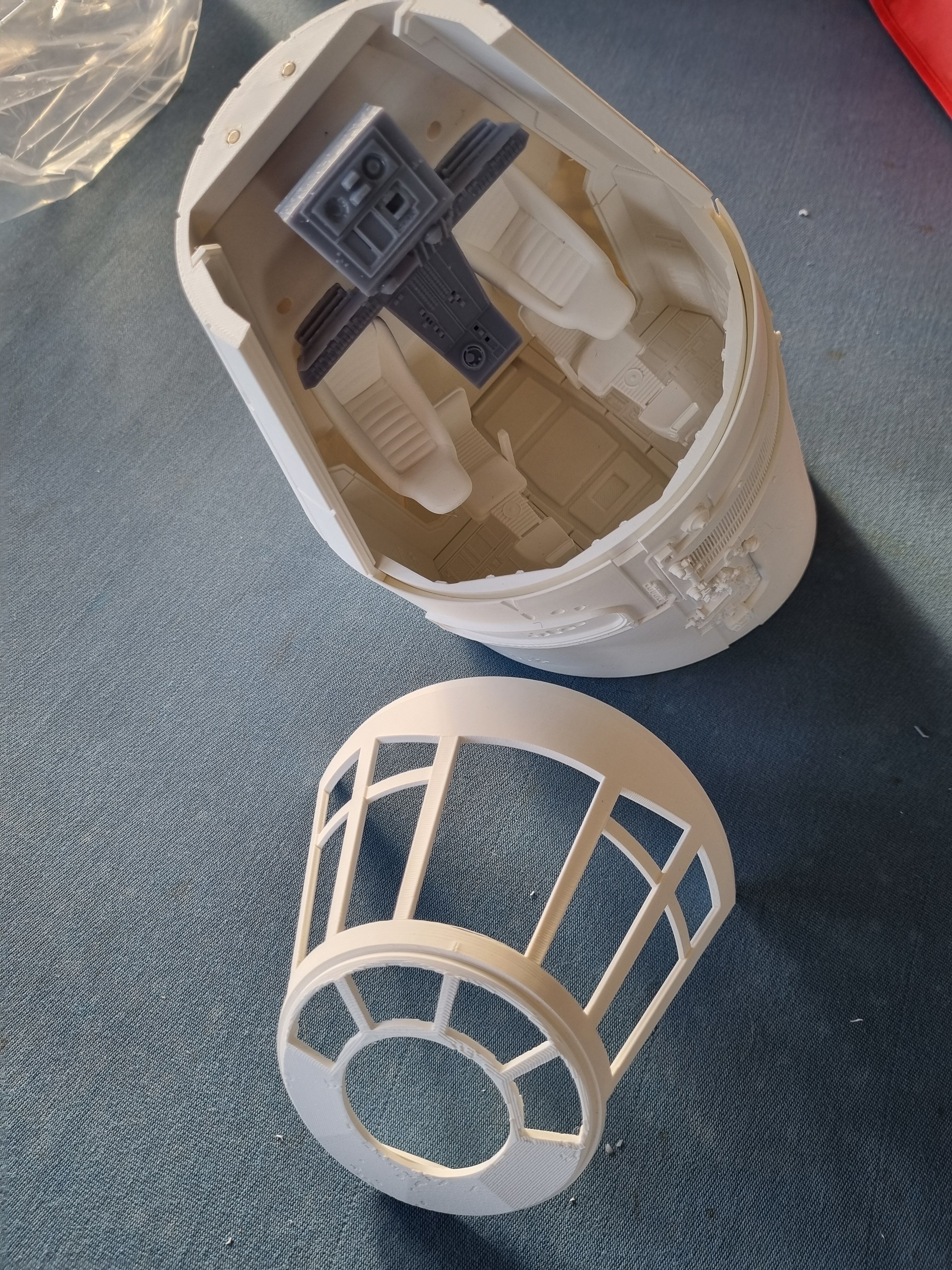

The Upper Canopy is attached using magnets, so comes off easily - I have also mounted the seats using magnets, gives you an easy way to rotate them to any position.
I have also put some lighting holes in both the Bulkhead and the Console - Still to figure out how to light the side walls and finish them off.
Any plans on modeling the inside cockpit detail seen on the studio model, with what looks like the LS Morgan Roadster dashboard parts, among other bits?
Funnily enough I was actually thinking of that - it might be down the track, but I wanted to end up with a few options for people to print - ie ANH, ESB and Actual Studio Scale Cockpits that could be swapped out.

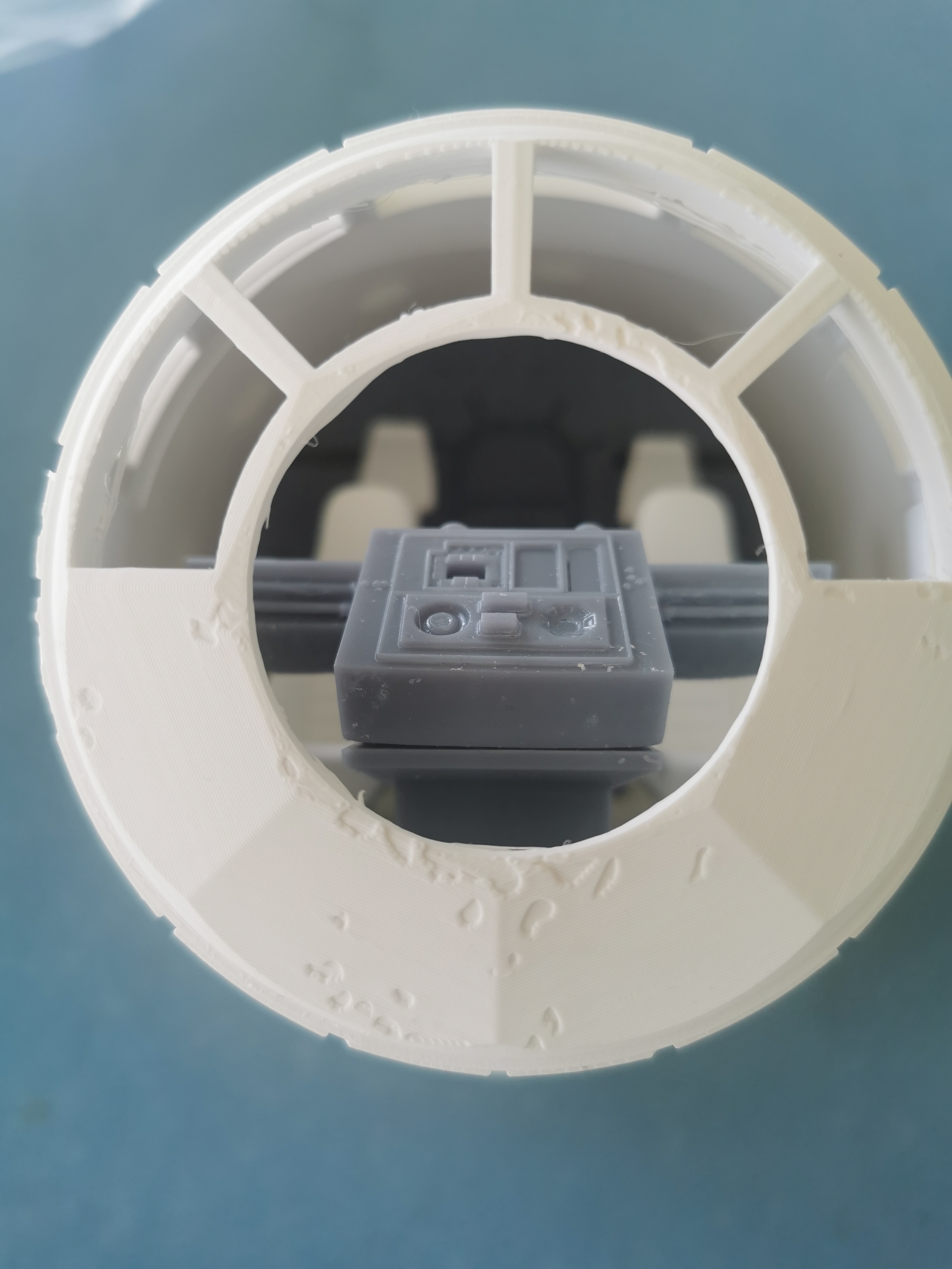

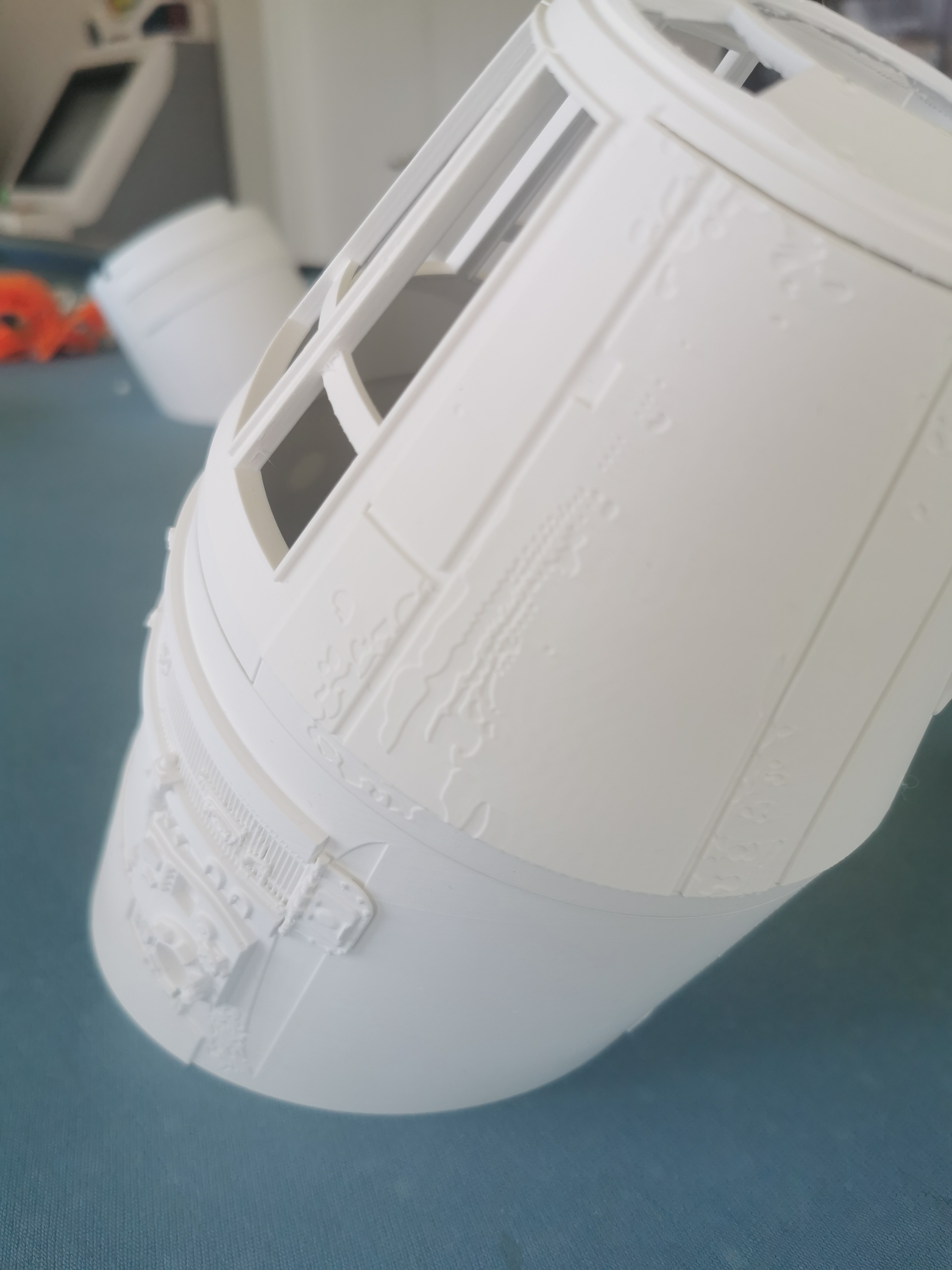

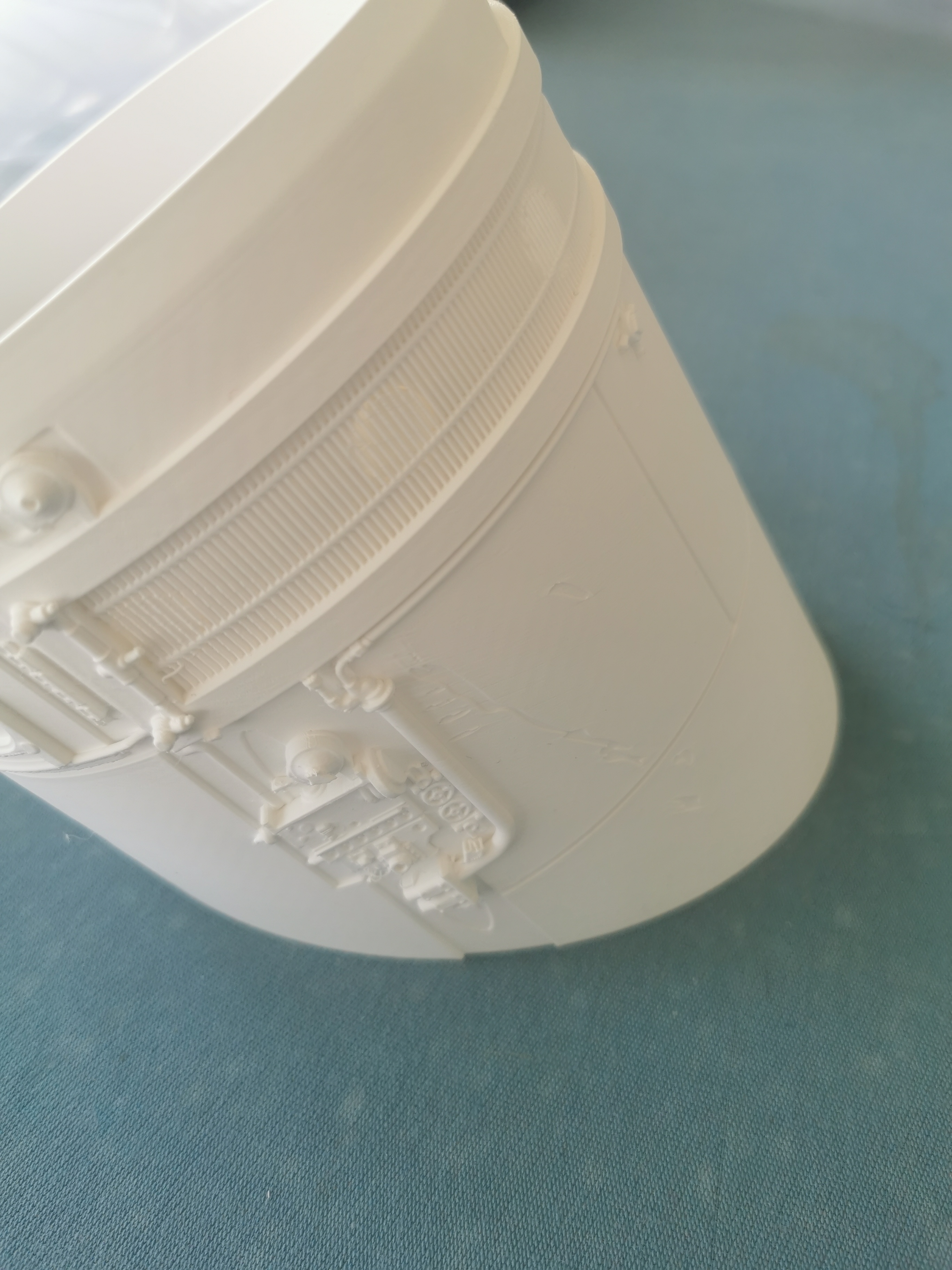

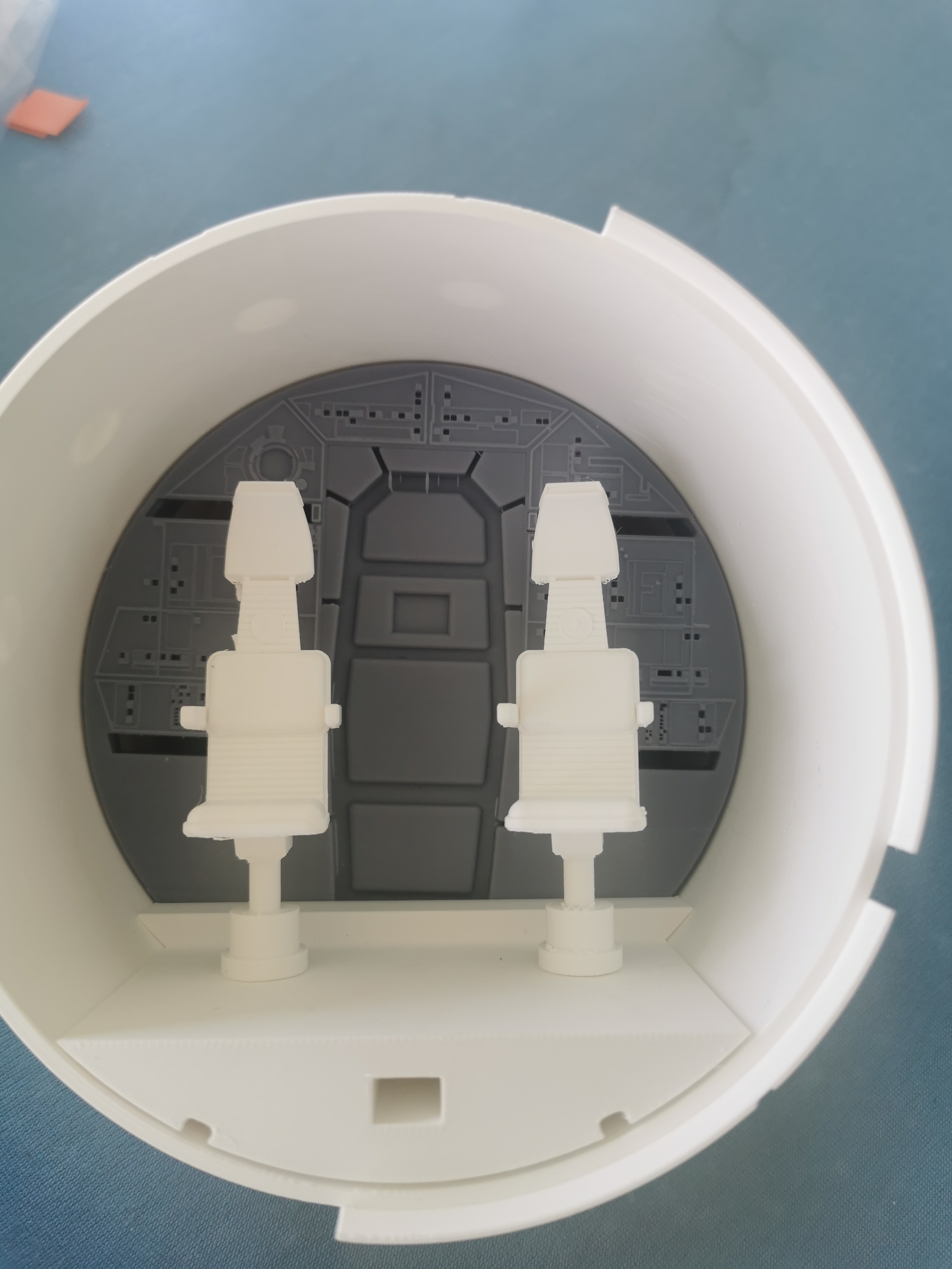

I have attached a couple of photos - keep in mind these are pretty much straight off the printer - no sanding or priming yet, which will help with any visible layer lines. It also shows my magnetic mounting - ie the seats, console, upper canopy all clip on with magnets, making it easy to access, and swivel the seats around.
I am pretty pleased with how the modelled damage came out as well.
White models are FDM (Bambu P1S), Grey are Resin (Anycubic M5S Pro)
