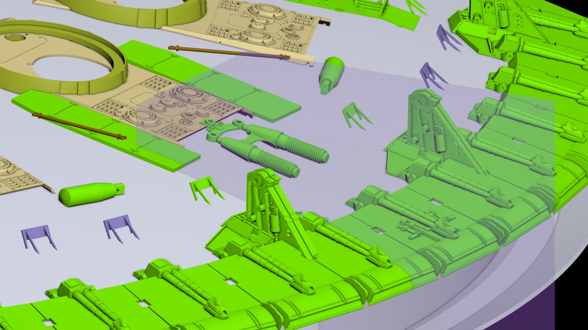

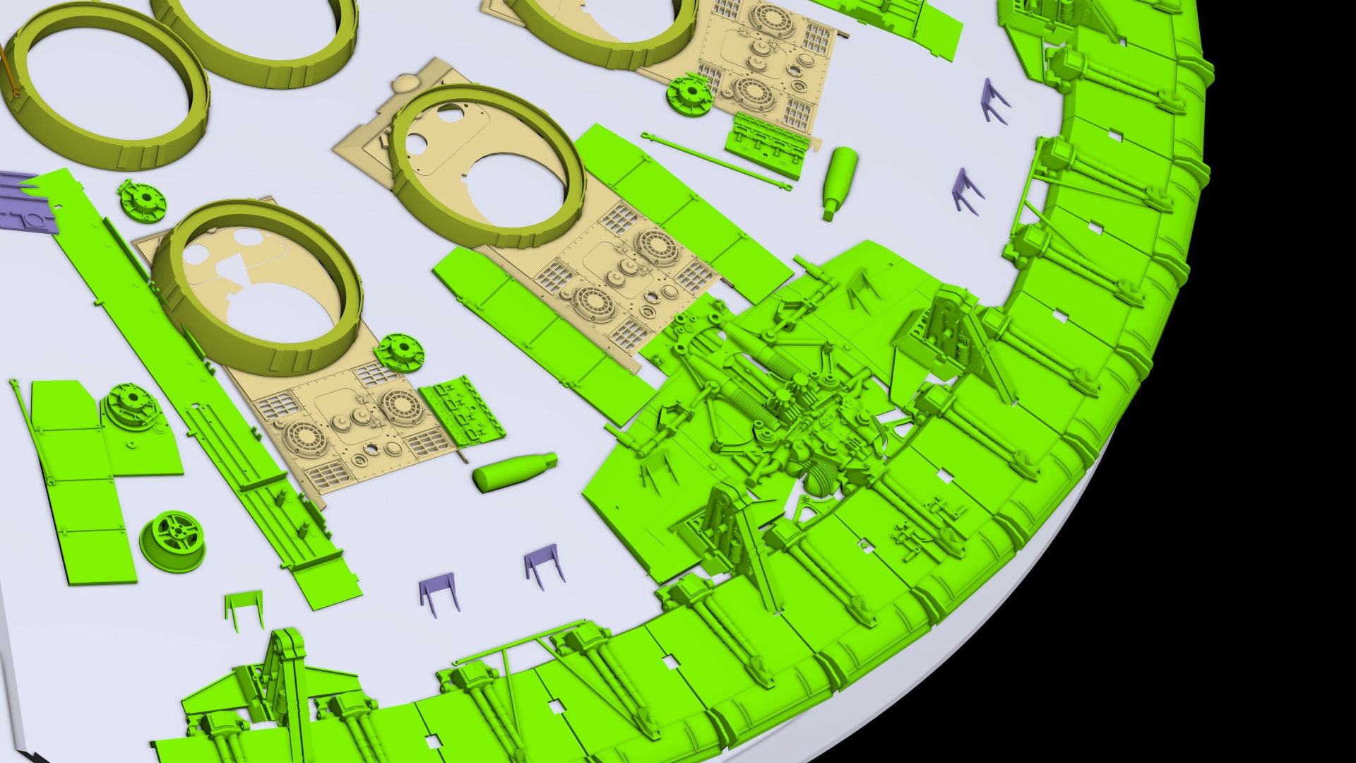

This weekend was really just me learning the software, but I did get quite a bit of modelling done - I don't take credit for the Panther tank top, or the Sealab models - I just reused what already exists there. Pretty picture attached
BTW I will make the models available at some stage - I am sure people with the kits and calipers can tell me where they need fixing.
Some still require tweaking and finalizing but mostly getting there

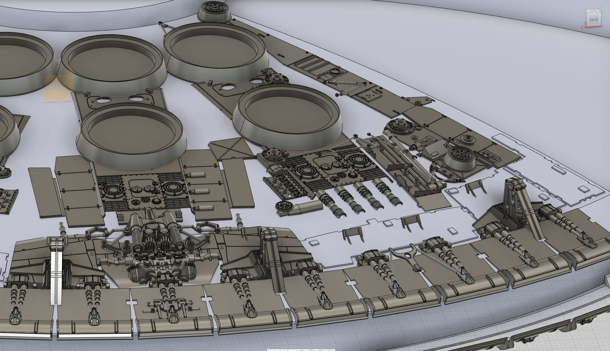

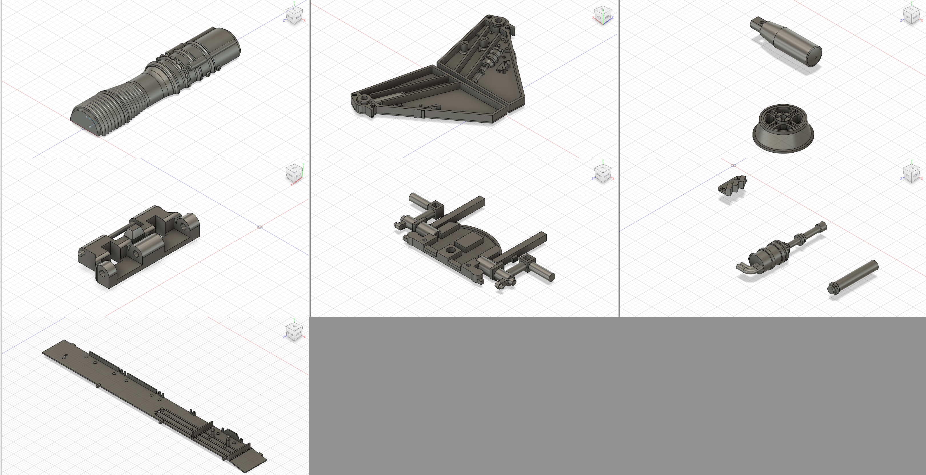

Bit of progress, hoping to have the upper engine deck completed by the end of the weekend
Then will move onto the lower part, then the fun part, how to split it all for printing, and what goes resin, vs FDM

A lot more modelling done - redoing everything in Fusion360 now, still not finished the upper Engine Deck, but getting closer each day.
Might move onto the cockpit once this is done - that should be a bit of fun

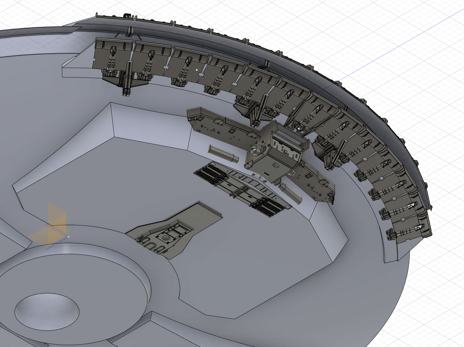

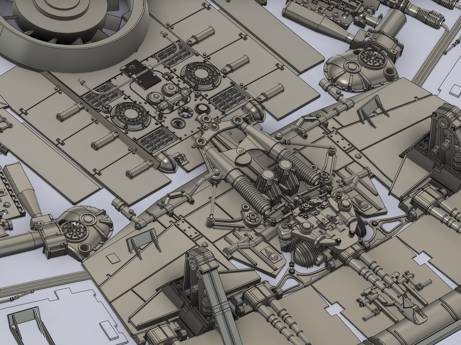

Nearly completed the upper deck, just a few more bits to model, but couldn't help myself and started the lower deck - a lot more to go there ;)

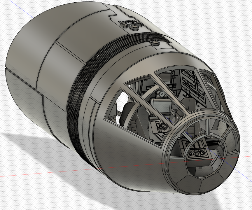

OK I managed to get onto the Cockpit while I wait for my new printer to arrive.
I remodeled the Nav Chair, Console, Bulkhead, and Sidewalls using Joshua Maruska's excellent models as a base. I was more going for something that could be printed easily and show a bit more detail - so a lot of artistic license there, and a lot lower poly count
This led me to a ton of questions - a lot of what I have seen the bulkhead seems too far forward, even the blueprints it seems too far forward, once you add in the seats - there is no leg room really. (I also based off an old photo that the Vickers yoke has a pipe going to the floor, so the Pilot seats cant go that far forward.)
So I redid it, a lot of it based on the PG Bandai Model, which seemed to have it further back as well.
I have the panels for the nose cone to finish off, and a few extra internal wall details, and this one will be getting split and thrown at the printers.
It will be a mix of Resin for detail bits, FDM for the bulk of it.
Anyway, once I have these split and am happy with the end result, I will put the files up for everyone to use. and or refine.
At some stage I will do a version with support for lighting - but that might take a bit longer
First few prints - It looks like its more than capable of showing a bit more detail, so I will be improving these models as well
I also noticed Joshua's panels were missing this section which I am in the midst of adding, which in turn pushes the Bulkhead back as well.
Ok In answer to my own Question - it appears that the ESB Falcon did have a pushed back Bulkhead and the extra panels I outlined above -
I have found this old photo from ANH which showed those extra panels didn't originally exist.
I see from a few other posts it was fairly common knowledge, tho its a lot of reading here on the RPF to figure some of this stuff out.
Small Update -
Most of the Upper Greebles modelled, just working on the underside ones and the Panther surrounds for the Grill at the moment

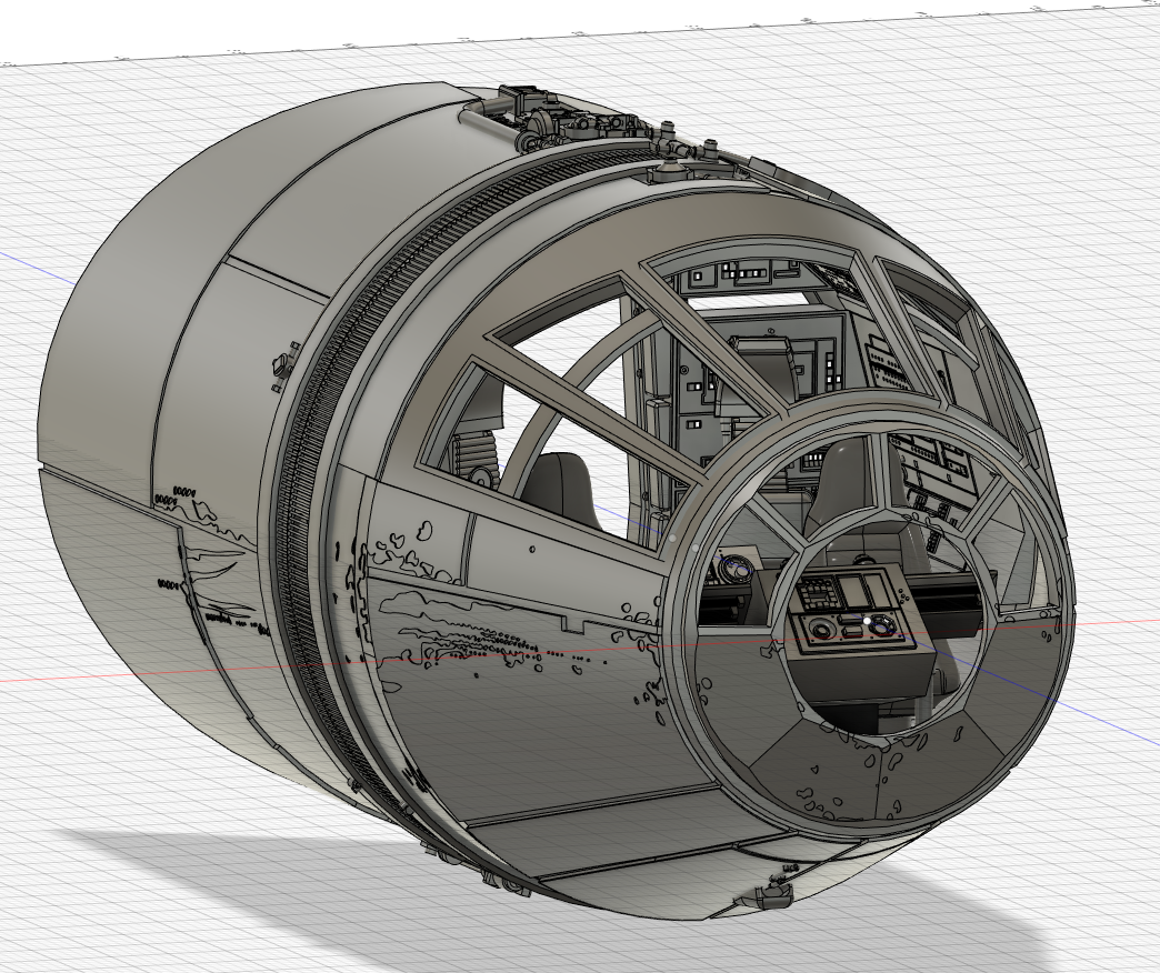

OK after some thoughts and discussion with Manu, I started modelling some of the damage.

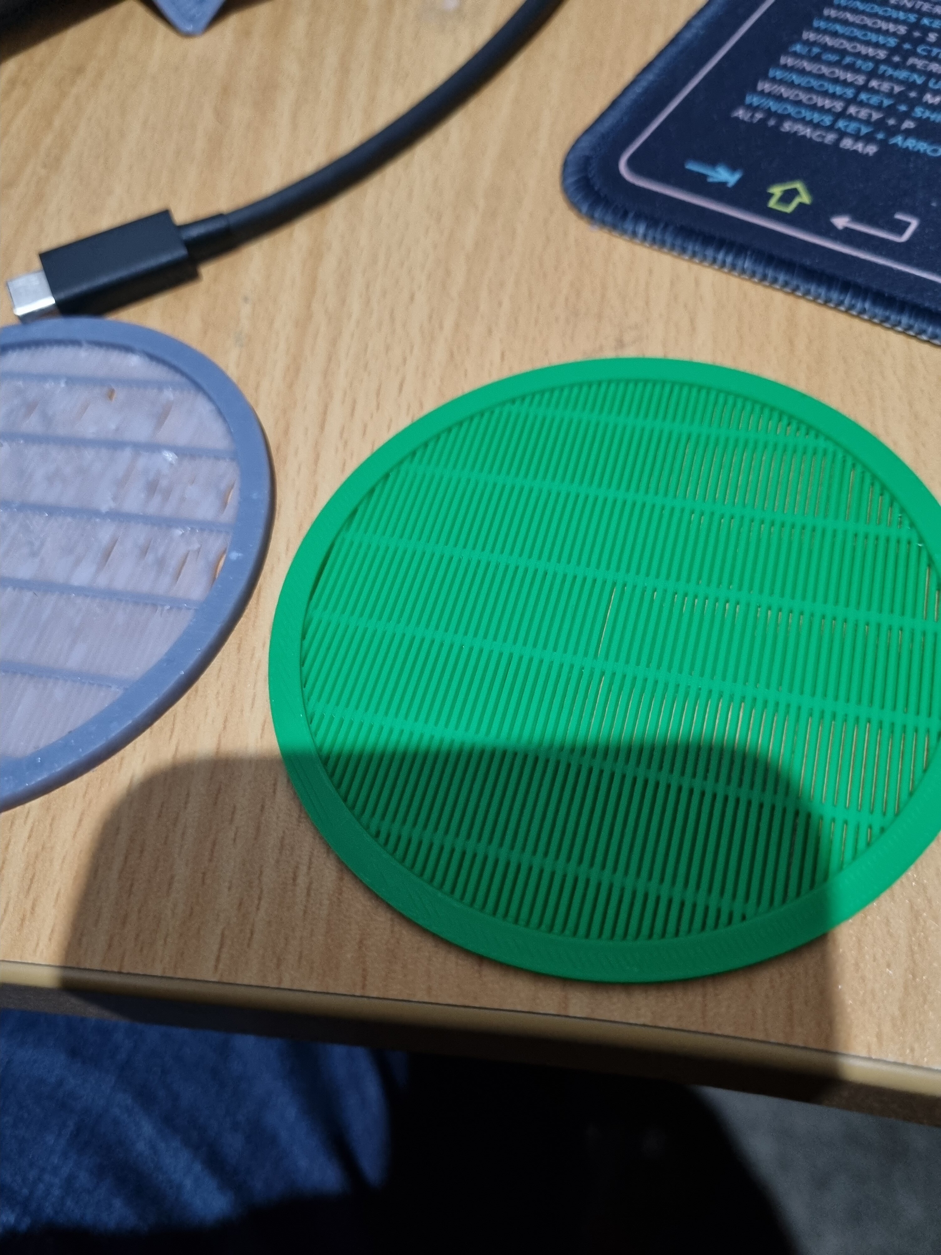

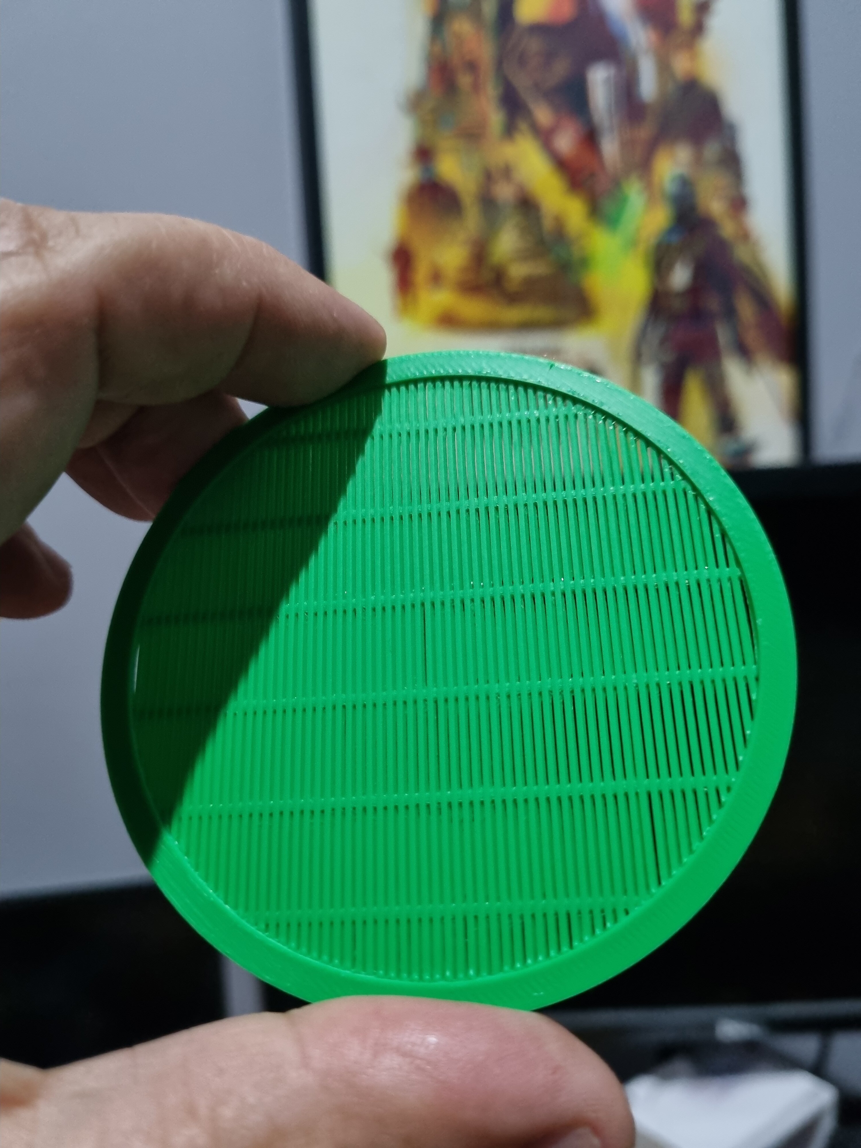

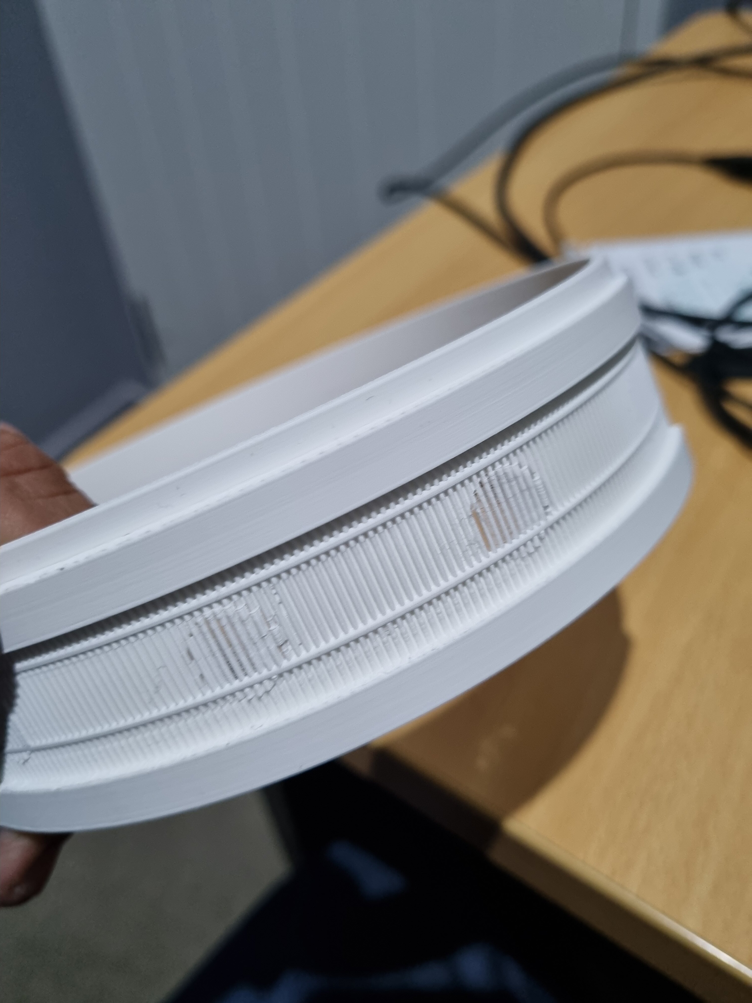

I also just set up the new printer, running full speed on a Bambu with some of the finer prints I can see issues, but i think slowing it down will help, so a few photos of the first few prints as well for reference, the grills worked far better than the resin for the time being.
I mean full speed, that thing is insanely fast. but for the finer detailing its just too fast

Slower is always better for FDM printing. That includes the non-print travel speed. For larger prints and when the print bed is moving really quickly, the extra momentum on the print bed can cause the belts to skip and you get ruined prints due to massive layer shift. So keep things slow. It only adds an extra few minutes to the print time, and you're far less likely to get failed prints.
Cheers, yes I will slow it down a lot, time is not an issue, and I'd rather have clean prints.
I was just more surprised how fast the Bambu was in comparison to the Prusa I was using.
The good thing about the Bambu is its not a plate slinger, the plate only moves up and down and the head moves , so less chance of layer shift. Which is why it can move so fast in the first place, but I definitely know of some other issues caused by the speed.

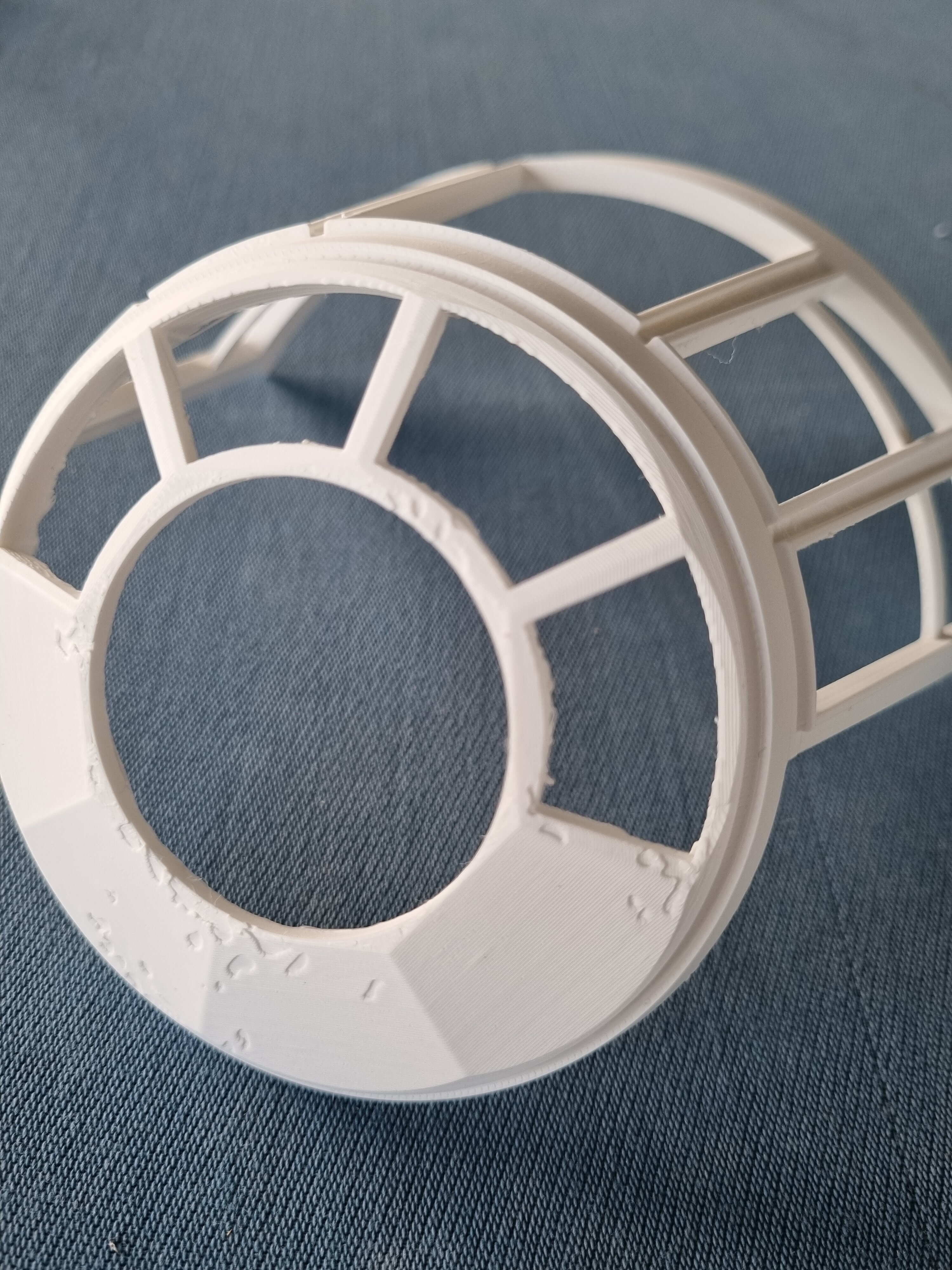

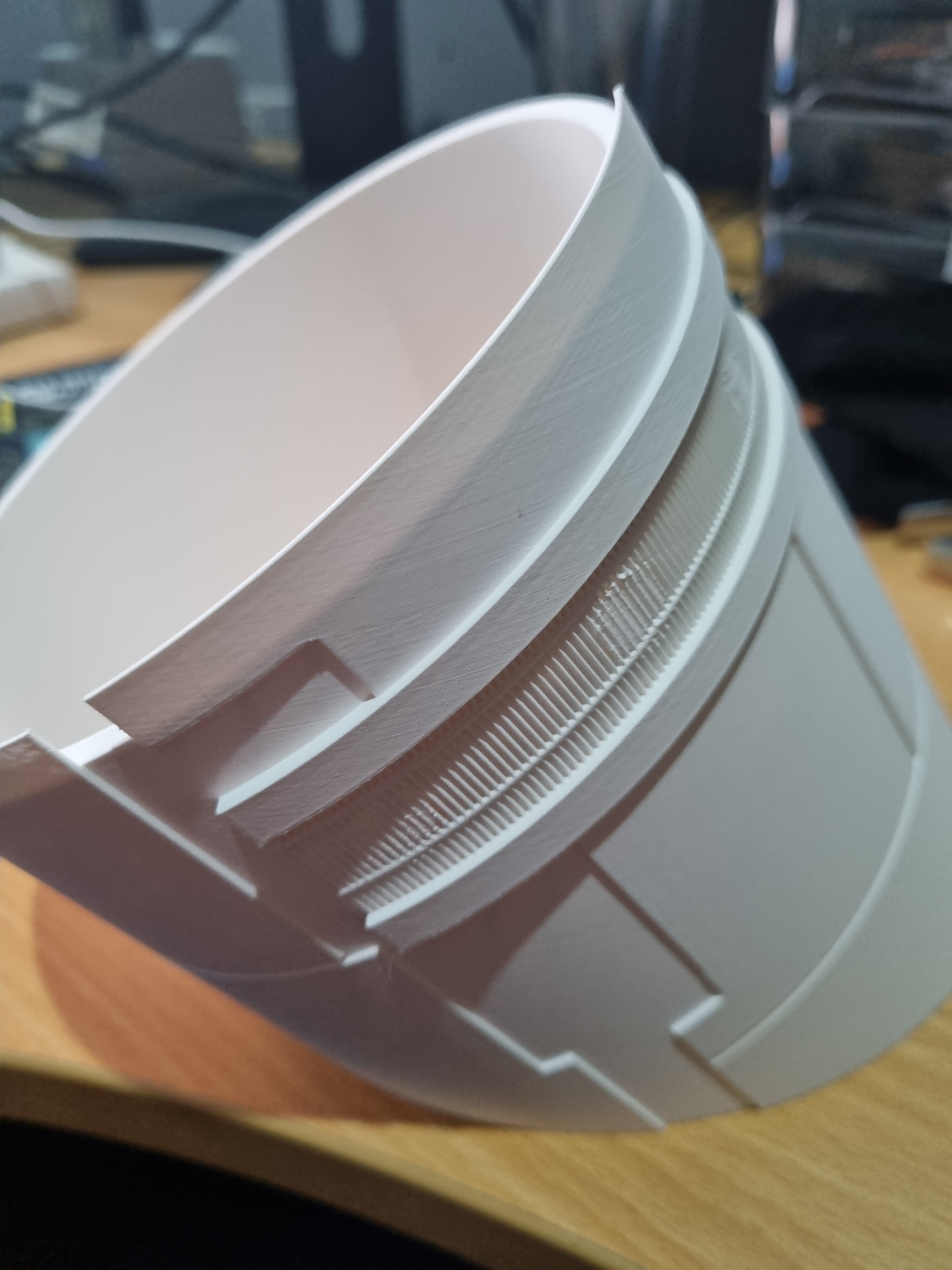

Lots of fun Modelling damage now, and a few prints from the FDM. Still a lot of damage to go, but its getting there
I've also split the bulkhead out a bit and punched some holes through for lighting - that is on the resin printer at the moment.
You can see some of the chipping on the front canopy picture - the main tube was really just a test. I will redo it once i finalize the damage - and how to attach the greebles and internal parts.
Printing at 0.08mm layer height, and around 40% speed on a Bambu P1S.
