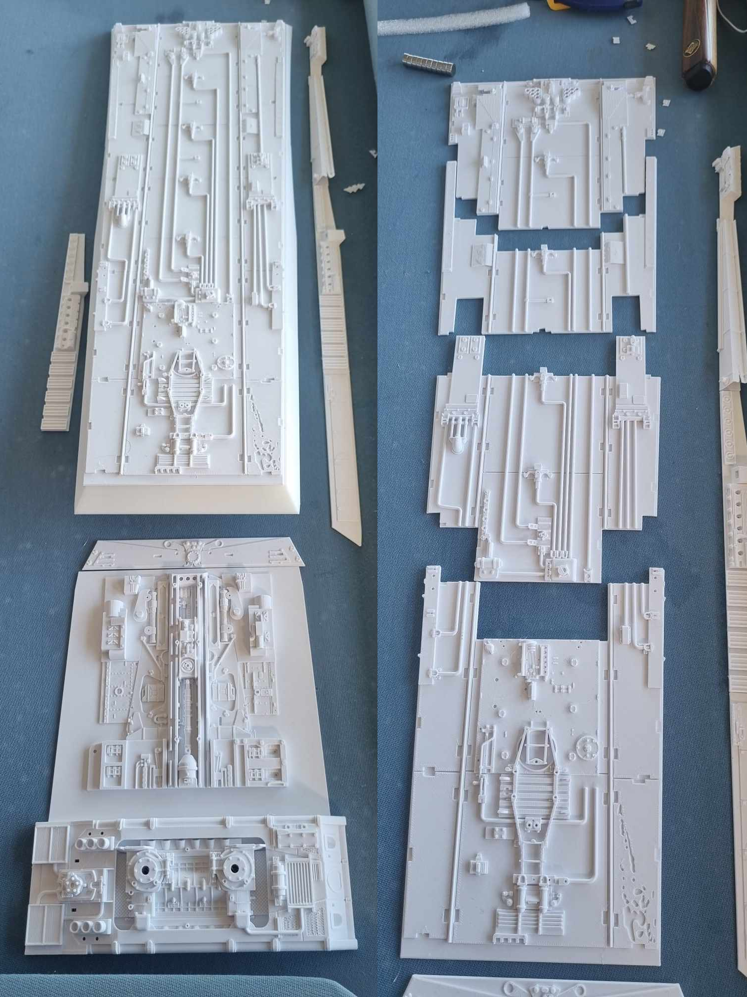

Couple of shots of the printing to date - not fully glued or bolted yet (Waiting on Extrusion), but should give a bit of an idea.

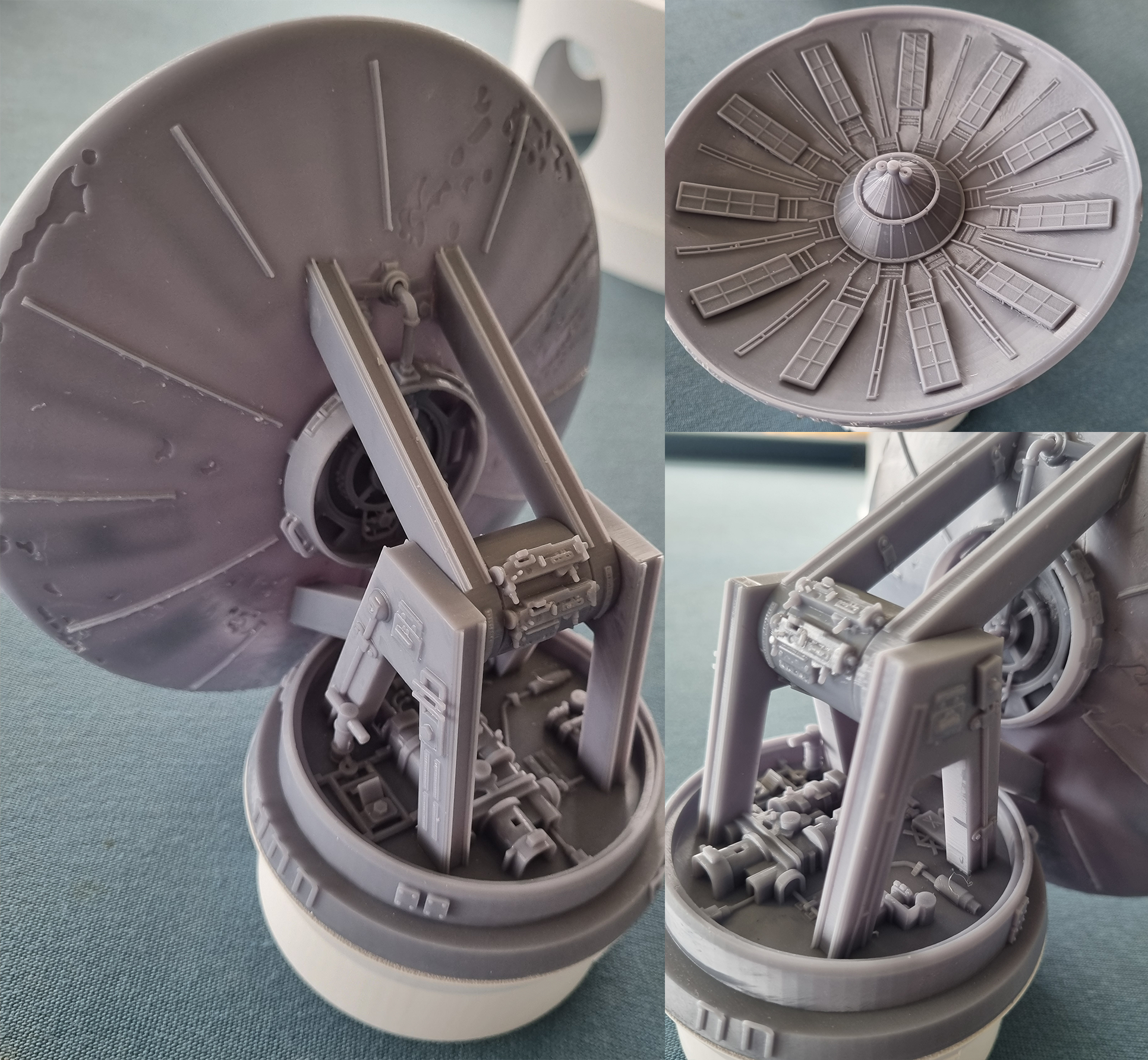

Here's the link to my 3d models for the Radar Dish for anyone interested.
The dish itself was based from a model of Manugu's, and a lot of tweaks thanks to invaluable feedback from the group here (Thanks Dave especially)
STLs and STP Files can be located here
In my build - the Dish A-Frame clips into the Upper base using magnets, so if you don't want to use that method you will just need to modify the files to suit.
Anyway have fun - Cheers D

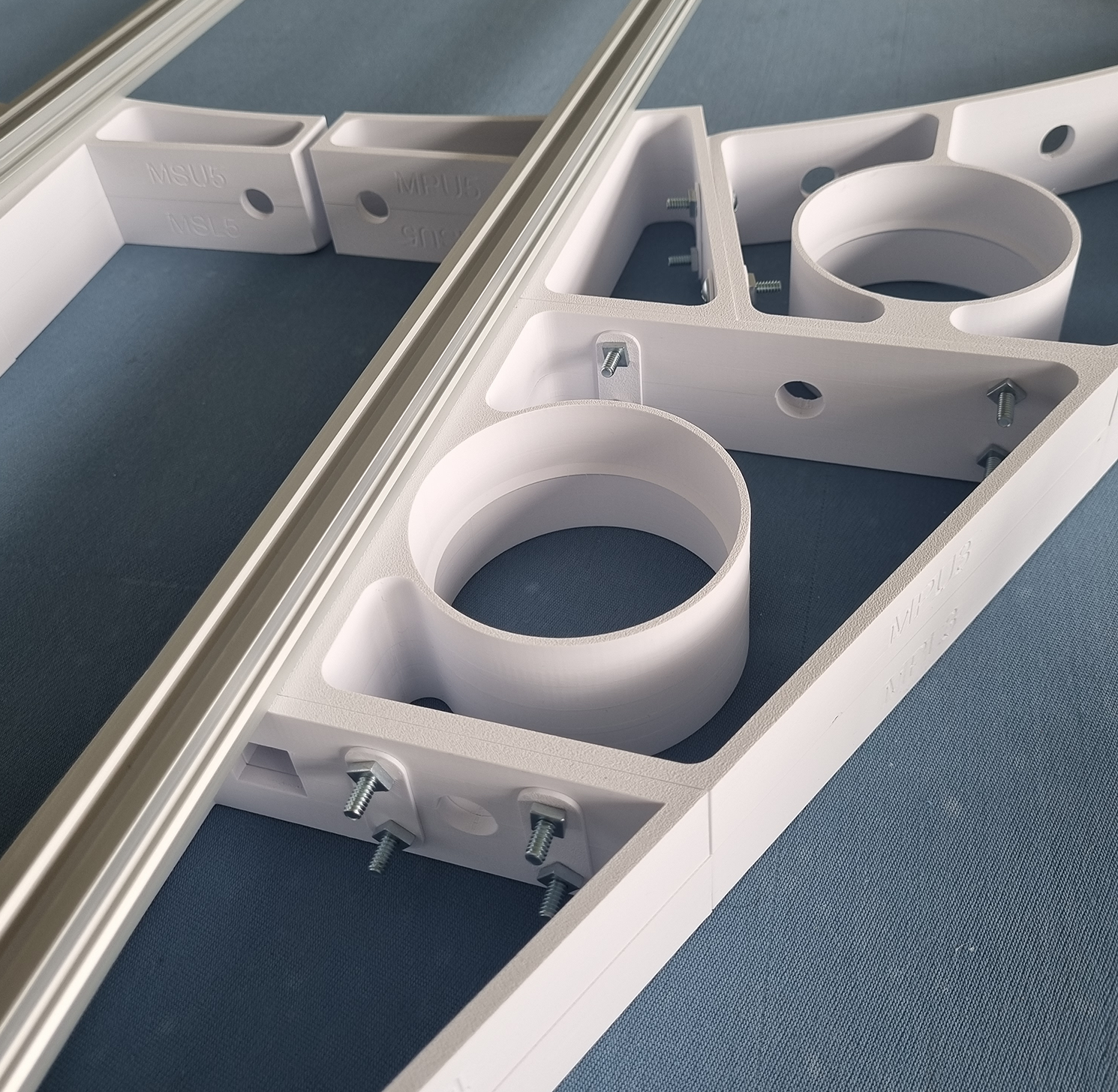

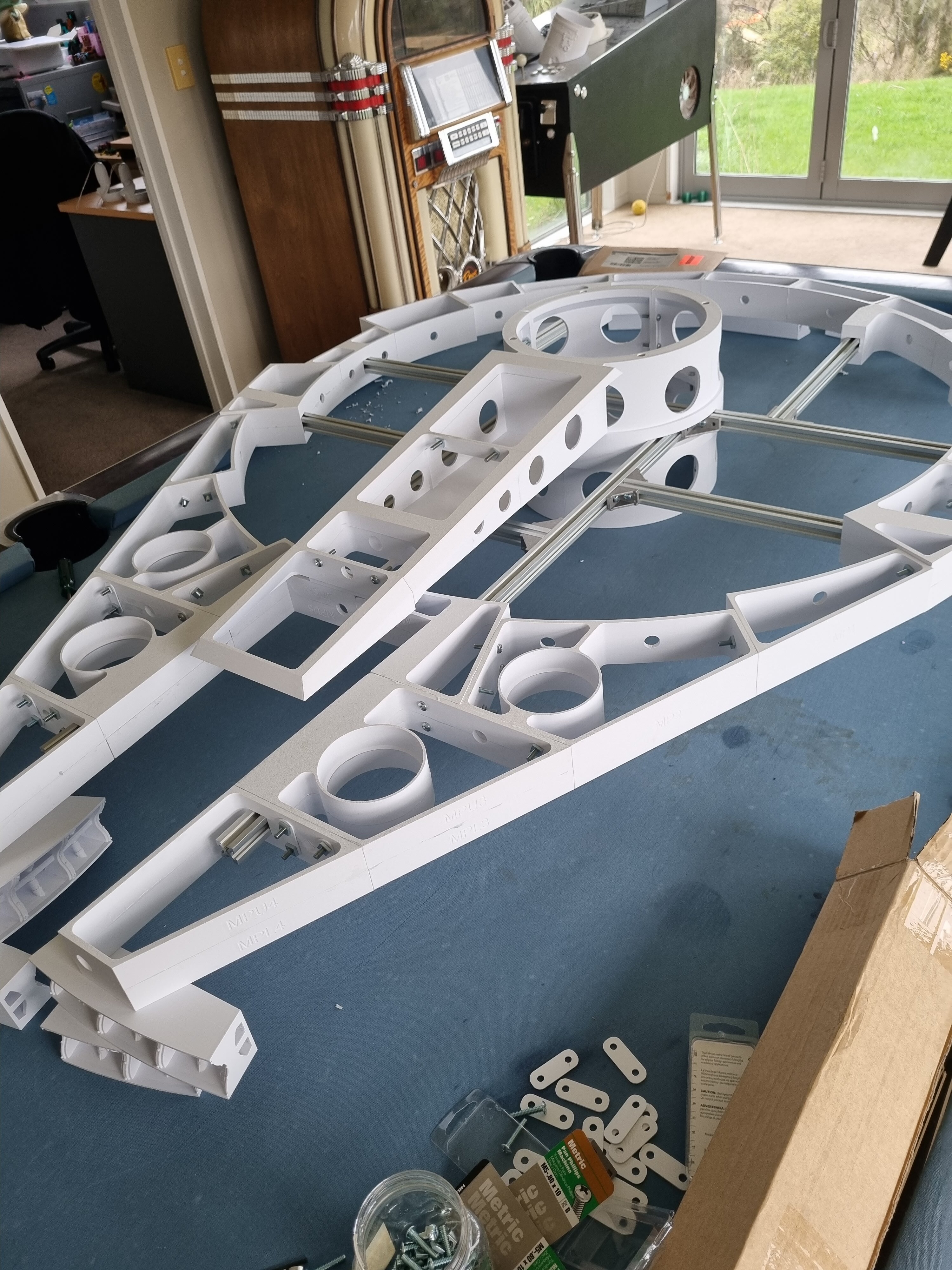

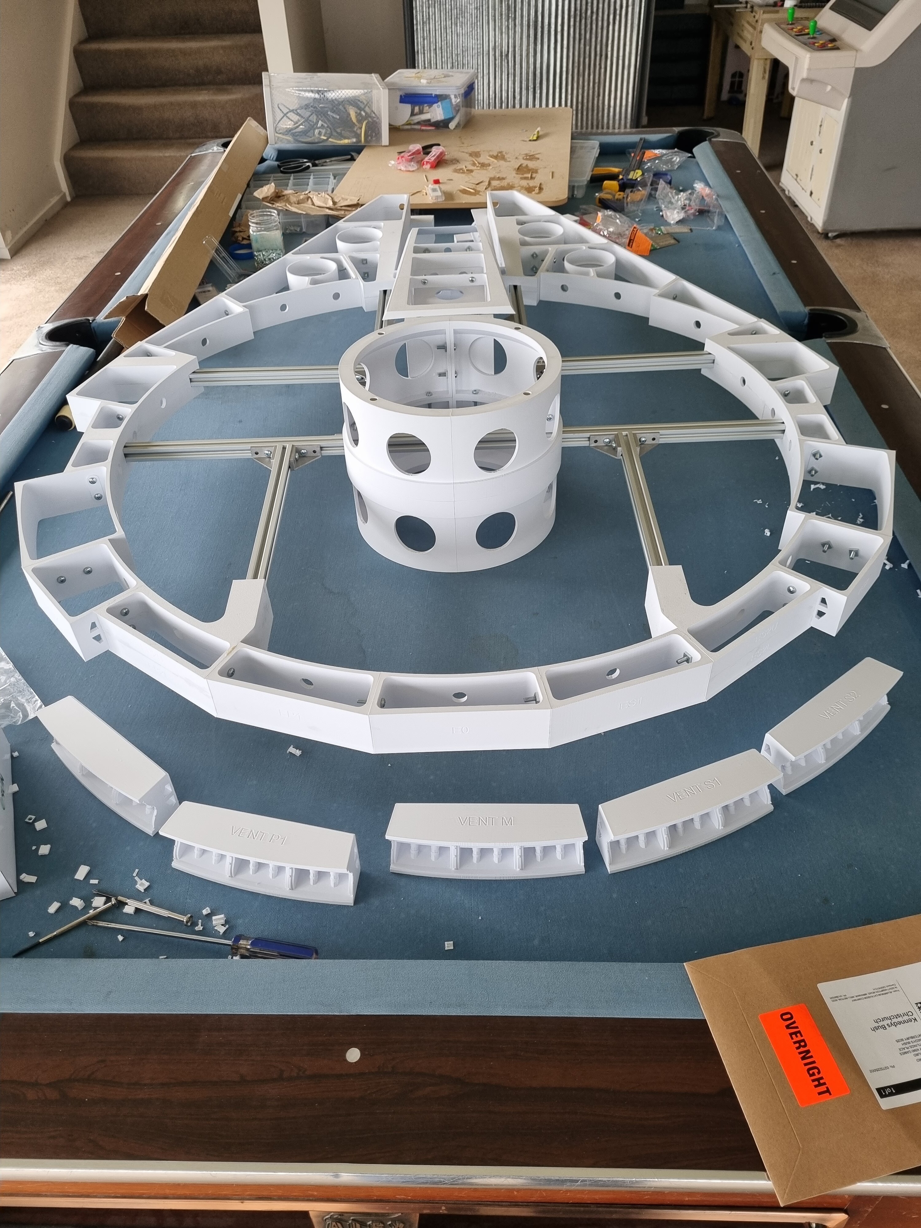

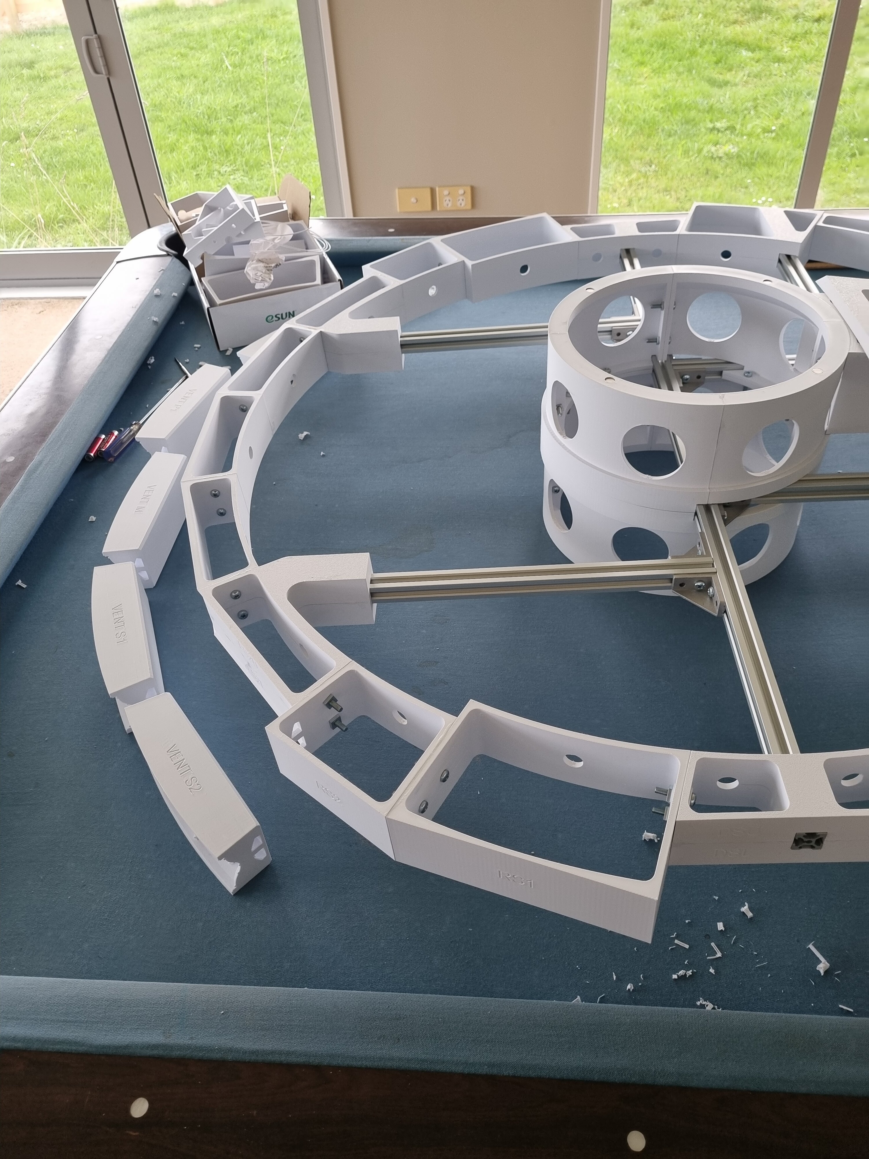

Exciting times, my Aluminum Extrusion arrived today, so now its down to cutting to size, finishing the last few prints, and then assembly of the base frame
Only a few pieces left to complete the ring.

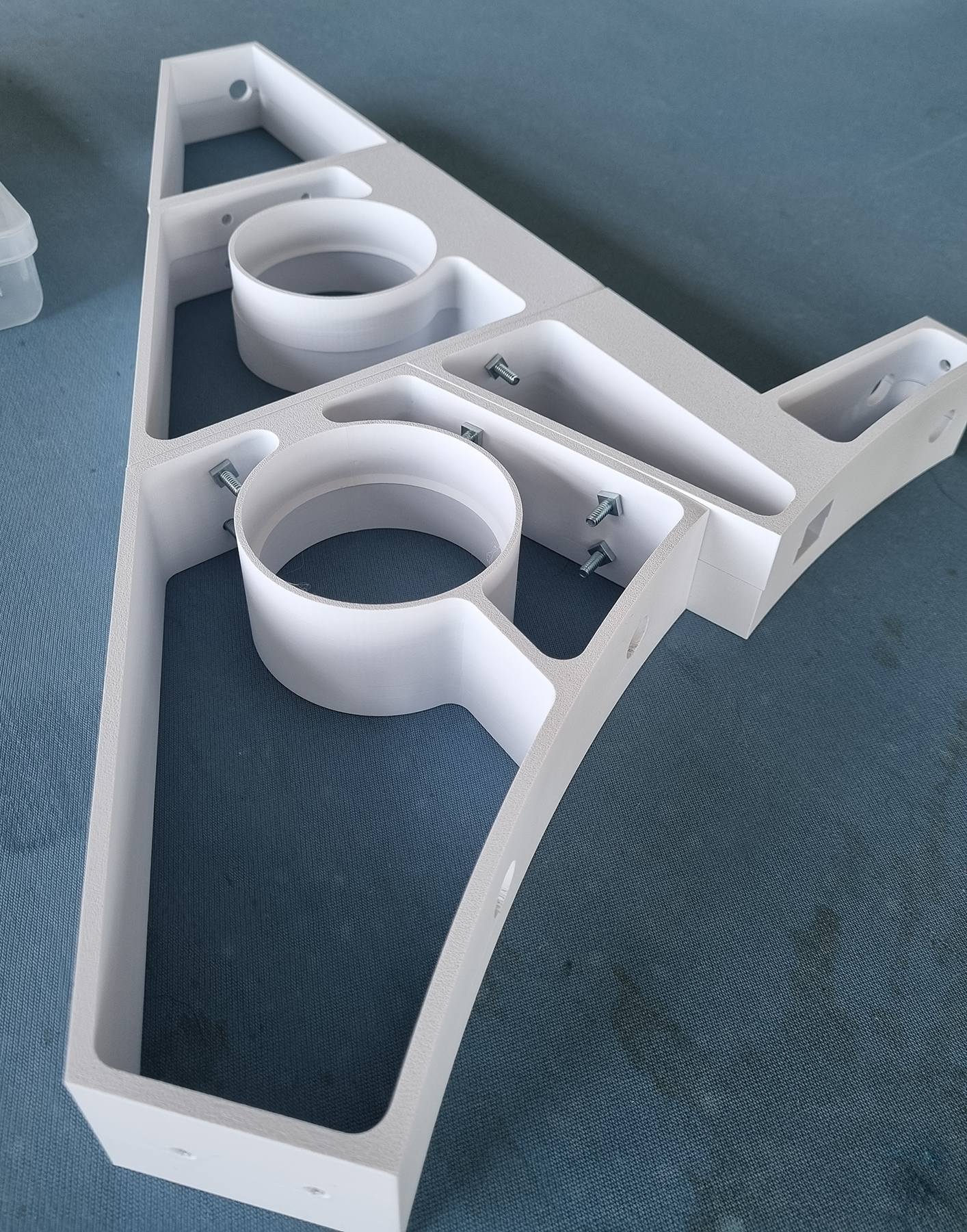

At the moment I am just bolting everything together for the first run - final run will be glue and bolts - just don't want to start gluing and realize I made a mistake somewhere (Yes done that a few times) - some of the parts a re printed in upper and lower sections, so these are bolted onto the other parts using straps as you can see in this photo.
Next photo series will be it assembled

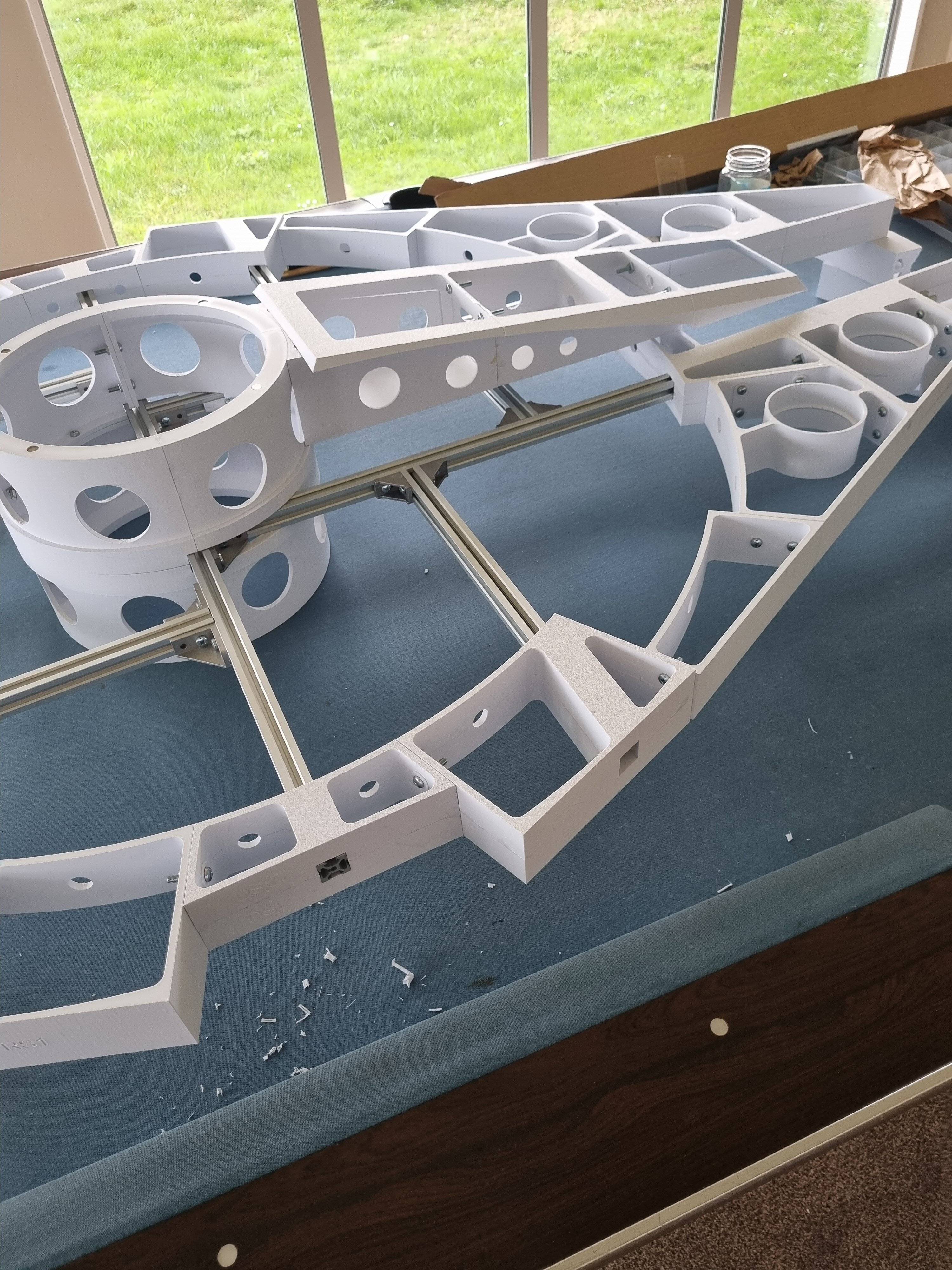

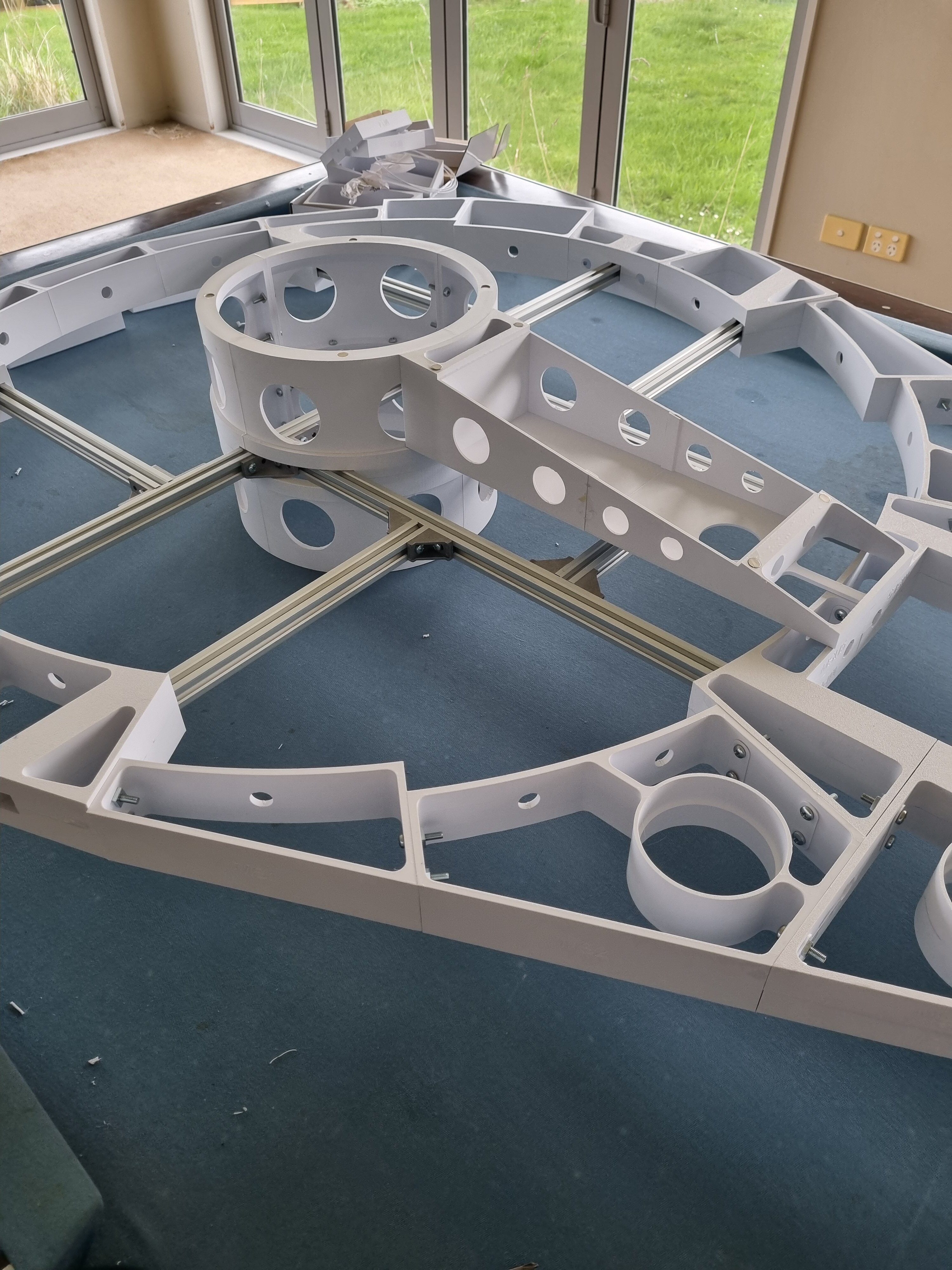

Well the frame is now complete, and is solid as - now to start filling in the details.
I will weigh it at some stage, but its not too heavy yet - I can still hold it comfortably with one hand.
The upper jaw part detaches to allow access to a recessed electronics area in case anyone is wondering

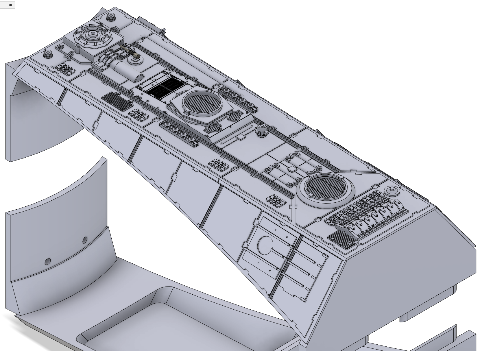

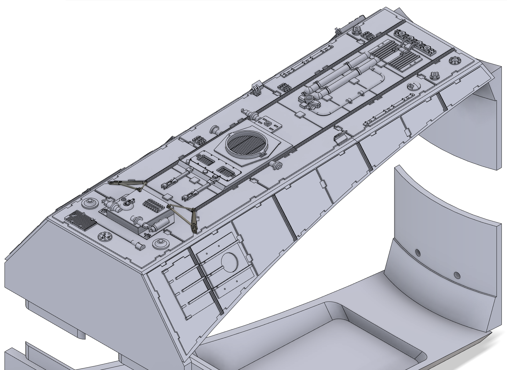

Sorry for the delay in Posting, have been frantically finishing off modelling the Jaws - they are a lot of work, but have the inners and uppers complete now, just ready to glue and then paint.
I have split the surface along panel and greebly seams to minimize any noticeable joins.

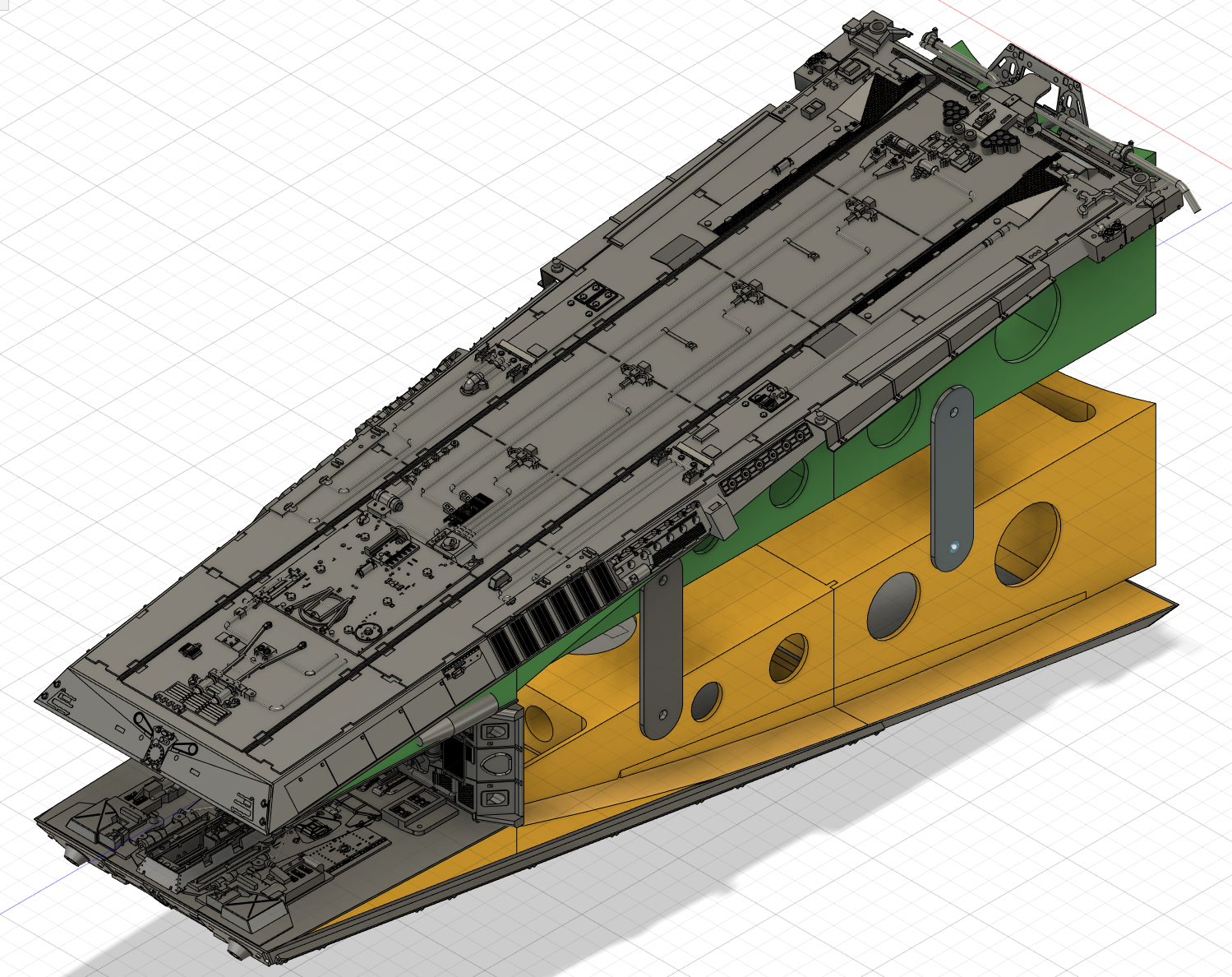

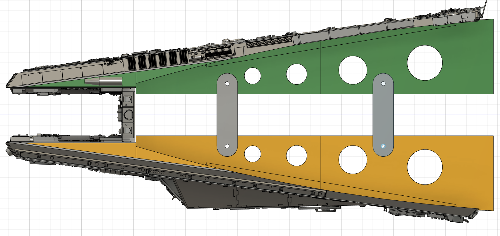

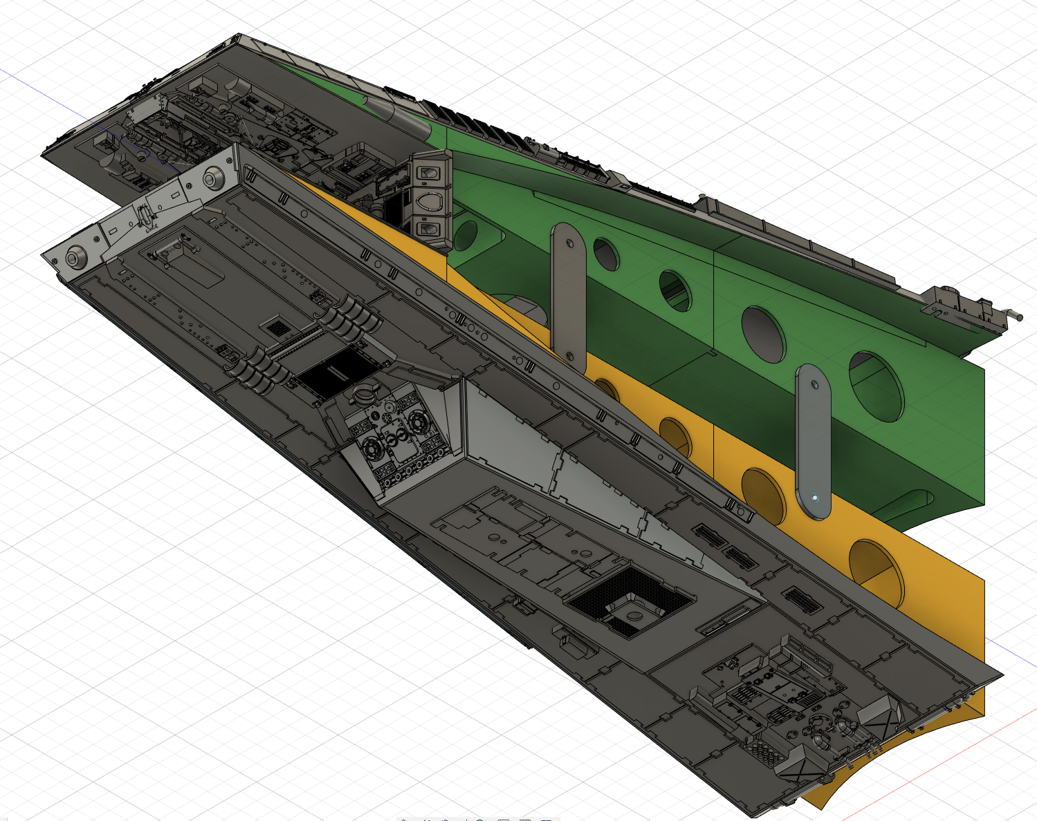

FYI the box support part is actually for electronics, with the jaws detaching via magnets to access these bays
