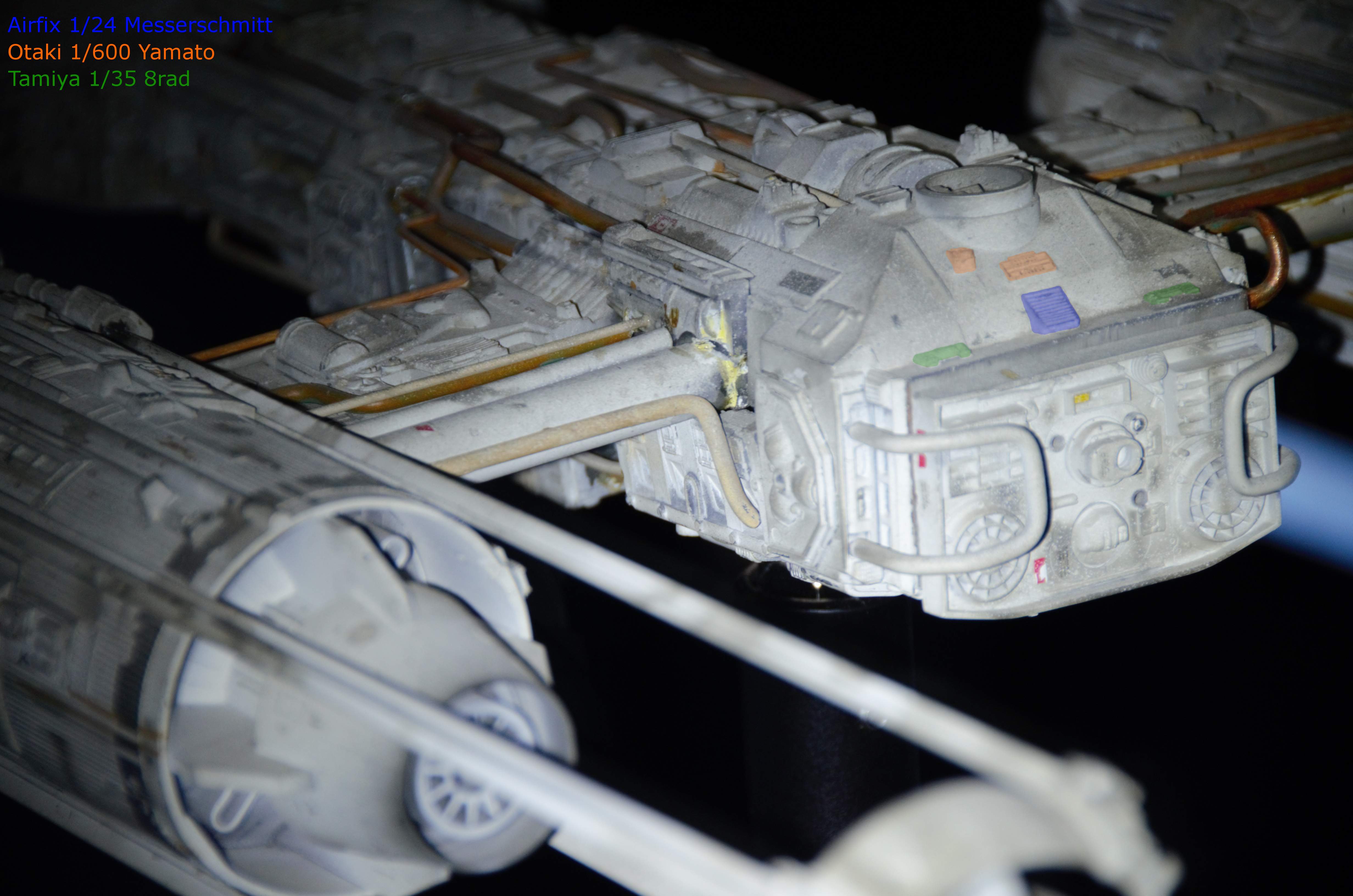

Another one for the front page. [strike]I hadn't found any info on the orange shaded piece though. And it's a bit small for my inexperience to judge what it might be.[/strike]

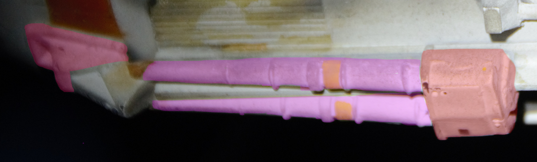

I've got the Dragon release of the Kettenkrad and can't find the green piece, or part of it, anywhere in the kit. Can anyone give some advice as to what the green piece is made of?
From what I've seen, it seems it's made of two separate pieces, one of which might be unknown.

Re: Y-Wing Parts Map for the "Green Leader" Project
There is a part in the Kettenkrad that might have served as the basis or inspiration for the piece you've highlighted in green, but I was under the impression that it was custom made and not sourced from an existing kit.

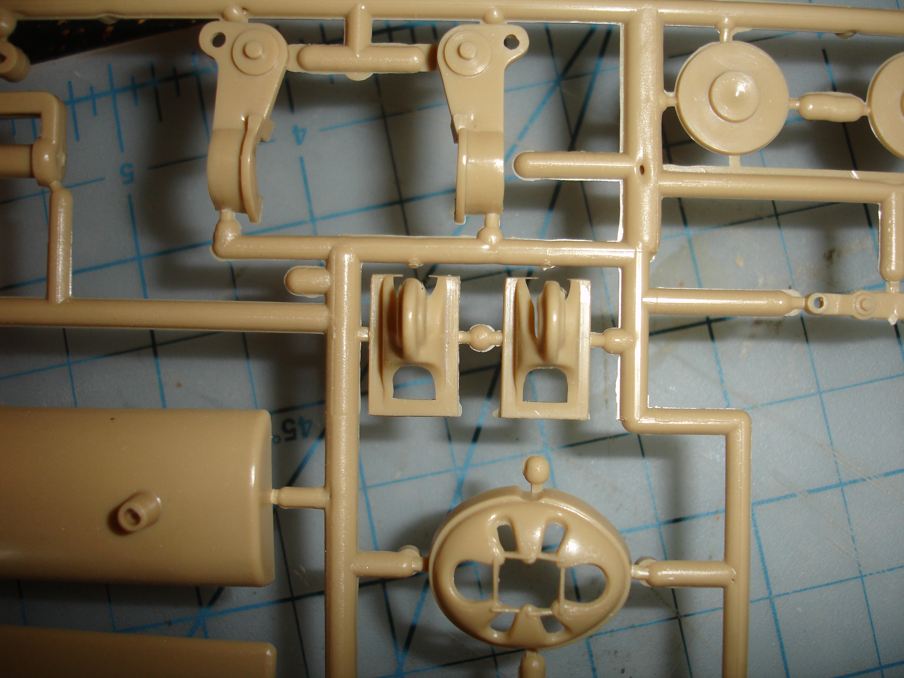

Here's the part. Mine's the Esci release.
Thanks. Mine's partially assembled and now I see the parts have been glued onto another piece. I can see the resemblance now.

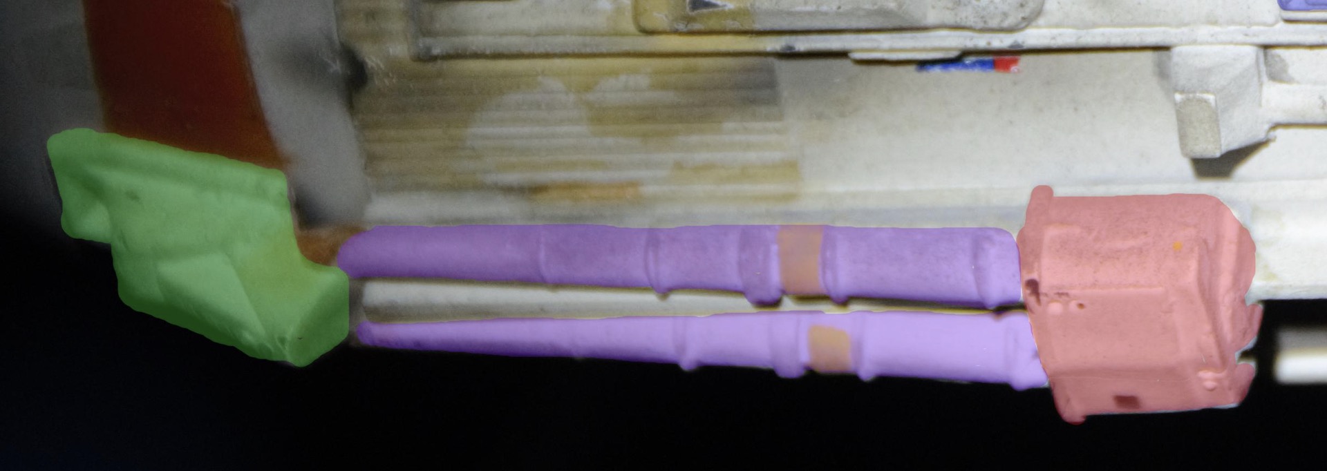

The Kettenkrad image in post 210 is the pink shaded piece in my revised engine image from my understanding. This is based off info available in the Falcon thread I believe.
The Kettenkrad part is used for the base.The top part is believed to be a kit part.

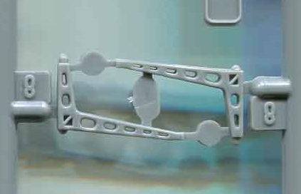

Moving as far aft as you can... does anyone know which part or parts make up this detail from the tail vanes?
This photo is of the EFX model from comic-con.

I noticed that assembly is included in Jason Eaton's casting pack. That's a start.

I see two different trimmed gun parts from ships.

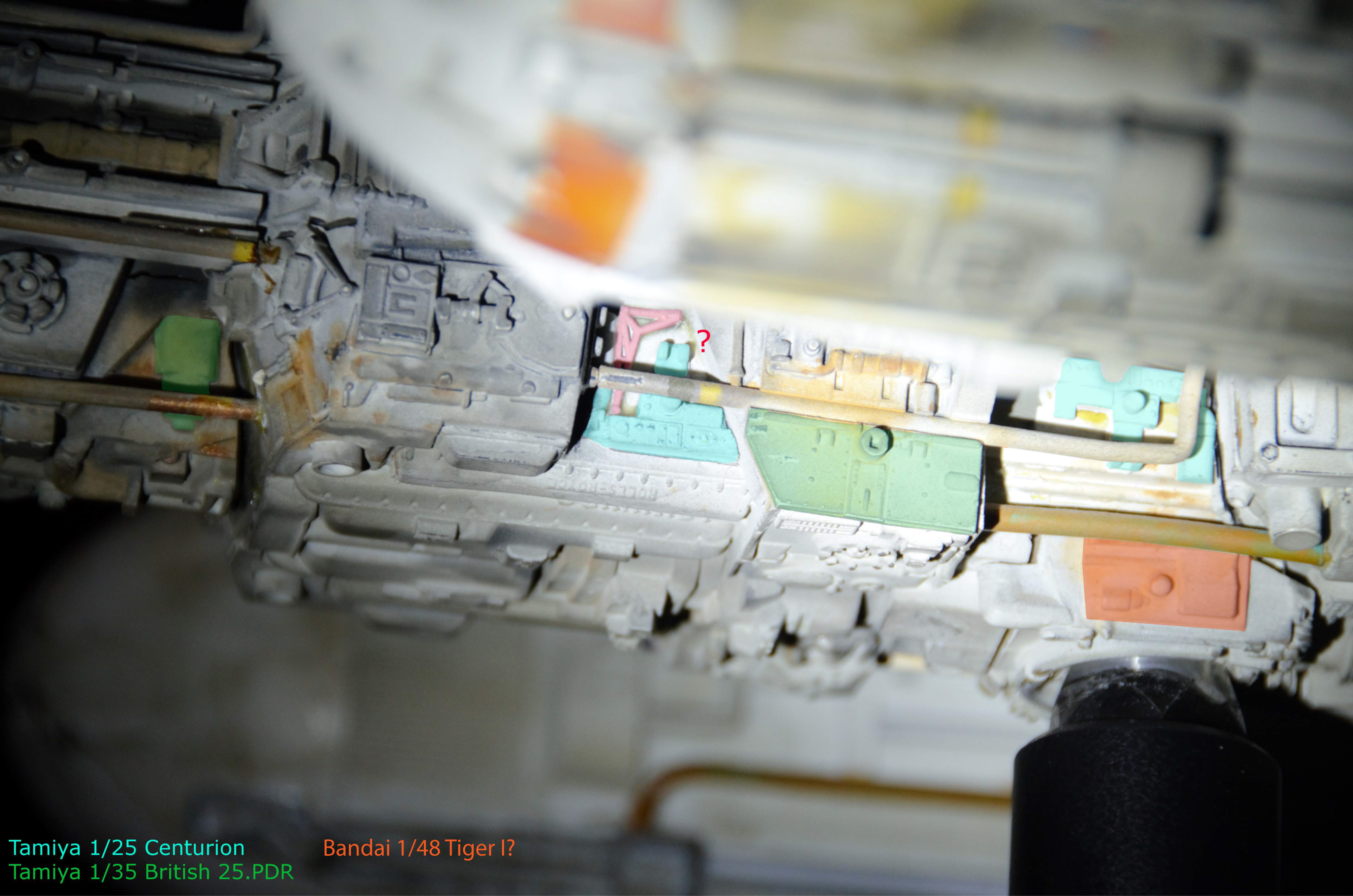

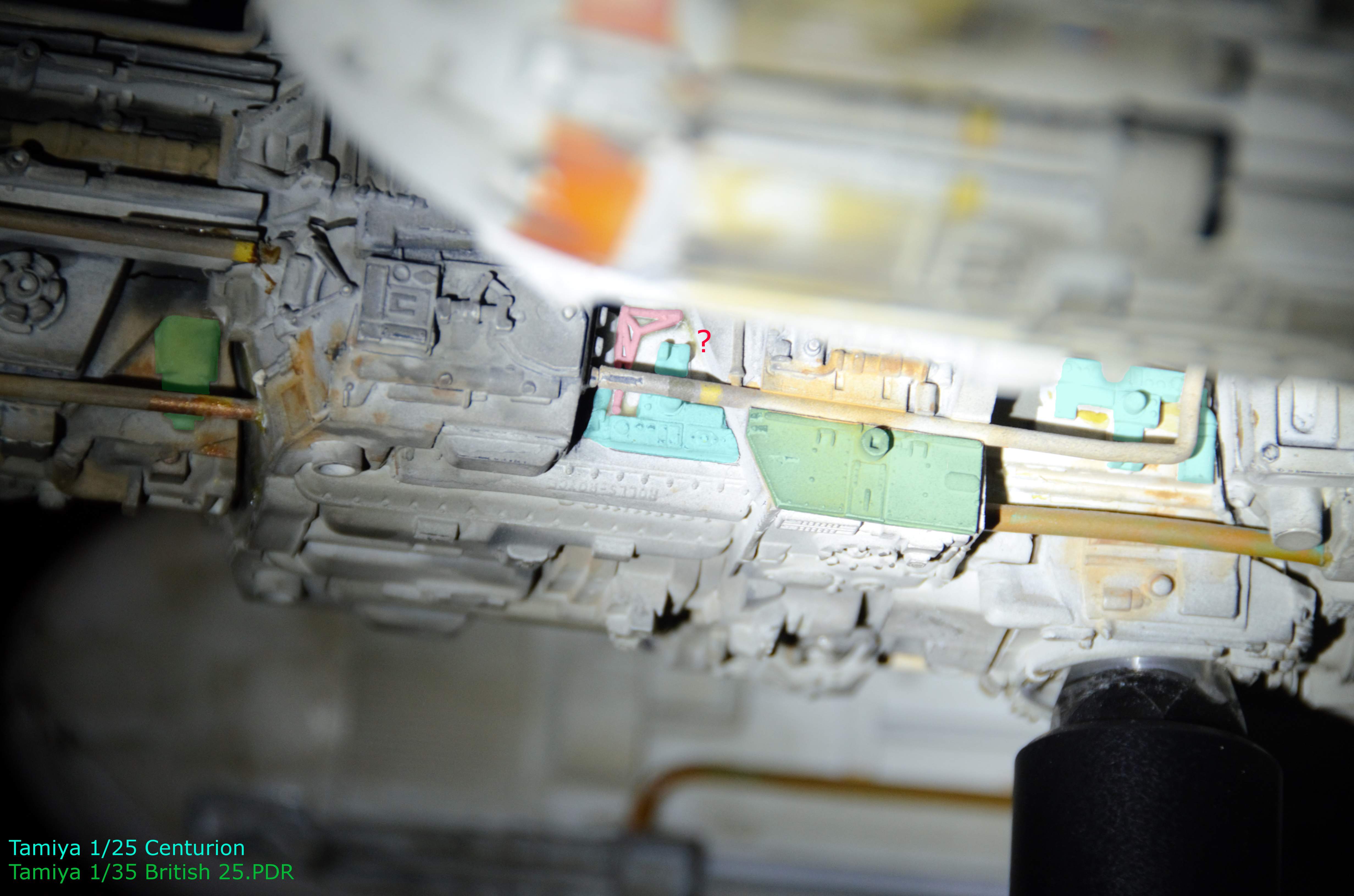

It's funny how much they pulled from the 25 PDR! I don't know the part in red though. I'm assuming it's a ship crane(focusing on Airfix now). Just haven't found the right one yet!
I did ID it, its definitely frrom a ship, think I saw it on the Enterprise or Hornet. I'm away from home for a few days so I can't confirm.
Well this is in the Tamiya Enterprise & Hornet. But the crossings inside are wrong. Though the outside shape is correct!

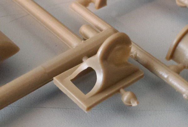

The orange piece on the right looks 90 percent like a Bandai 1/48 Tiger I engine block. They're slightly different than one another. Maybe it's from a Tiger variant?
