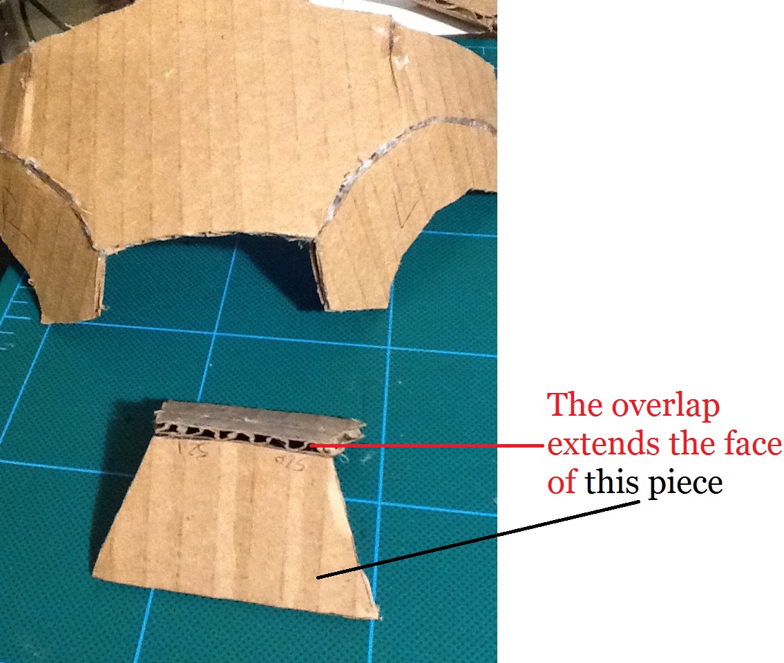

Hello all. I have a question. You'll have to reference the pictures to make sense of it though. It seems to me that the fact that cardboard is three dimensional has the potential to throw off the proportions. Depending upon how you glue it you may end up extending a face, leaving you with a helmet with improper dimensions. Short of cutting the joining edges of the parts at an angle (45 degrees or otherwise) how can you overcome this problem? I tried carving out the back of the cardboard in order to do a fold instead of a cut but I didn't foresee the next problem (see image 2). I'm loath to alter the faces of the pieces to any degree, I fear that that is tantamount to cutting the pieces of a jigsaw to make a fit. Am I over thinking things? This is my first build (and first post on the RPF) after all. Thanks so much for any advice you can offer and I look forward to being part of the community!

A little overthinking, but you are absolutely right about throwing the proportions off. When assembling, just concentrate on maintaining your outer dimensions. Depending on the cardboard you are using, you can trim back the inside edge to make 45s or whatever angle you need, and then reinforce the initial gluing with more hot glue behind the joint. Just use scissors to trim back the inside edges.The thickness of the cardboard and density of the corrugation also affects how clean and strong these corners can be made, so sometimes it's worth picking and choosing the stock you are using if you can. I try and get cardboard that has a laminated and color printed side (like what small appliances/fans/etc come in); the cardboard is usually stronger, has a pretty well-packed corrugation, and the laminate side is usually really smooth and doesn't suck up primer like raw stuff would.

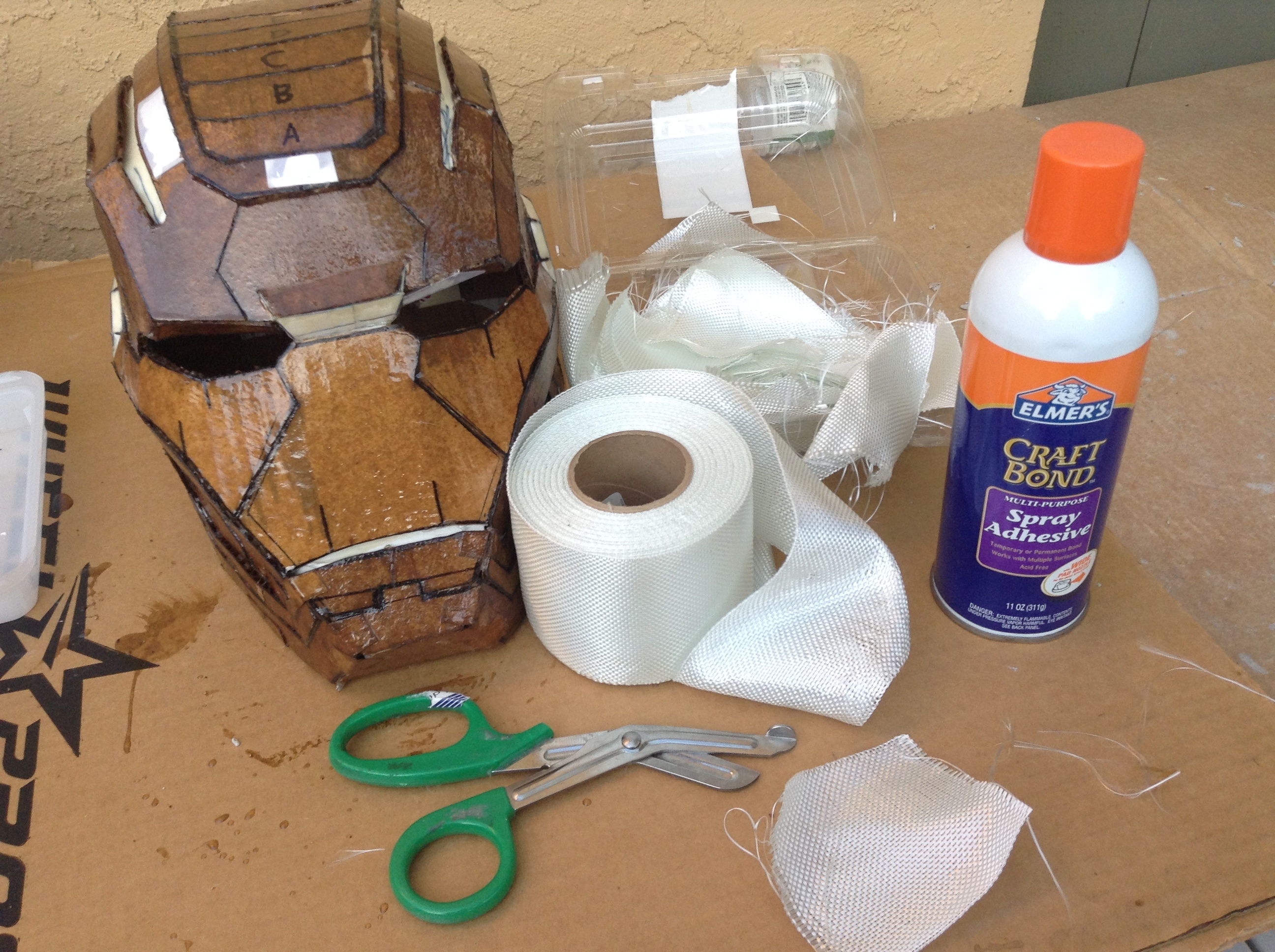

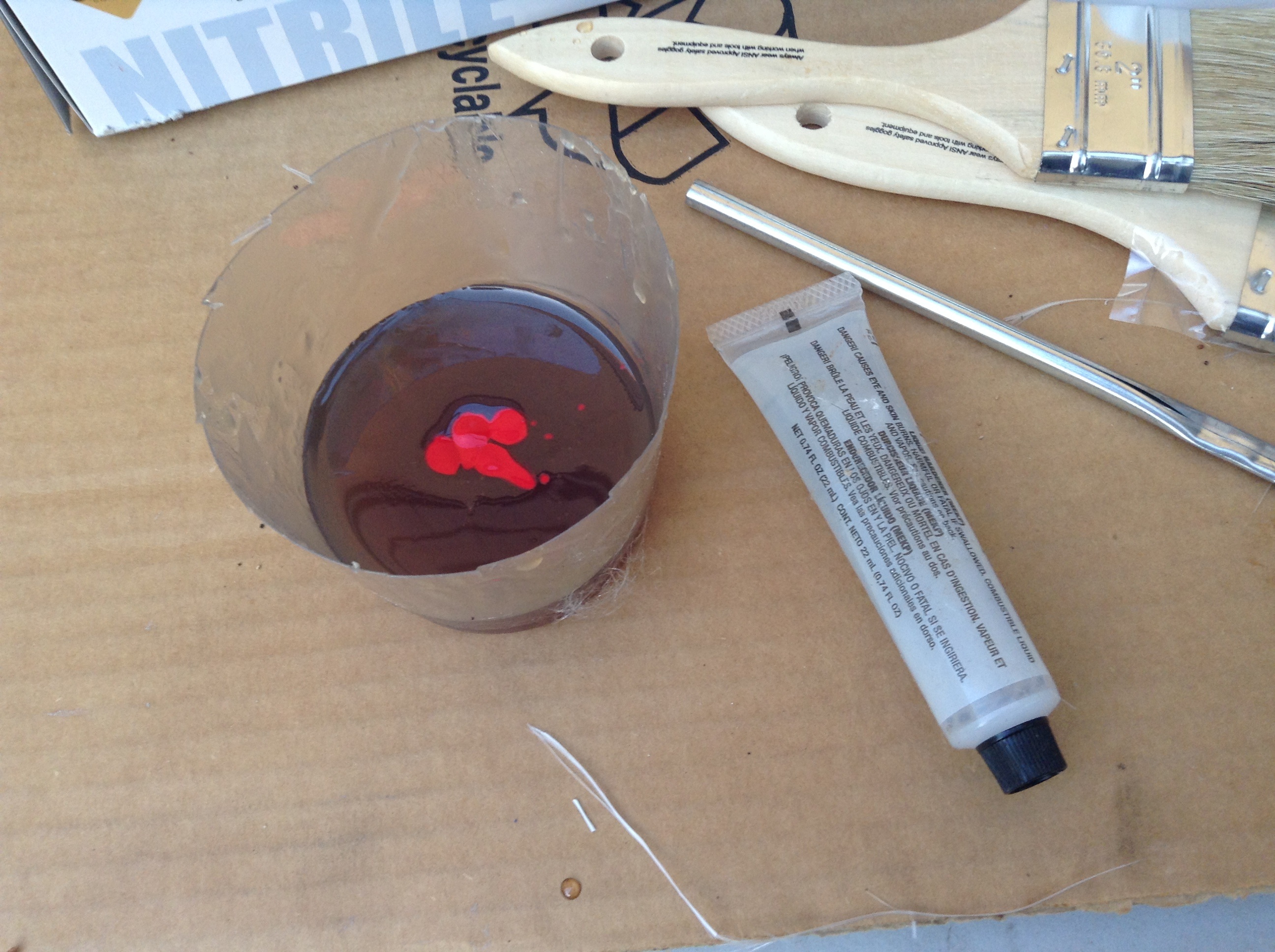

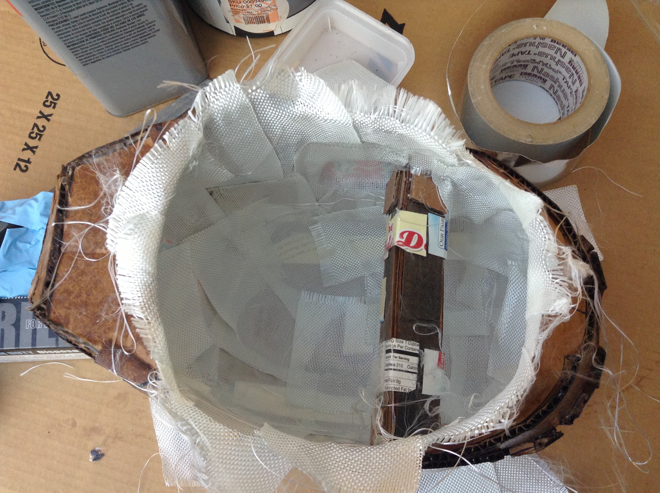

I did notice something while applying the resin to the helmet. Turn it upside down to let the resin seep into the corrugated layers. It is much easier to get under the jaw as well. I will be prepping it for bondo this week. I cannot wait for the bondo tutorials..
