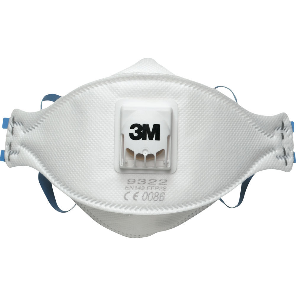

Just wondering, would the 3M 9322 dust mask be suitable enough for both sanding and fiberglass dust? (are these the ones you have laellee ?)
I have a nicer respirator for fumes, but reading from the things above, it's best not to get that clogged right.
Re: IRON PATRIOT Costume TUTORIAL Part 6C -Filling, Sanding Pepakura (HELMET) Page 7
I'm with Stealth on priming the cardboard before bondo. For me at least, it's a lot easier to catch imperfections and proportion problems when the part is a uniform color, less stuff for your eyes to get tricked by.
Madosheet, those would work perfect. Honestly though, I don't even spring for the ones with the valve, I just get the 3m 8200 or 8210s. I've used those for years while finishing both cars and drywall, and I don't have emphysema yet (cough cough), but If you can afford better ones by all means get 'em.
