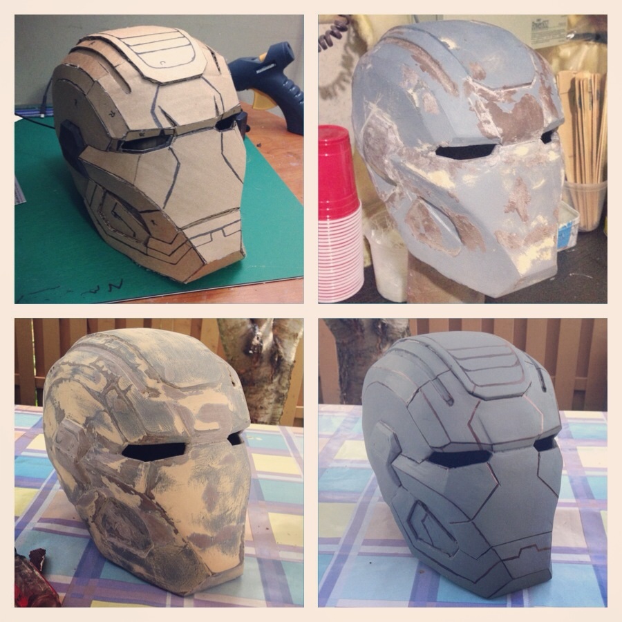

Here's where I'm at so far. Still needs a lot of work.
Can't upload much until I finish this filler stage completely.
Wow that looks amazing just with the mapped out panel lines/etc... I'm looking forward to see how you're approaching those details. Great work.
Re: IRON PATRIOT Costume TUTORIAL Part 6C -Filling, Sanding Pepakura (HELMET) Page 7
I usually just use needle files and score the details in. I have to re draw them out though. The faceplate and chin details are off. I'm ahead of myself though. I still have more sanding and what not to do. Also the sides will need fixing. I just draw them on for fun.
The faceplate has been outlined already with my dremel in that pic. I've already etched in the division of the faceplate and chin.
Man i like this pic. The bottom left looks like the Patriot Kabul edition. It looks camoflauge and with my idea of paint that changes color electronically, man that wold be cool...GM
yeah, that was the first thing that came to my mind when I took that pic. A few people commented that as well.
Since that pic, I did a lot of reshaping the to top sides of the helmet. Looks a lot better now.
