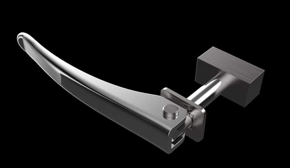

Levers for the run are in production:
Thanks roygilsing @ wannawanga.com for working with us and providing this design!
Enjoy this render in the meantime. :love:
So these aren’t the same levers he usually sells but a variation offered specifically for this run? :oops:
Yep! Roy was kind to examine the reference with me and create a model with the tweaks we wanted to see… just some minor adjustments to his offering for this run.
