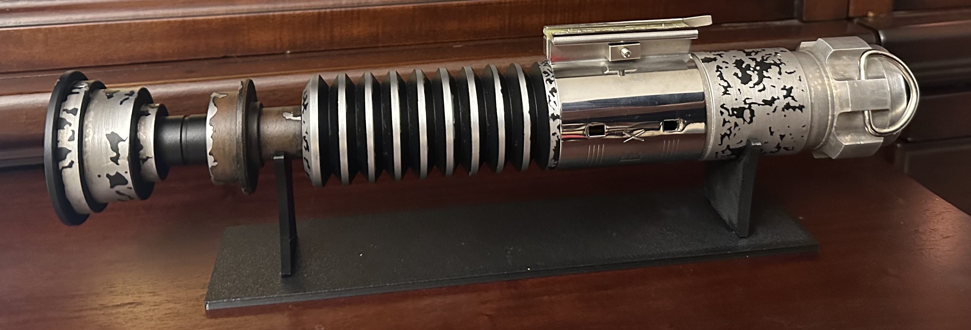

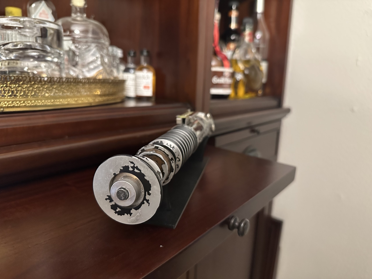

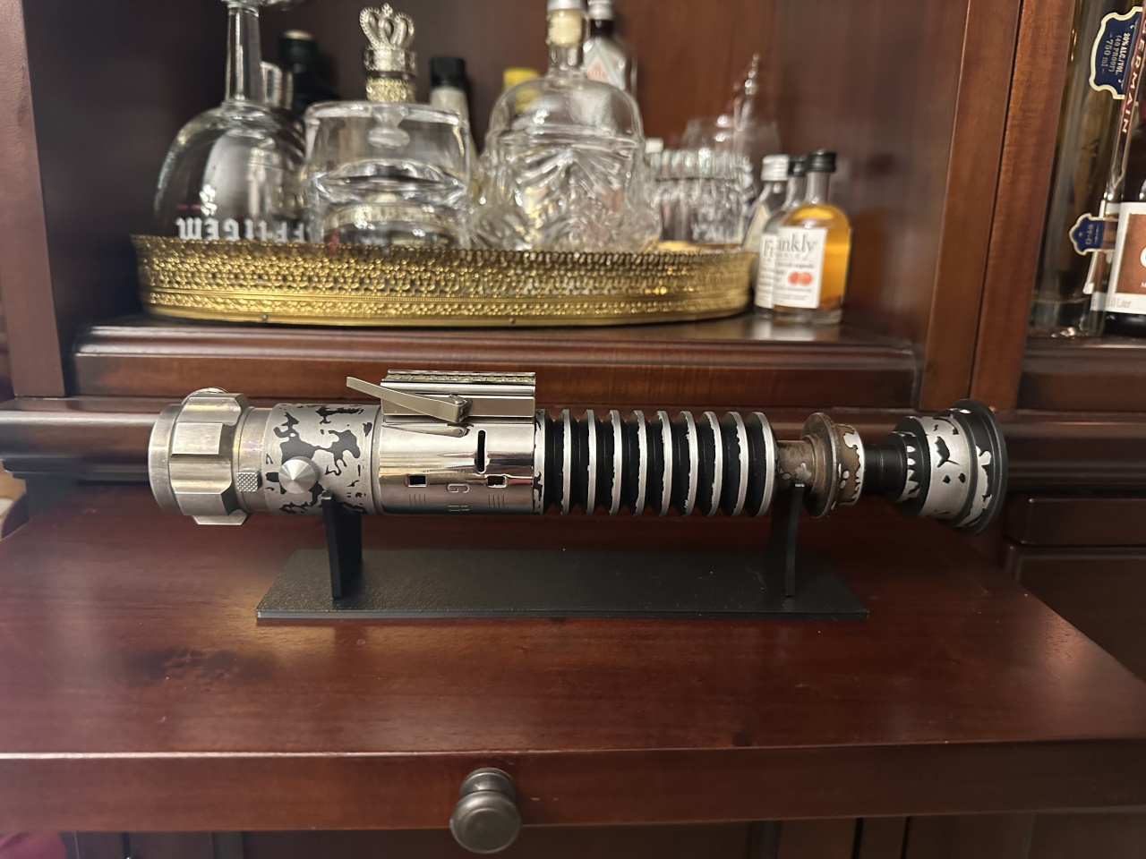

Last Black Friday Korbanth had a sale when you buy three sabers and I "convinced" two other friends to get one also and picked up the V2 kit that was available at the time. I realize it's not as accurate as other versions out there, but this was too good of a deal to pass up.
This is how it came out of the box, though I added solder to the clamp card at this point.
I tried the dishwasher method to at the grey tone, in particular on the booster, but I didn't notice much change. 30s in a Clorox bath worked much better. I have read about Halliwax's chemical method, but wasn't sure I wanted to work with those caustic chemicals and deal with disposal.
I picked up a set of Trooper's Trents stencils, they didn't quite fit. I think they were intended for a different Korbanth release. But, given I wasn't going for 100% accuracy, just good enough to make my happy, I didn't mind too much.
The end result was not bad for a first try. I used the Leather and Flat Brown combination recommended by Halliwax for the neck.
After I took the photos I realized I completely forgot the gaffer's tape. This is probably not the right type, but it could be easily replaced once I find some.
Overall I'm very happy with the result. I need more practice with my airbrush and I'll add the line to top of the the emitter. I was too chicken to attempt the damage to the emitter or the pommel. Eventually want to go back and add some rust to the clamp and general cleanup.
This was a fun project, I might try to pick up another more accurate saber one day and try to go deep on the details. Thanks to everyone who posted to the *long* V2 thread, that took while to read, Halliwax for his videos and Trooper Trent for the stencils.

Thanks! I almost didn't post because I've seen photos of the hyper accurate versions done here, but I'm rather happy with it. I did a K4 Obi-Wan a few years ago, but that was mainly stripping, applying Aluminum Black and some weathering. This was much more work, but at the same time not too difficult given your stencils and Halliwax's videos.
Looking at my receipt it was a "LS6 LukeV2 stunt basic". So, I may have ordered the wrong stencil. But it was only 1-2 millimeters off either too wide or too narrow, I was able to make it work using liquid latex masking to extend it where needed.
