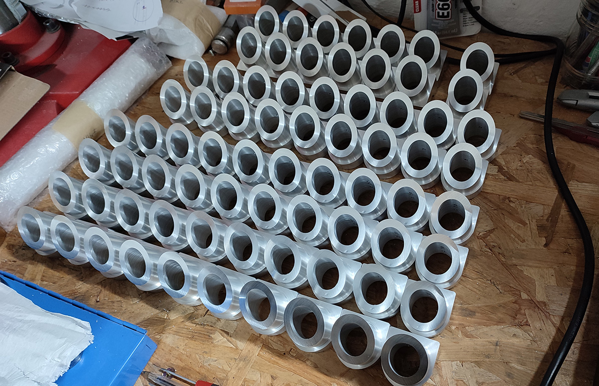

well, we have some huge progress here, I have finally finished cutting all those round corners on the Barbicans and Severed Hand shrouds! this was HELL!
As I explained before, i had to make two parts/jigs to hold the shrouds on the rotating table of the mill for each rounded corner. Those jigs I did 3 times in total, taking basically half a day each time I was remaking it. it had to be so precise, so the center of the shroud was offseted exactly of the right amount. And there was also the damn side with the slightly angled cut:
this is the second reason I had to do that setup so many times. Well I first did all of the round corners of the straight side; and then, I had to tweak the setup for the angled side again for half a day as it was still not working perfectly.
Anyways, 5 days later, we are done with all the round corners. and after I milled them, I had to go with a MDF caul with sandpaper and clean and adjust very slightly all of the angled sides to be as accurate as possible as it was still very hard to be perfectly consistent in the result with the mill.
That means that there can be some slight fine file marks and sanding marks on the angled side of the shroud, and this is all accurate to the prop, as can be seen on the photo above were the paint is damaged on the angled line, and on many other pics, all part of the handmade look of that prop!
This means that on some shrouds, you'll have a side that has been fine sanded, and a side that is raw machining. On some of the shrouds, I sanded both sides to make sure everything was lining up. but here is a very very close example of both sides finish that can be expected:
for the kit people, you'll be free to sand a bit the shrouds as well, but keep in mind there are several coats of weathered paint on the Barbican shroud, so appart from knoking down the edges a bit with sandpaper, there isn't much to do on the shrouds in my opinion.
Alright, I am very happy and relieved that this step is finally over, this was the last big hurlde. Tomorrow, i'll cut the front angles of the shrouds and we will be close to finished!
cheers all :)

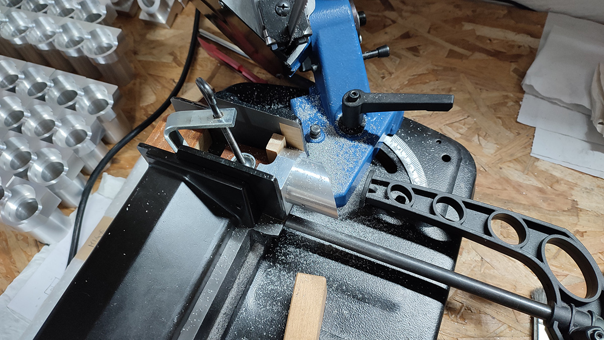

alright, so this is probably the coolest step on the shrouds, cutting the front angle and cleaning it:

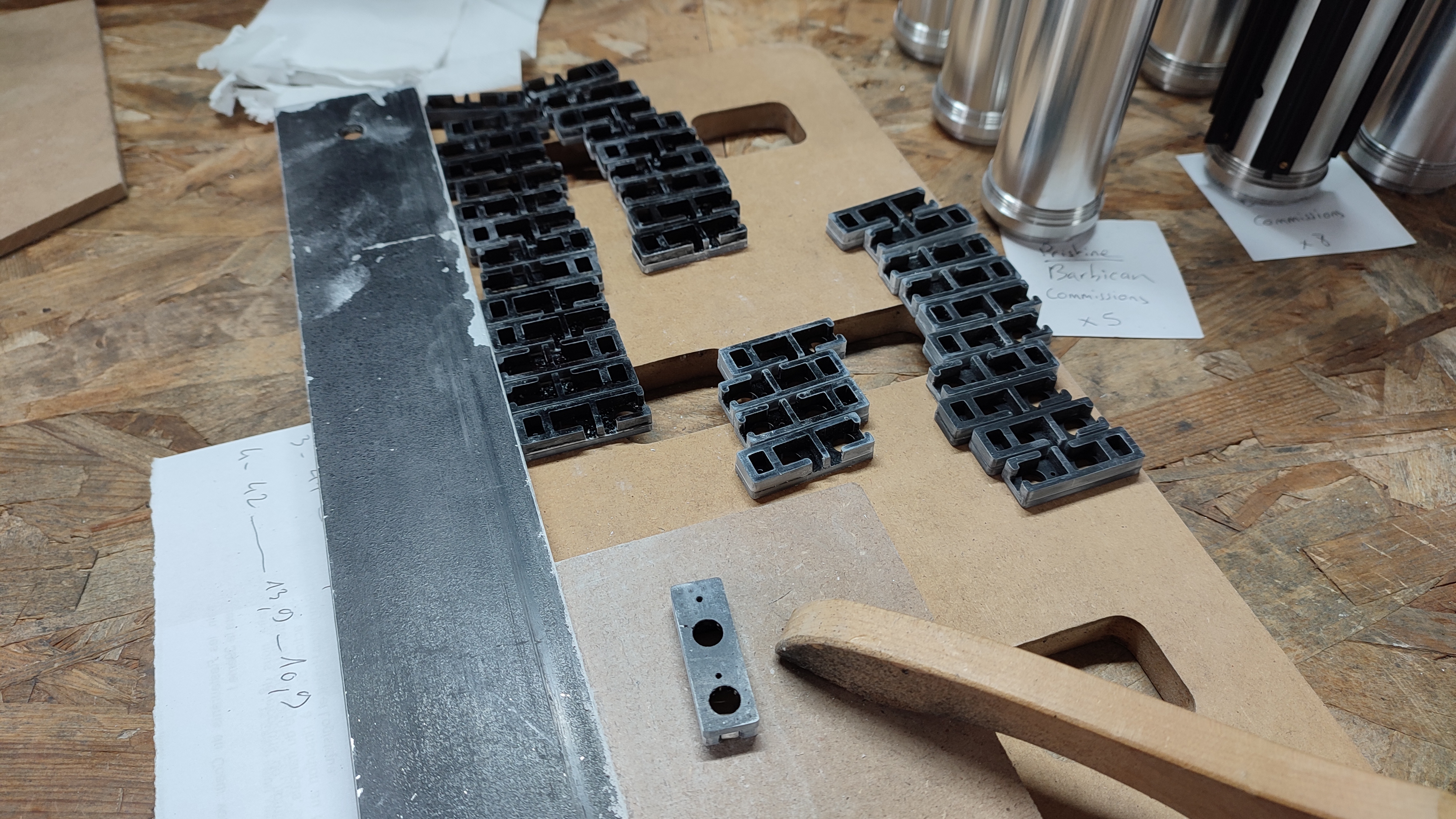

The kits are finally ready. I have spent the day packing small plastic bags (reused to be more ecologicaly friendly) with all the small parts for the kits. Screws in a small bag inside another bag with the plastic or aluminium parts to separate a bit and keep everything safe.
I'm still struggling a bit with the activation boxes, I had a few already ready from when I did the square shrouds and have sanded a few today but it is super annoying and painfull for my fingers to do. So, since we have a more modern resin printer now, I have negociated with my wife to pause a bit her own run today and have launched a few new activation boxes on it. Basically, they are a bit faster to sand, but it will help me a bit already!
since I now have extra, i think I'll include a few raw parts for people that order several kits, so they can have more choice, or at the very least possibly see that the sanded ones are a better (I hope!) and that it is annoying to sand them yourself ahah!

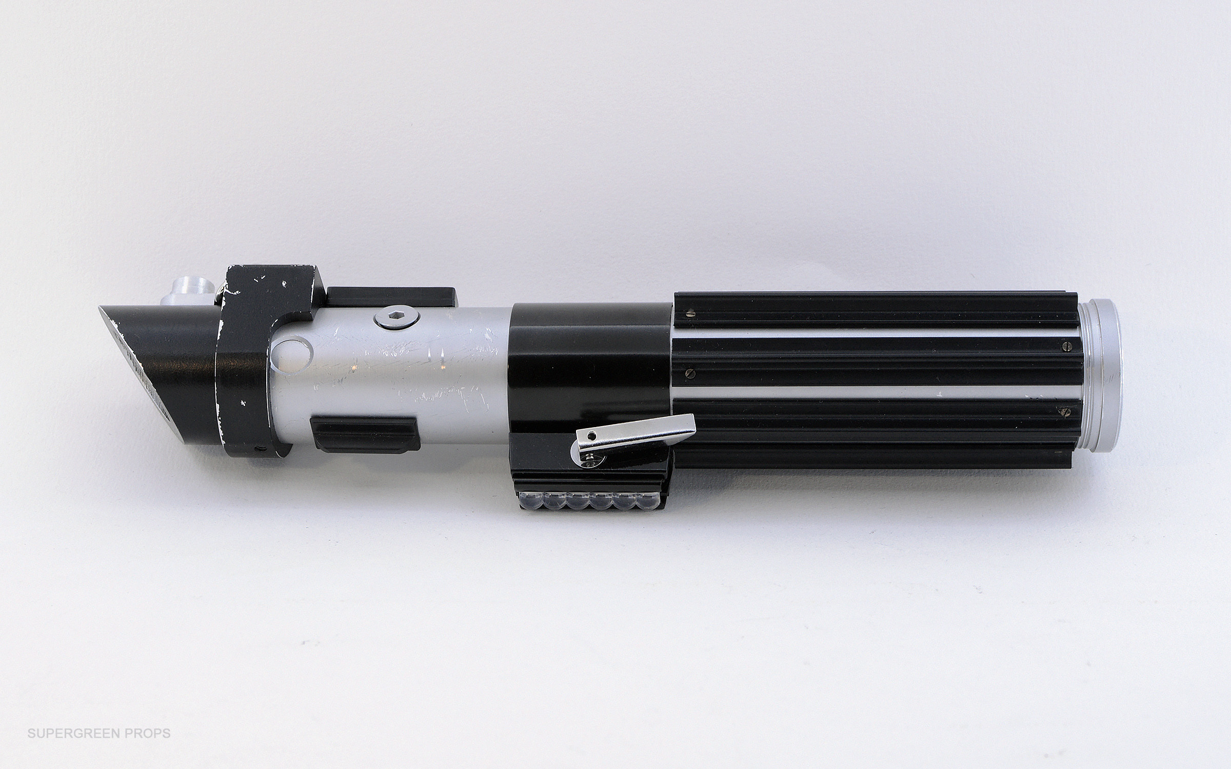

Square shroud, those are final photos with production parts.

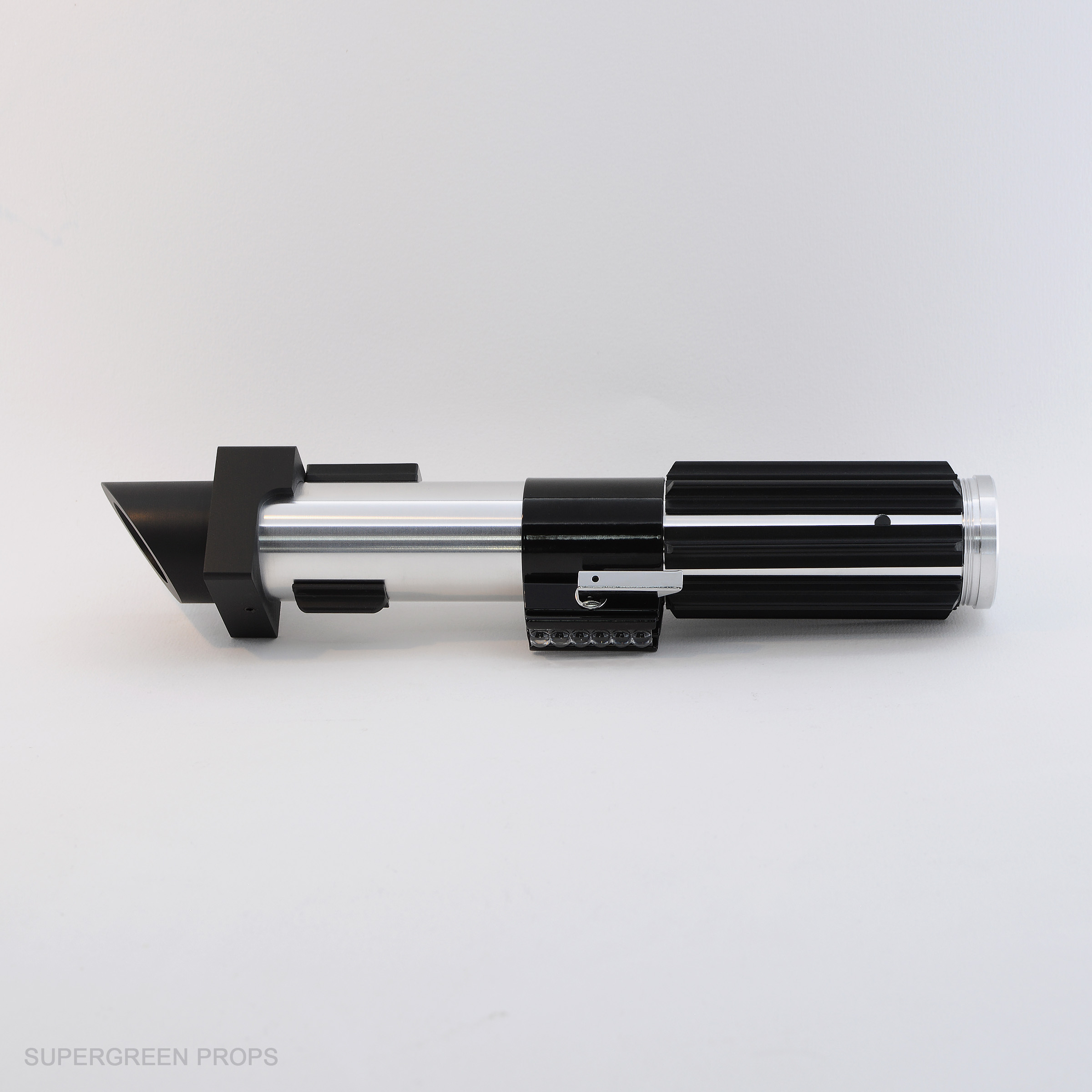

Square shroud:
those are the actual final photos from the production square shroud, accurate to what you'll receive.
There are two variations, one with the hole visible between the grips and one with the grips covering the hole. I have an equal number of each left for now, I hope people will buy the covered hole version as i don't really want to remove the grips and start over on those :oops:

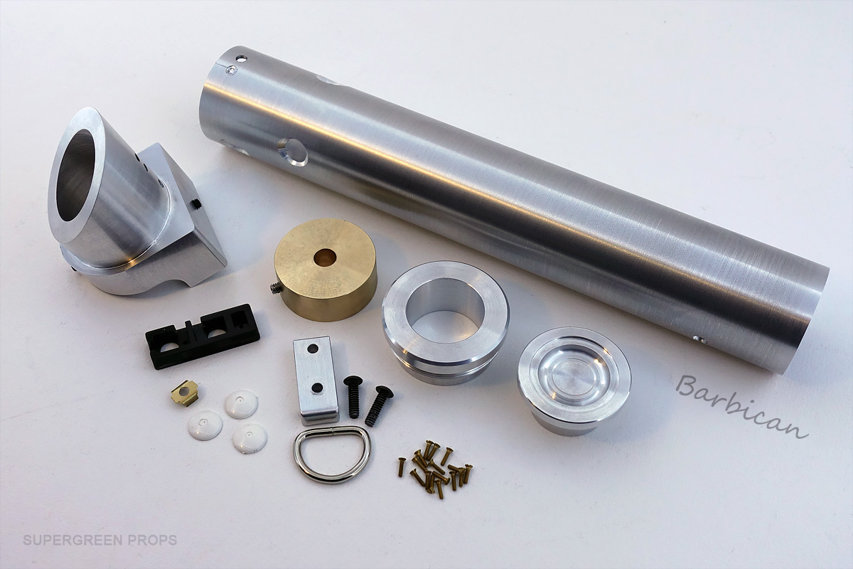

Barbican:
those are the prototype photos, they show what the final version will look like but I am already trying to best that for the weathering and will take final photos when the time comes.
more photos can be found here:
there will be two versions offered:
- weathered, as shown below but even closer to the original, weathered aluminium and brass, painted clamp
- pristine, this will be an accurate replica of the Barbican with the wonky grips and all the details, BUT, the 7th grip will be installed, the saber will not be weathered.

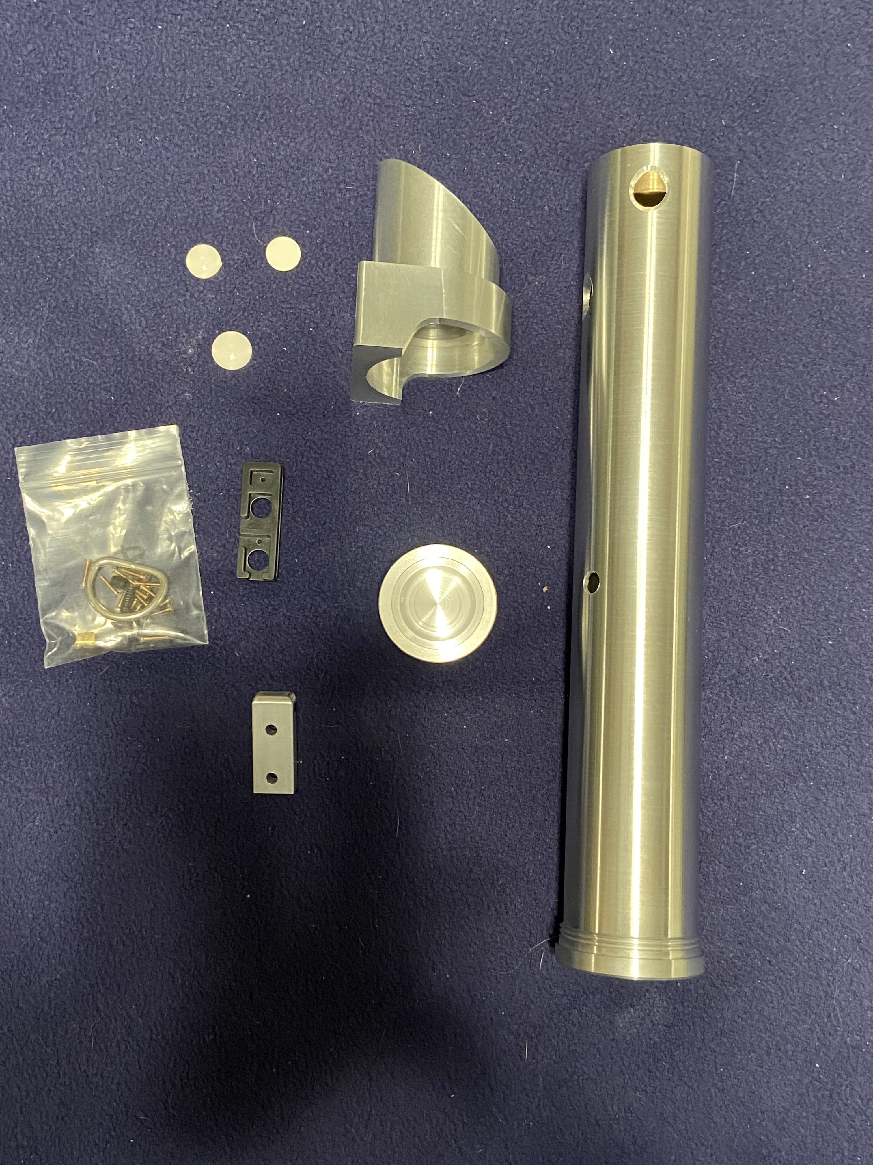

Severed hand:
same, those are the prototype photos and I will work hard to best this. the black detail in the front hole will be painted on the final version, bubbles will be painted silver, shown here is a custom saber shop clamp but the final will be a nice Roman clamp.
I have planned only this one version for now, but can take reservations for pristine sabers when you get my PM as I haven't started painting. Price will be the same as weathering is minimal on those and pristine paint is also hard to achieve and maintain :)

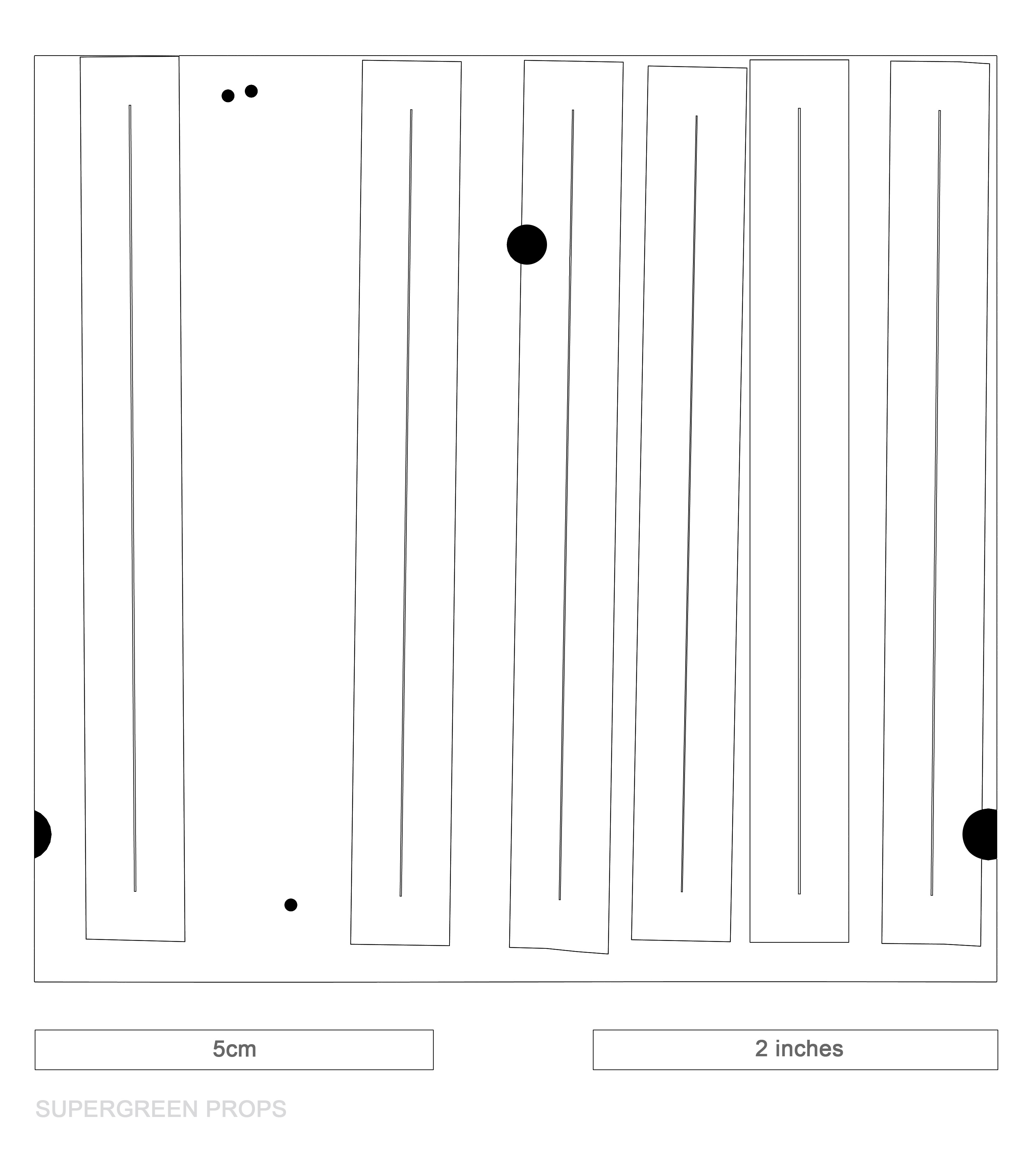

It it possible I have forgotten the Barbican grip template in a few packages, I was trying my best to organize everything and ship immediately and in the stress of the process, I might have forgotten a template here and there as it was a bit on the side on my desk when preparing the orders. Really sorry if I forgot!
here it is for you to print in case I forgot it, it should print 1/1 if you setup your printer to print 100% of the file size. there are two areas in the bottom to check the size when it's printed:
