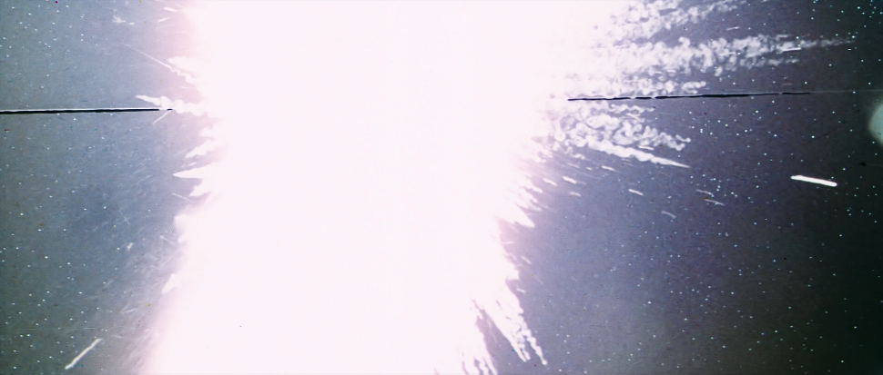

And the TIE that got blasted by Wedge.
A cleaned up version is fine, and I would probably choose that most of the time for casual viewing. But I still want an unaltered version in a hi res format, as a fan of effects history I want to be able to see the original as it was.
