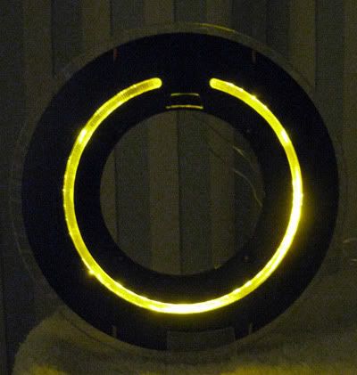

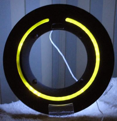

Here's some shots of my disc mod. The colors don't photograph well and aren't very true to life, but you get the general idea. I haven't done any wire management yet so everything is kind of sticking out all over the place too.
Incandescent light, both rings lit. It's a Rinzler disc with clear Kevin Flynn rings.
Lights off. The center ring looks yellow, but what was described as "light yellow" actually looks cheeto orange in real life.
Each ring is hooked up to a separate switch so I can have only one lit or both.
The LEDs that were supposed to be yellow annoyed me that they weren't the right color, so I cast my own center ring and painted it with transparent glass paint. It's not as green as it looks in the picture, but the blue cast of the white LEDs definitely gives it a green tinge. Some sheer fabric in a warm color should help diffuse that. If not, I'll have to experiment with mixing paint to get the right color.
I was hoping to finish it this weekend, but now I have to wait for an additional string of white lights to get here. orz
If you don't mind me asking, where did you buy them? Your disc looks awesome! And were they hard to wire? I know pretty much nothing about wiring LEDs and such, but really want to learn.
I bought them from a Chinese seller on ebay. I know virtually nothing about electrical wiring but these were incredibly easy to hook up. It helps that they're already in a strip so all you have to worry about is what wire at the end is positive and which is negative.
