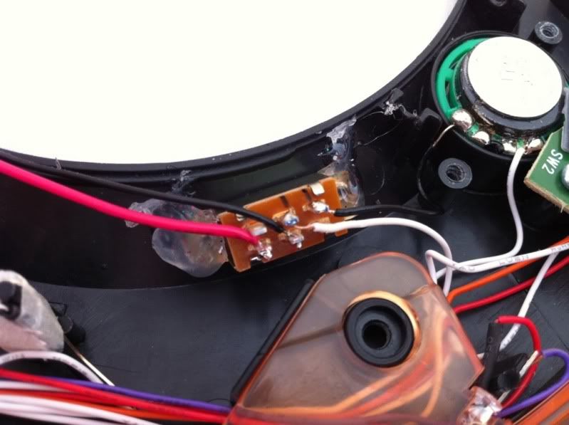

Been reading here for months (mostly that massive costume thread!) and wanted to share my disc mod.
I wanted mine to be animated and not solidly lit so was happy to find the mod posted by FreakT. The only downside to that one is that it's a permanent change to the functionality of the disc. So in order to retain the original and still get what I wanted out of it I did the following...
Soldered a wire to each of the spots on the motion sensor that lead over to a new switch.
Cut one of the wires from the speaker and then soldered a new wire onto the speaker that leads over to the new switch.
Soldered the red and black wires from the motion sensor to the new DPDT switch. Soldered the wire that was cut off of the speaker to the switch and the new wire from the speaker to the switch. The switch was placed in between the speaker and the motion sensor. This worked well for placement and usage when it's being held.
Here is the switch from the outside. The hole is a little rough and the switch is a little tall but it worked out pretty well for my first mod ever. This is also my first attempt at soldering. The switch in the "on" position makes the disc function as it does out of the package. When switched to the "off" position the disc will run through the animations and the speaker is bypassed.

Well congrats on your first post. It is a good one too. Very detailed I may PM you just to get some more detailed info on what you did and I for one would love to see a Video of your mod in action. It also looks really good for a first time ever attempt. I will freely admit my first soldering jobs did not come out that clean. Good Job and welcome to the board. I look forward to your next post.

this was my very FIRST attempt at a soder job, so its not pretty, but OMG it worked! :D you have no idea how happy I am
I did my disc with this mod (first soldering job ever) and it worked! Then two people asked me to do their discs. First one worked! Second one did not. the lights would not turn on at all. So, I broke open the packaging from the second disc I bought months ago and tried again. Once again, dead disc. Is there something I'm doing wrong? I know that's a bit vague, but really, I swear I did #3 and #4 just like the first two. They all look pretty much like the photo above. Did I do something that was painfully obviously wrong?
