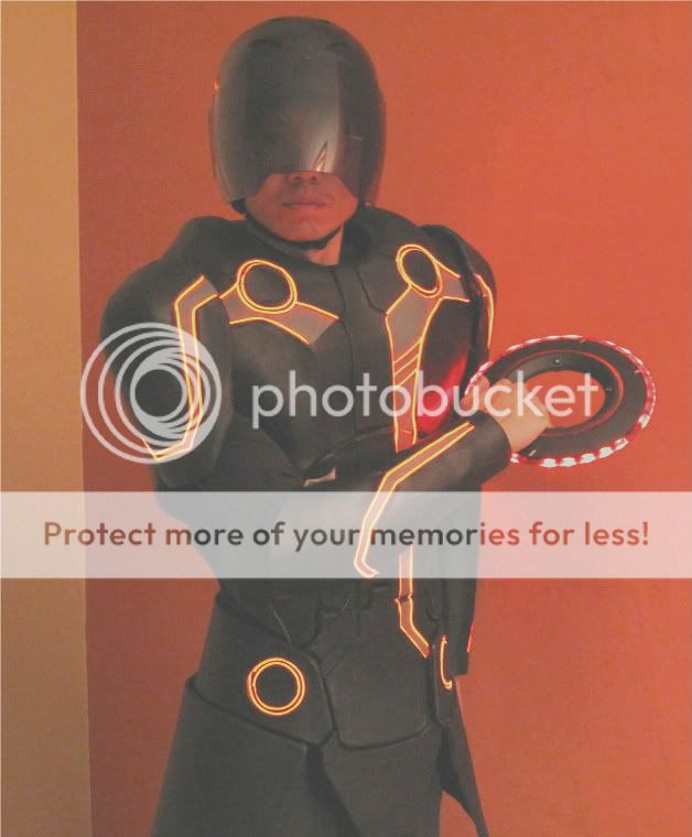

Almost done with my costume. I've only got the legs and staff left to do.
Here's a progress pic.
Way to go!!!, the one to beat...if someone could.
Fantastic job!!! Way to go!!!
Wow!!!! Incredible job and you must be so proud :thumbsup I know I would be. I am trying to figure out where all your wire connections are being powered too. I am going to have hidden wires and extention plug n play connectors for my el wire going everywhere eventually ending to my project box on my back. Excellent work!!! Please tell me you got tix to go with our group to the premiere on the 17th at Universal??? If not. Get yours! I hope there are even seats left.
Thanks. I am happy with the overall look. My only regret was tapering the edges with a dremel which left a rough surface rather than a sharp straight edge of a scissor cut. I wanted the top layer of foam to look less like a glued on panel. It also looks a little messy underneath with foam patches holding the wires in place. The 12v battery pack is in the identity disk holder and the inverter and fader is in a hole cut into the foam of the chest. All the EL wire lengths(about 10) have all been tree spliced from 1 speaker wire to the 5 way splitter at the inverter. The other 4 quick connectors are for each gauntlet and each shin pad. I am still trying to figure out how to reel in the extra wiring once I'm wearing it since mobility is limited. I got so many velcro straps going that I'll be making popping and tearing sounds as i walk. LOL. I even designed the hip pieces to come apart so I can sit down.
