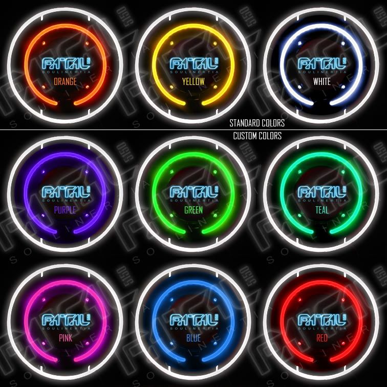

Yes, orders are now open! The Full Kit does illuminate both sides. It's a bit of extra work, but not too much. For those that want to attempt it, extra 'C' rings are available :thumbsup
ok I like this new disc a lot! I have a question though, is it possible to get a green inner glow by changing out the LEDs or would those pieces need to be cast in green? (or just put some green tint over the top as a hack)
All of my rings are cast in translucent white to be used with any color LED. I'm offering 3 standard LED color options, but for a little extra you can pick custom color LEDs. I like your tint idea though.
I'm going to have to experiment with this.

WOW! Soulinertia how the heck did you get the back side to light up??? maybe I should just go check out your vid ;) very nice! I have my clear rings now, thanks to the Kevin disc but, may order one C-ring from you to attempt to light up the back side of my disc too.
Do the instructions come with your rings as to how to do the LED lighting in the disc?

Wow, Soulinertia! Those custom disks look awesome! I'm going out to get my disk today; there is a big sale on Tron items near where I live, and myself and my friends who are planning on making costumes as well are going to take full advantage of it. :-D
Yeah, those discs look pretty awesome. I'm currently in the process of modding mine so it'll have a lithium ion cell phone battery inside to light it with a port so it can be charged.
Also, what sort of EL wire would be recommended? High Bright?
it all depends on the color you are trying to match I think. EL wire by default as others have said is very fragile and prone to breaking with wear and tear. if you can, get tester strips of each and see which you like best.
If the EL wire is going to be lodged in the disc and not bent there shouldn't be too many concerns about breakage.

Good point, and also not a lot will be needed. I was thinking more for the idea of keeping it matching whatever light method is used on the suit. If you aren't building a suit, going for white, or trying to get as bright as possible, go with an LED strip. I can't remember where I heard it but the EL wire doesn't emit very well from inside the disc and LEDs are much brighter than even the High bright EL Wire.
