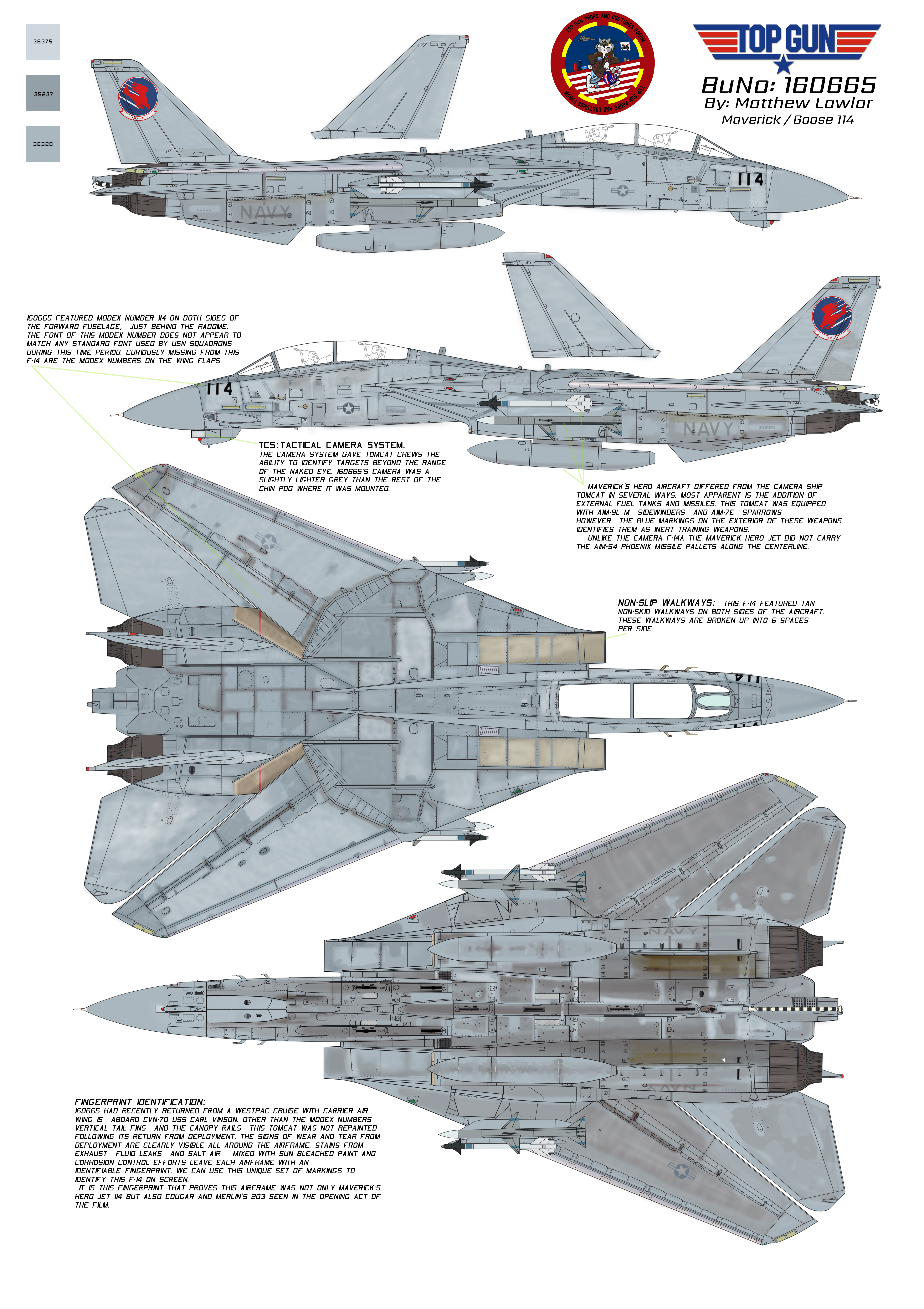

Here's 2 more. Or i should say 1 more with 2 different sets of markings. Bureau Number 160665 was Maverick's Hero jet in the movie and wore Modex number 114. However this was not its only role It was also Modex 203 and appears mostly in the opening act in that number as well as a few odd shots here and there in the rest of the film. If you look closely 203 is the jet that performs the "Inverted" scene with the Mig-28/ F-5. Hope this and the other graphic help all of you modelers out there. At some point down the line I'll try and get one done for Iceman's 104 jet as well as Maverick's 114 from the final act. ( yes that is a different airframe)
cheers.

Wow, I didn't know you were on this forum, too, Matt! Hey, guys, this is THE Top Gun. He's the guy to go to if you want to ask anything at all about the filming jets. Thanks for those super-accurate weathering guides, Matt. Am I getting dizzy from all those airframe differences! I just wish I hadn't painted and decalled my models -- I asked you too late. But at least the guys have that chance now.
So.. the camera bird never sported drop tanks because of the camera mounted in its spot. Makes me want to remove the tanks from Mav's jet but theyre super-glued on : )
