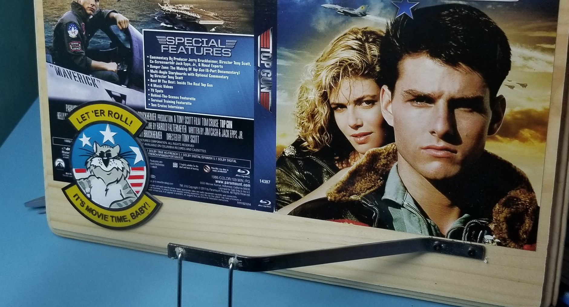

Thanks for the kind words, guys! : ) Hi vj mojo, I found some barbecue skewers to use for the stands. I couldn't find a flatbar the size I like from the hardware store -- they were either heavy gauge steel which was too thick to bend and would rust later on, or aluminum which wasn't too sturdy, so the stainless steel barbecue skewers were a lucky find. I don't have a picture of them as I bought them but they were about a foot and a half long and a quarter inch (around 6mm) wide. I cut them up and bent them to a "Z" shape using some hand seamer/sheet metal pliers. The top of the "Z" lines up with the flank of the Tomcat. I glued on 2 styrene tubes inside the tomcat about an inch apart and drilled two holes on the Tomcat's flank (a painful but necessary step -- no one wants to ruin a model but it had to be done and I figured it's the hidden side, anyway) I then cut up a couple bicycle spokes and bent them to an "L" shape. The long side goes into the Tomcat and the short side goes into holes drilled on top of the "Z" stand. Hope that helps : )

For the banking position I just used a different pair of spokes -- bent at an angle.

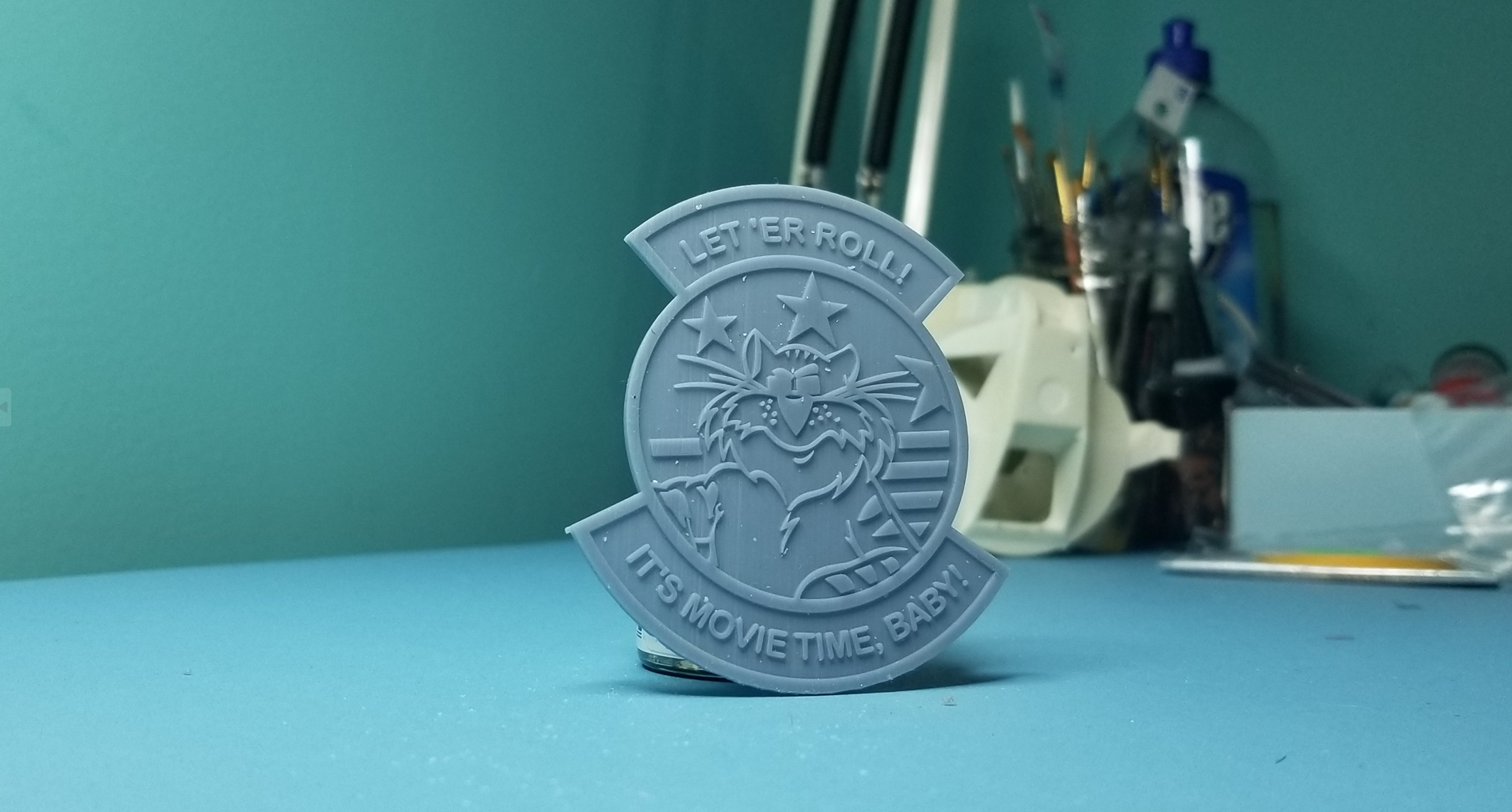

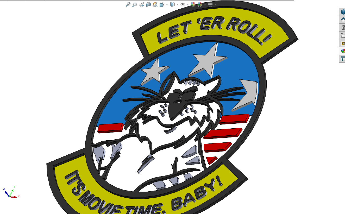

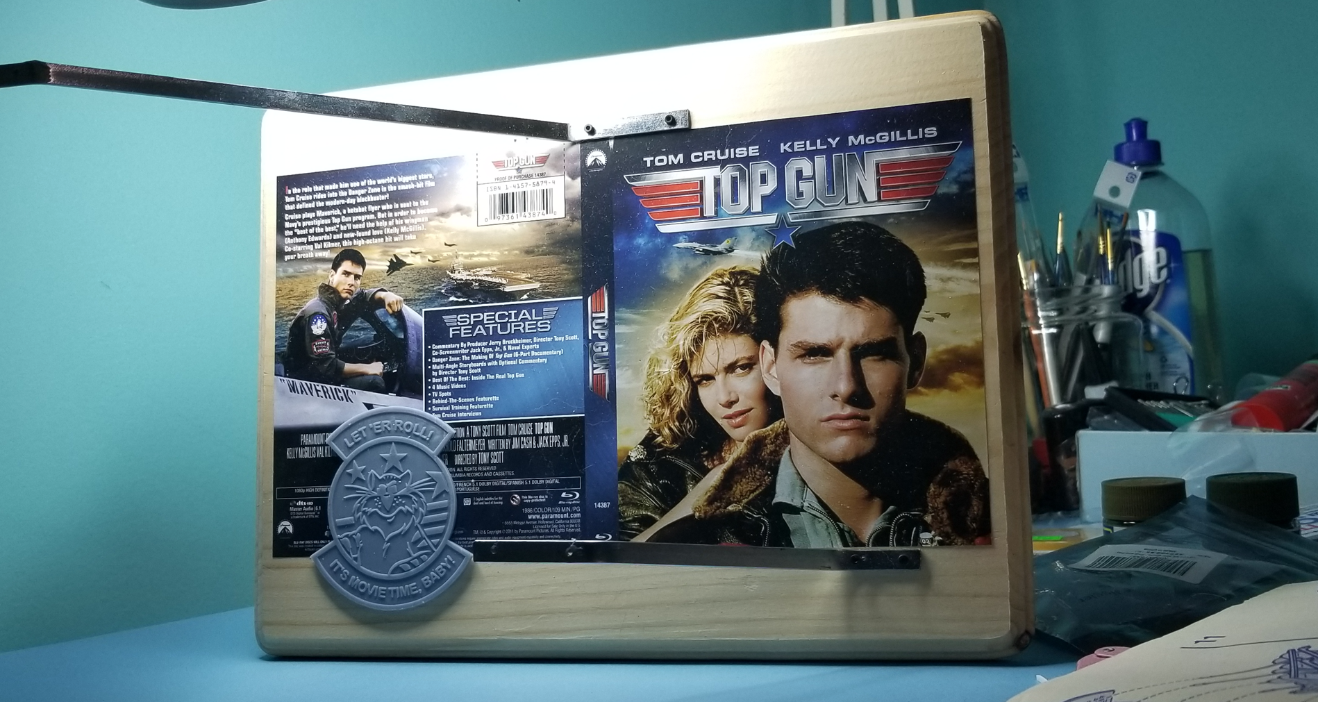

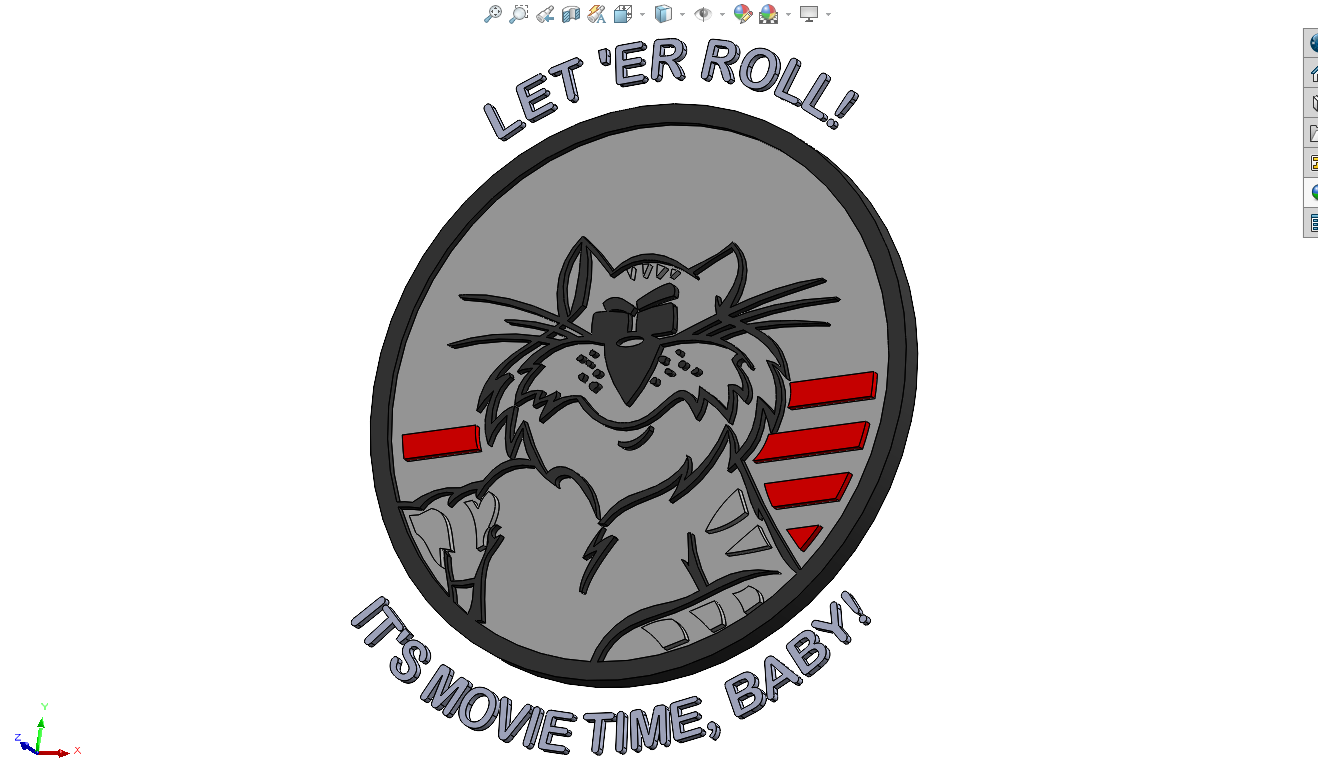

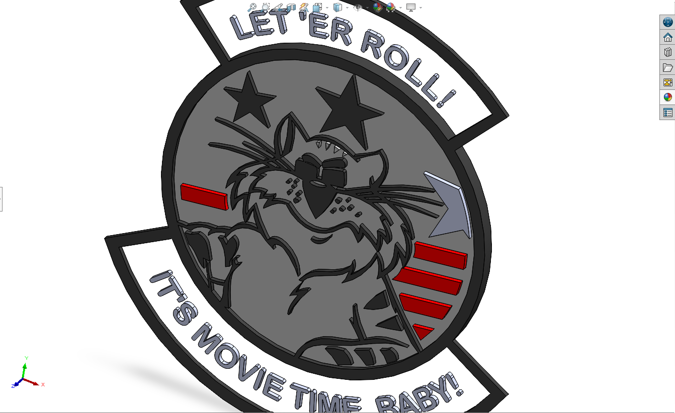

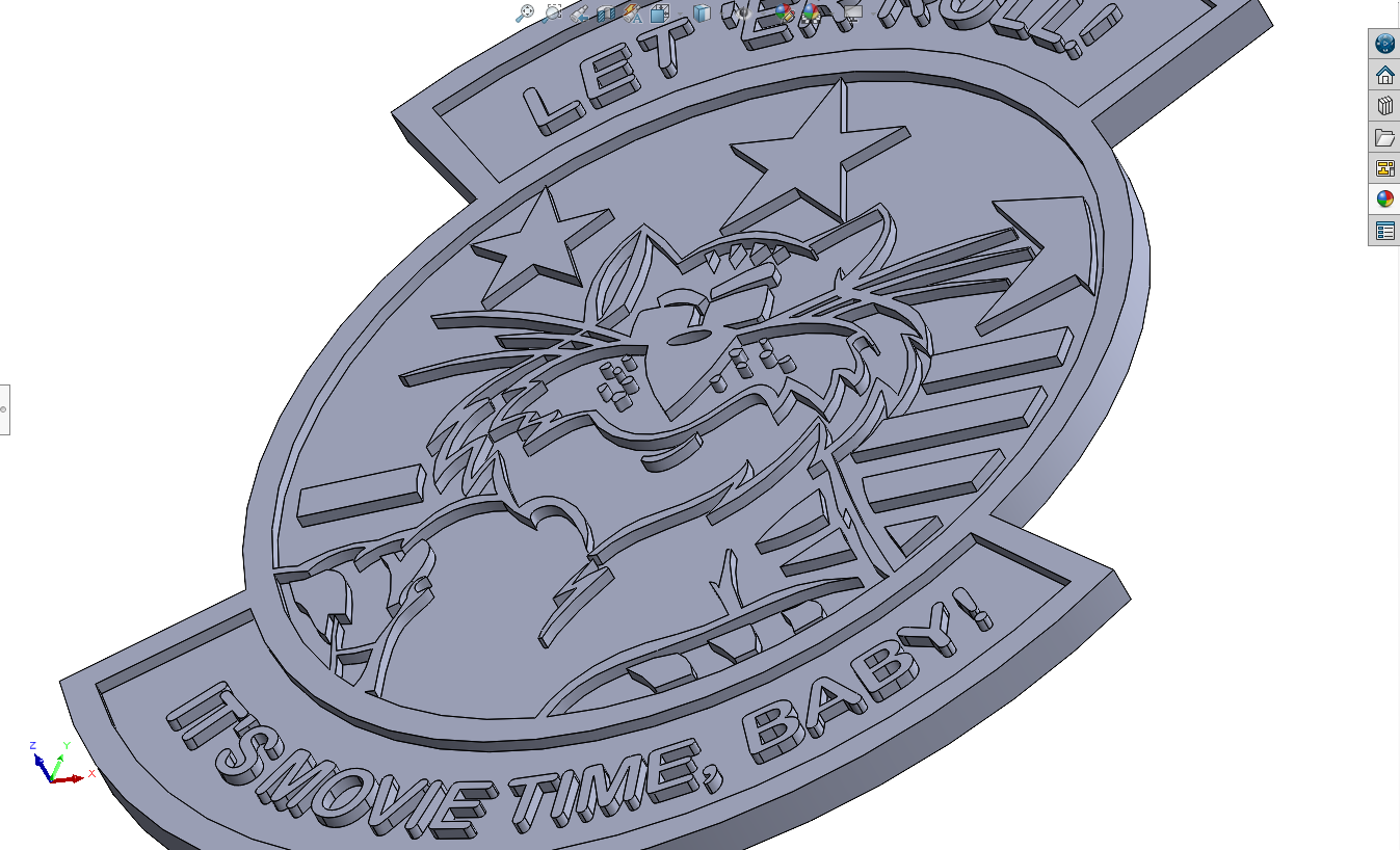

A little something to spruce up the base : ) The base looks lonely with just a DVD cover slapped on. Tomcat patches have this cool and brash slogan and variations to it that's pretty cool and ran the gamut from "Anytime, Baby!", "Been to Baghdad, Baby!", "You're Booty, Baby!", to its retirement slogans like "Bye, Bye, Baby!" and "Well done, Baby!"
Why not "It's Movie Time, Baby!", lol. The Tomcat did a fine job in the film, managing to look good while sporting a scruffy paintjob : )
I'll give it a lick of paint and see how it turns out in color.
That's awesome! I love the play on the patch slogans.
