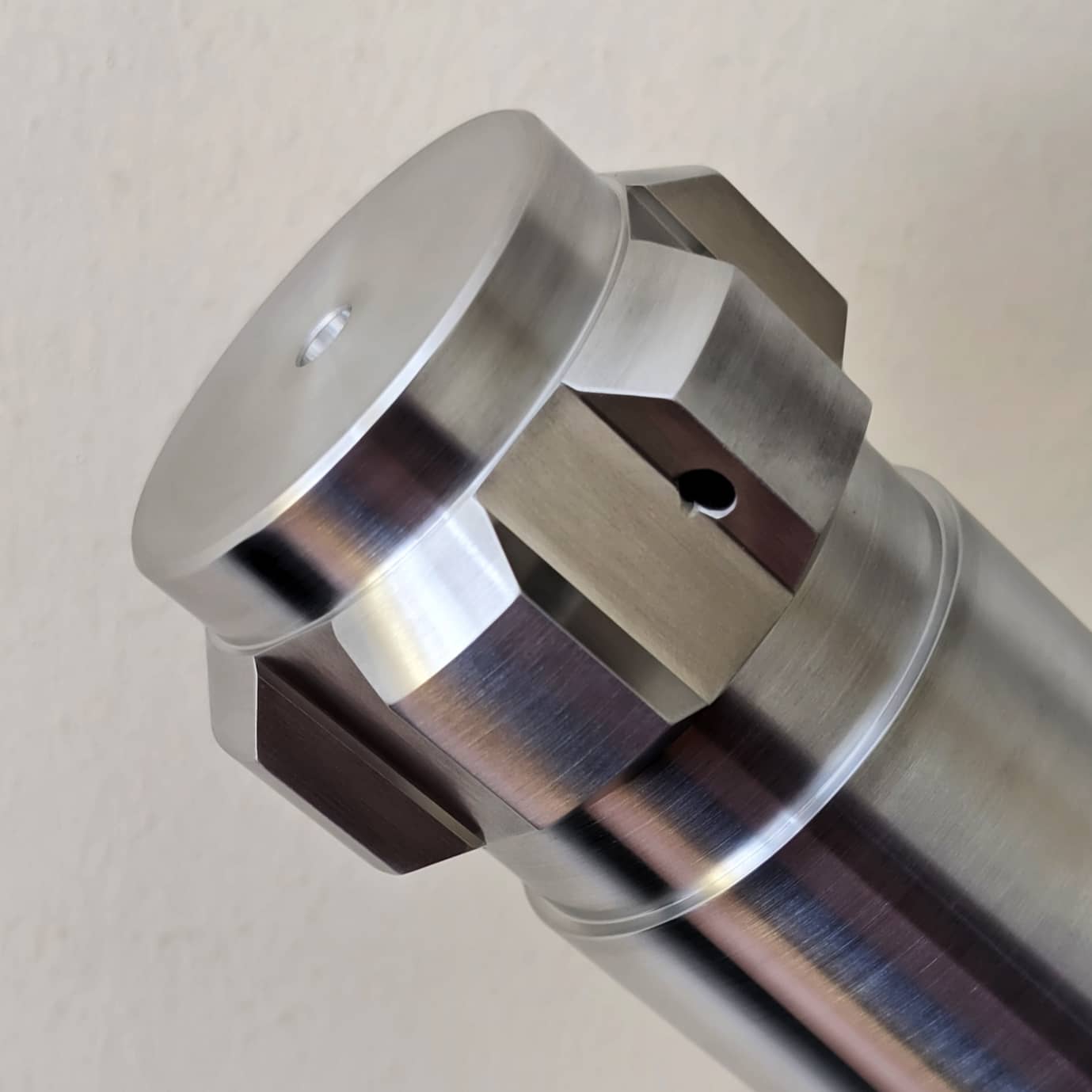

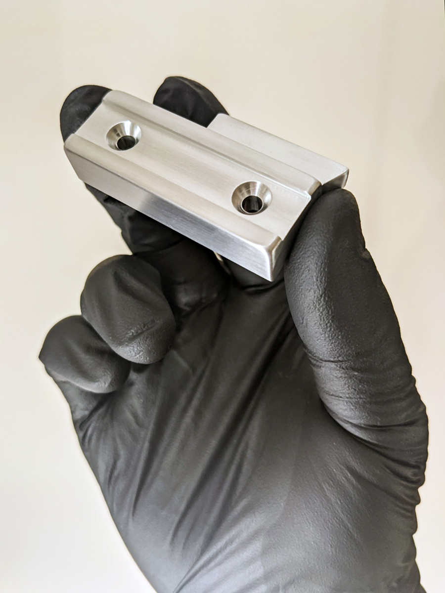

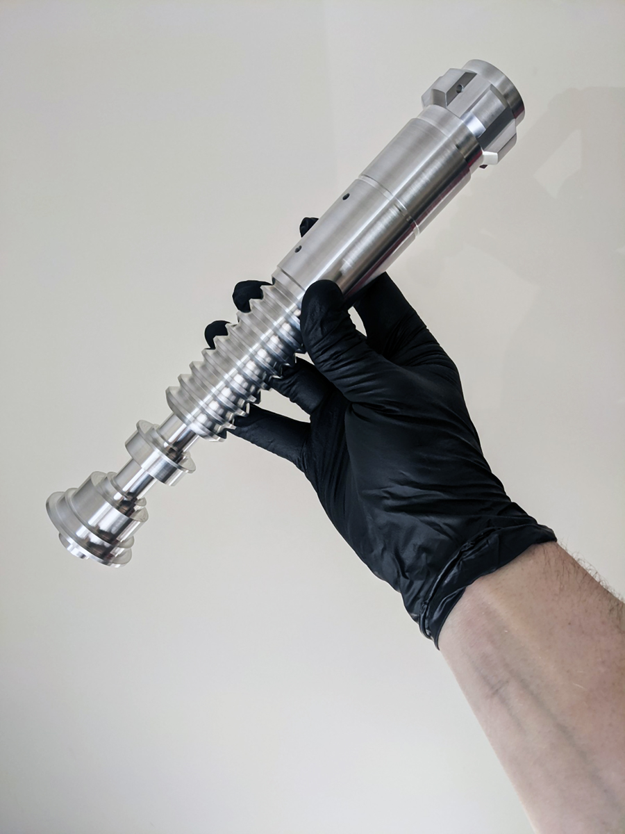

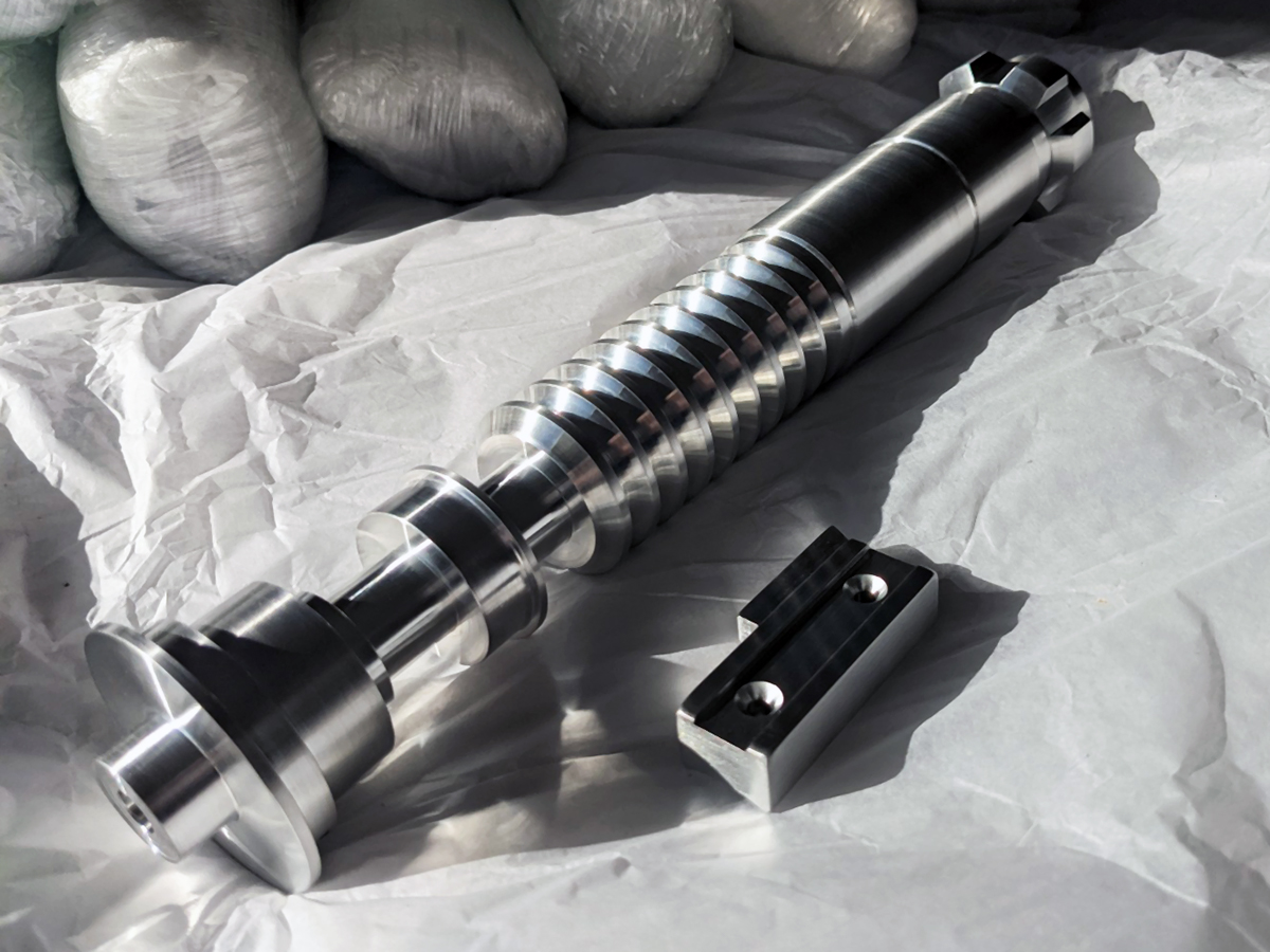

Hi Everyone. Just a very quick update... Here are a few shots of the parts, which arrived this afternoon, as promised.
All looking perfect so far! (y) I'm currently busy checking through them all, which will take a while! :D

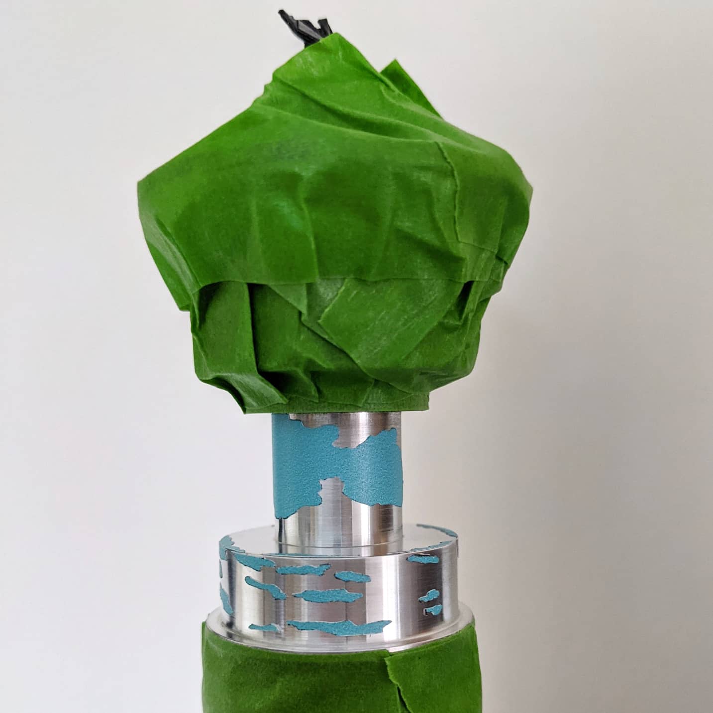

Having chemically treated all the emitters and cleaned off any loose oxide, the next step was to mask off the necks:
The stencils for this section (N03/04/05 on the stencil sheet) should be put to one side for later.
Next up, I mask off the "clamp" section and the pommel, leaving just the "booster" section exposed. I then apply the stencil for the booster without using transfer tape:
Most of the ring sections can be applied without the use of transfer tape. Just be careful to position them in the correct place in relation to the centre line. The Upper/left ring on the sheet is always the one closest to the emitter. Also, be careful not to touch the stencil with your bare hands if possible. Use a scalpel and tweezers.
The last ring (R10) has more islands than the others, so I use transfer tape for this one. I recommend that you use Yellow Frog Tape. It's tacky enough to lift the stencil, but low tack enough to leave it behind on the metal.

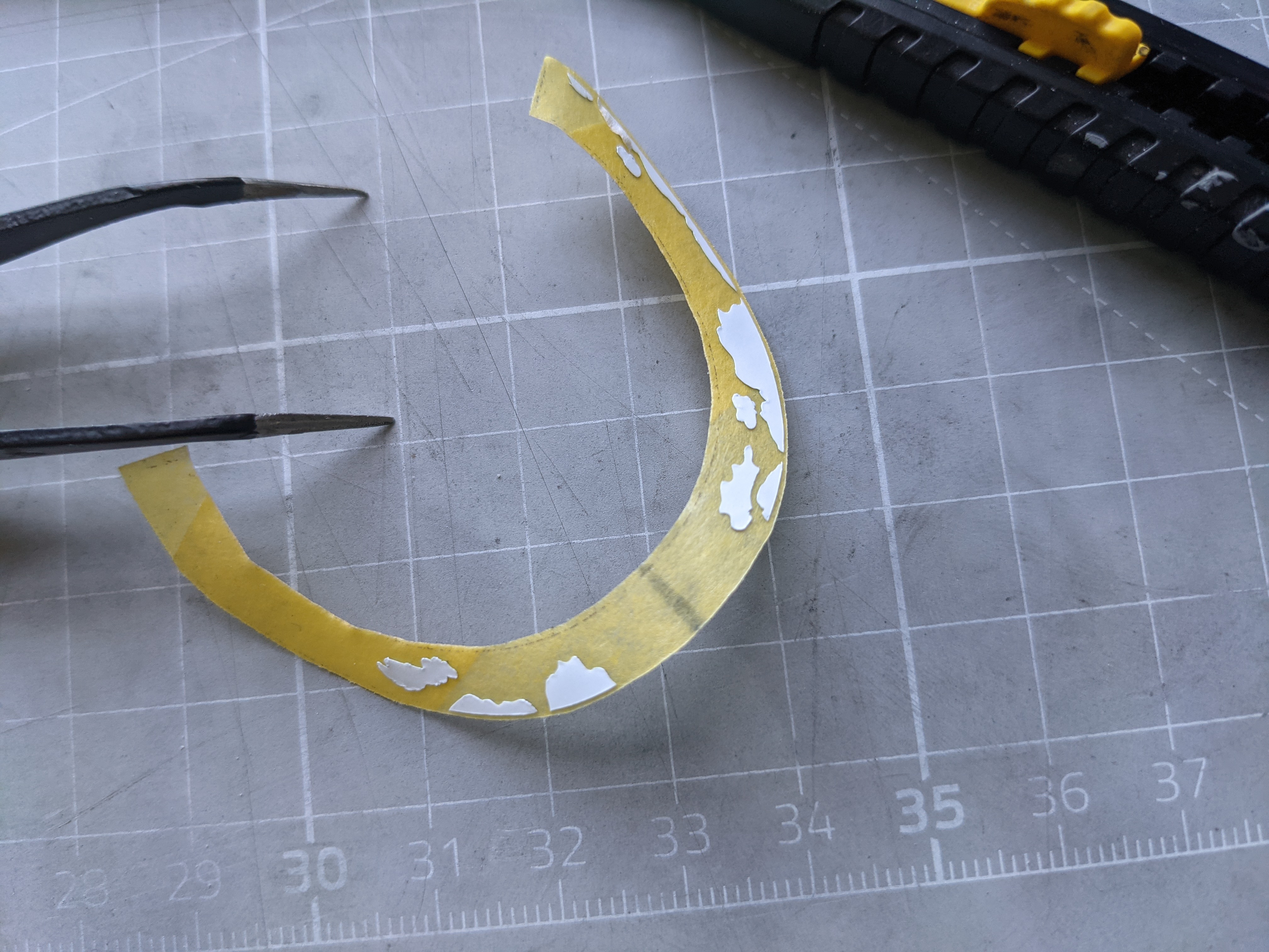

First up, cut out the section and remove the dark grey area:
Cover the section in transfer/Masking tape, and mark on the centre line. Then cut out section around the white line:
Lift the stencil from the backing paper and remove the outer edge before applying:
You can now remove the transfer tape and the stencil should be left behind on the hilt. Pulling the tape back on itself should prevent anything from lifting off with the tape.
The same principle applies for most of the remaining sections:
Once you have the remaining sections applied you'll want to just mask off the emitter nipple, then you're good to go!

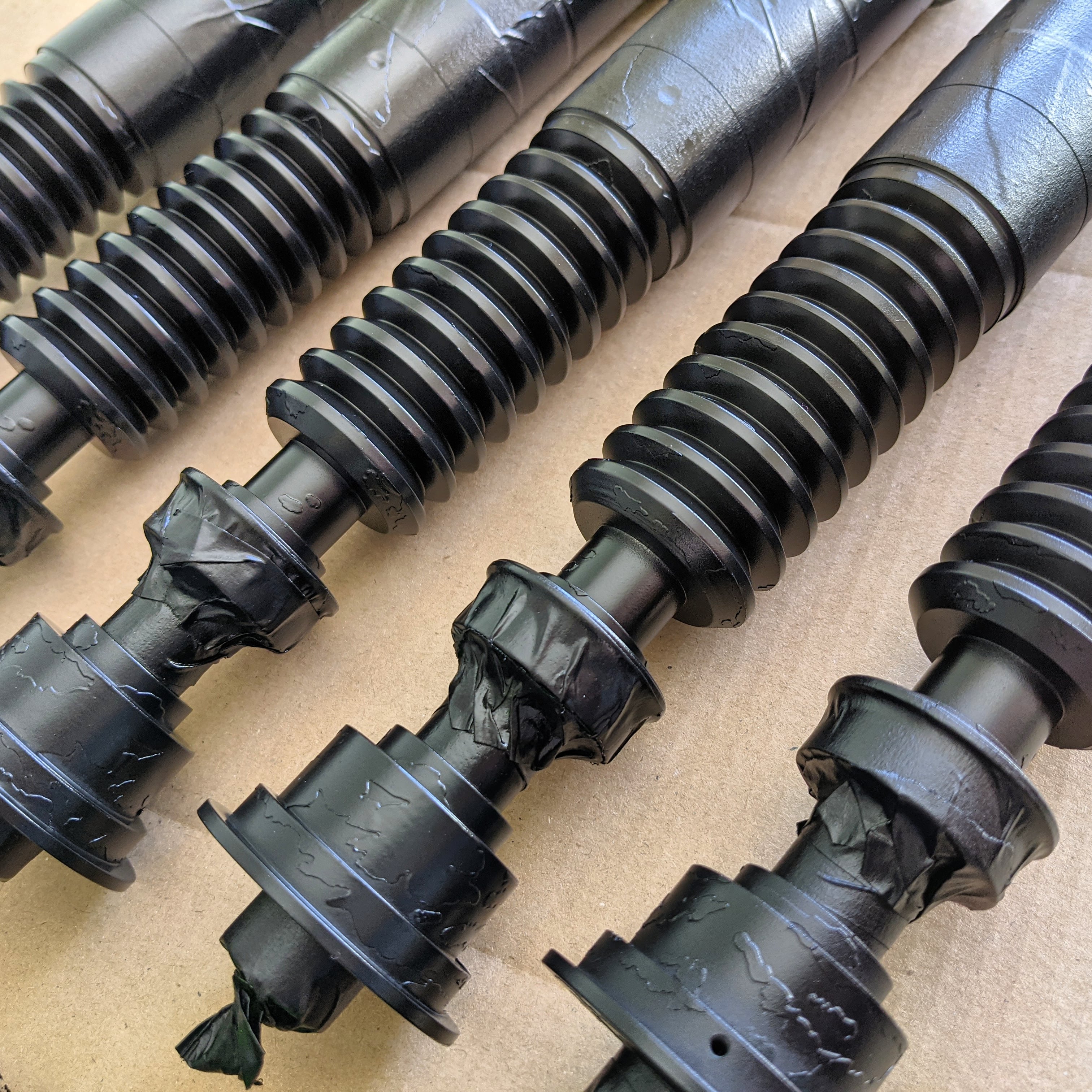

**Update**
Sorry for the radio silence everyone. If/when I drop off the radar, it's because I'm busy working on these. Each step in the process is taking longer than you might expect due to me working on ten in one go. I've made some good progress so far this week though and should have the first batch finished soon.
I wanted to get the bodies all finished before posting an update, and I'm happy to say that I got those finished today.

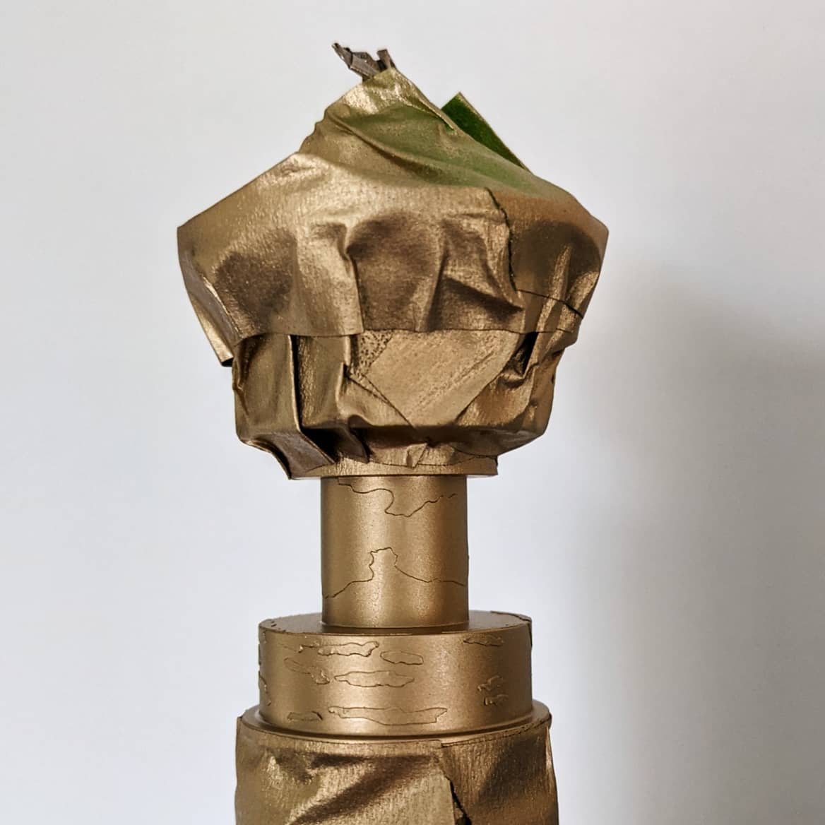

Here they are after they were painted black:
After a few coats, I re-masked and applied the neck stencils:
Freshly de-stencilled:
After de-stencilling, the paint on the emitters was knocked back with a wire brush and the rings were sanded. I also removed any residue from the stencils using WD-40 where necessary:
The necks were then weathered with Tamiya Weathering Master (Soot). I can't recommend this stuff enough! :
The bodies for this first batch are now finished. :)
I just need to get the boxes and tri-rings installed and finish off the blades, then these first ten will be on their way. (y)
Thanks for your patience everyone. Hopefully everyone is happy with how things are looking.
Any questions, please feel free to DM me.
Looking forward to getting these out to their new homes!
All the best and MTFBWY-A,
Dave
