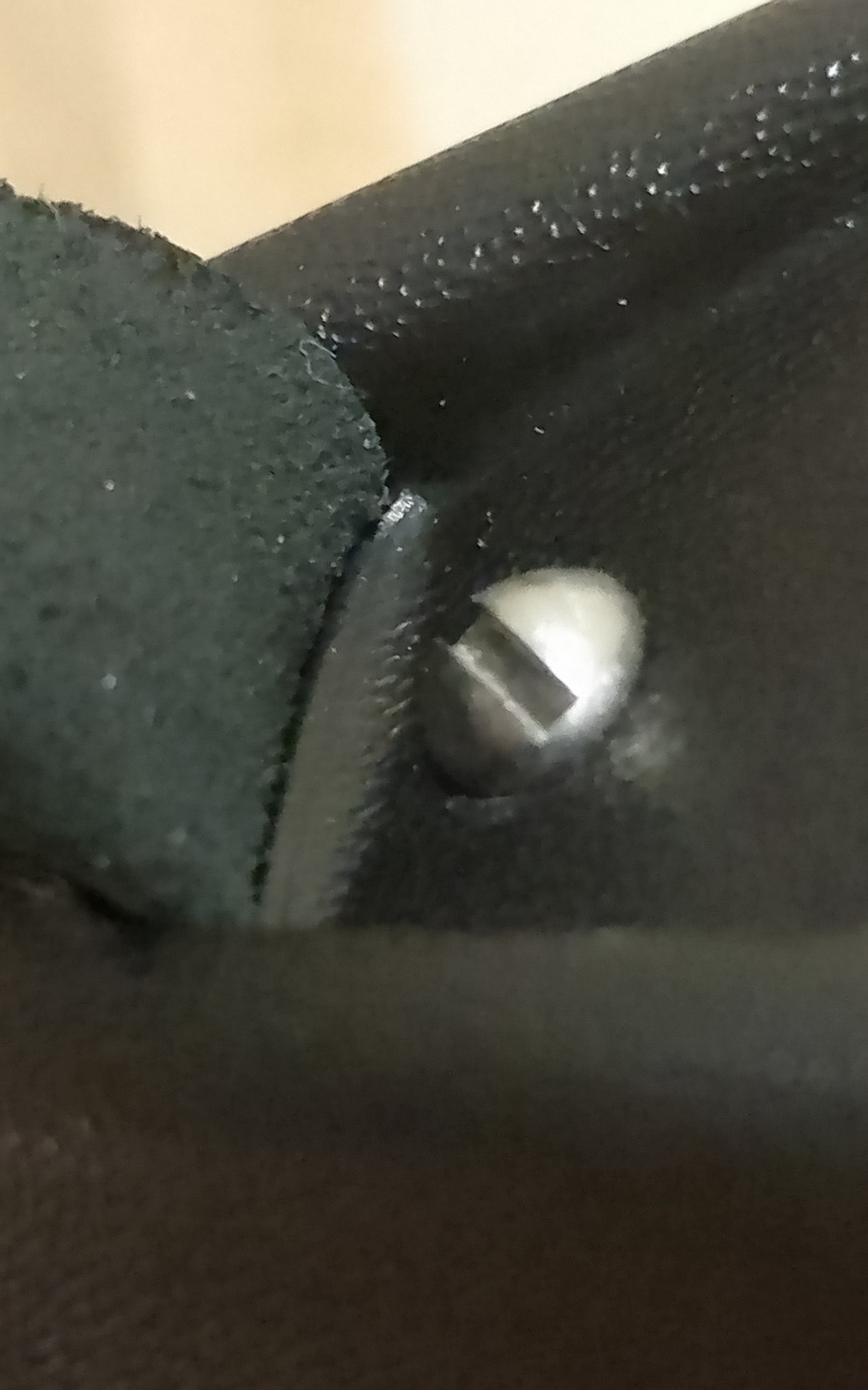

I don’t know why….TWC went to the screw they chose, but I like the original round heads. So I’ll probably change TWC’s out.
These were the ones I got. I had to get the 10mm ones and shorten them as shorter ones are out of stock. Put a couple of nuts on the threads and then put into a drill and you can reshape them to your own taste. I had to use an emery board as my tools are in storage but when I can get them back out I'll be trying that myself.
The round screw head is the domed-one some members believe sits too high. That is why I suggested the Pan Head, it has a lower profile- but is not completely round but has a flat top (to aid in a non-slip drive ability). There is a third head which I rejected which is the Truss Head. It has a lower round head but it is also has a wider profile so I do not believe it fits in this case. Just to be complete you would want a "M4 slotted ANSI Pan head screw". Many pan heads use a Phillips (X) driver, and a JIS (Japanese Industrial Standard) Pan Head has a smaller head.

From what I can see those are all Imperial, no metric ones so won't work.
Hopefully this link works. The previous one was from the app.
I've tried to do an angle comparison of mine with the brass ones you linked. Not got the best camera to do it though unfortunately.
I believe there are equivalency conversion tables to satisfy the sizes differential…….or of course a tap and dye set to re-thread the holes to Imperial threads.
