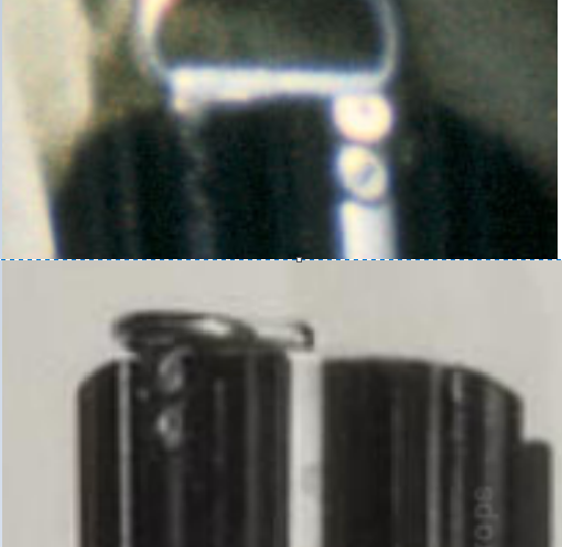

Looks like the side rivets were placed before the grips.
In all props they have the bubbles show on the front side when hanging on the belt. I think it is by design like that.
But I can imagine it is also more comfortable as the ring is attached little to the rivet side of the saber and of course not having the control box bumping into you all the time.
Exactly. But, for that one photo, at least, the prop seems to have been hooked on the belt 180 degrees from normal, which wouldn’t be very comfy, since the clamp box would smack into Hamill’s leg. I can’t imagine that they initially had the rivet side of the Graflex lower in line with the clamp box (and therefore on the “beauty” side of the prop), then rotated it 180 degrees after that first day of filming. The prop was probably just hooked on backwards.
Also note that the ESB saber and its Kobold assembly specifically has the d-ring biased toward the edge of the lower’s endcap, on the side facing opposite the clamp box, which would allow for a more comfortable fit on the belt than the centered d-ring of the ANH prop. Sort of the same principle as having the d-ring run through one of the handwheel side cubes on the Obi ANH and Luke ROTJ sabers, rather than attached to the top of it.
I‘d say the rivets just cover two holes in the prop which were the result of an earlier attempt to attach a ring or hook or whatever to hang the prop on Lukes belt.
I was thinking that too, but I didn't see a reason why it didn't work for them so they switched to mount it the other way. I mean just the 2 big rivets alone should be able to hold a loop that is strong enough for the purpose. Just what Gregatron wrote above - all the other sabers have the attach point on the side.
And I don't see under the rivets any leftovers that should be there if the rivets were used to attach something on the outside.

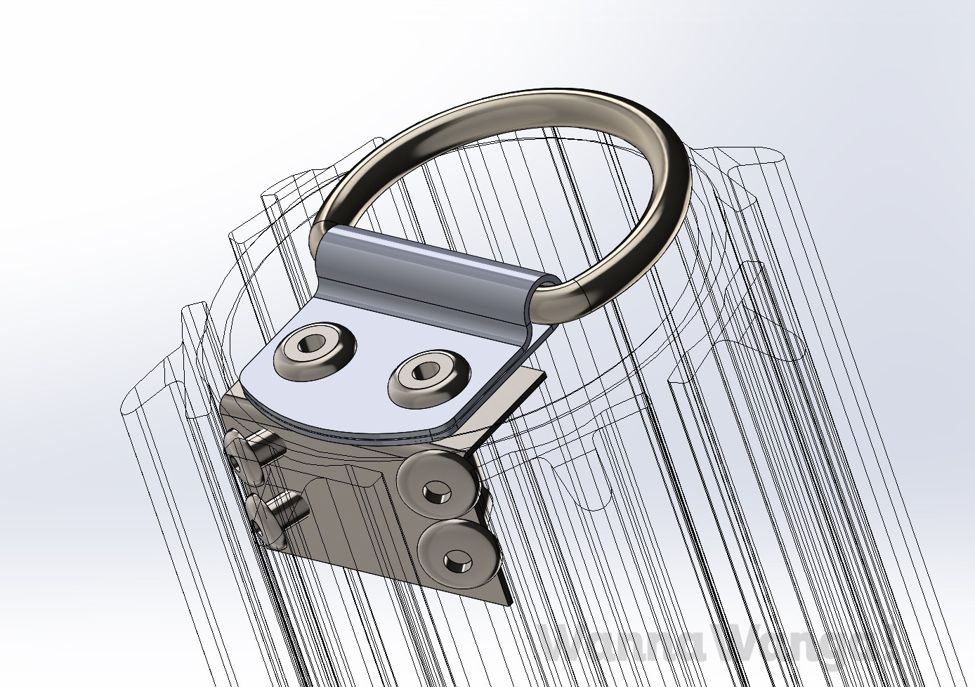

Still, I maybe like this theory more than the L-bracket
But, assuming they tried to side-mount a d-ring bracket (one ostensibly similar in design to the final version) on the side of the tube...why would the rivets be installed vertically instead of horizontally?

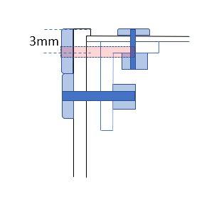

And this is what bothers me with this design and where we the side rivets are (the larger ones):
We have a gap between the wall and the L-bracket because of the circle shape, and the rivets will be at an angle - but OK, there are rivets that should be long enough and it will hold.
But we have 3 mm (assuming the rivet is aligned with the edge of the bottom, that's what I see on the picture) from the edge to the center of the rivet. I don't have the measurements for the other parts, but it looks that it will need to go into the top plate of the L-bracket and possibly even hit the top rivet.
The smaller rivet is even close to the edge, so there might be even worse.
Edit: I don't have measurements, so it may actually fit, but in first look I think it does not.
Think like the Kobold clip but installed on the side (like it is on the Kobold flash originally)

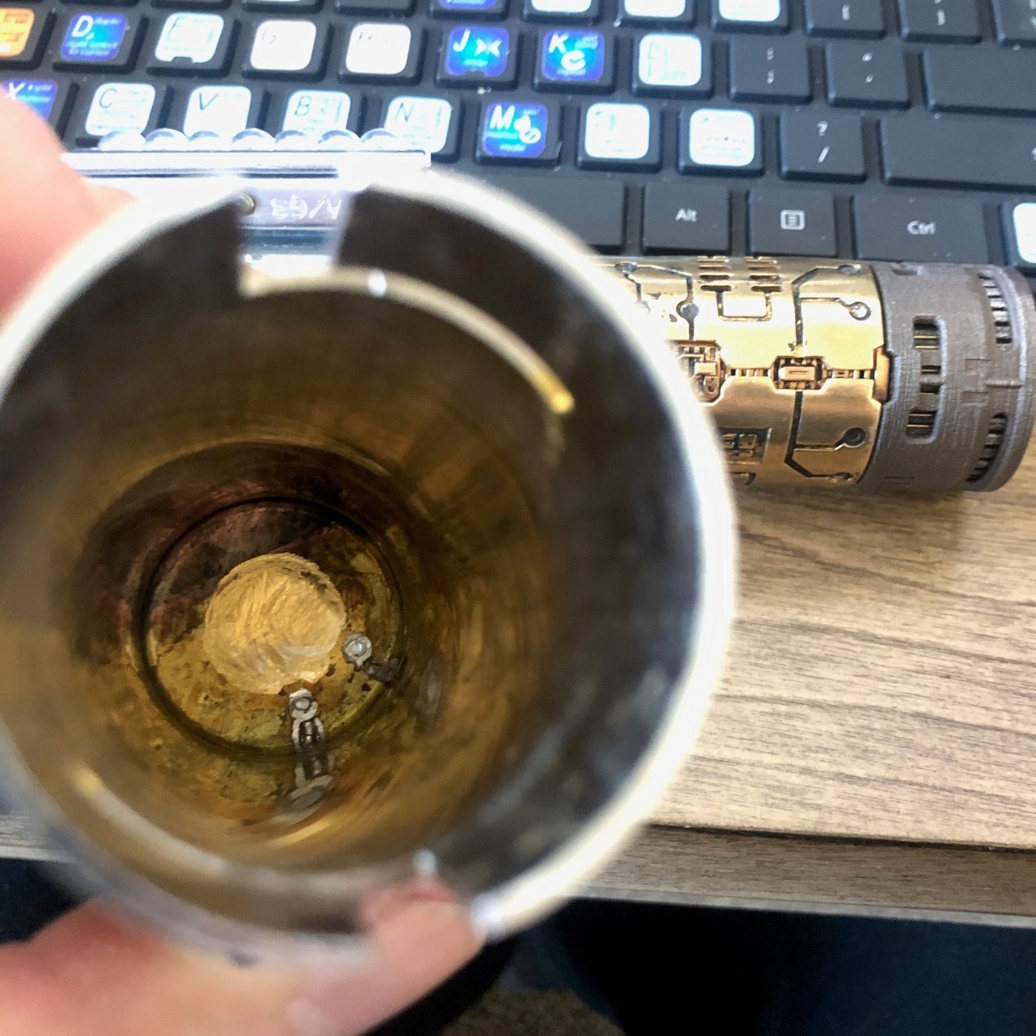

Fwiw, I built a Goth3d chassis for mine and had to grind down the rivets internally with a dremel for it to fit, and have had zero problem with this still being completely structurally sound. It's a Roman Graflex, but it appears to have the same rolled, captive end without solder. Don't know if i'd have the guts to drill and rivet a Folmer Graflex if I ever decide to pull the trigger on one of those in the distant future...

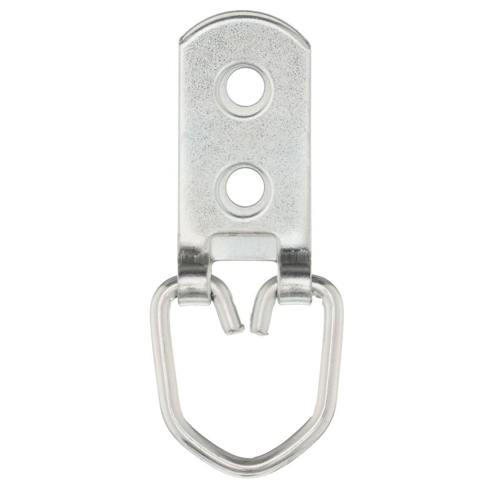

Perhaps they were trying to attach different sizes of D-rings like this:
And they didn't work. (Probably far too small for the hook)
I proposed my side-mount D-ring theory because those side tube rivets are there for 1 of 3 reasons:
1) The original photographer added them for some reason and the prop dept left them
2) The prop department added them because they served a purpose, such as holding an L-bracket for the endcap d-ring clip (or something else)
3) The rivets serve no purpose and were added for aesthetics, or they were added to serve a purpose but then were not needed (such as a failed side-mounted d-ring, or to plug drilled wire holes, or something) (...but why would you drill 4 holes to run 2 wires anyway?)
I would think based on the fact that the side rivets were still on the saber during filming that they do serve a purpose, or it was deemed too much trouble to remove them if they served no purpose, or removing them was unnecessary.
Also, if the rivets were added before the grips but then not needed/serve no purpose, why didn't they remove the rivets and cover the holes when they glued on the grips? Or just drill out the rivets and leave the holes? 4 tiny holes would barely show up in the film, especially given there are not really any close-up shots and you can 'hide' the holes away from the camera by wearing the saber with the holes toward the body or cover them with silver foil tape, or something.
The fact that the rivets are still there makes be believe they were intentionally added for a purpose, and that purpose was being used on that saber (such as the proposed L-bracket)
