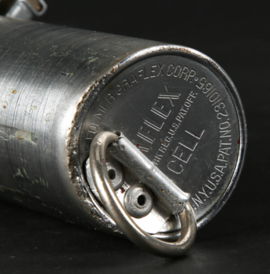

On a totally different topic of the handle rivets! So some think it was used to hold a core, or perhaps in coordination with the D ring? I have to wonder if it originated as some kind of stunt saber, and there were holes drilled for the wires to come through? Then when they used it as a belt hanger just attempted to sort of fill the holes with rivets or something? Just a guess!
Personally, I think they just wanted to reinforce the d-ring attachment to the flashgun so that the Graflex’s bottom endcap didn’t pop off during the rigors of filming, and/or from the weight of the prop hanging on a belt. Note that the rivets are positioned on the side of the lower tube opposite the clamp box, on the “non-beauty” side of the prop, where they wouldn’t be seen.
While this seems the most likely explanation ... there are few things that make me question it.
They apparently let Obi's heavier lightsaber hang on the plastic cube of the handwheel. So I doubt they were concerned about the durability on this one too much.
It is clear that 2 rivets and the bottom itself should support the weight of an empty hilt just fine. After all it is designed to hold the weight of 3 batteries while hanging on the tiny tabs on the clamp (and that's proven to be good enough for military use).
The tiny aluminum? sheet they wrapped around to attach the D-ring and rivet to the bottom is much much weaker than the bottom itself and if anything breaks it will be either the aluminum sheet from the 2 rivets or the D-ring will cut trough it.
The 4 rivets on the side do not help at all with this. They are cramped so close together is an overkill and I think it will actually weaken the construction with too many holes.
And why use different sizes? I'd just drill 6 holes with the same drill bit and use 6 identical rivets if I had to do something like this.
Is it clear? We know that, especially because we've spent years not reinforcing the bottoms of flashes, but I don't know that they would know that, especially the part about the flashes seeing military use. Doesn't matter if it's true; it only maters if the prop guys would have thought of it that way.
One of the first times this was discussed, I recall a few folks mentioned that the flash bottoms can, occasionally, pop out. Maybe it happened on one of the flashes from the box Christian bought? Possible, maybe.
The tiny aluminum sheet they wrapped around to attach the D-ring and rivet to the bottom is much much weaker than the bottom itself and if anything breaks it will be either the aluminum sheet from the 2 rivets or the D-ring will cut trough it.
Disagree. I've popped a lot of rivets into a lot of brass tubing over the years and that's tough stuff. If I were concerned that a press-fit disk of sheet metal might pop out of its housing, I'd 100% trust rivets driven into brass tube wall to hold it.
Now that you've mentioned it, yes if it is to prevent the bottom disk to pop out it makes sense to do something like what we see.

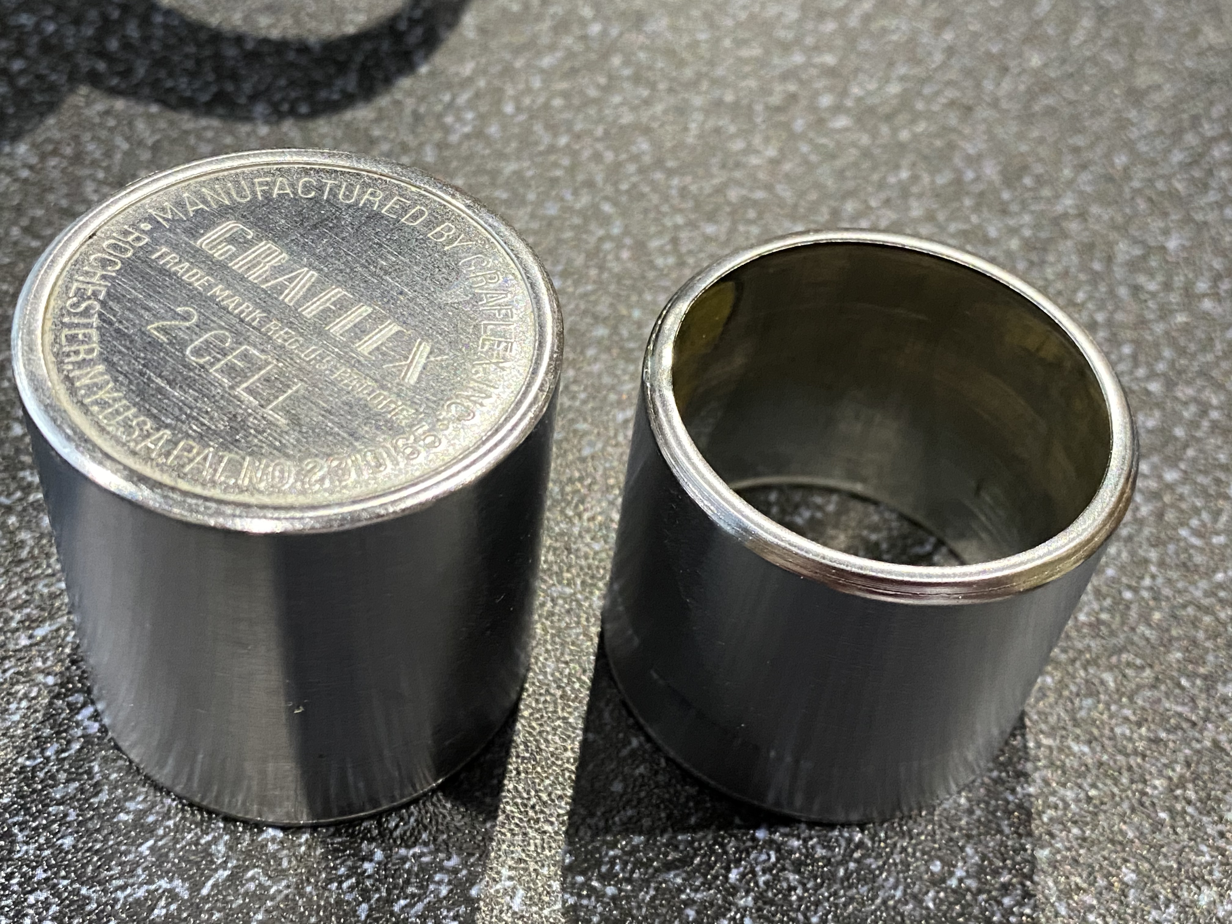

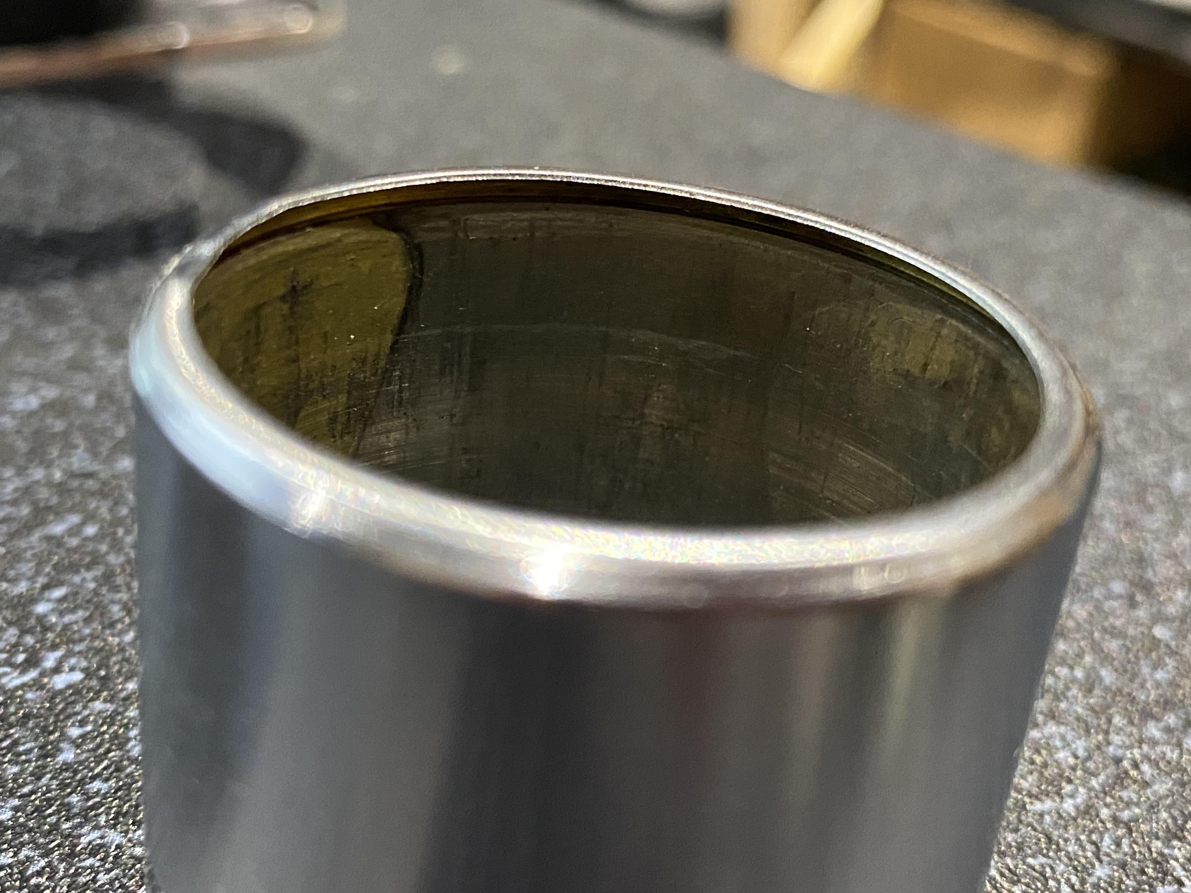

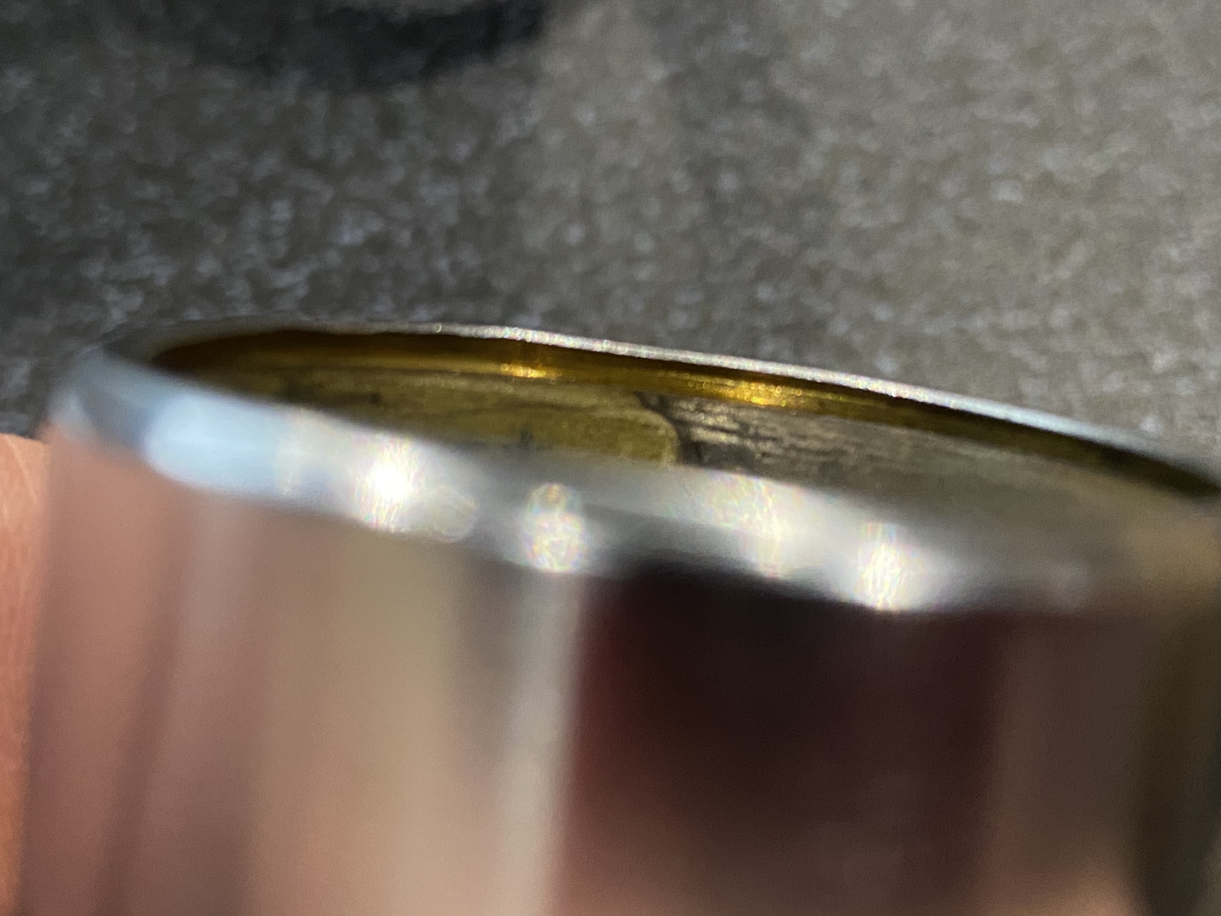

There is no solder on the bottom tube, the end cap disk is held in place with a rolled edge and groove milled into the tube.
The inside of the tube end is milled or lathed with a small recess a little deeper than the thickness of the end cap disk. The disk sits on the milled step, and the slightly higher walls of the tube are rolled over by a machine process, holding the disk tight.
It is possible to remove the disk, but it can only come out one way. You could remove and turn the end cap disk if you were trying to match a specific saber shot from one of the movies and your bottom tube end cap didn’t match up.
I’ve done it before, you have to be really careful or you risk the disk tearing the rolled lip. I’ve re-rolled the lip on one of these cut 2-cell bottom tubes.
Yeah, I think that's the hypothesis; not to reinforce the d-ring rivets but to reinforce the disk itself.
I agree with this hypothesis. I imagine an L-shaped bent piece of metal inside the saber with the long arm of the L attached to the ID of the tube by the four rivets between the grips and the short arm of the L attached to the backside of the disk by the two rivets that also hold on the makeshift bracket for the D-ring.
But that still begs the question... Why did they (apparently) not reinforce the bottom disk of the Graflex flash on the ESB saber(s)? The Kobold clip is anchored to that same disk, right? As others have pointed out, the ESB sabers saw a lot more action but apparently there was no problem with the bottom disk pulling out of the tube. Were the prop makers for ANH just overly-cautious? Is v312 saying in post #178 above that the ANH hero saber might have been built from a generation of Graflex flash that was inherently weaker on the bottom disk than the generation of Graflex flashes used for ESB Luke sabers?
