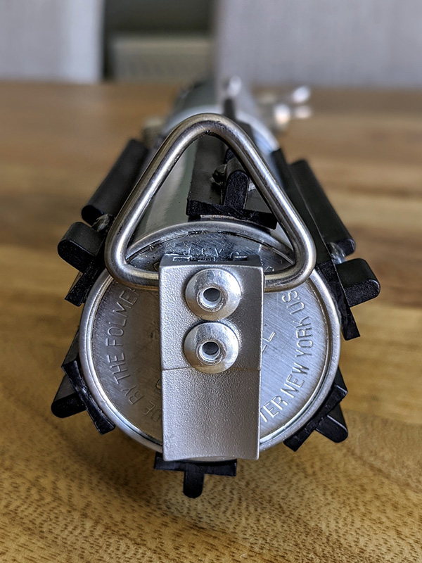

D-ring, silver screws:
Tri-ring, black screws:
D- ring, black screws:

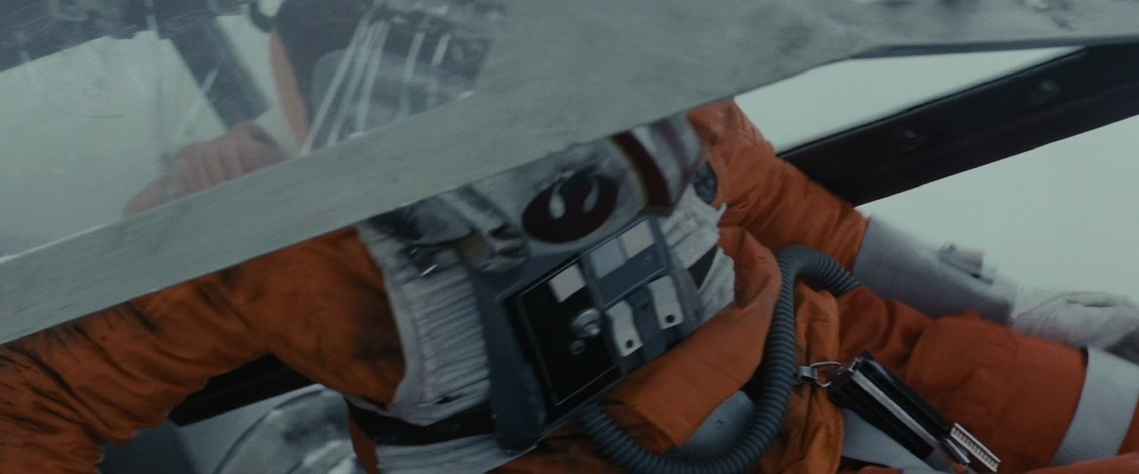

Some of the Snowspeeder crash was filmed in Norway? I thought all of that was at Elstree?
I don't see any screws at all on the speeder escape-- I also thought that the close-ups were shot on stage. You could very well be right though.
The bluescreen shot of Luke jumping out just before the AT-AT’s foot crushes the speeder was filmed on the stage. But, in Norway, they filmed Hamill scrambling to get out of the smoking, full-sized speeder mockup.

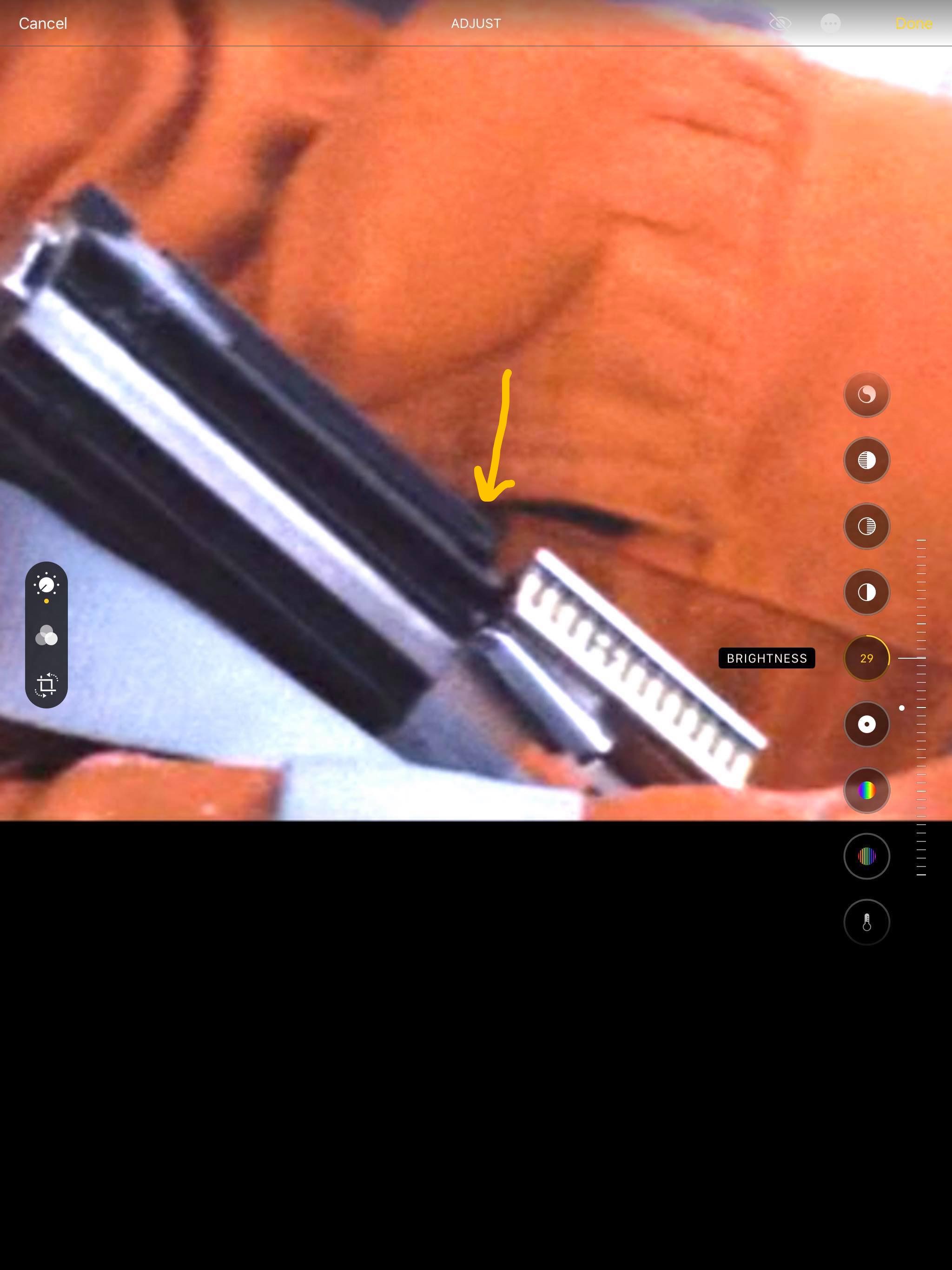

The notches are there on the snowspeeder escape prop. Which must mean the screws are there, too. It’s easier to see in motion than in a screencap.
So the shot that you posted is from Norway?

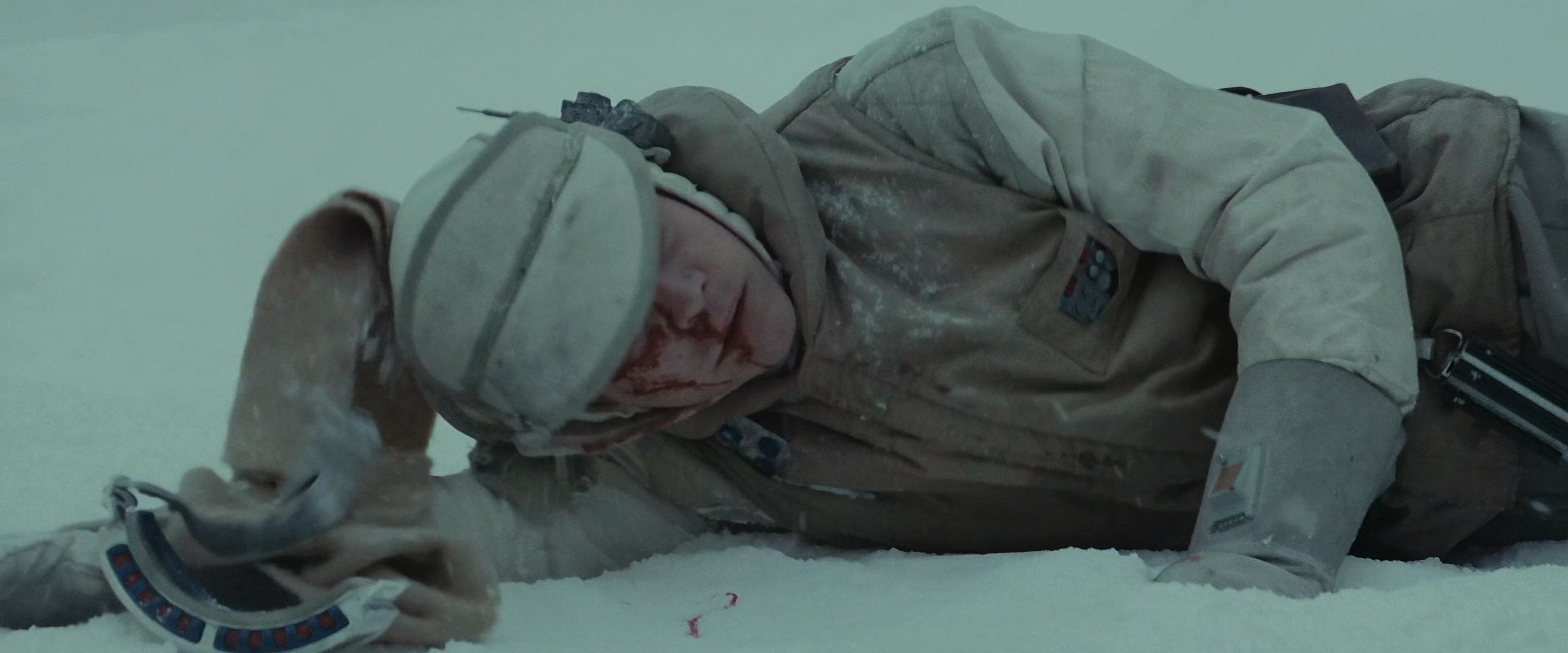

The first day of shooting was for the scene with Luke scrambling out of the Wampa cave. As the story goes, it was intensely cold, and was filmed right outside the hotel where the crew was staying.
We have the photos of Hamill hanging outside the hotel in costume, and the prop has the notchless grips. And then NO grips. Everything after that seems to have the notches and screws.
I don’t have the shooting schedule handy, but logic dictates that they would have subsequently filmed the other scenes featuring Hamill in that costume during the early scenes, then moved on to the Hoth battle/snowspeeder stuff. So, I’m thinking that the shots with the Wampa attack and whatnot came early on, then then moved onto the showspeeder stuff. With TWO props being used throughout. The tri-ring version (black screws) and the d-ring version (silver screws).

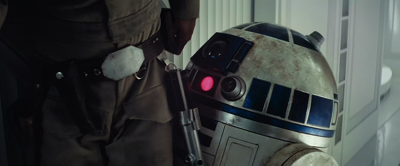

Also note that the clamp card has the same horizontal marking/scrape on the gold traces that the version seen in the Luke in Bespin fatigues publicity photos (and the onscreen R2 bump shot) has.

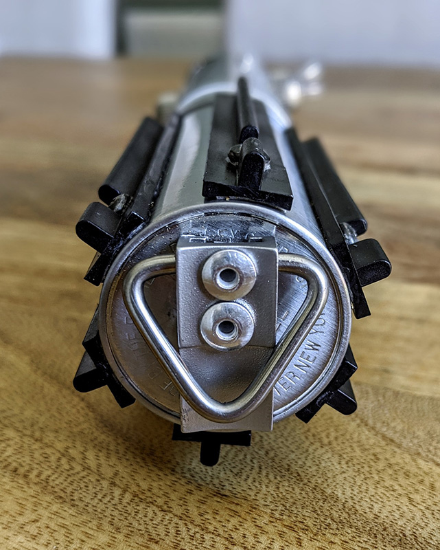

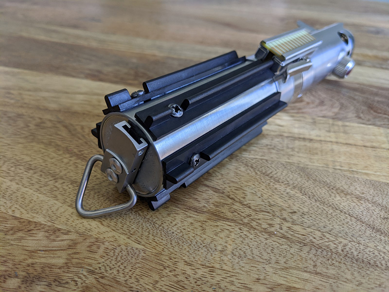

I’m in the yuma/hero tri ring..
The edges look identical to the yuma/hero
I bet they scavenged this tri ring off this graflex since they weren’t using graflex’s in RoTJ
That's an awesome thought! Nice to think that that ring could tie the histories of those two props together! Going to have to try one out for size on my graflex tomorrow. :)
From what we know, the Ranch saber (which has a d-ring) isn’t an exact match for the Dagobah saber. The upper red button was missing, yes, and the lower matches some of the reference, but it’s not exact.
We also know that a Graflex (with d-ring) was initially on-set for JEDI, and that may well have been the Ranch saber.
That distinctive scuff on the clamp card in both the snowspeeder escape/R2 bump scenes indicates that either the same clamp card was used in two different props, there was ONE prop which underwent numerous changes during the rigors of filming (no notches to notches, silver screws to black, tri-ring to d-ring, upper red button lost, and screws added to upper grips), or that the tri-ring (or perhaps the entire Graflex lower) was swapped out for a d-ring when they started studio shooting.
