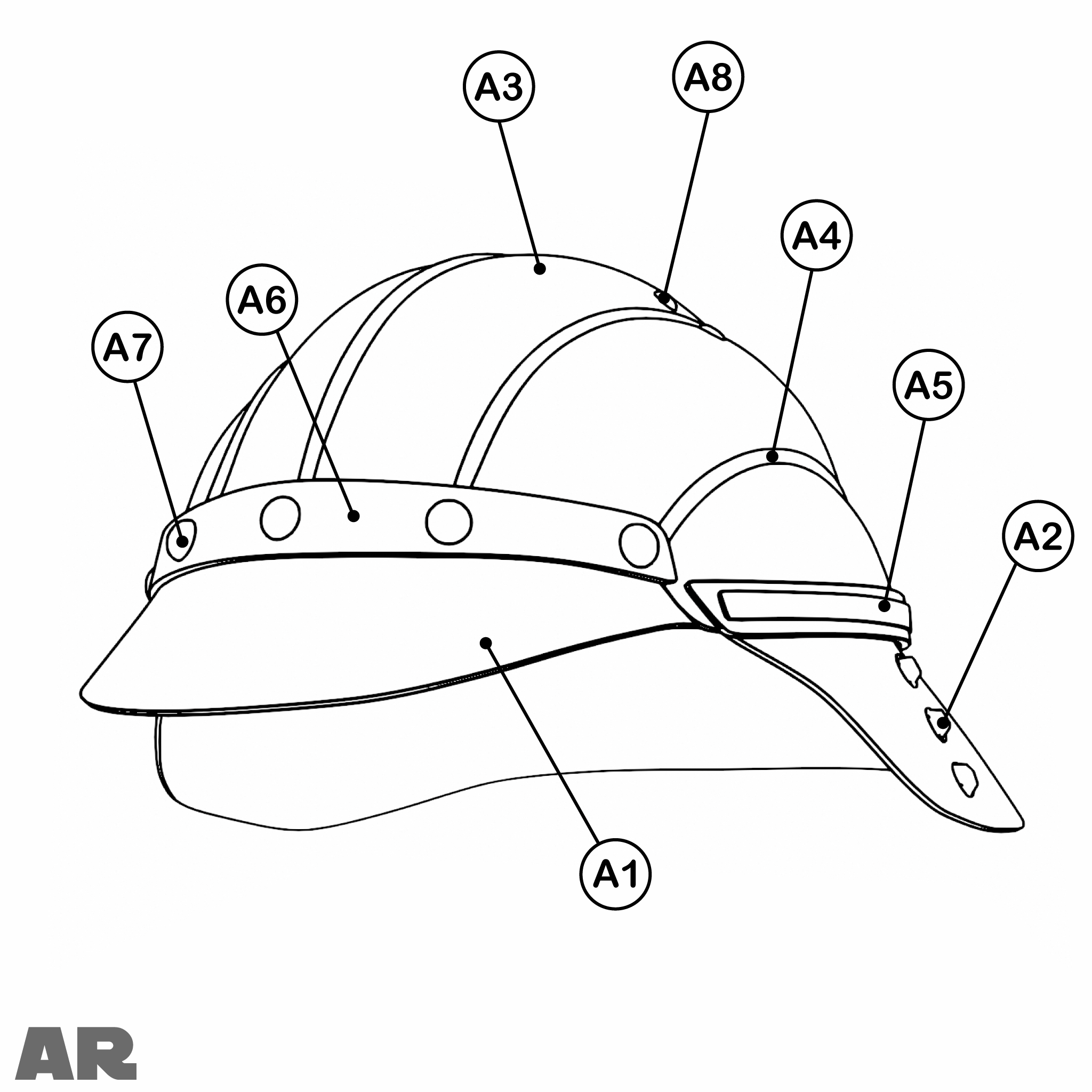

I think this is the best place to start in order to familiarise you with my nomenclature and then go into materials etc. The helmet has two main components the Shell Ⓐ and the Jaw Ⓑ in the below diagram:

Again, I will breakdown the shell of the helmet into its component parts:
*A9 not shown in diagram​
A1. Shell​
The main component of the helmet is a vacuum formed white haircell (textured) ABS sheet, with the texture on the interior of the helmet.
On the Hero helmet, the outside is covered a pitted finish (post-forming) while the 3 stunt helmets are smooth on their outer face.
Shell Interior
The interior of the Shell is seen to have a textured finish as seen on many other ROTJ helmets and sits on the head of the wearer with an off-the-shelf helmet harness. There is no evidence (I’ve seen) of a screen used helmet having a foam liner.
Shell Paint
Brandon Alinger’s book has a direct quote from Peter Ronzani stating that the helmet was given its patina with rub and buff and a lot of scuffing. Still to figure out colours.
A2. Boot Stud​
There are six of these on the helmet, 3 on either side. These studs are the same part as seen on the Luke V2 Lightsaber and Endor bunker bomb. The found part has been previously identified here. This is most likely a decorative piece that obscures the structural fixture for the Jaw. A representation of this part is pictured below.

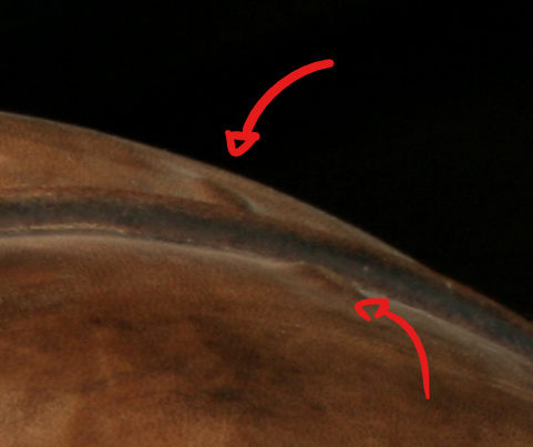

A3. Leather Moulding​
Either one piece or several sewn together beneath the belting. To be expanded on further.
A4. Round Leather Belting​
Holes are present in the front and back of the Shell to allow for these to thread through. To be expanded on further.

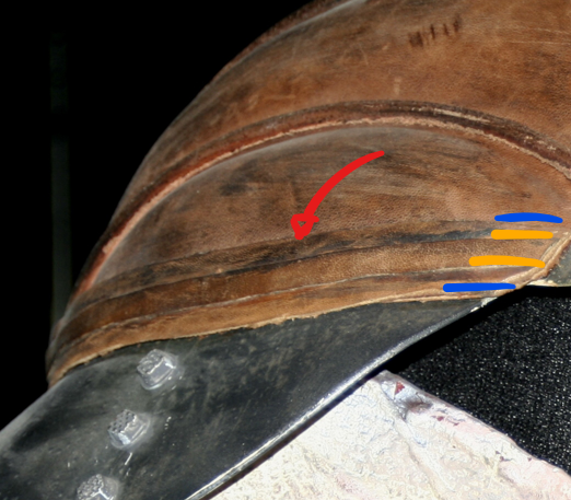

A5. Leather Trim​
Consisting of two seperate pieces of leather, outlined in yellow and blue below. To be expanded on further.
A6. Brow Trim​

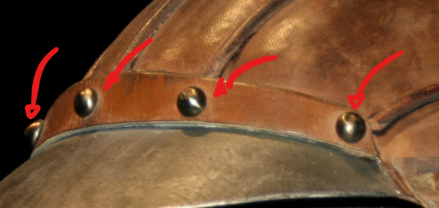

A7. Brow Tacks​
A8. Harness Rivets​
Structural fixture for the Harness. On the stunt helmets these rivets are beneath the leather moulding whereas on the Hero they are seen to be on top.

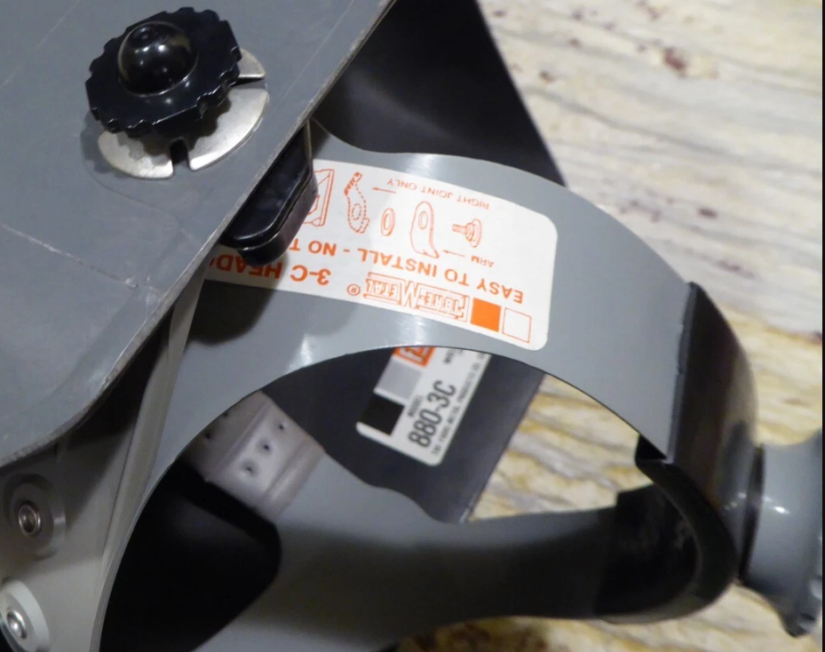

A9. Fibre Metal Harness​
This internal harness is a found part, the exact harness is apart of a Fibre-metal 880-3C welding helmet (Fibre-Metal 3C headgear) though there are similar harnesses that are still produced today with minimal differences.
Above: Welding harness seen on stunt helmet, César Villar Toro, 2009
Above: Photo from an ebay auction of a 880 3C welding helmet​

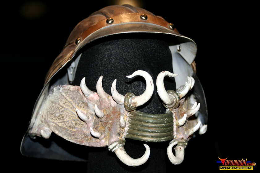

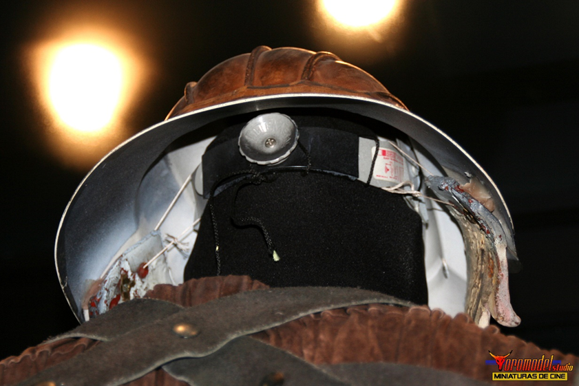

In the below photo of a stunt helmet there is 3 methods of attachment to the Shell; Glue, string and some sort of fastener.
César Villar Toro, 2009​
My belief is that both the stunt and hero helmets have the same attachment method of the single fastener, however as that isn’t enough support to hold the jaw up on its own the string and glue was added to hold it in place on the stunt helmets to keep the jaw from falling down.
Jaw Sculpt​

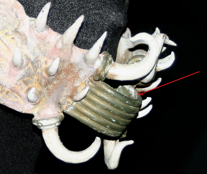

The Jaw sculpt has 6 cords on the outside that were painted gold, as these cords change slightly between each helmet, I’m opening the possibility of them being separate pieces added to the Jaw after it was cast. There is a sculpted piece behind them on the helmet that also supports this hypothesis however without a photo of it on 2 different helmets I cannot confirm whether or not that was a cast element as well or an element sculpted into the back on each helmet to support the corded section of the Jaw.

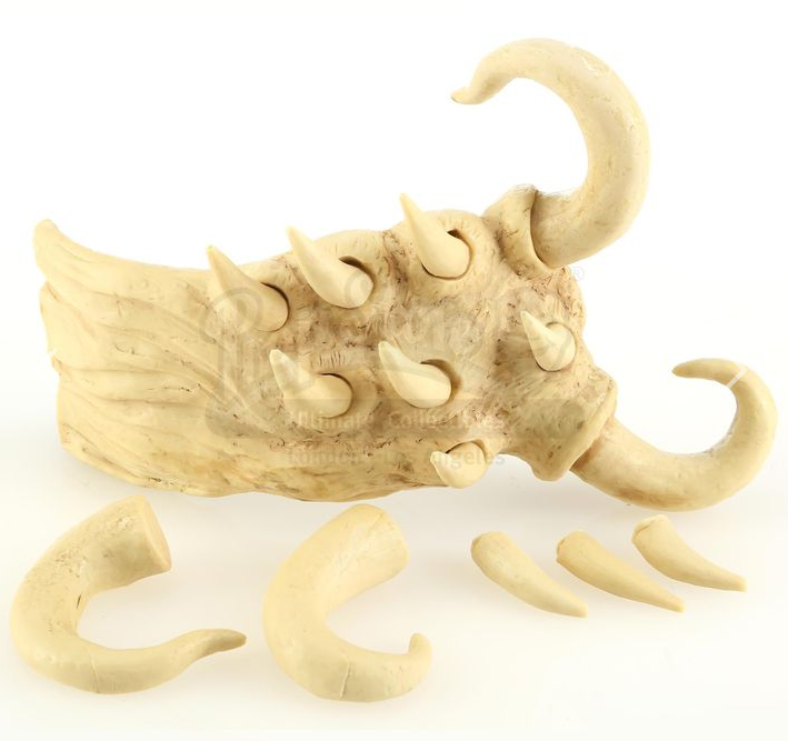

This helmet, and the other propstore auctioned helmet are very interesting. I'd like to know where they came from and whether they truly are prototypes.
Unlike the other propstore helmet, this ones jaw looks to have come from the same sculpt as the screenused helmets though it has different tusks in the middle (which were glued on pieces on the final helmet).
Unfortunately, unlike the shell which has a "safety casting", i'm not aware of direct moulds of the jaw existing in private hands.

  • The bottom left horn on the propstore auctioned 'prototype' was missing with clean separation (no apparent fracture etc.)
  • The spiked teeth change positioning between helmets (glued on during assembly not moulded)
  • The lack of detail on the inside of the jaw piece* (supports assumed casting technique)
*The jaw piece does have a ridged section on the inside of the center ribbed section which I believe was added after the Jaw was initially cast (no great evidence to support that) this is also not a feature of the 'prototype' helmet
There looks to have been different material used on the prototype as well (latex?)
The photo below from the propstore shows the missing horn as if it fell off.
The 'test components' also auctioned may also support this however as you can see this is a very crude 'test'.
