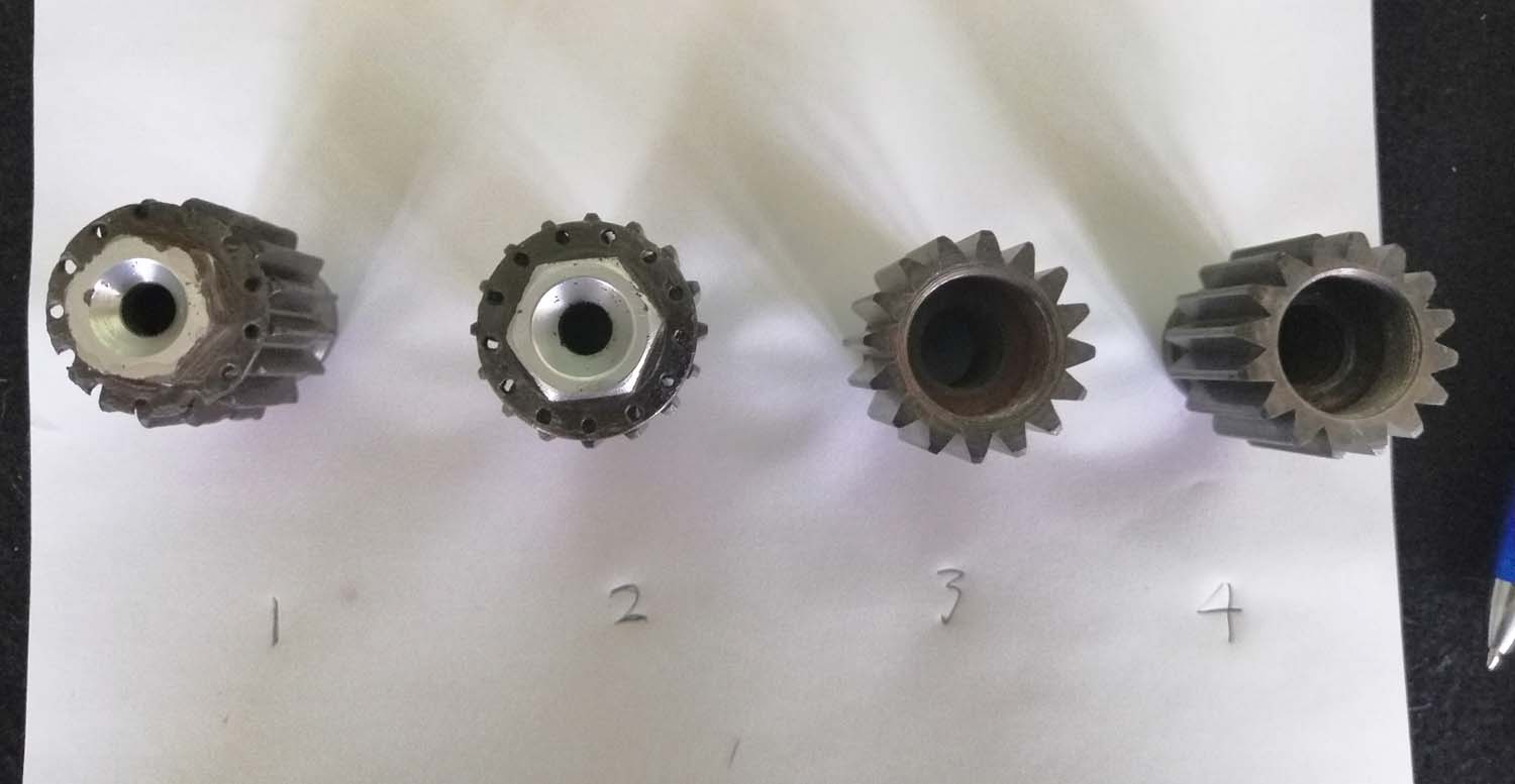

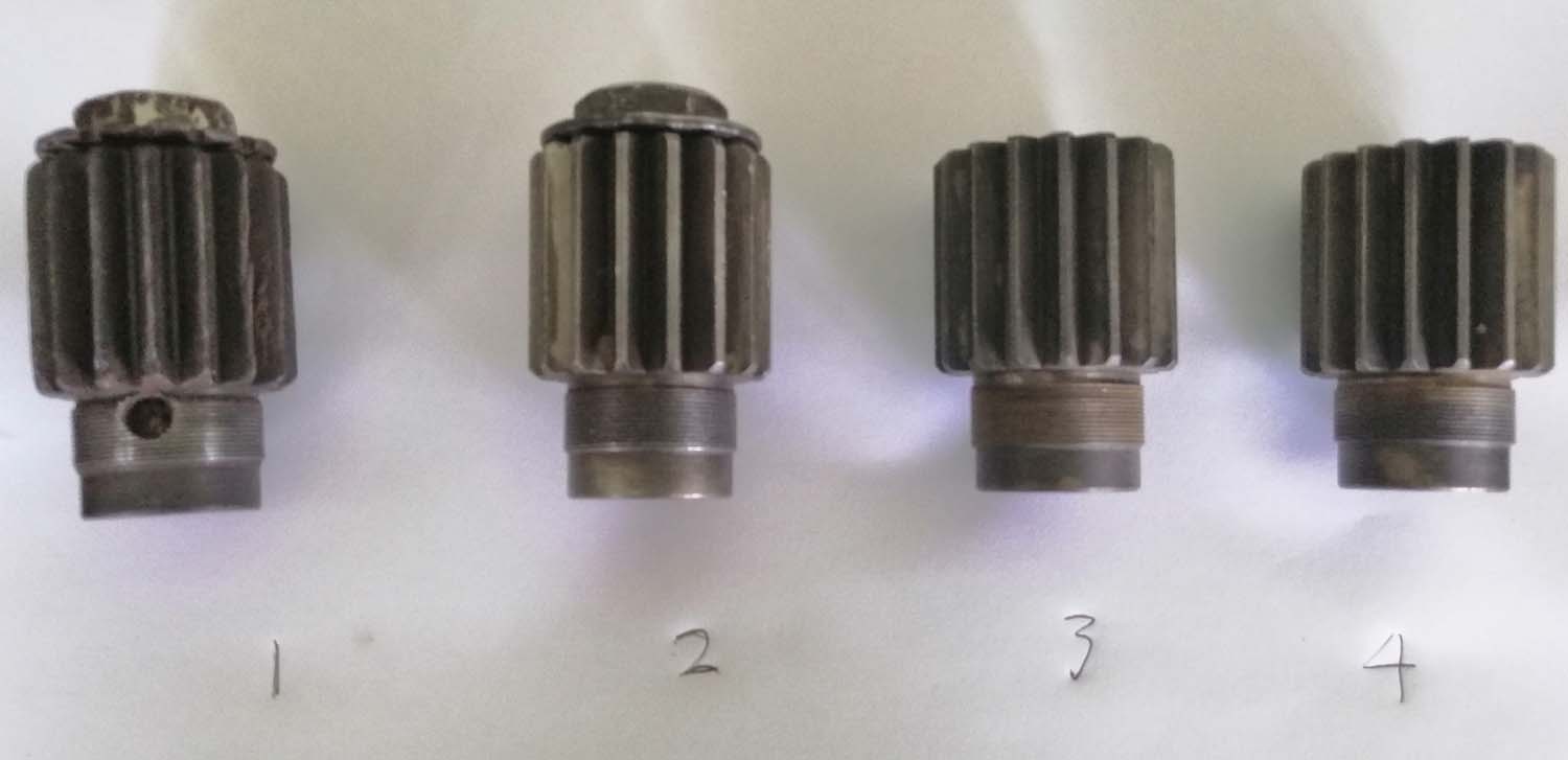

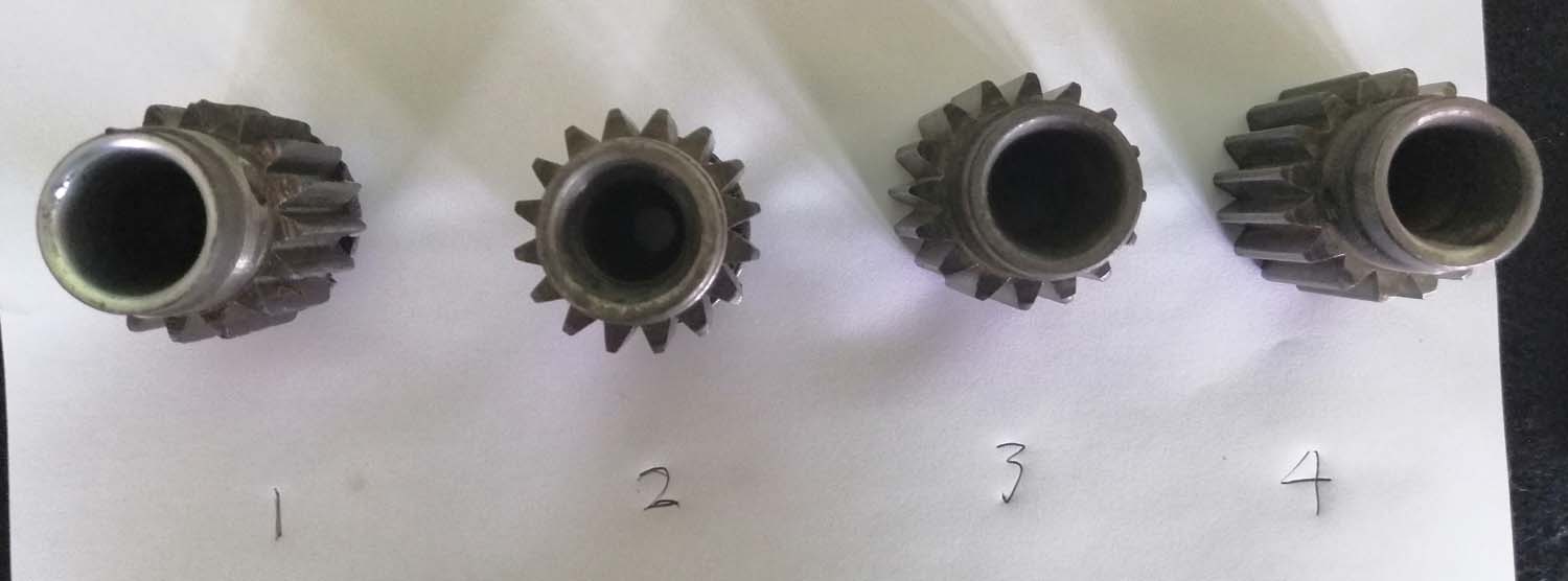

I hate to second OdiWan72, but those boosters are replicas. I had the chance to purchase those exact three in early June but passed after examining the pictures Spitfire provided and after getting a second opinion from teecrooz. He confirmed they were indeed replicas, and pointed out some of the lesser obvious tells that I didn’t notice.

I did end up purchasing the one to the far left (#1) because the fins, wear, and chrome plating on the inside indicated it was absolutely genuine.

yeah the fact that the boosters lack the nikel plating inside seems like a big tell they would be replicas. That is crazy if the guy from spitfire sold them for real ones and for a hefty price I'm guessing...
the first one looked legit. The bearing nutt is legit and was very hard to het off
the bearing nut is indeed a very weird detail for a replica, especially if it was hard to remove. I don't know man, it would be Nice if Teecroz could explain the other tells. when I see them, i think replica, but they are very realistic, It would be nice to have a more complete opinion on the matter.

Sure, I can elaborate. It was already mentioned that they are missing the chrome on the inside. Another is that the fin cuts end in sharp angles like a “V” instead of being rounded at the bottom. A third is that the ends of the fins are also not rounded. They almost have a chamfer instead. A fourth is that there isn’t a weld on any of the fins near the pin hole. There should also be two holes between fins that are opposite of each other. I can’t see them in the pictures, but they may be there.

coolhanluked, I wouldn’t feel bad or take down the pictures. I had four different people ask me about these before I posted the PSA on the prop Facebook group. If they came from a vintage gun, it’s the first time I’ve ever seen this variant.

I will take better pics of all three so everyone can see the details. And hopefully helps people see the difference so this doesn't happen to anyone again. This blows! I sold my real booster this weekend cuz it was in pretty bad shape. Now i no longer have a complete build.
I have to agree with you on all of that Teecrooz, thank you for your exprt opinion. I would also had that I usually spot the replicas at a first look by the fact that the fins are really wide. I saw recently a suposedly original one that had wide fins though but that was the only time.
This doesn't appear to be a Roman replica however because of the V shape of the fins. Did you guys already see a replica that matches those?
The fin width verys
All the real ones I've seen are always really thin, exept one probably in this thread lately that I didn't save on my computer, But I remember thinking, those are pretty wide for a real booster.

Edit: Also, my booster is (chrome? nickel?) plated on the inside
Fin tips can vary slightly but are usually a sharper fin tip. You can have a real one with a flattened fin, but it’s usually from the wrench/vice used to tighten them onto the barrel or try to remove them.

Another good tell is the letter stamping, real boosters usually have distinctive stamps on top and bottom sides.
