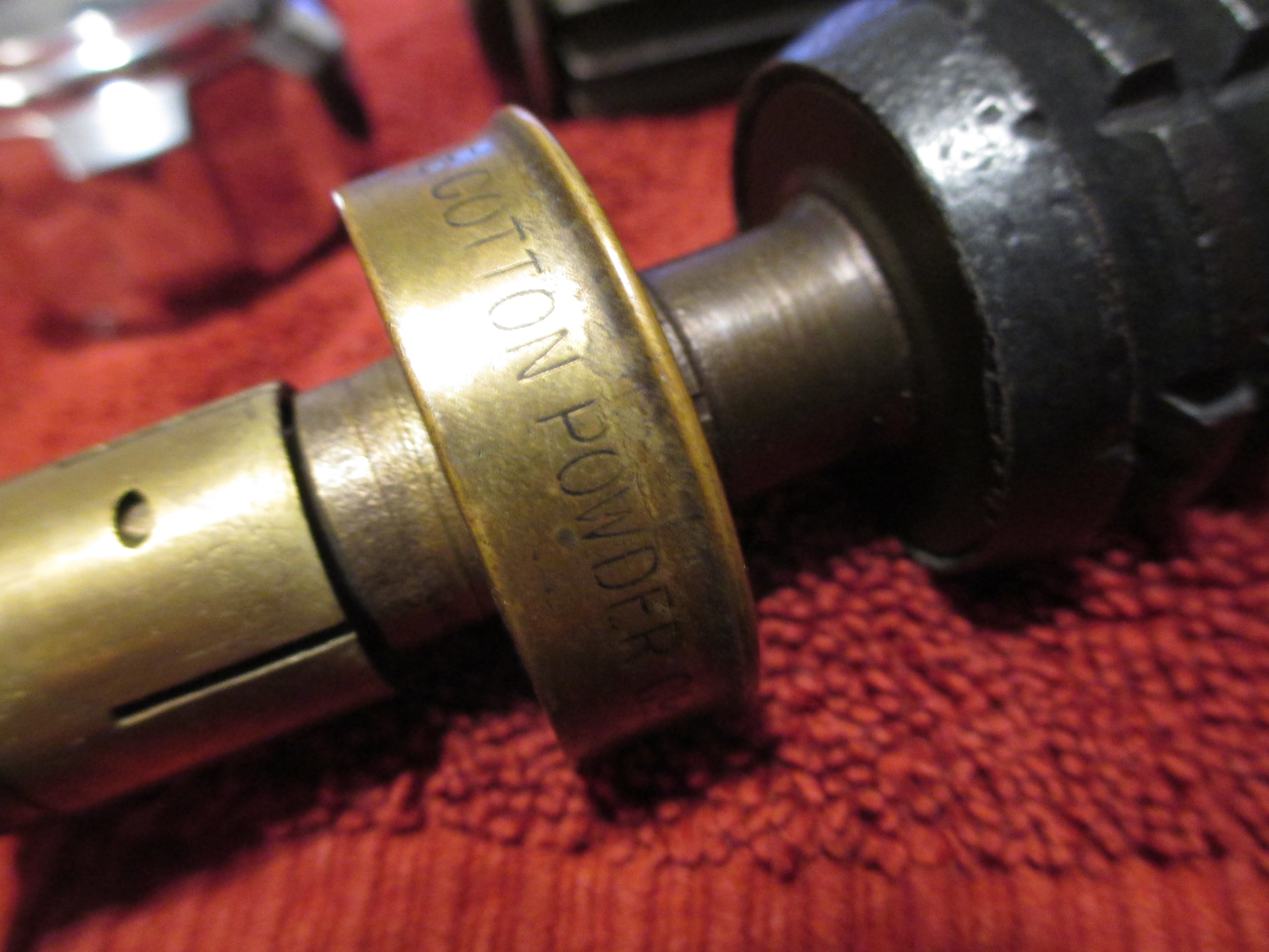

I think that your booster is likely stuck inside/stuck to the barrel jacket by way of fouling and not by pressure fitting.

If I had money to bet (I don’t), I’d say there is mass fouling built up in between the threads of your booster and the threads of your barrel jacket that has had over 70 years to set up shop and get comfy. You might say they Fused (like your screenname, LOL! Okay I’m a grandpa now so I’m allowed to tell that kind of dumb joke).
I’d guess a little heat will get that booster unwound. See newmagrathea ’s removal video in his thread or in The Ninja ’s collection thread for lesther strap usage to not damage the booster vanes.

If fouling is the problem a little soak in some cellulose thinners might help.
Thanks for the background, Andy. I love learning about the history of this stuff. Keep writing. If I can get her to unscrew so that any mods I make are reversible, that would be ideal. Well, IDEAL would be keeping it all together and waiting for another booster to drop of the sky onto my head

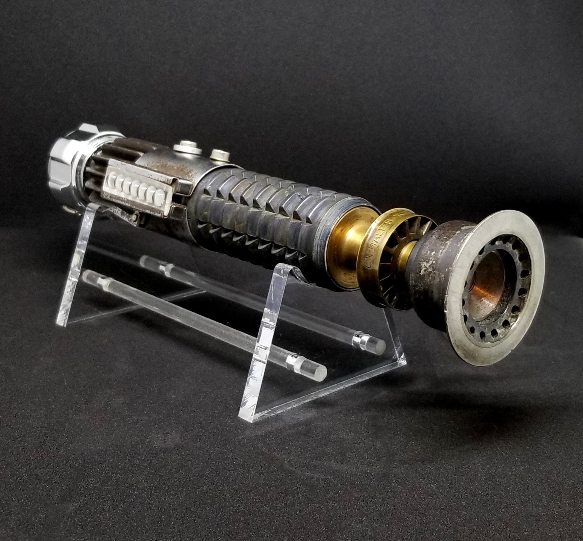

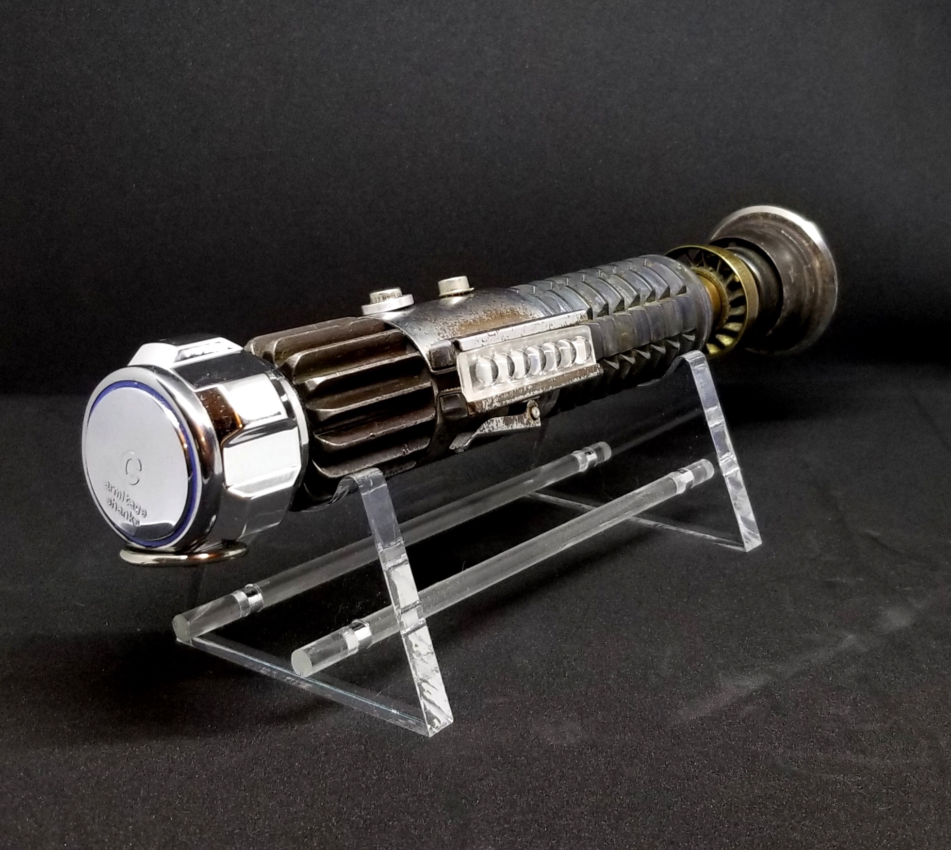

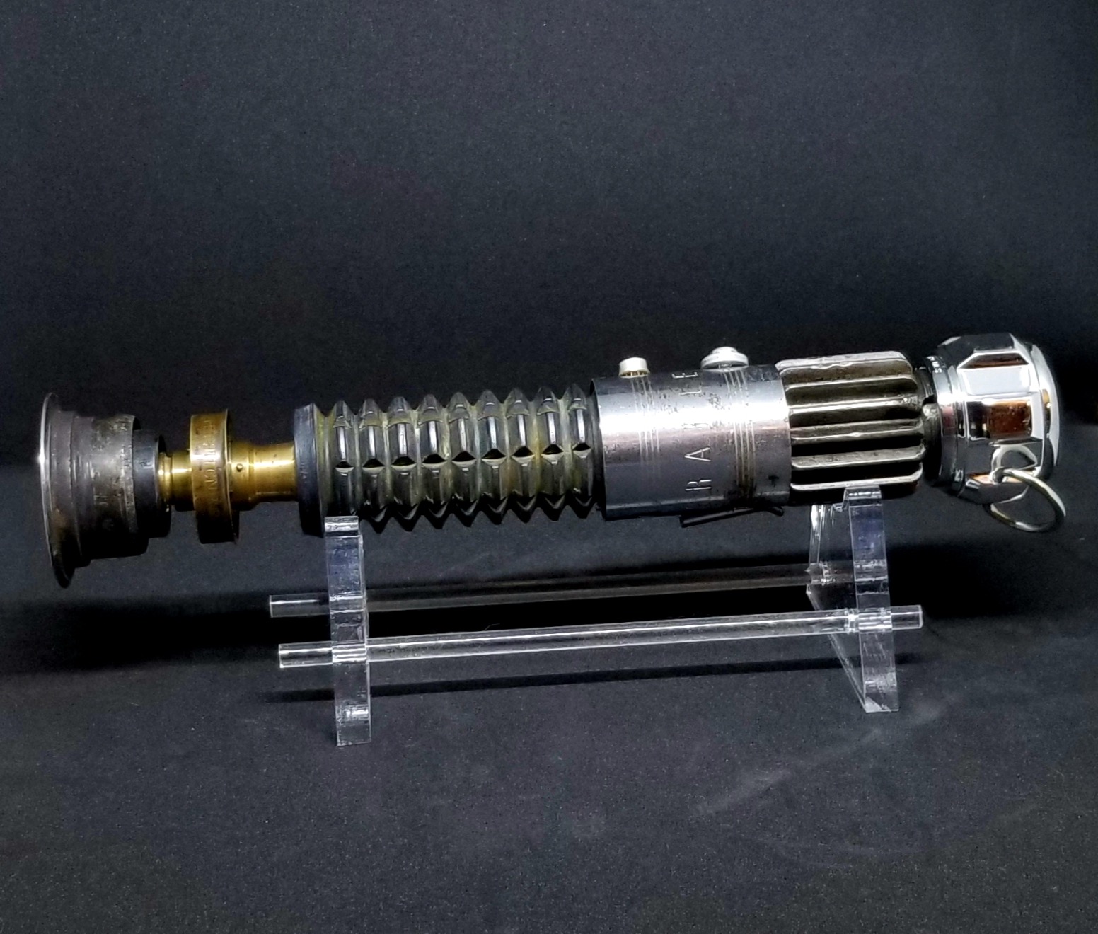

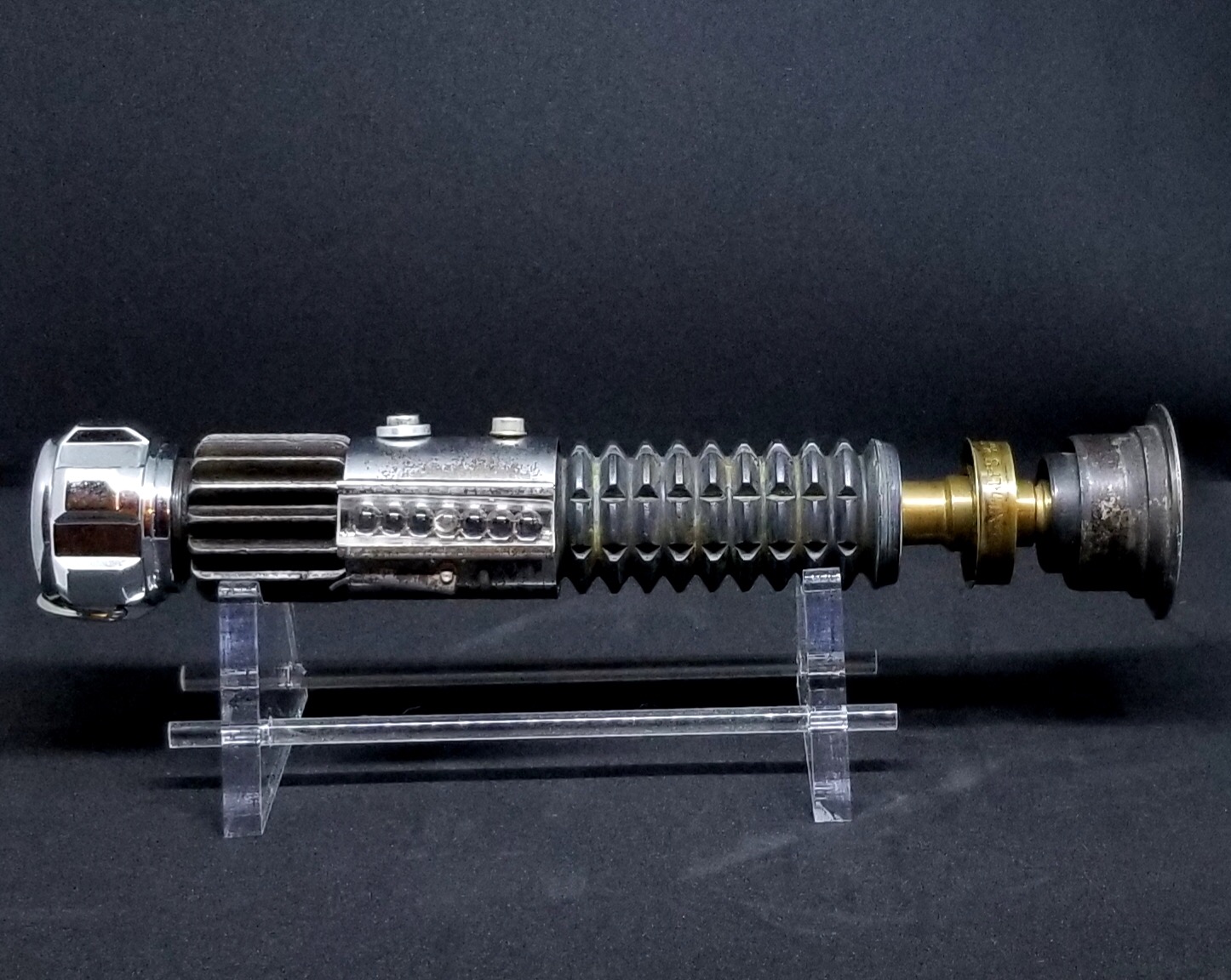

I can't believe I can say this... but I have finished my all real parts Obi-Wan ANH lightsaber!!!
A huge thank you to teecrooz, kurtyboy, Sym-Cha, Romans Empire, The Ninja, & so many others. Without the help, tips, suggestions, encouragement, & sales in some cases... this would NEVER have happened. Thank you all!!!
Beautiful vintage parts Obi buddy, congrats on completing your build (y)
