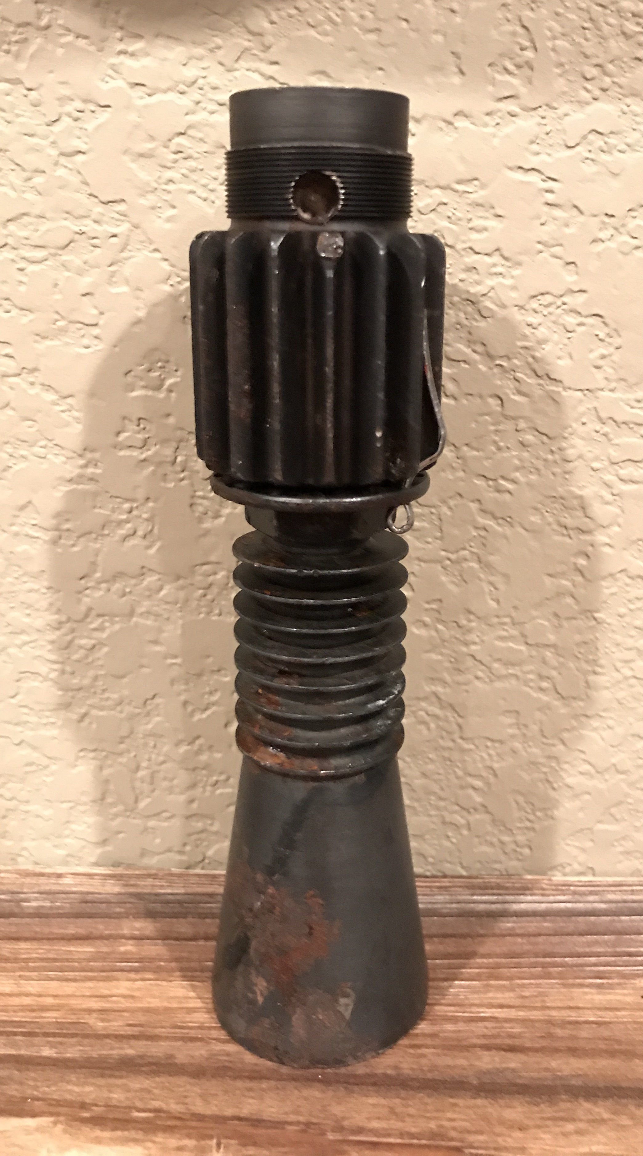

I saw, and saved the pics from arrowhead back in April 2017. But those photos are different from the ones I just saved today, I wonder if they were the same grenade? Everytime I look at their site everything says "SOLD", and it never seems to refresh, so I kind of gave up on it, guess I need to put it back in the rotation!
Great grab one way or the other, they both looked like specimen grenades!!!

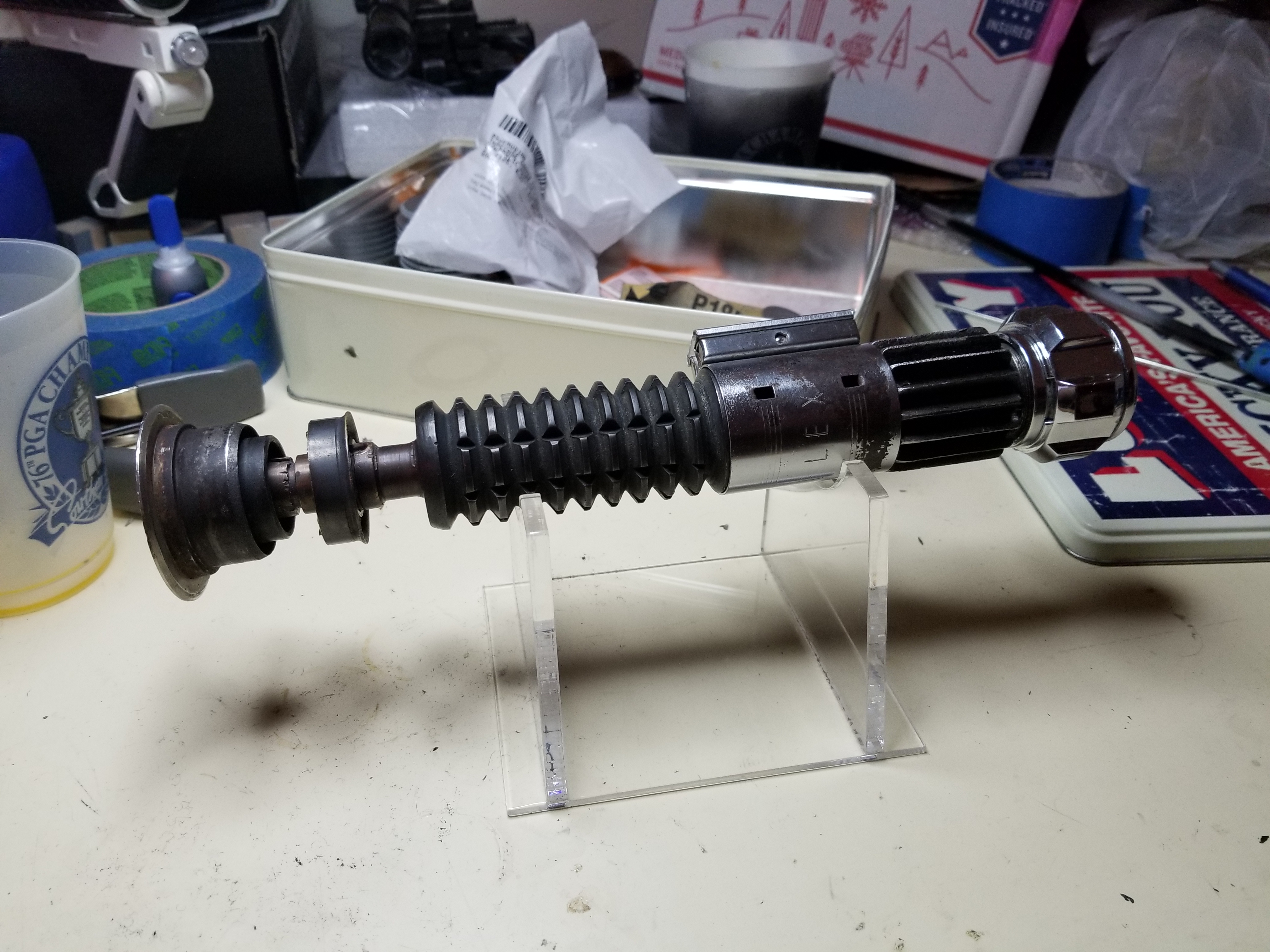

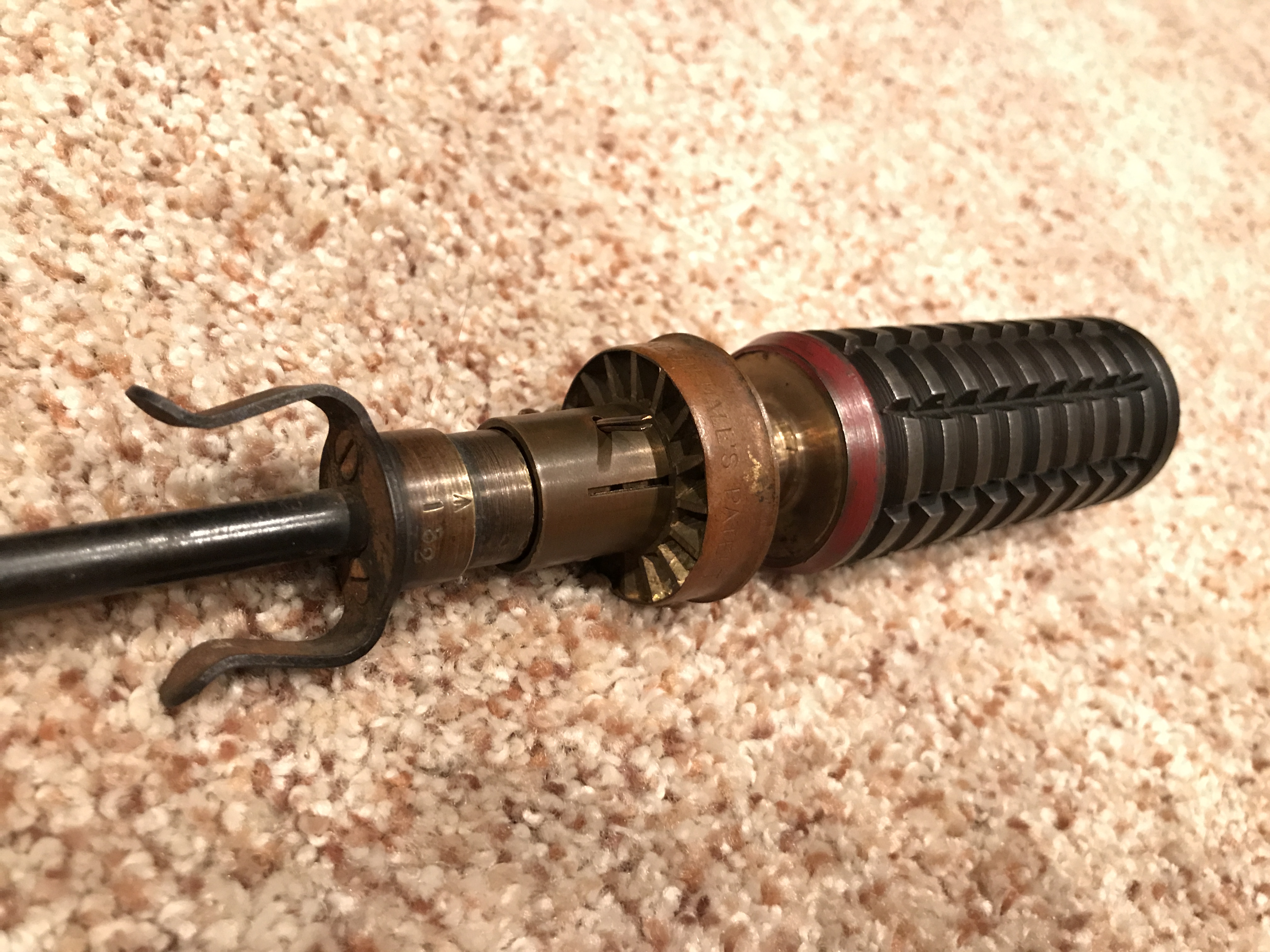

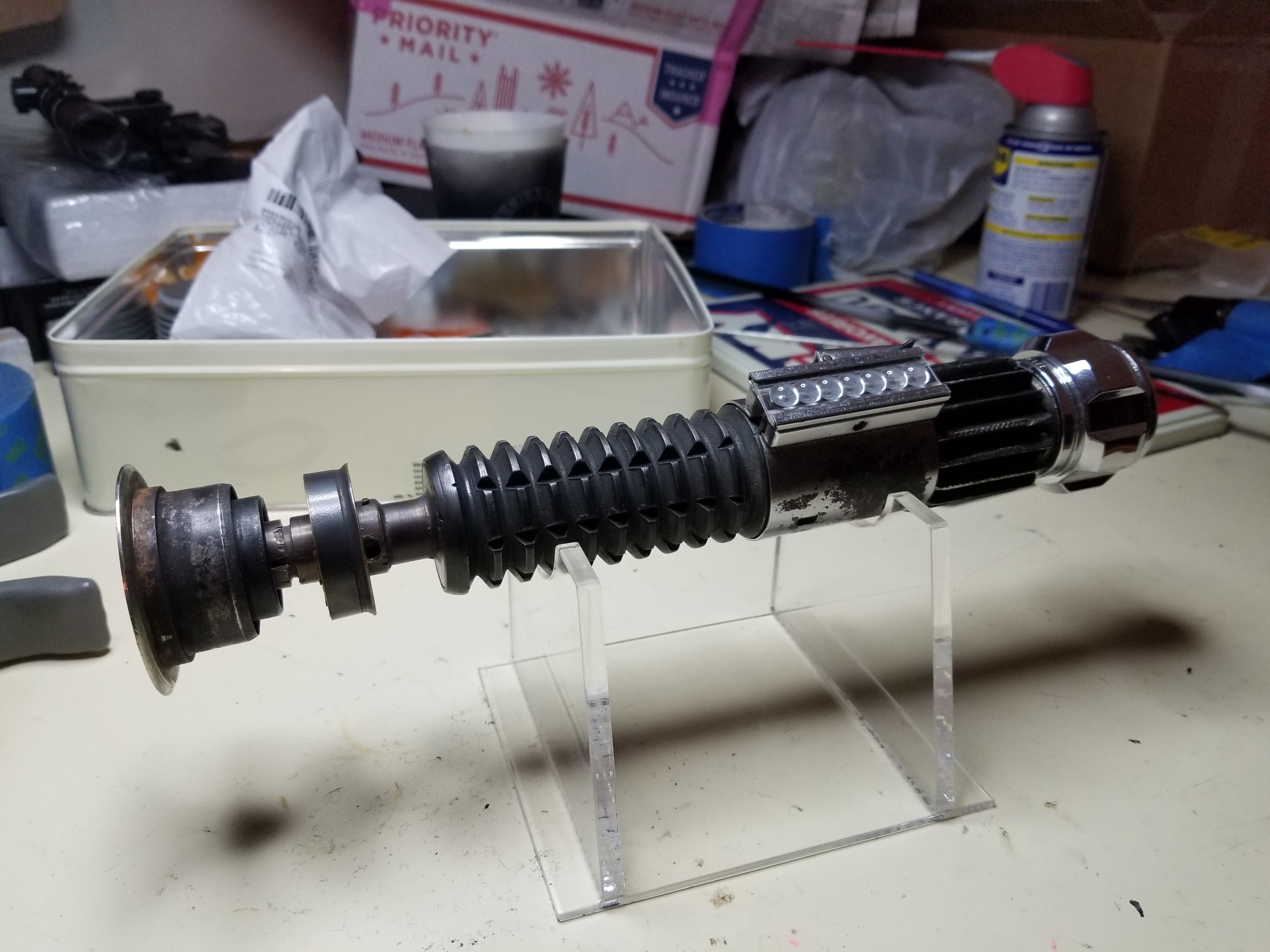

Ok...finally have a trial fit together.
I think Romans Empire had it right, I think my booster AND grenade had a lot of wear on their threads or had their threads made at the end of the run or something.
With a dremel and sanding cylinder i sanded the threads down on both ends of the adapter and both pieces now screw on farily easily. (Woohoo!)
Had to do the same with the balance pipe adapter too. No biggy, just an hour or two in a high temperature garage with high humidity :)

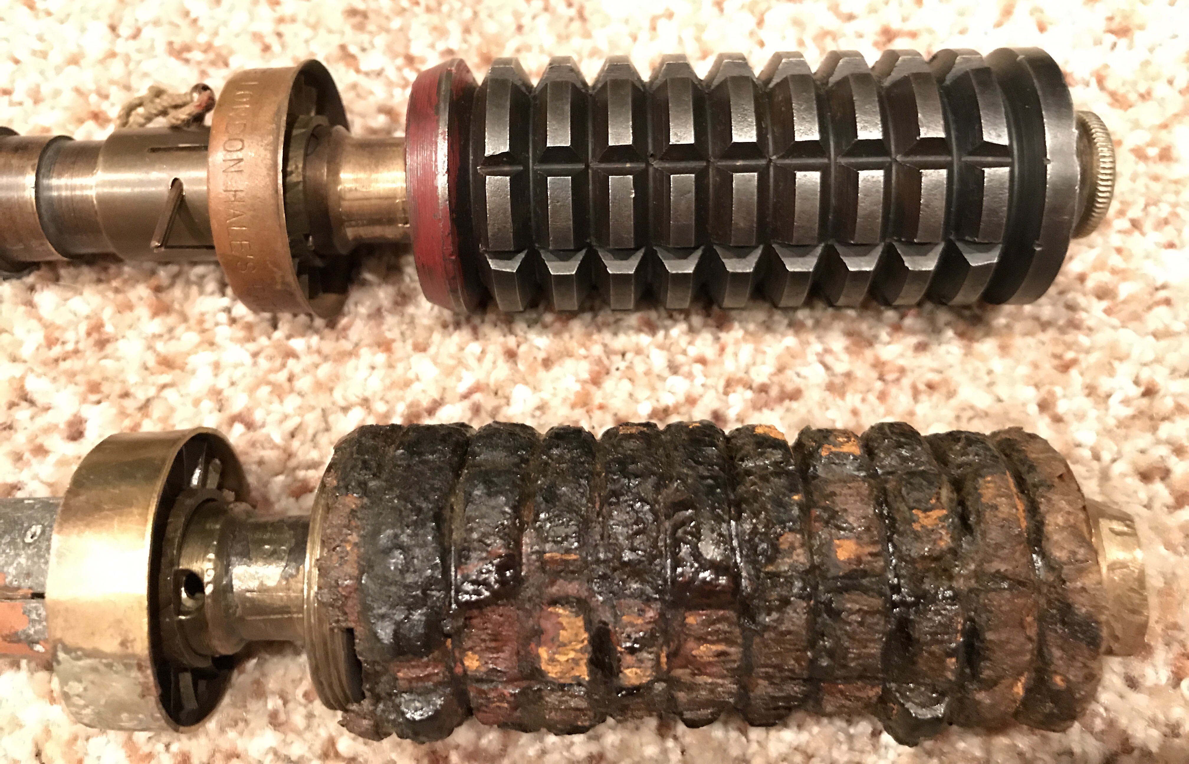

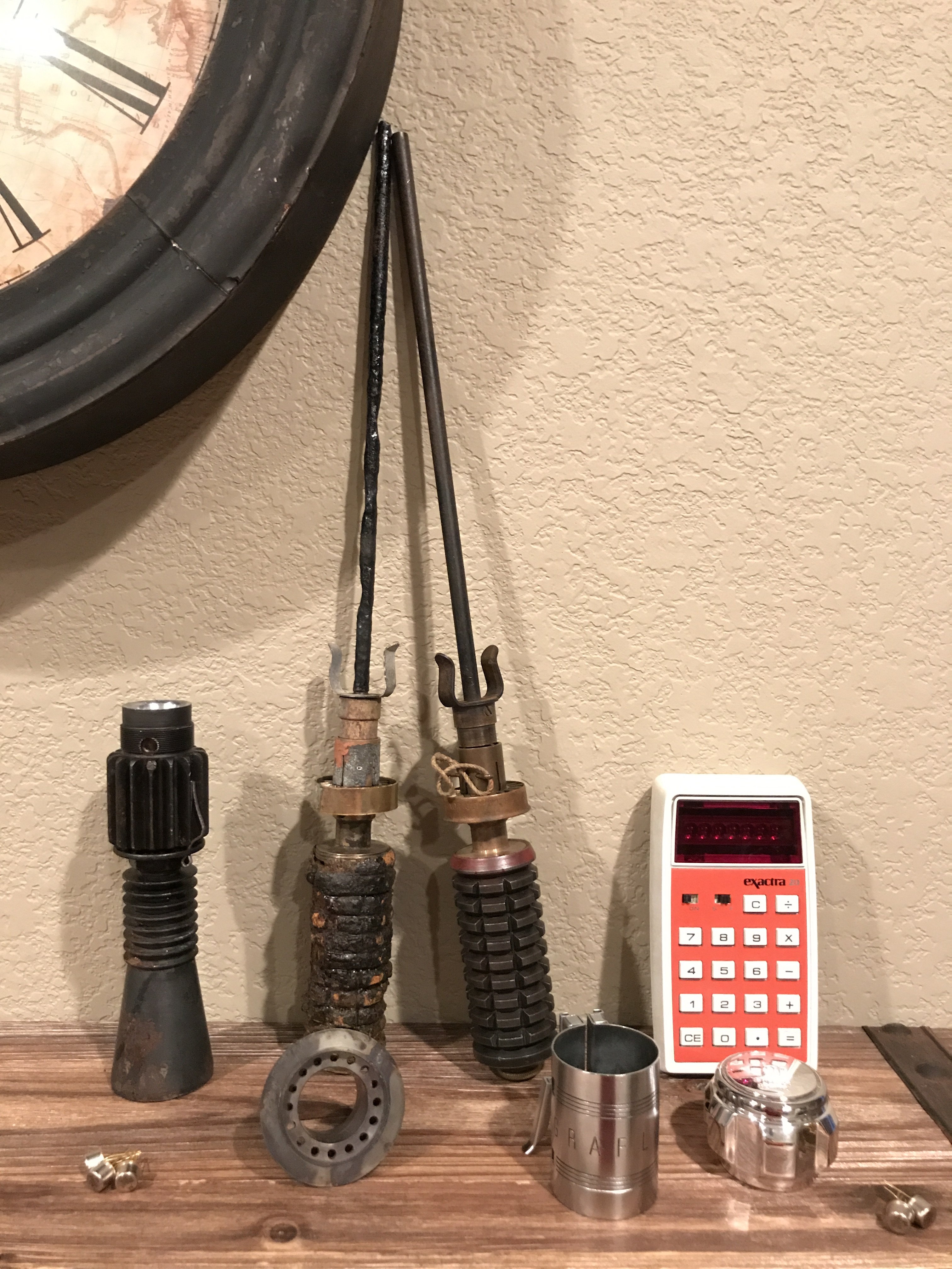

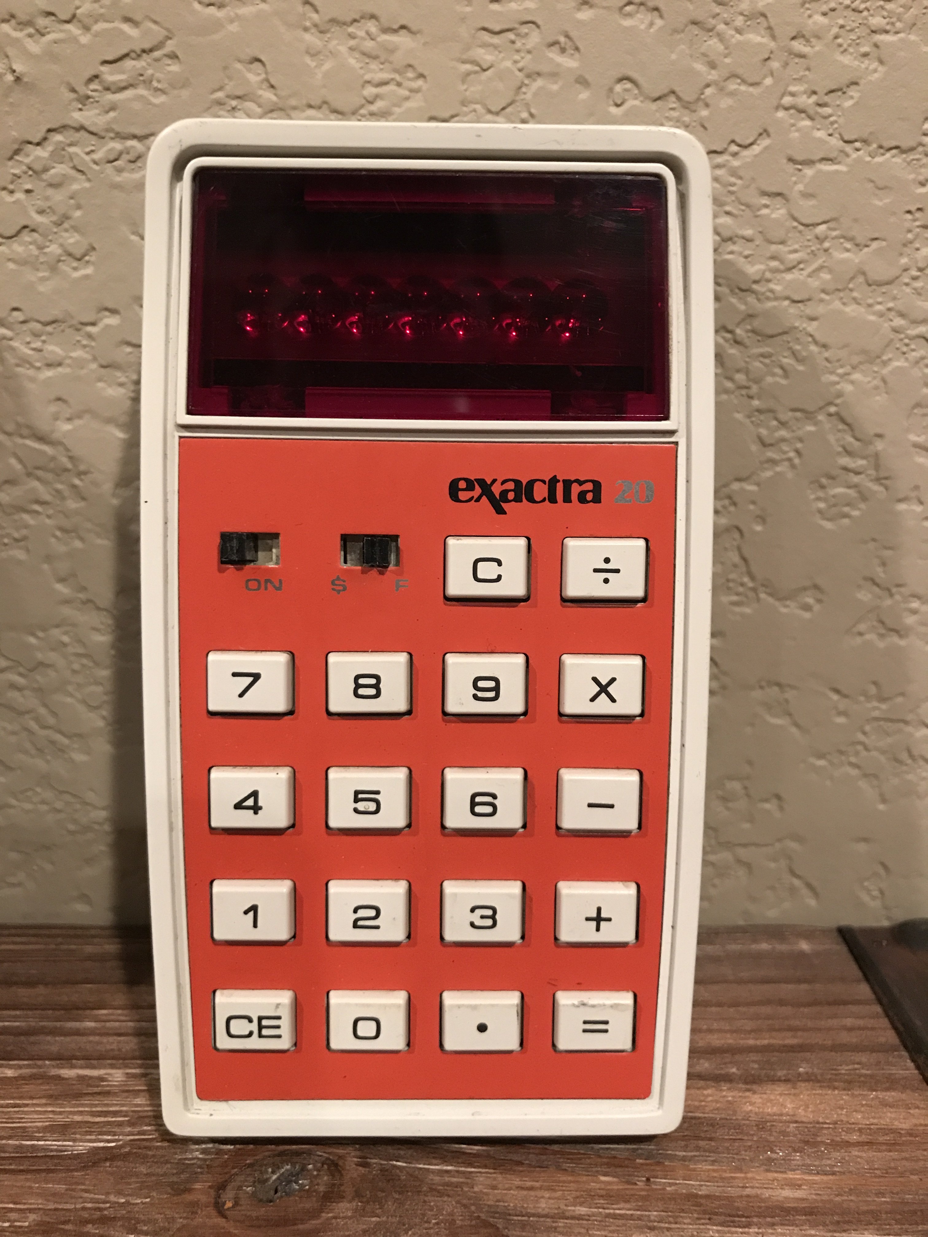

After all this time I finally see what it'll look like. All pieces are real except the calc bubble. I have a real calculator, just haven't pulled the bubble strip yet. I wish i had a before pic of the grenade. I used steel wire brush dremel bit and took it down to a shiny original steel and used perma blue. Had no real idea what I was doing...learned an important lesson. You're not coloring the steel, your oxidizing it. Yep, it's black rust so to speak and if you don't hit it with steel wool or wet/dry sandpaper it starts developing rust colored rust :) So a note to those who haven't done it yet. They say did it or coat it for less than a minute, dunk it in water to neutralize the solution, dry, and then steel wool or sandpaper lightly.
As i wrote earlier, i had to blast it with a torch to get the stem off the grenade. That actually darkened the stem to the color you see there. I did dunk it in some brass black, but it literally had no effect. I couldn't darken the spoke cover either. Had to hit it with a wire brush first. Dunking it didn't turn it much at all, but it darkened up over the course of a week to that color.
Sink knob, clamp, and balance pipe are all as they were. I haven't done anything to any of them. The clamp isn't a dead on match to ANH, but i really like the natural weathering on it.
Big thanks to Teecrooz, without whom this would still be a fantasy :) Can't believe it's finally coming together, and pretty nicely as well. Only paranoid part left is drilling for the d-ring. Hopefully the dremel drill press works well for that.
Looks fantastic ... well done ... personally I wouldn't mind just a little brown rust on the grenade :)
Chaïm
Thank you :)
That was the thing - I don't know enough about the perma blue process - IF (big if) if i could have stopped it in it's tracks, I agree with you...a bit of rust in the crevices looked really cool. Thing was - it didn't stop. It proceeded all the way up the crevices and was starting to get the outer surfaces of the grenade. I don't know if clear coat would have stopped it or not. I think it came out pretty dang well though. I figured it'd turn out looking fairly new, but the way I wound up doing it gave it a good color that looks really old. One of the things I think makes this look so good is the natural age of the rest of the pieces
You could always stipple a little bit of orange and brown and red down in the crevices with acrylic paint using a dry brush technique if you want it to look like rust in the corners.
Did you heat your grenade while Perma-bluing it? You probably could have just Perma-blued over the rust that was there (if not too gross) and it would have kept some of the "natural age/ looks really old" texture of the antique grenade. Part of what I think you're seeing now is how smooth the grenade cubes are from having wire-wheeled it. Try misting it with dull clear coat to give it back a bit of texture. Like the beginning to rust texture, not the pitted and nasty rusting through texture. ;)
One of the things I like seeing most on the grenade teecrooz gave me is the tooling marks in the "V" groves that run around the grenade body. As I work on it, I try and preserve as much of the original machining as possible.

I feel ya on the Bubble Strip, I kinda like having the complete calculator in working condition for my future display case!

My grenade didn't have any visible rust on the outside - it did on the inside though and all over the threads.
It actually didn't take much time with the wire brush to clean it off. I wasn't 'au naturale' or anything, it had a layer of paint on it. Couldn't blue through the paint, so removed it and moved forward. The grenade really isn't any smoother either. the edges of the cubes might be a touch, but not all that much. The color on it now actually makes the edges look rounder than they are

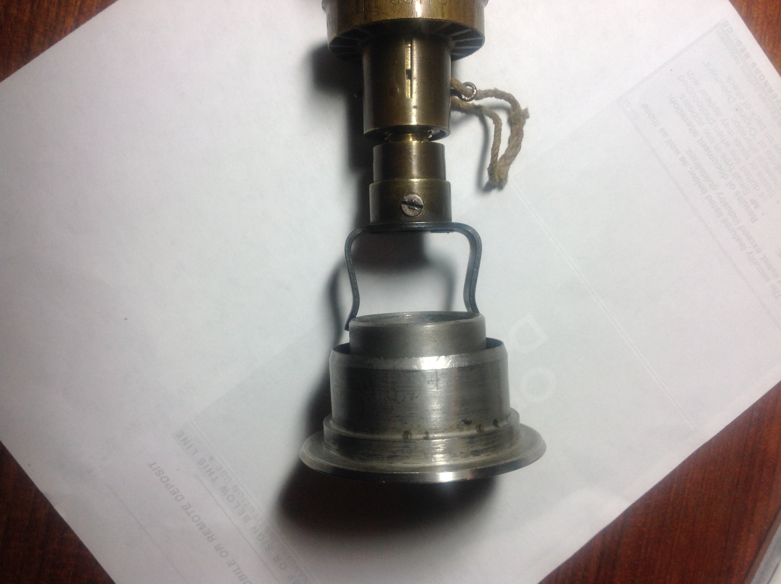

Has as anyone thought tom use the ears that were designed to kee the grenade from falling into the rifle barrel as a clamp by jamming them into the space between the rings in the balance pipe vent? Seems like with a little shaping and force that would work. But I have no idea how stable the connection would be. Is there any evidence either way showing whether or not the prop makers tried that trick?
I have thought about it alas my grenade didn't come with those ears and it will need a lot of tweeking to get the final endresult with the accurate neck part showing ... so I doubt the propmakers even considered it ... that said is it possible to reverse the position of those ears backwards and cover the piece with the one part that's held together by the cotterpin (removed) so all can be squeezed inside the emitter?
Chaïm
The ears would have to fit in the annular space between the two cylinders of the balance pipe vent, I think. It would require quite a bit more bending - especially at the base - to get them into the smaller cylinder.
But, if the prop makers didn't likely do it, neither will I. It was mostly an idea of how to best copy what they did for authenticity.

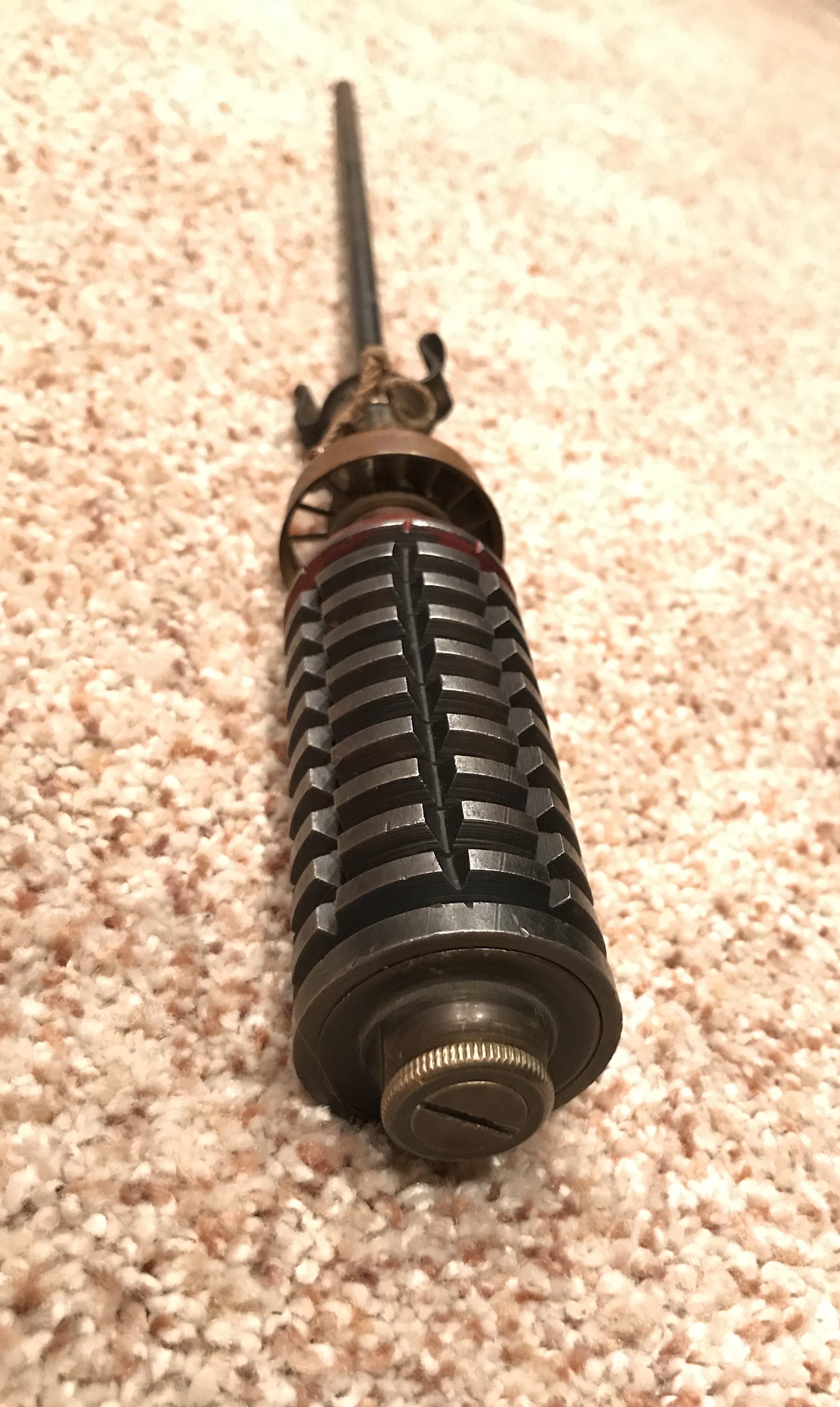

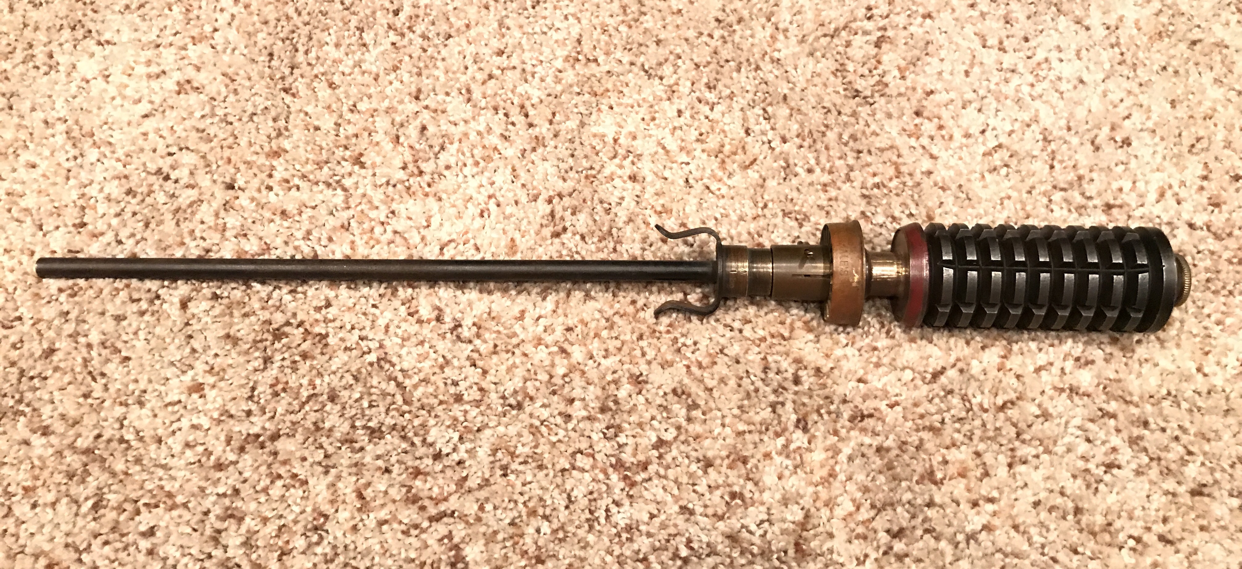

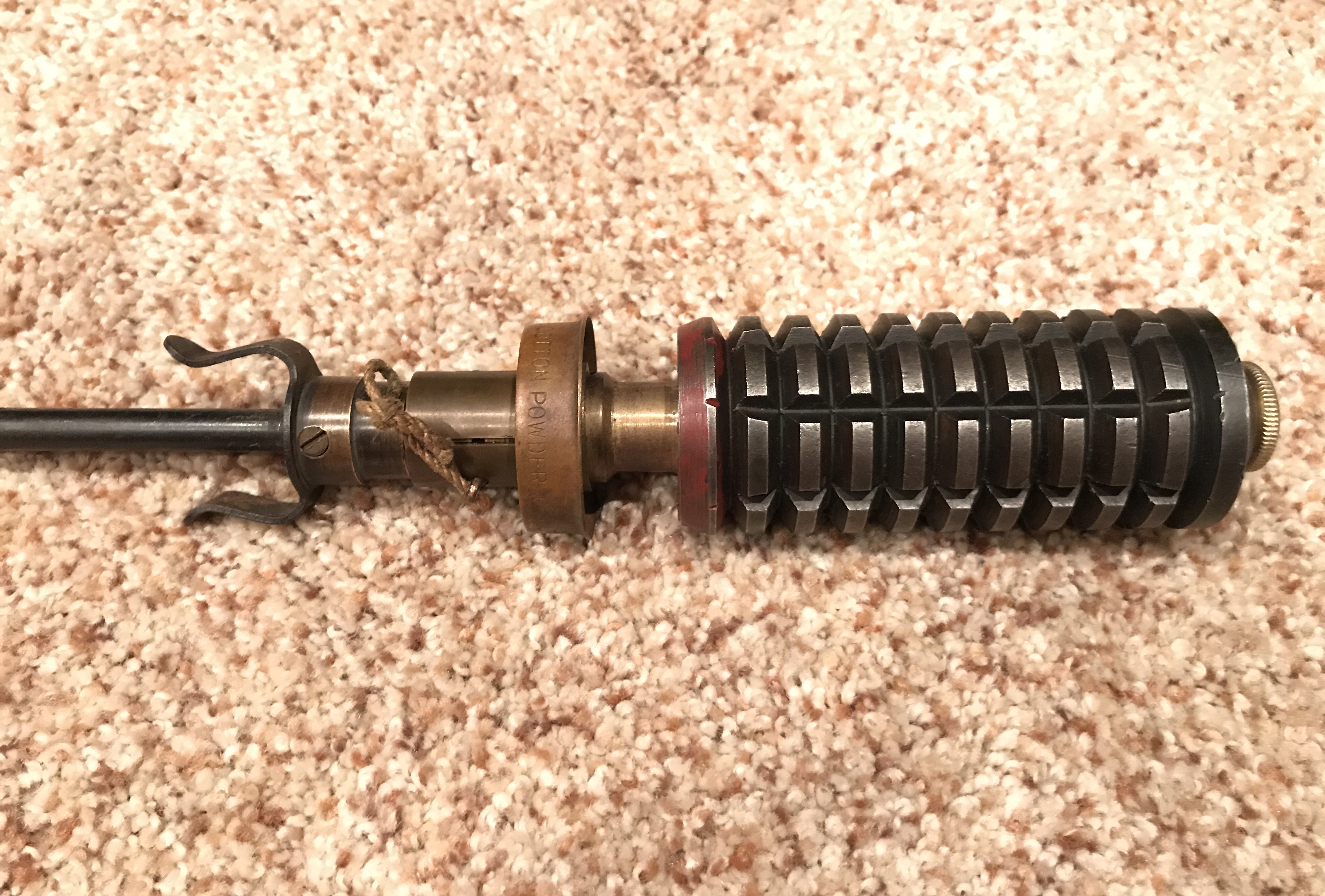

After an interesting journey of just over a years time my collection is now complete for an all vintage Obi. MTFBWY as it has been with me.
Just received the last item to my puzzle today, the Hales, which was located here in the US in a military collectors collection as was my booster/FH which was the first puzzle piece I found on my journey and caused me to continue the path.
Enjoy the eye candy.

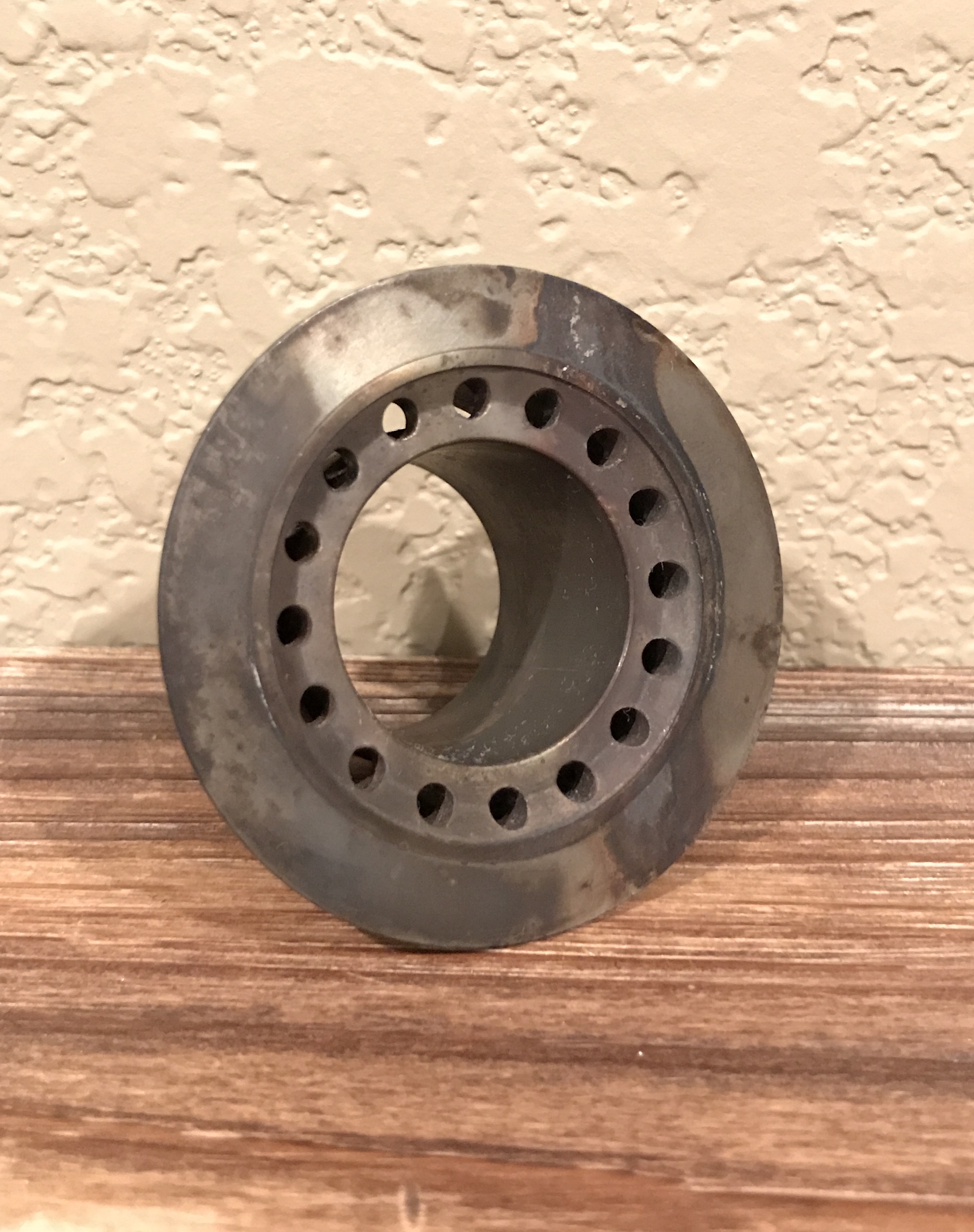

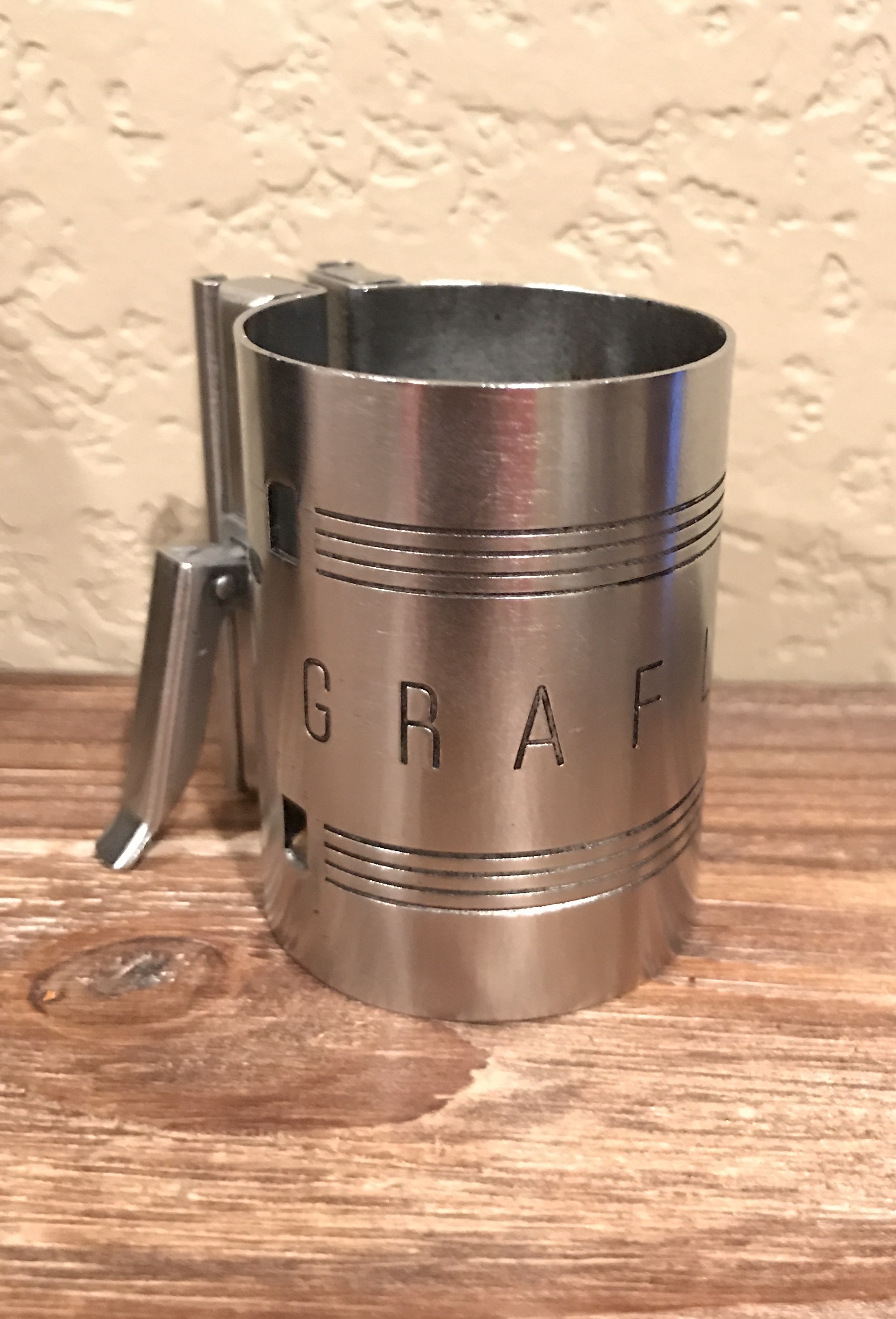

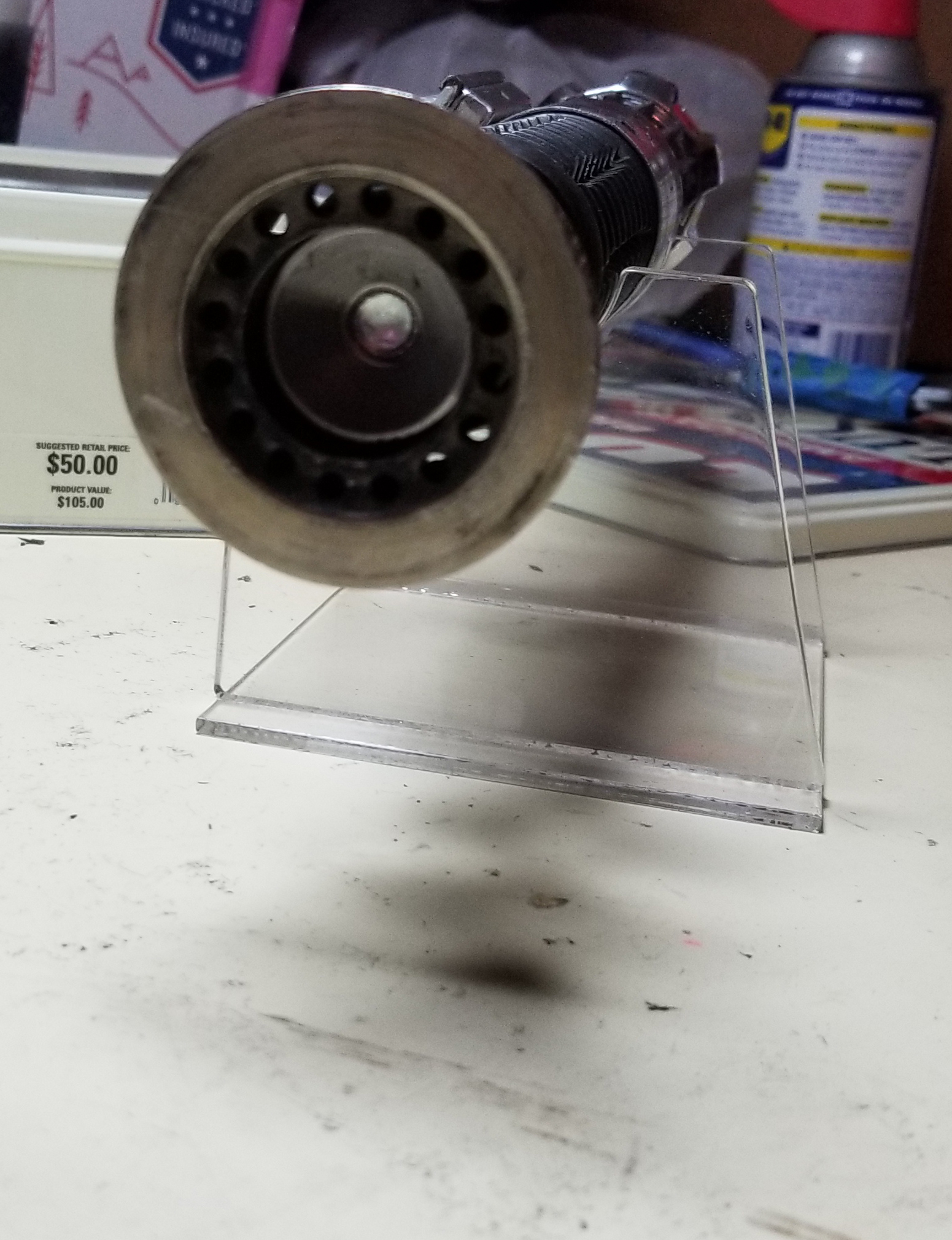

View attachment 744323View attachment 744325View attachment 744326
Was that my grenade at one point? Looks familiar. Anyways, a gorgeous build!!! Now lease it to Disney for the Ewan movie ;)
