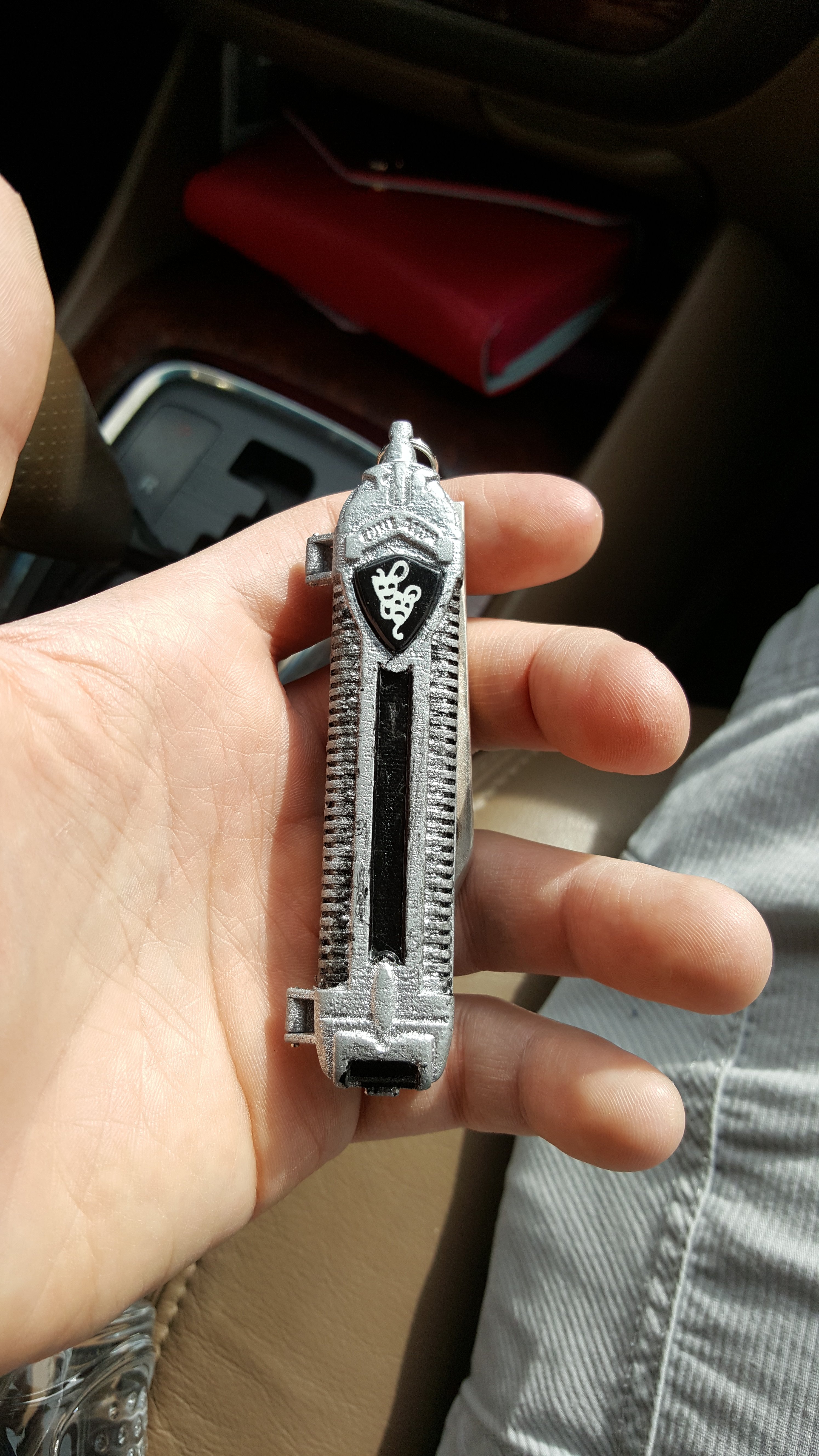

Not a great paint job but I will be doing the rhodium plated soon. Words cant describe how cool this is.
hmm....that was the "White Plastic Polished". It's cheap, but It looks like the finish is not smooth.
Maybe the minimum I should offer it in is the "Frosted Ultra Detail". The FUD has a smooth finish.
On the plus side, the hinges look good.
Just too grainy finish. I've removed that option from my page.

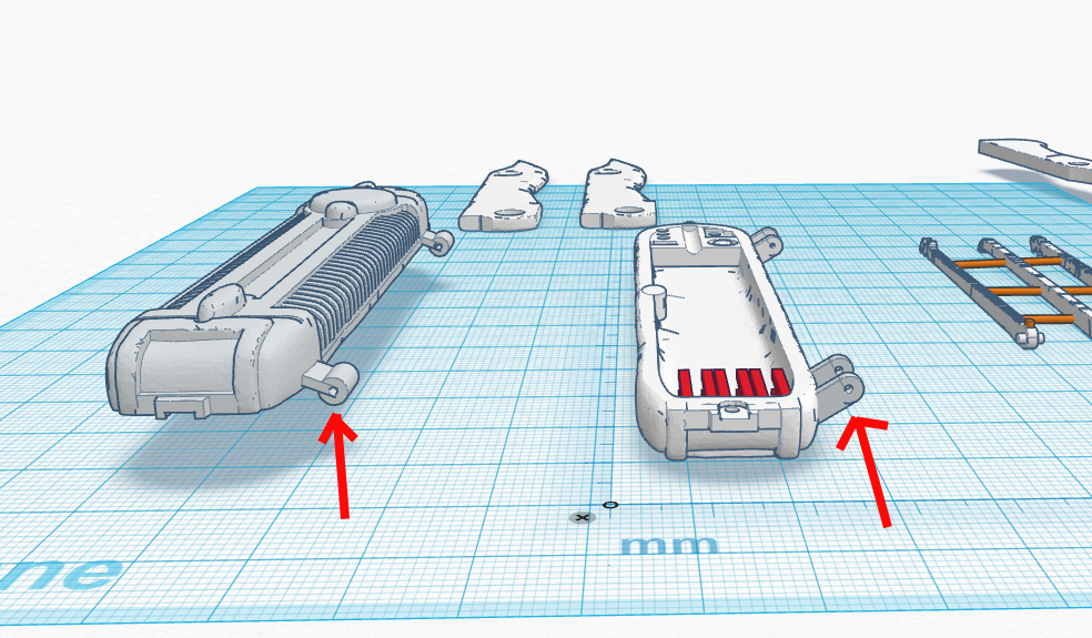

You need a pin (sewing kind, but not needle) Put it through the hinge and fold the end over. Snip the remainder of the pin off.
Here, there are two circles, one on top, one on bottom. The blade has a hole in it the same size as the circles. You need to gently pry the case apart enough to slip the blade past the circles. The circles will be completely inside the hole in the blade and act as hinge for opening and closing the blade.

what program did you use to design it? sketchup?
I use a combination of free / pay software.
I use Blender and Tinkercad which are free and Zbrush. (expensive ! :p )
