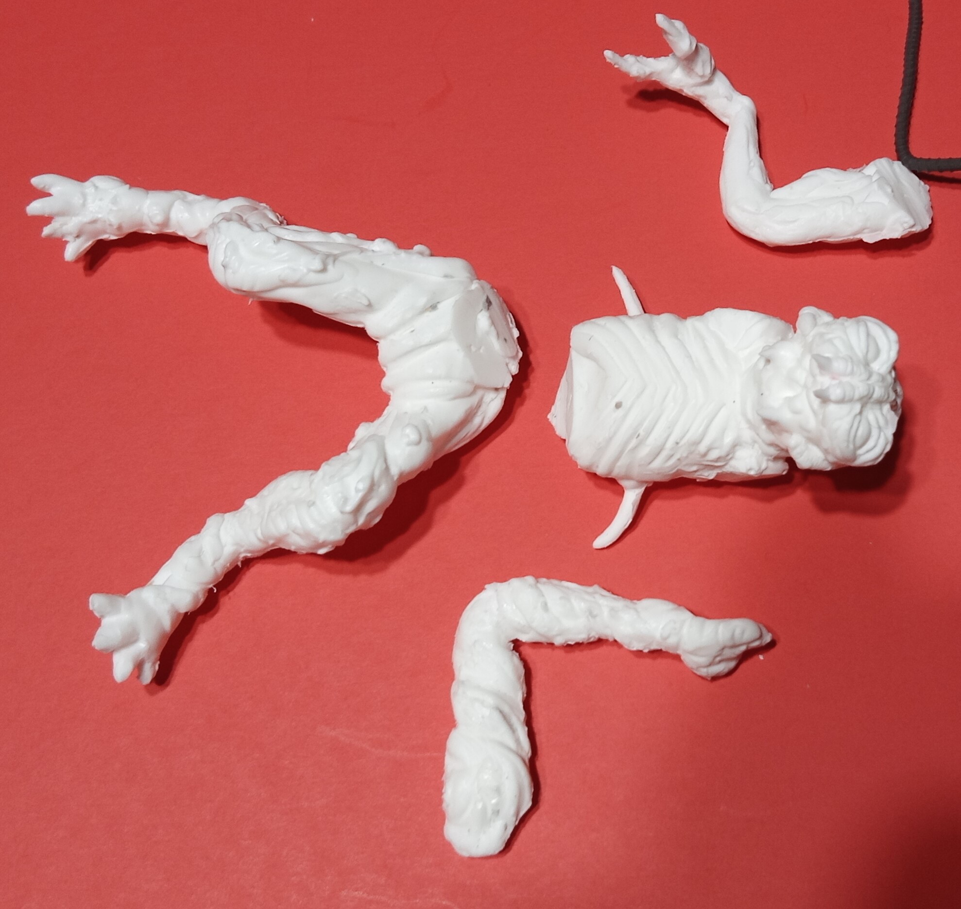

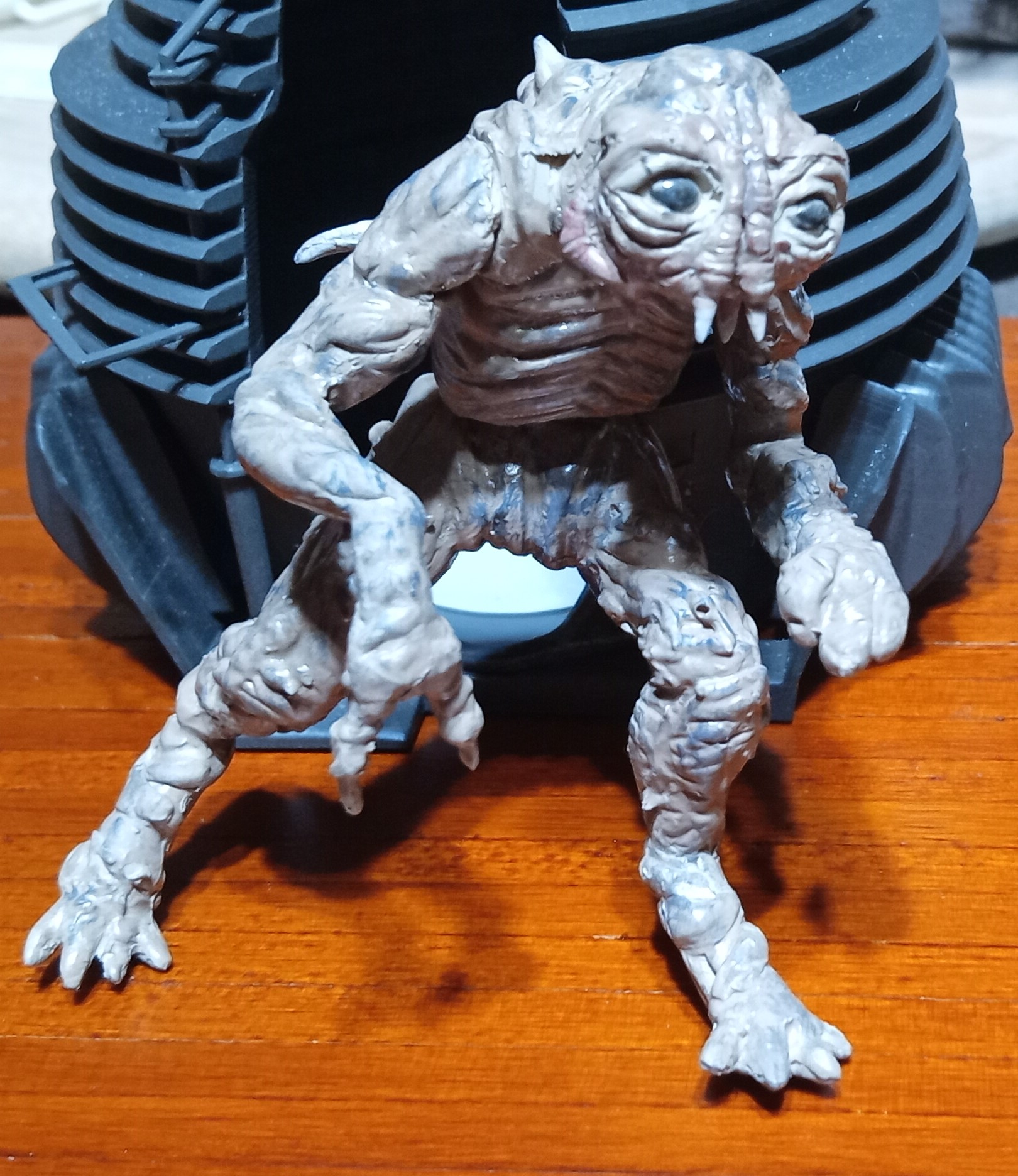

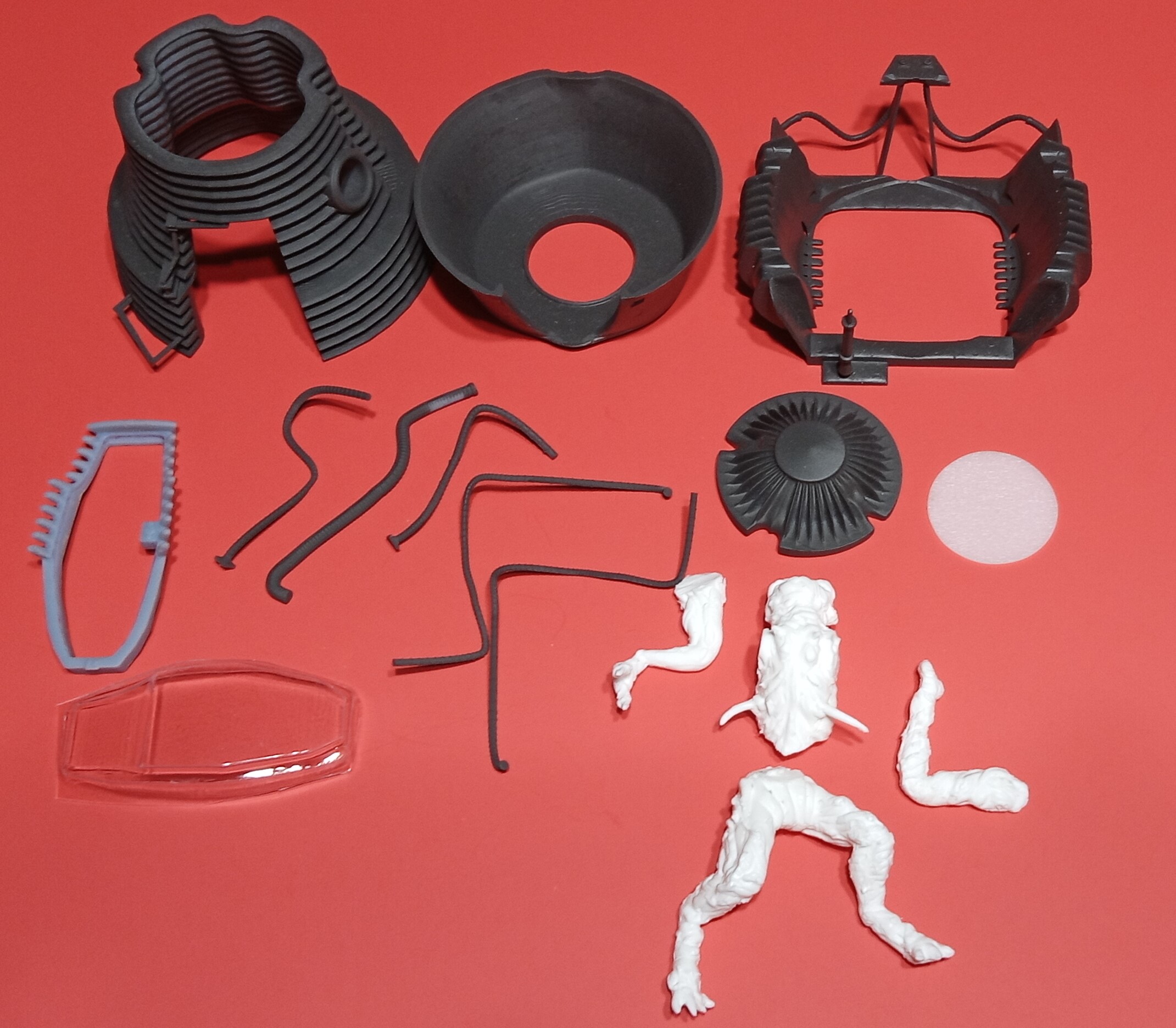

Yes, the Fly figure was sculpted by Joe Laudati at 1/24 scale for me.
Kits are available for purchase if interested.
Also Joe sculpted the Snake man for me as well.

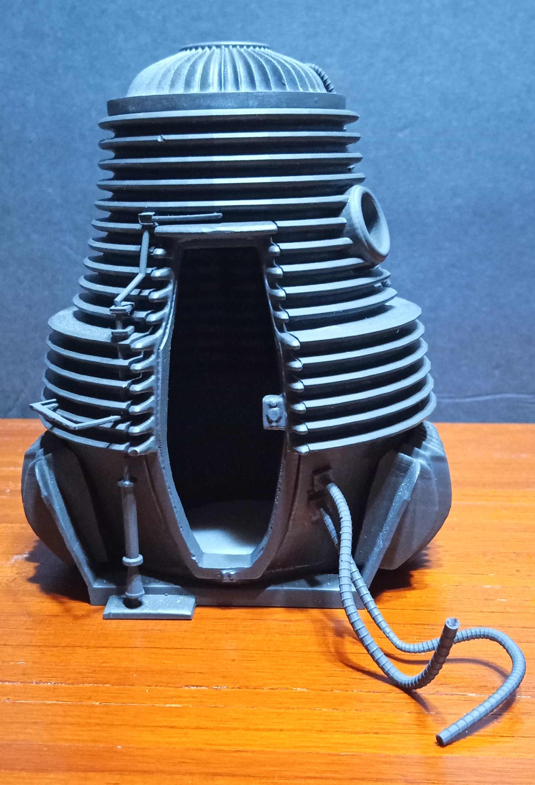

I finished programming the telepod lights. I designed a custom PCB for the base light since I wanted it to be as 'flat' as possible like in the film, didn't want any LED showing through individually, I wanted something super smooth. So, I design a PCB with 33 LEDs on it, arranged in a circle. I tested different acrylics until I found the proper balance of transparency with different thickness.
I ended up using a 3mm thick #7328 acrylic at about 5mm distance from the LEDs to diffuse the light properly.
There are 8 sections of LED plus a single on in the middle. I can address each section independently, as well as the center one using an atTiny85 micro-controller directly on the board. I'm at my third version of the board, started with green but realized it had too much contrast with the bright LED, the white board helps smooth out and bounce the light under the acrylic base.
Also, I wanted to have animation in the pod, since just standing there lit up felt a bit boring, I added a mode where all the LEDs would pulse slowly in and out to make the miniature more alive. Also, a second push of the button triggers the 'teleportation' sequence. In the film when something gets teleported there is some postproduction vfx light applied on the object that swirls over the object, looks like it might have been hand drawn frame by frame, I wanted to simulate that effect the best I could with lights coming from under the white floor.
not sure why this media doesnt play for me in the forum, if you click it it will play properly on imgur
It's a bit hard to capture on camera because of contrast and rolling shutter, it looks way better in person
