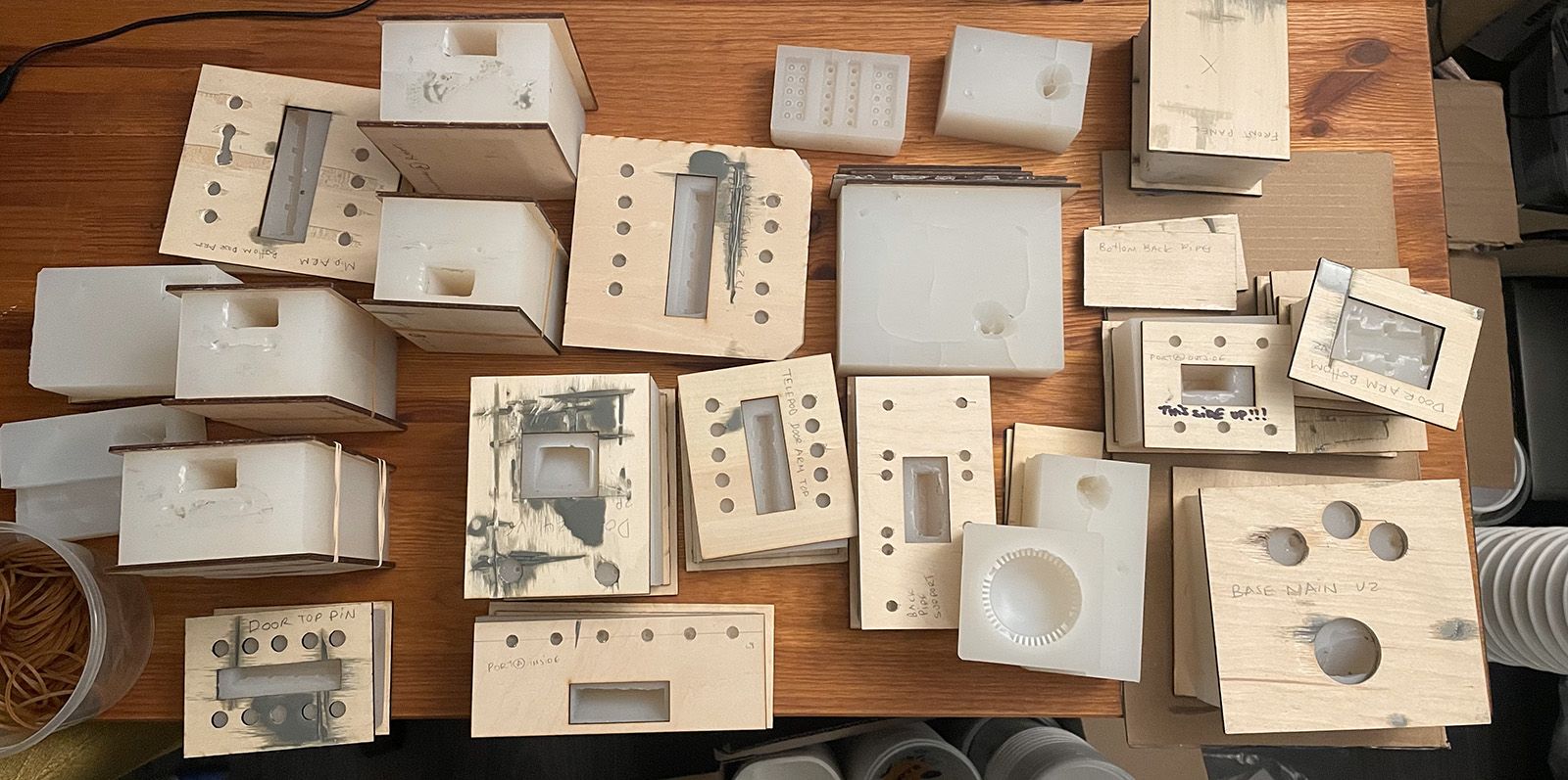

The model is made of different parts that are printed separately, designed to fit together as to simplify assembly. Also optimized to make the part castable, designing vents directly in the printed part in some case, or attachments that are later glued on.

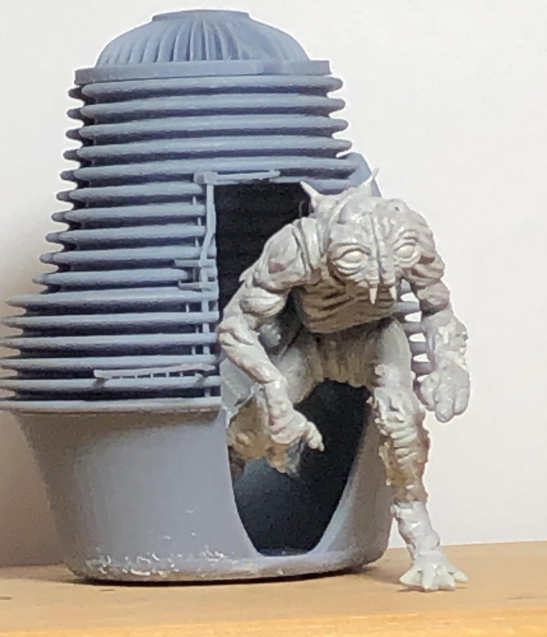

Coincidentally, I picked up this nice resin replica from Serial Resin Company, last year. It’s about 3” tall, splattered with resin “slime”, and came with a bonus Brundlefly head magnet. A cool little piece, although some of the pod proportions are a bit off.
The goo makes it really weird to me, wonder why they made it this way

As for my Serial Resin replica, their products are more about capturing the vibe of a film than anything else. Thus, GOO!
Y’know, instead of molding and casting your parts, 3D printing in resin would probably be much easier. Some online printings services print in resin very cleanly, with very little flashing/print lines. Maybe a bit of sanding for flashing and some filler primer would be needed for cleaning the parts up. Mind you, I’m not trying to be critical or tell you how to do things. Just floating possible options, because there’s a lot of potential with this project. I’m just really impressed.

The reason I am making cast instead of printing is manly durability. Ive done SLA printing using all sort of resins and its always very brittle, hard to drill, tap or machine. I've shipped pieces that I made that shattered in the mail and they were very well padded. Also making functional parts like the door hinge with resin print just didst work. 1mm, 1.5mm arms that are functional just cant survive very long being manipulated. The resins used in SLA print, which ever flavor, have very short strands of polymer. Mostly because the strands cant be longer than your layer in the Z axis. it just doesn't come close to the durability of cast resin whish has very long strands in every directions. in my opinion and experience at least, maybe others have better experience with SLA and durable resin, but I find the most durable SLA resin doesnt touch the worst cast resin. I only do resin print final object if I only make 2 or 3 of them. If i have to make 10 or more, id rather cast.
