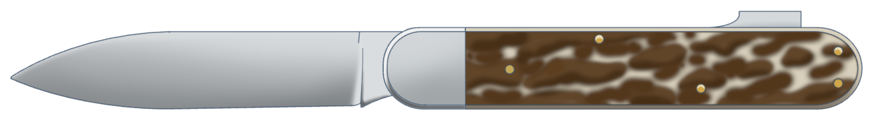

Thread edition, here is final design, opened lenght 209mm, closed lenghts 117cm blade length 92mm

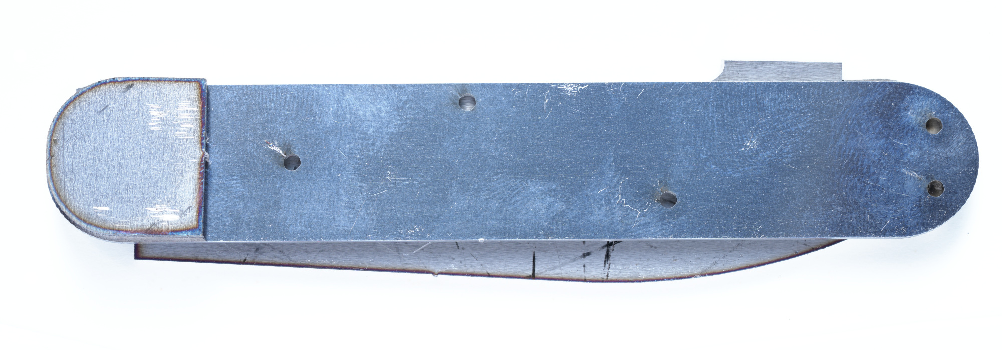

-get te prototype machined [DONE]
-finish prototype, and share on the group.

After some searches I discovered some facts about that raider pocket knife.
-it's not a Linder
-It's not a Hubertus
-it's not sourcable anywhere, new or old.
-the bolster is stainless and has no grooves
-the rivets are steel
-the handle is fake stag
-the blade shape is different from any existing knives I saw, especially the base
You can see the colors on this 4K screenshot, notice the bolster shape and color, rivets, stag handle, blade shape:
The stag is not grinded to match the bolster, rivets color and position, closer to linder than hubertus, but color doesn't match any of them, both have brass rivets.
I recently learn the Linder blade size, which would be 1cm smaller than my blade, which I designed based from those pictures.
Bolster is plain like the Linder, and made from stainless, unlike hubertus, which has a german silver bolster
Blade shape especially base doesn't match any of them.
The fake stag is not like any of them, but I have seen this material on vintage knives made in Thiers, I will ask some knifemaker friend to show me some examples.

After some searches to enlarge my prop collection I discovered some facts about that raider pocket knife.
-it's not a Linder
After searching on the internet and examinating similar knives, I concluded that, first the bolster is stainless and has no grooves, the rivets are steel and the handle is probably fake stag, the blade shape is different especially the base.
The stag is not grinded to match the bolster, linder is, hubertus is not, hubertus probably has fake stag.
Rivets color and position, closer to linder than hubertus, but color doesn't match any of them, both have brass rivets
As I am a knifemaker, living in french knifemaking city, I can produce this knife, just have t design it, get it laser cut, tempered, and blade edge made, then make assembly and finish, I already started 3D design.​
I want to use genuine stag, but for the best accuracy, I want to choose wsely, to avoid the grinding to match the bolster as much as I can.​
I think the price would be about 150€ plus shipping, I have concern regarding shipping to some countries because of legislation, as the handle is 11cm, and blade about 93mm, some countries may have restrictions (Japan, Canada, UK?!)​
If anyone is interested, please comment.​
