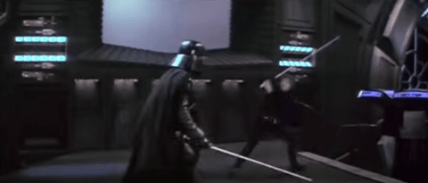

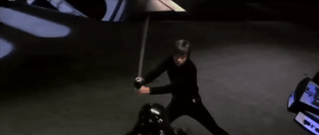

and now (thank you.... tumblr...) ROTJ Blades, much whippier than ESB i think, but both are whippy
ROTJ Throne Room Gif
maybe tougher tensile strength near the tip (I'm sorry for my phrasing)
Throme Room Gif 2

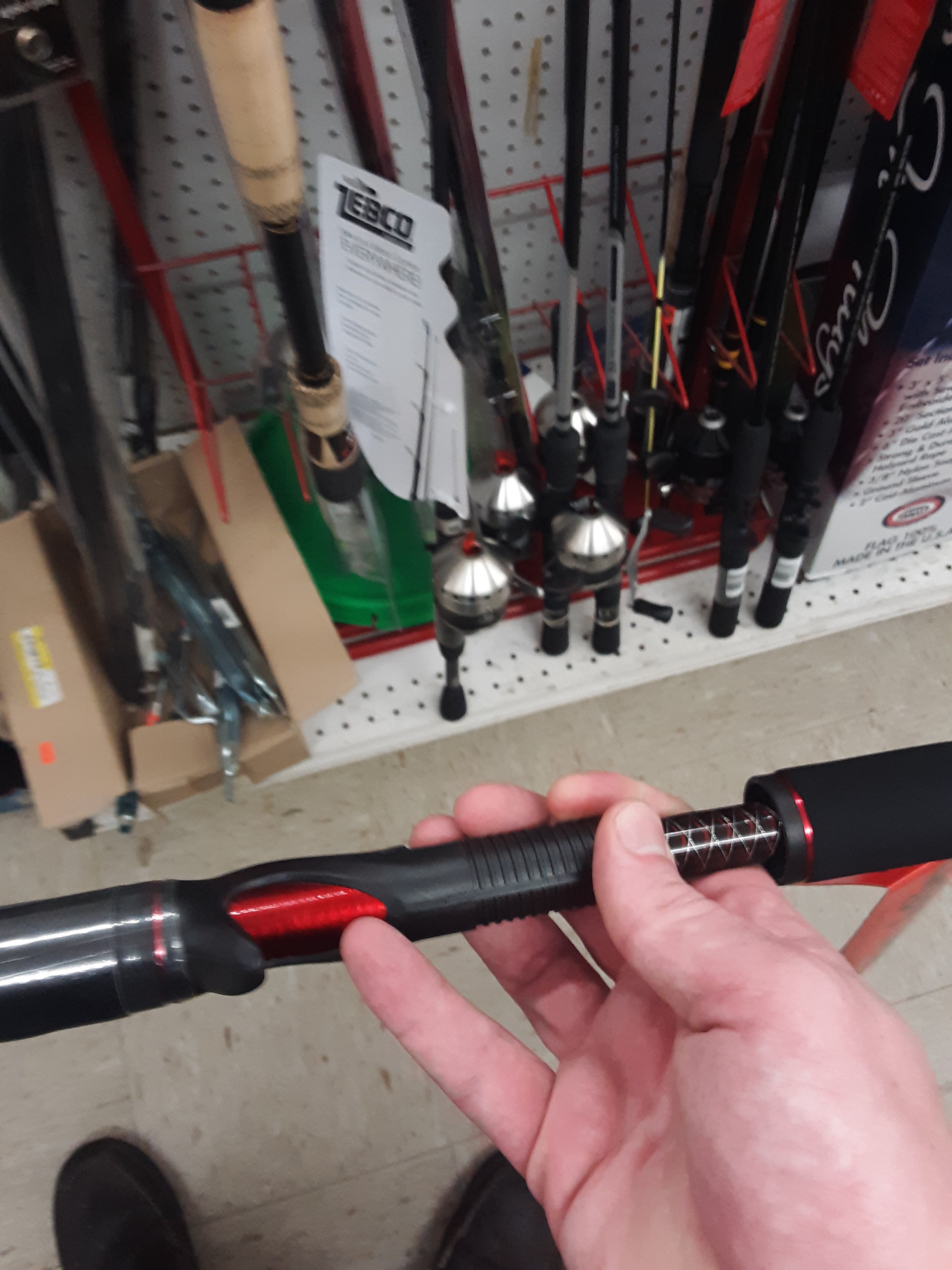

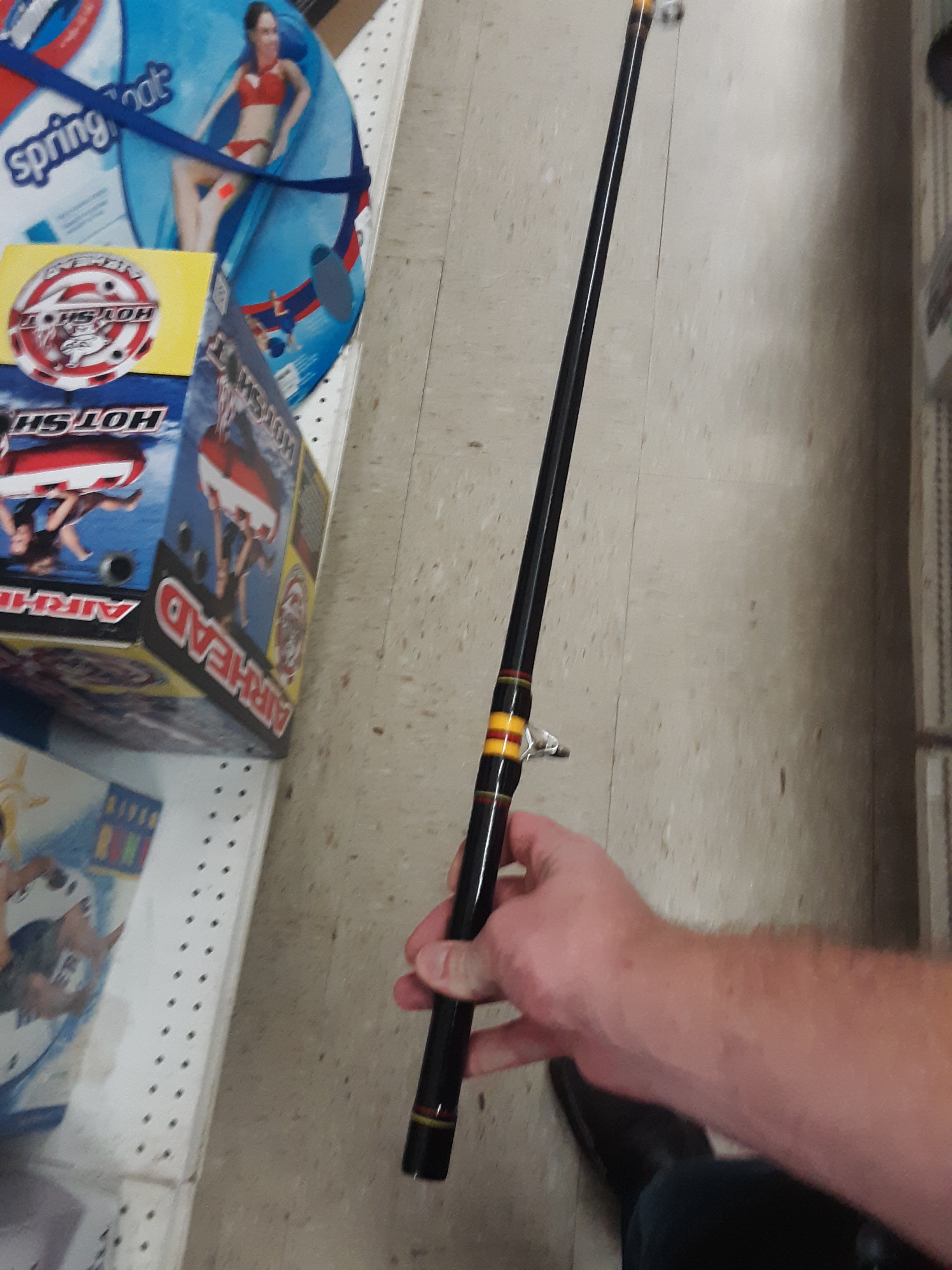

I did more investigation into fiberglass today I'm starting to believe that more durable high end fishing pole blanks could have been a possibility. A medium- heavy pole is got some decent flex while still being fairly rigid. They seem like they can take a good whack. Especially the heavy gauge if you look closely at the red portion that extends into the grip foam/plastic they are near perfect diameter for most of the blades we have seen from the v3 to the flashguns. Let me know what you guys think
I'm with you on this - fishing rod is the only fiberglass I can find that's tapered, the solid & short sea rods look real tough. I'm also keeping my eyes open for cheap examples (solid / hollow) to test.
Keep in mind there may well be something else we just haven't come up with & keep in mind they may well have used several different types depending on what they're filming.

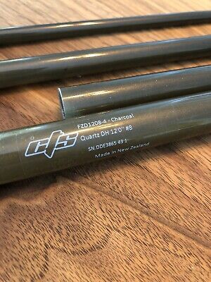

The color and texture seem to match the BTS images of the uncoated blades

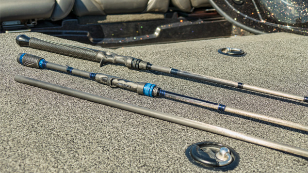

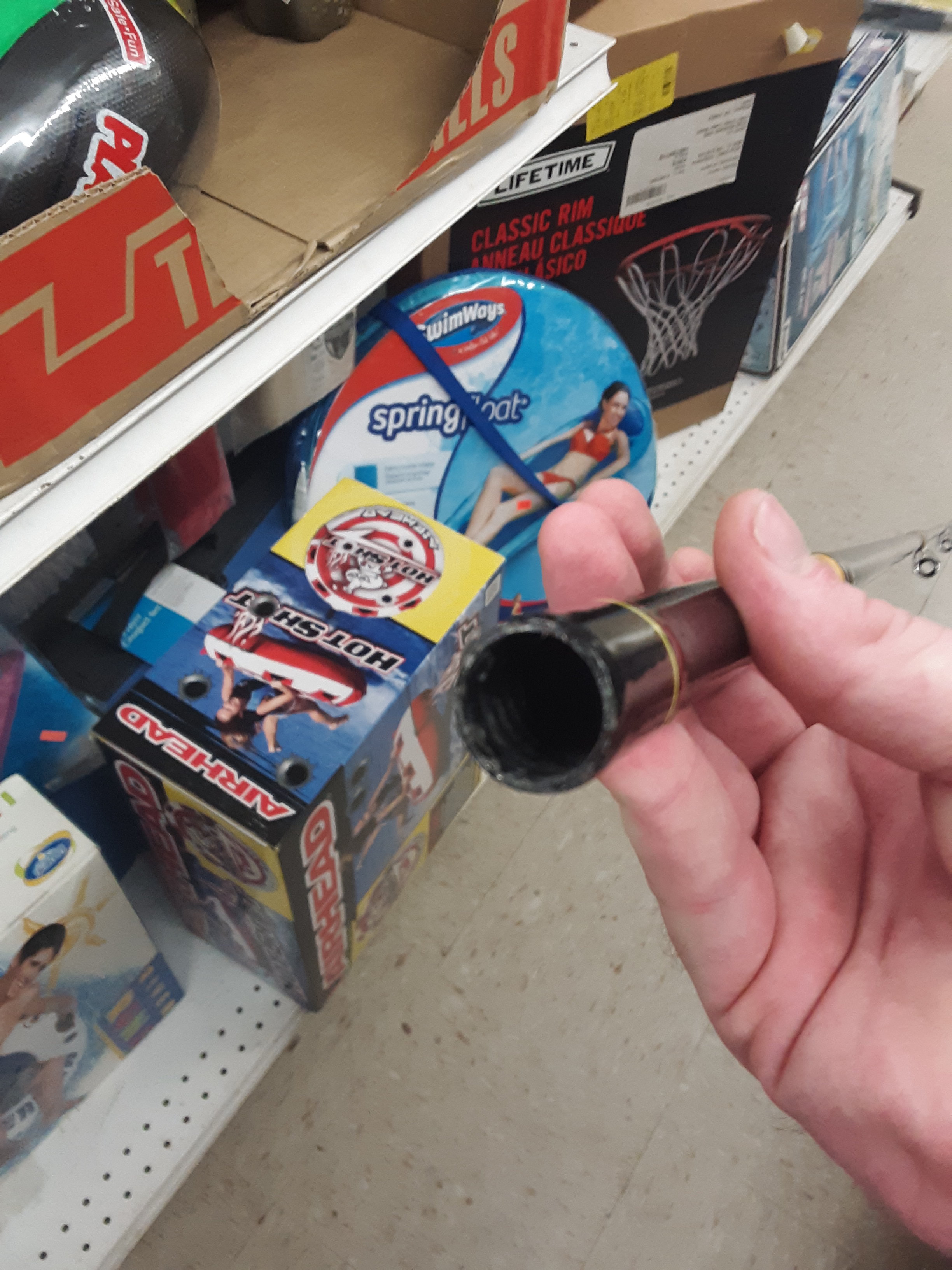

That's quite thick walled. Certainly a very good ESB contender. How expensive?

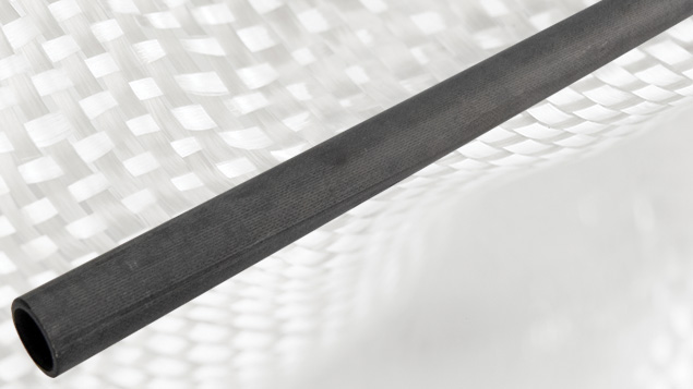

edit: just looked these up & can't find a price but did notice these latest gen carbon fiber... Tough stick & solid glass (esp latter's diam) look more promising.
It's noticeable that the heavy poundage spec stuff is all GRP.
Would these carbon fiber rods have been around in 1979? Or something similar?.I know carbon fiber was in its infancy but it was around . I just have a hard time seeing Lucasfilm forking out the money for carbon fiber since 20th century fox was all over him about time and budgets for ESB

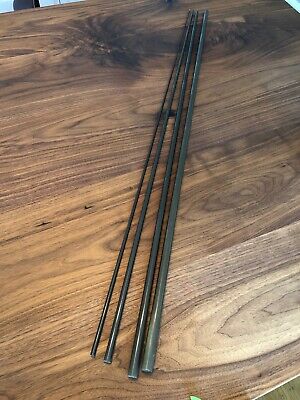

Can only post one source since the other images came from auctions. I've talked to these guys they seem to be the number one source online for blanks they recommend the heavy grade which is kinda pricey. After what MouseVader said I looked at a graphite rod. Probably alot more durable but not much flex . I believe we are on the right track gotta be fiberglass or graphite antennas or pole blanks or both!
