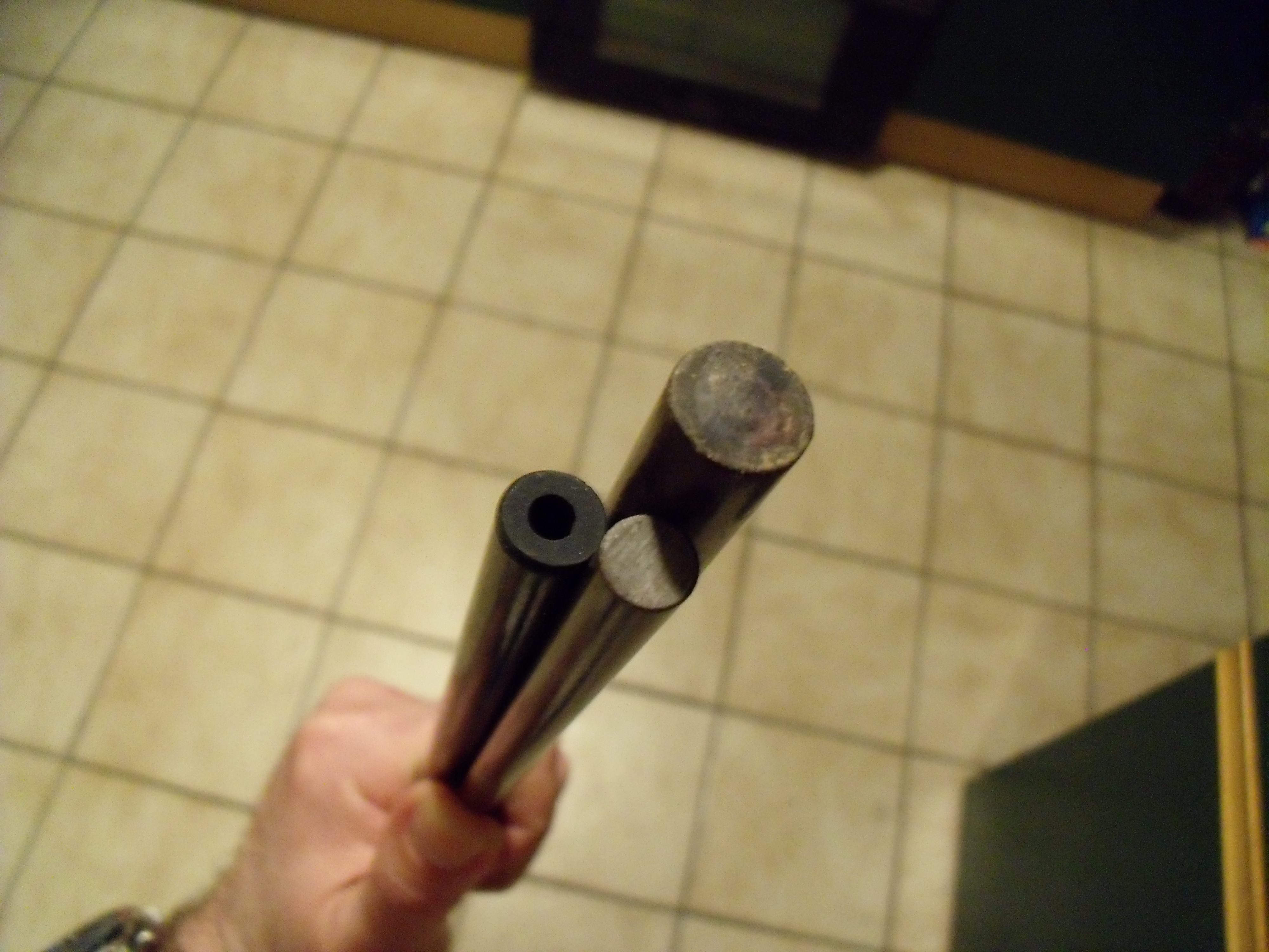

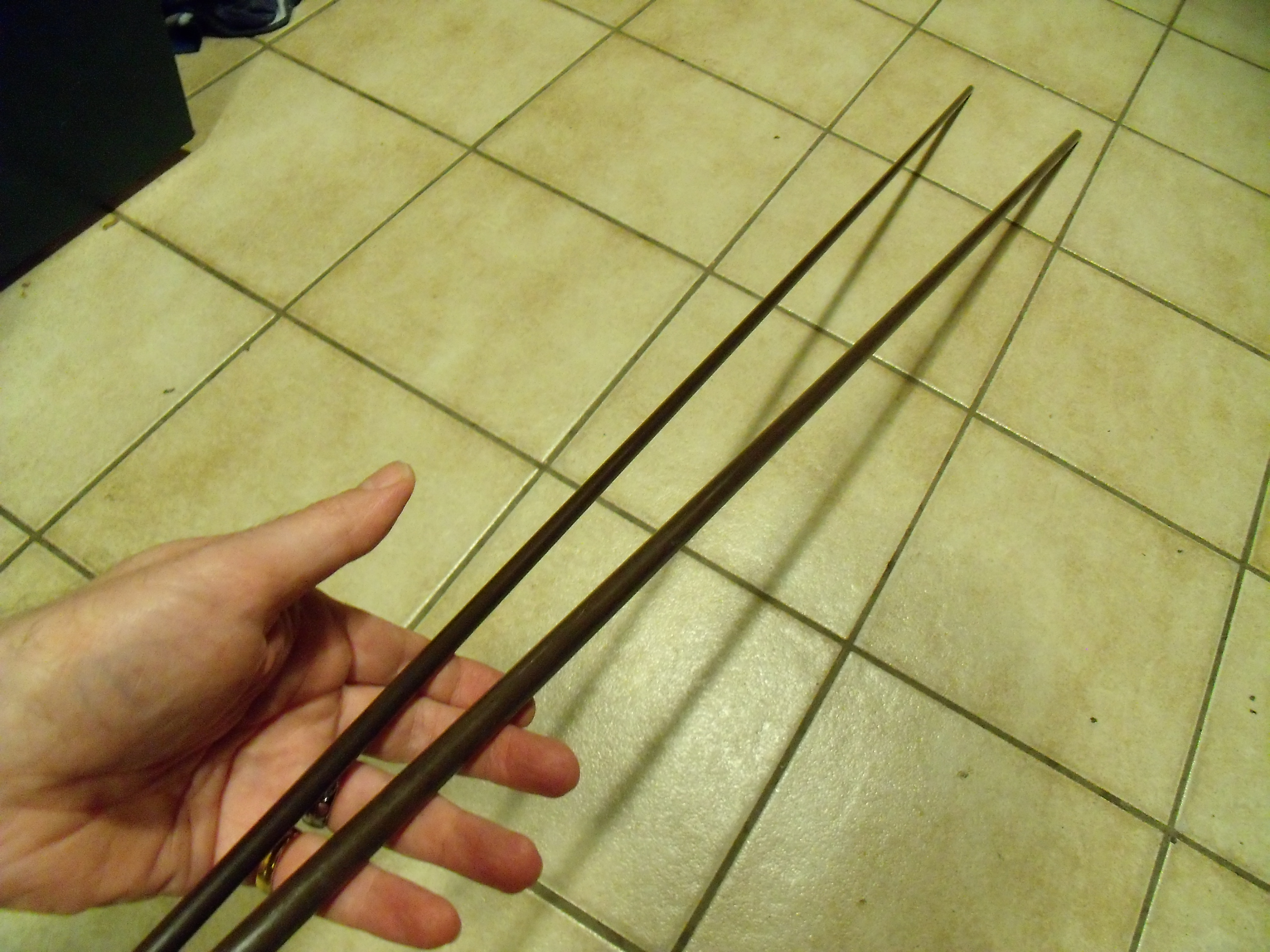

Found 'em. Thin one is 3/8" ; thick one is .45". Both 4' long. Black one is a fiber glass tent pole. This stuff gets made somewhere.

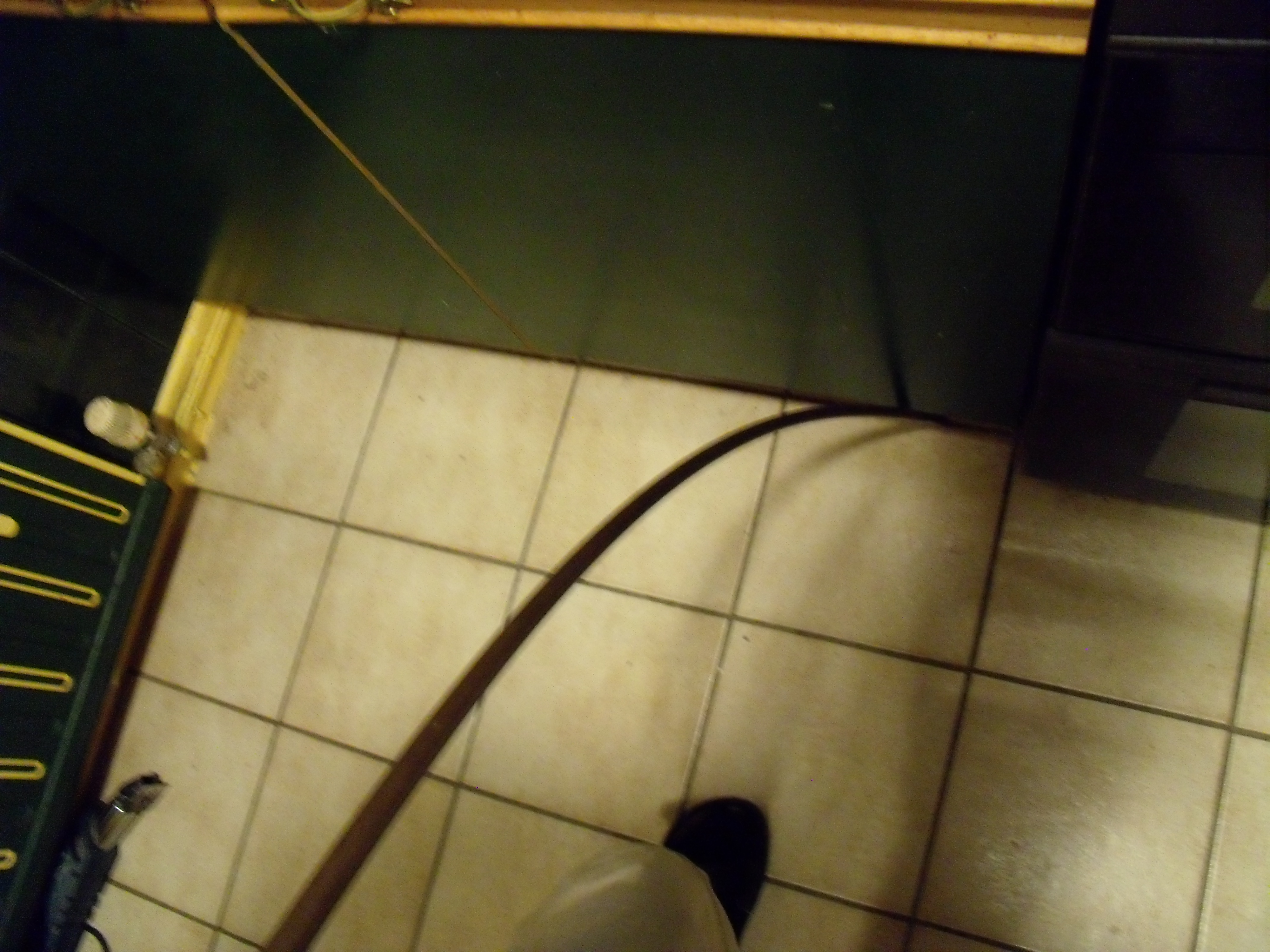

Very bendy, if you've the strength. This is the 45.
How they sound.
Way to go Mouse Vader! Sound and look just like some of the ones we have seen especially the color, reminds me of the blades we see in the archive video.What are the thick ones made for ? We need to find one near 16-18mm thick and partially hollow (Tom do they need to be hollow?)
Yes and given all the photos, material theories, sounds we hear, and given the fact that carbon fiber was super expensive back then and doesn't have that much flex fiberglass is the logical conclusion. I wonder since solid rods have more flex like we have seen in BTS footage that its possible that the holes could have been drilled and tapped into the rods/blades to adapt for the inner collar. Fiberglass is still pretty sturdy even when drilled / cut. But then my experience with hollow tubes has been limited
Bought as ram rods for Muzzle loading rifles. I'm thinking retailer buys them in as plain stock. Not tapered but gives us info as how fiberglass rod behaves.

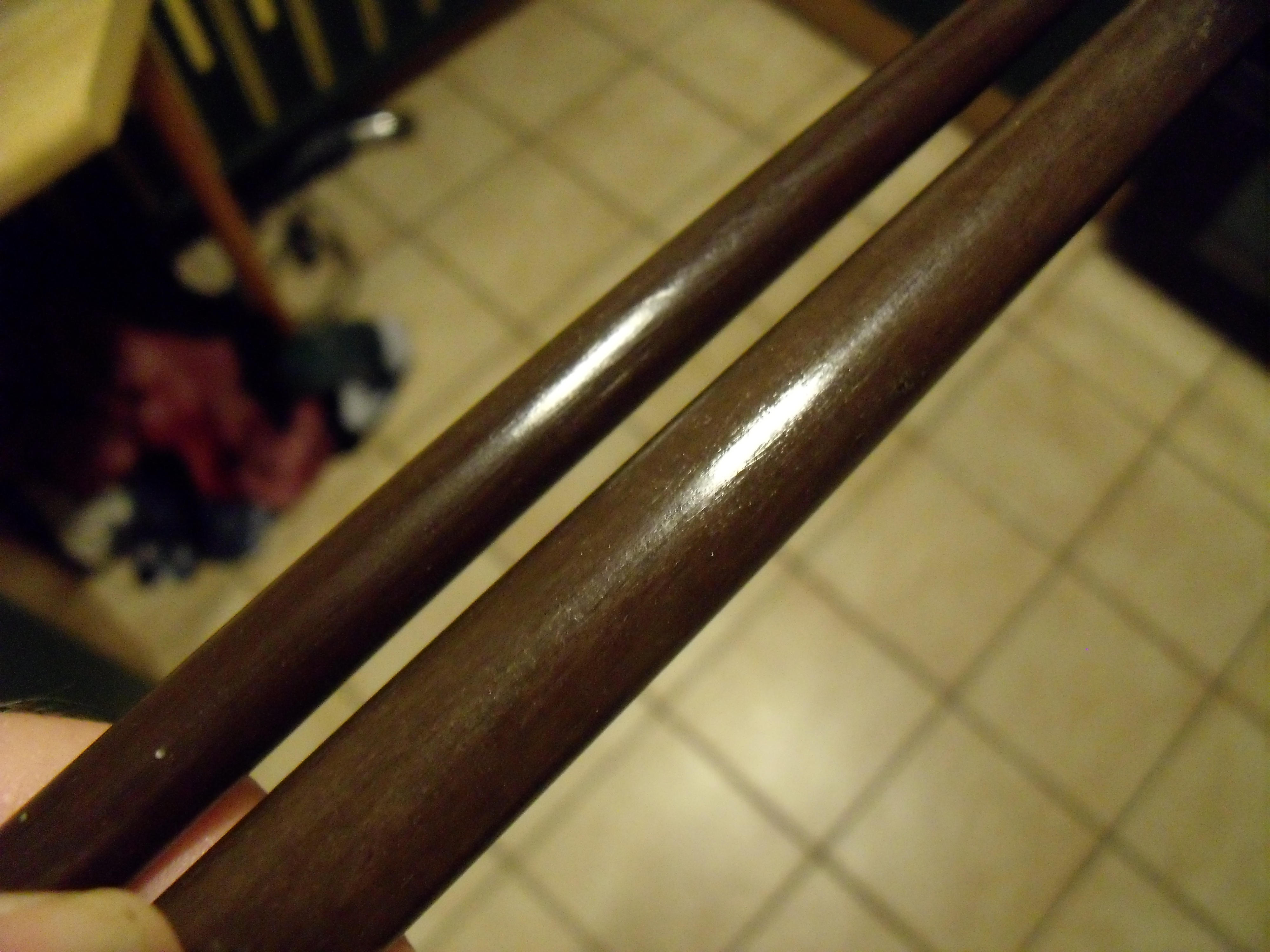

Getting closer. this one's 7/16" x 36" long.

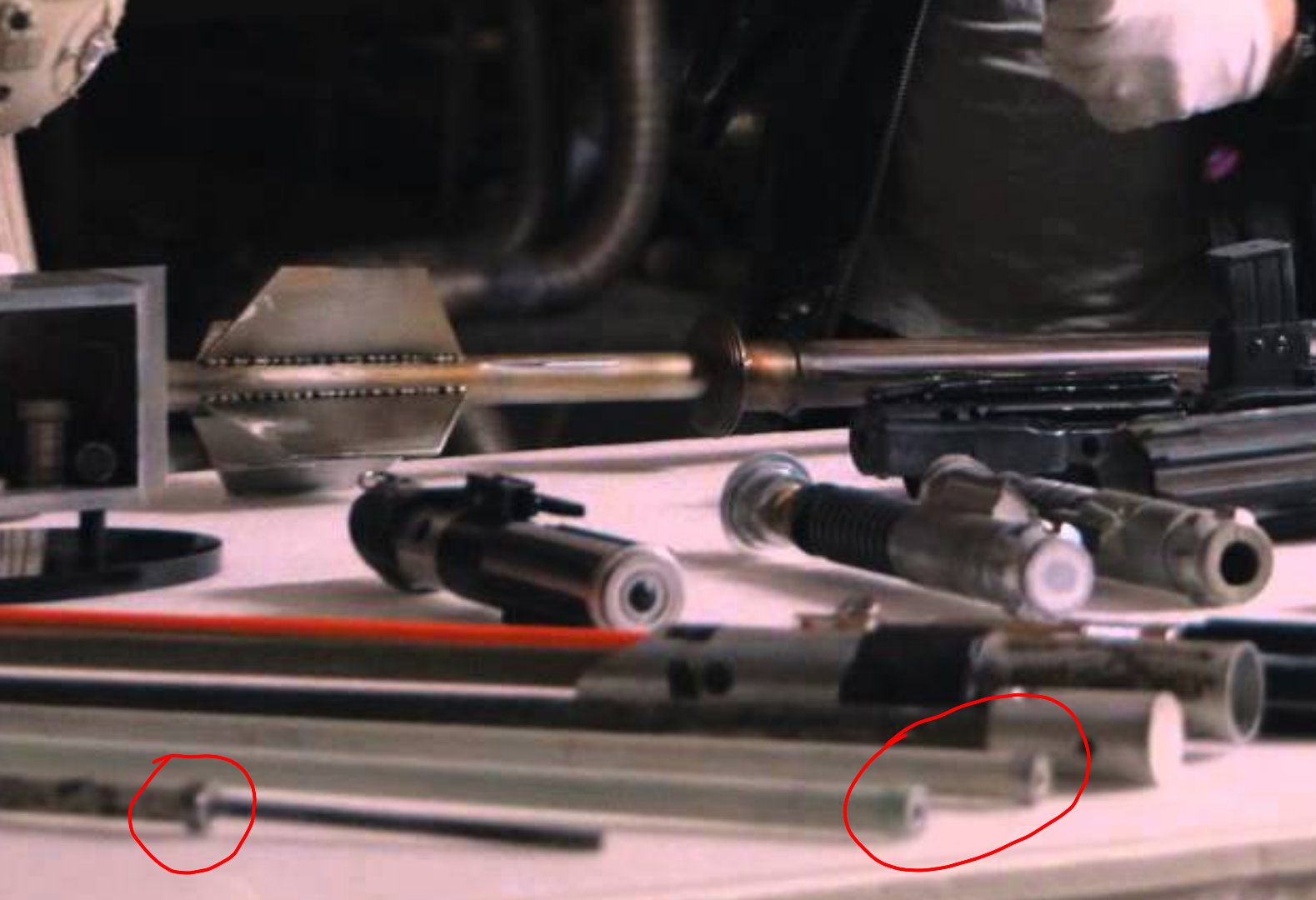

In that photo we are looking at collar systems, some of them coated like the rest of the blade.
I personally think the dark one on the left was part of an ANH-ESB beater saber and the coated ones are Jedi era
How sure are you those are blades from ESB combat sabers?
The left one does have a resemblance to the one that takes flying lessons but looks longer below the collar. Compare with my GIF post# 175, pg 9.
