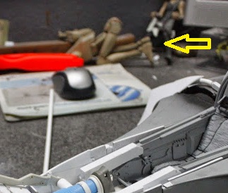

Front wing, after lots of attempts this is what i ended up with, shape wise
Marked it out on 1.5mm styrene sheet
Cut it out,
Cleaned it up,
Split it up into its core elements,
Using 1.5mm tubing as my transition piece, stuck it back together with some angles
Filled with squadron green,
Sanded and with some edge profile work done
Quick squirt of primer
Decided it looked better flipped around so i then added the front elements
First with 'H' cross section piece
Then with tube
Then a piece of 'U' and a piece of half round on the tip
Then it was filled, squadron again
Sanded
Here you can see the cross section of all the different pieces
And then some more precice shaping on all edges
Came up with an idea for the attachment to the nose using tube that i will shape all fancy with sheet and filler later
Tube bent and glued
Filled,
Sanded,
Added some 'T' section on the ends, next thinking about more wing elements and the end plate
And thats where i'm at,
