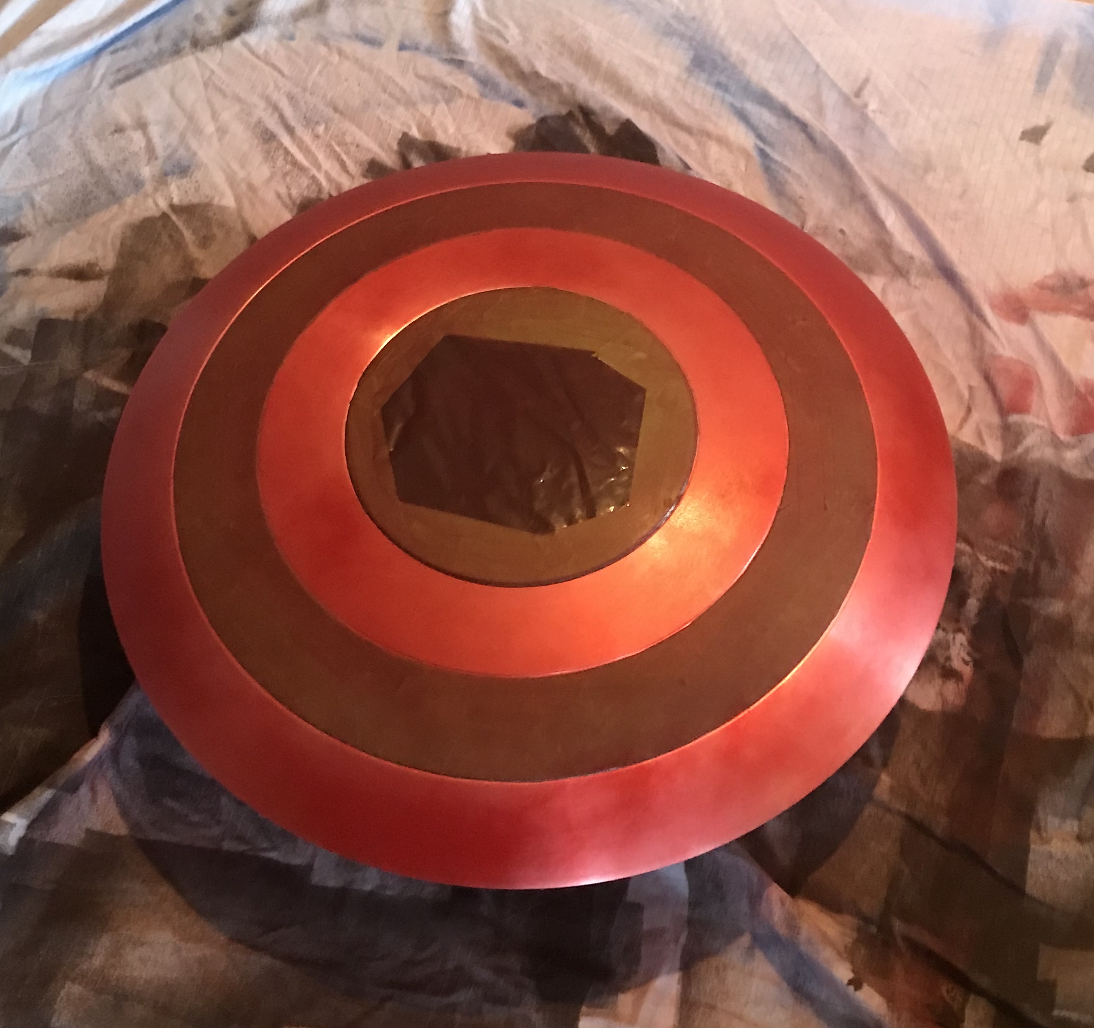

Dudes!!!

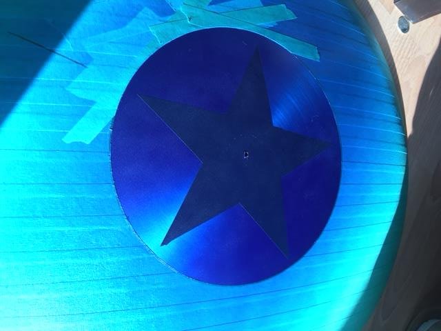

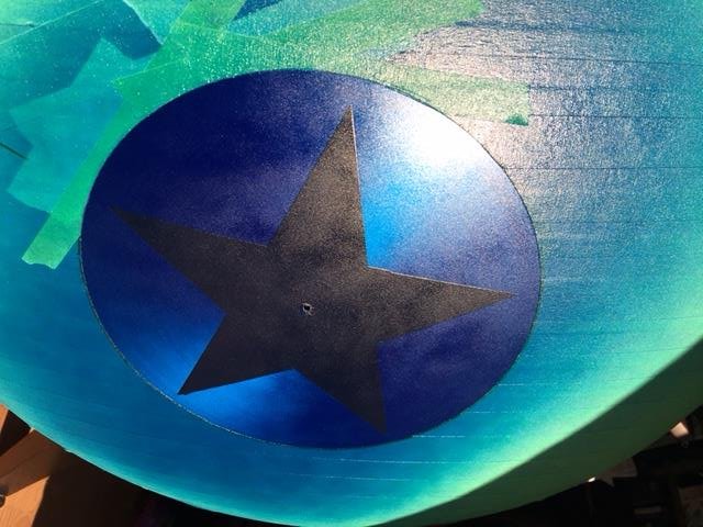

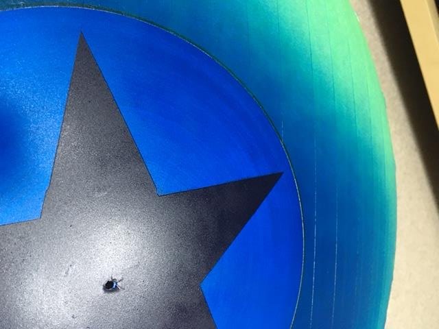

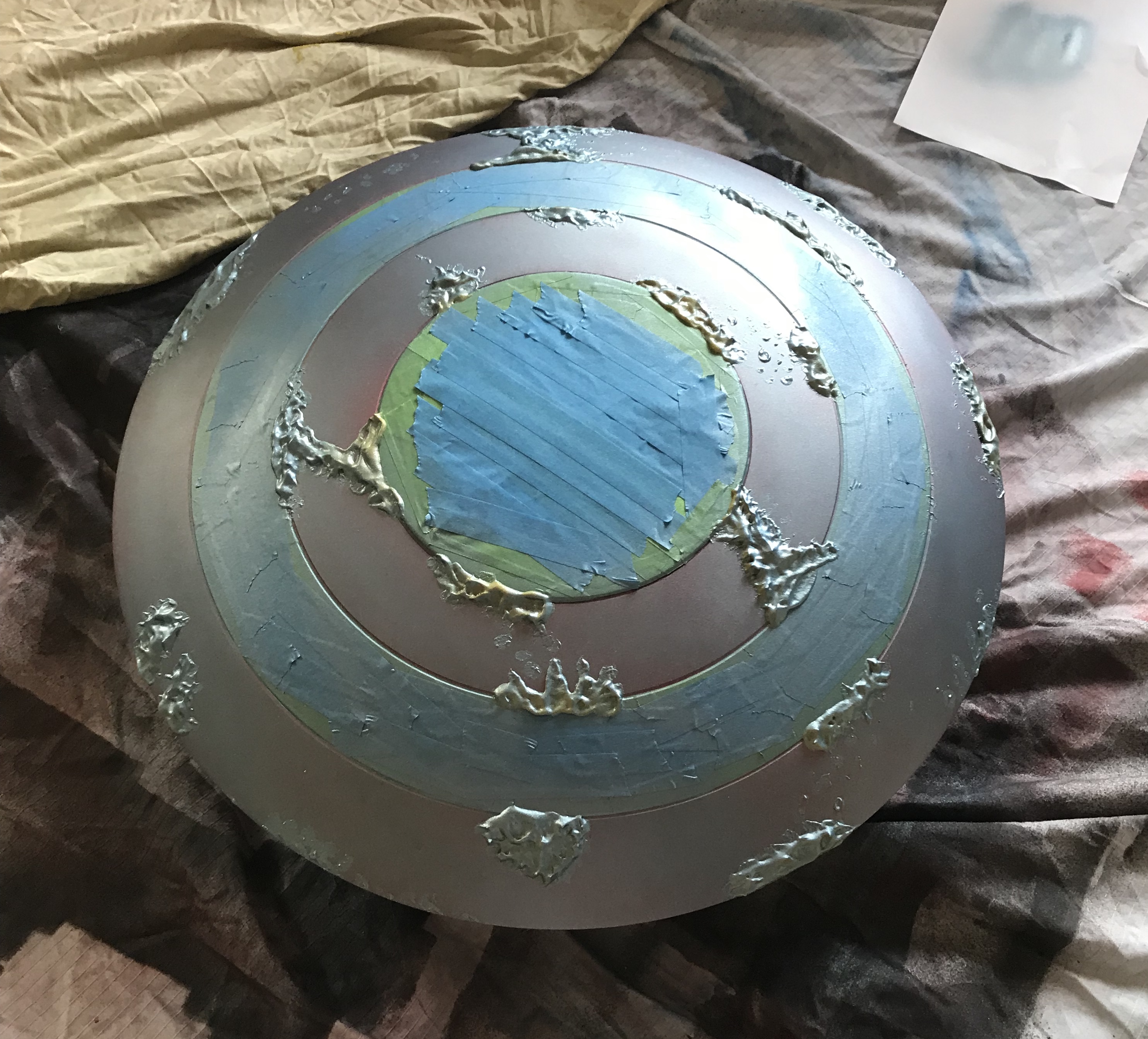

Did I eff up? Laid a few coats down Monday, & noticed the tape was a little rough on one edge. I fixed that up, then sprayed a few more coats today. Now it's pretty dark & patchy, & tough to see the spun effect unless it's right in sunlight ( last 2 pics). I do have to fix up some splatter marks anyways, but I just wanna make sure that this would look ok after the clearcoat & wetsanding is done.
Any feedback would be much appreciated!
Thanks!

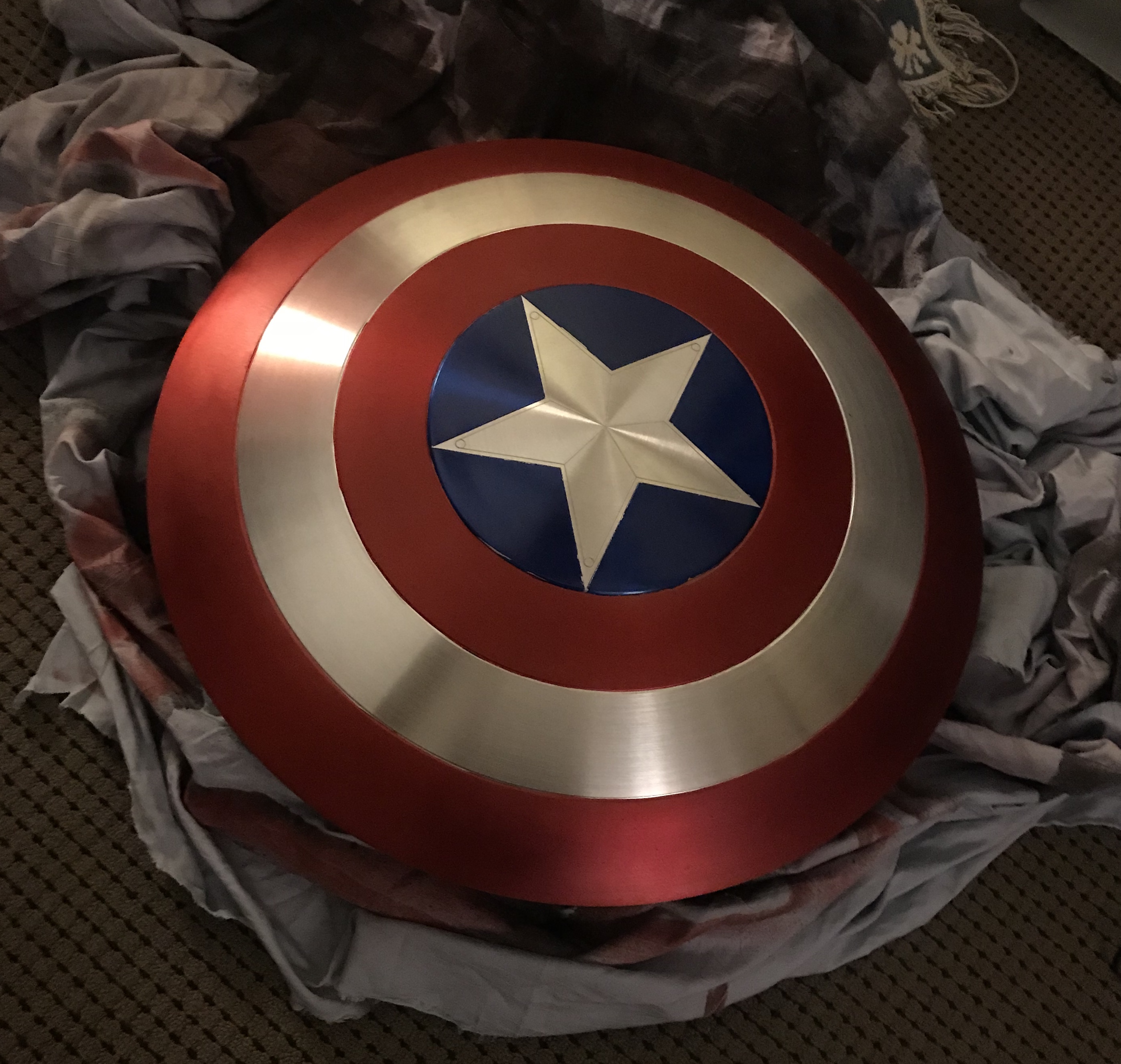

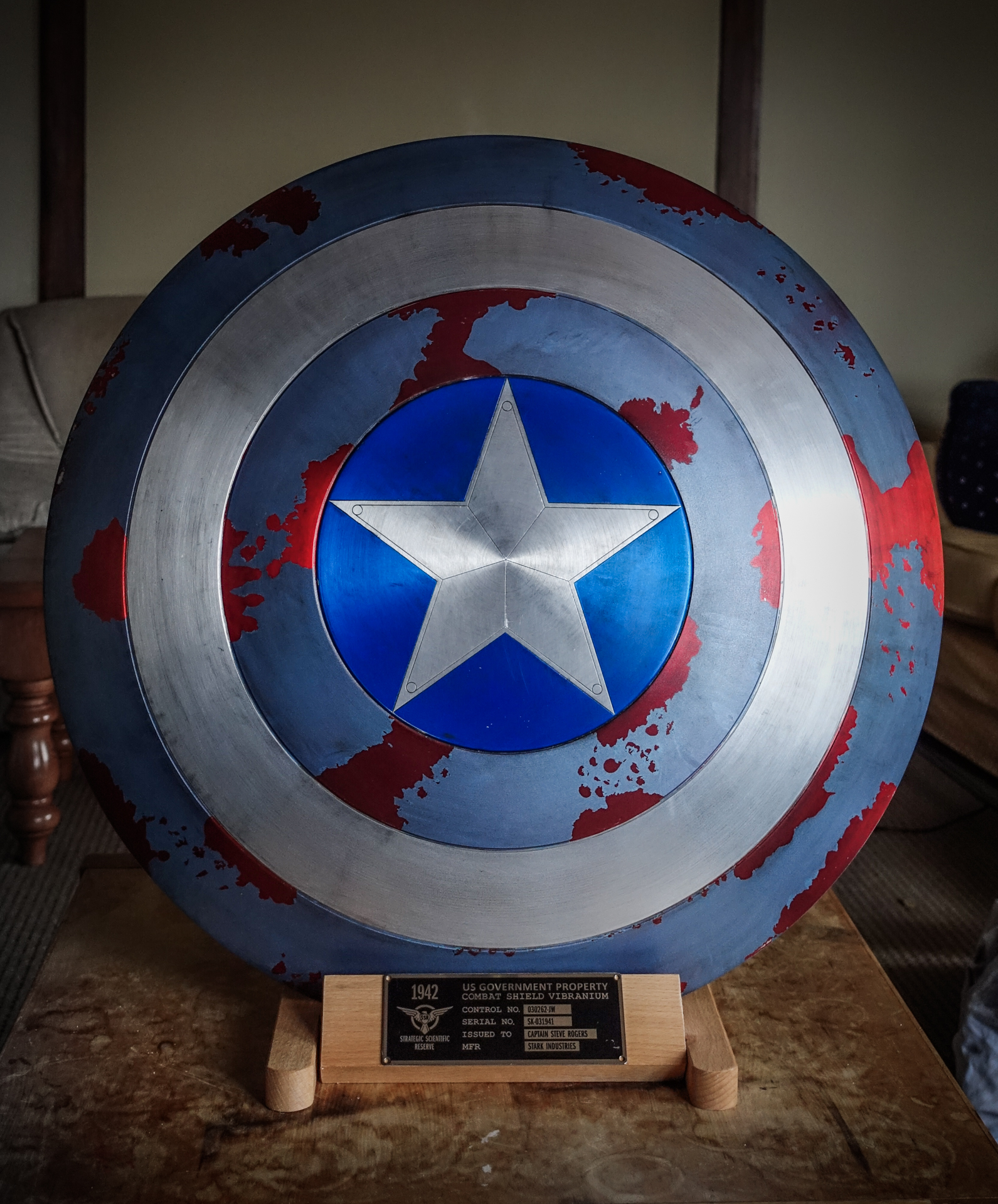

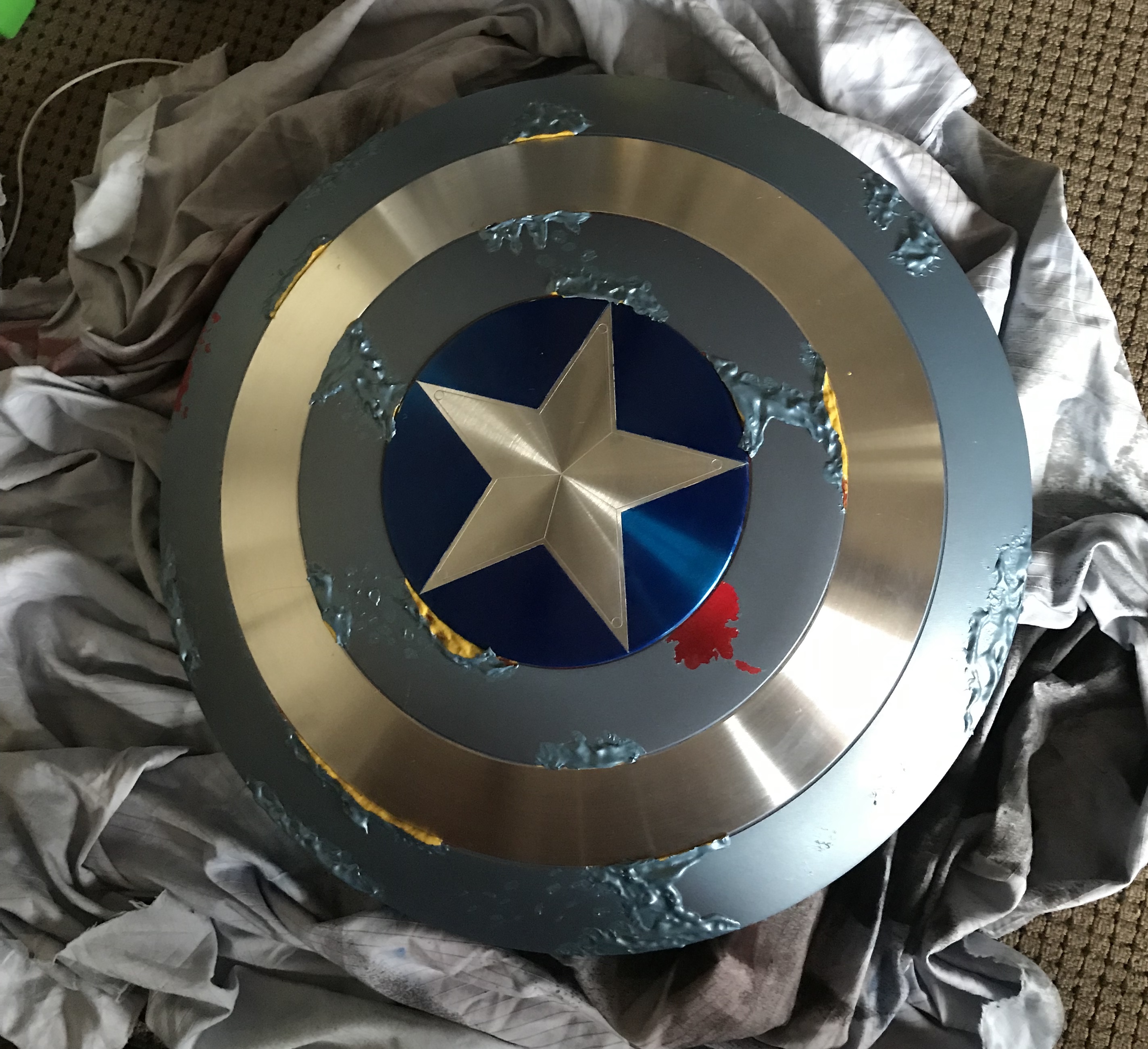

Hi all, i'm new to the prop making and the forum, and I figured upon completing my first project that i would chime in here with my results/experience.

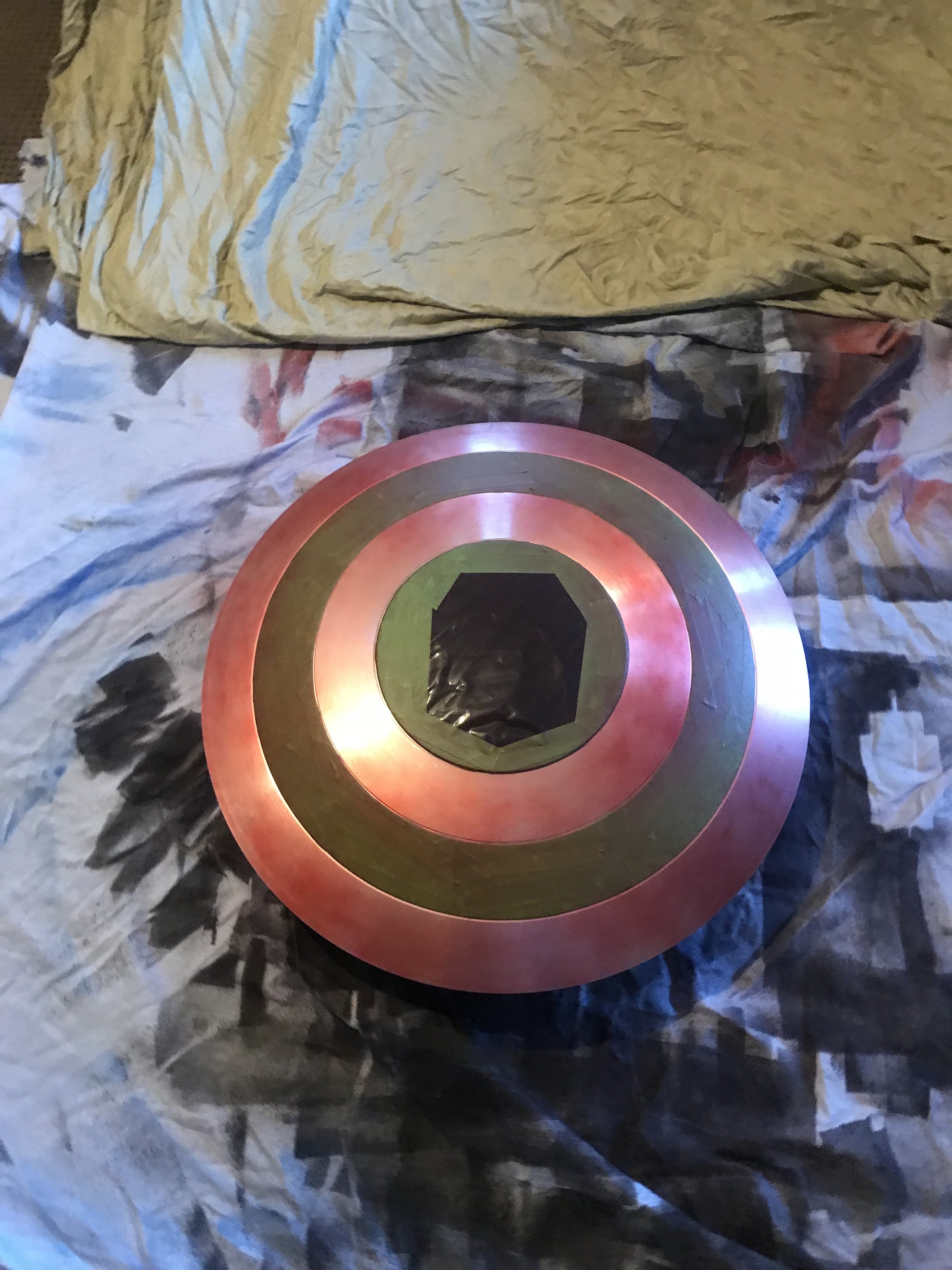

I had always wanted to paint my own Cap shield and after diligently following this thread and working out a sound methodology i decided to pick up an ebay shield and make my own battle damaged stealth shield from The Winter Soldier. I figured this would make a good first project for me, although i'm loving some of the creations on here!
My final result:

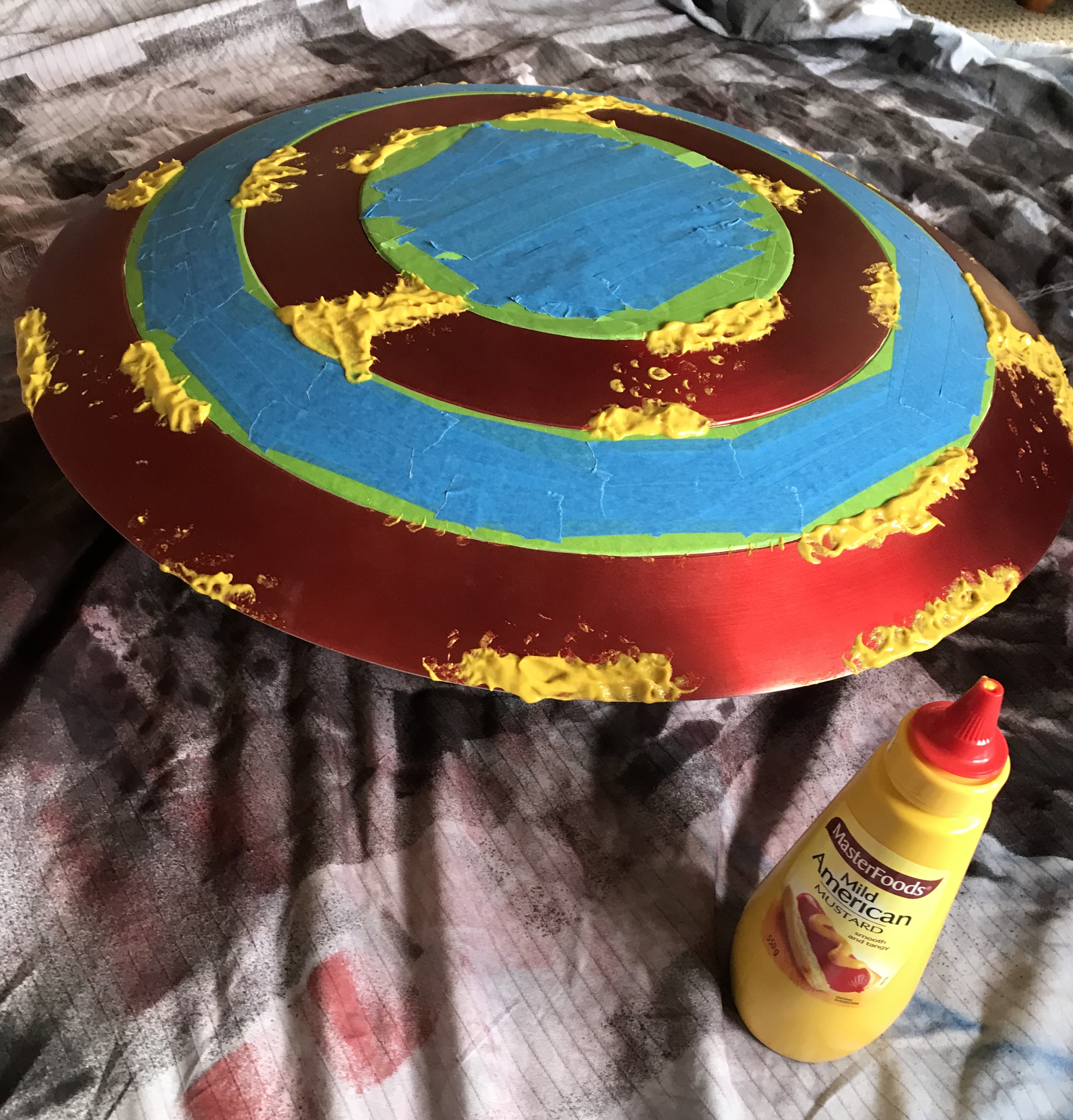

and here are a few photos i took along the way. Thanks to Jax for the mustard idea! and now i can finally understand everyones issues with Metalcast paint! it's a stubborn one isn't it! warming the cans and starting your spray away from the shield seemed to be the best method, i only had a few 'stringys' land on the shield. As it was a battle damaged one it wasn't a big deal though.
Thanks all for the information in this thread! looking forward to the next piece

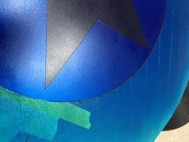

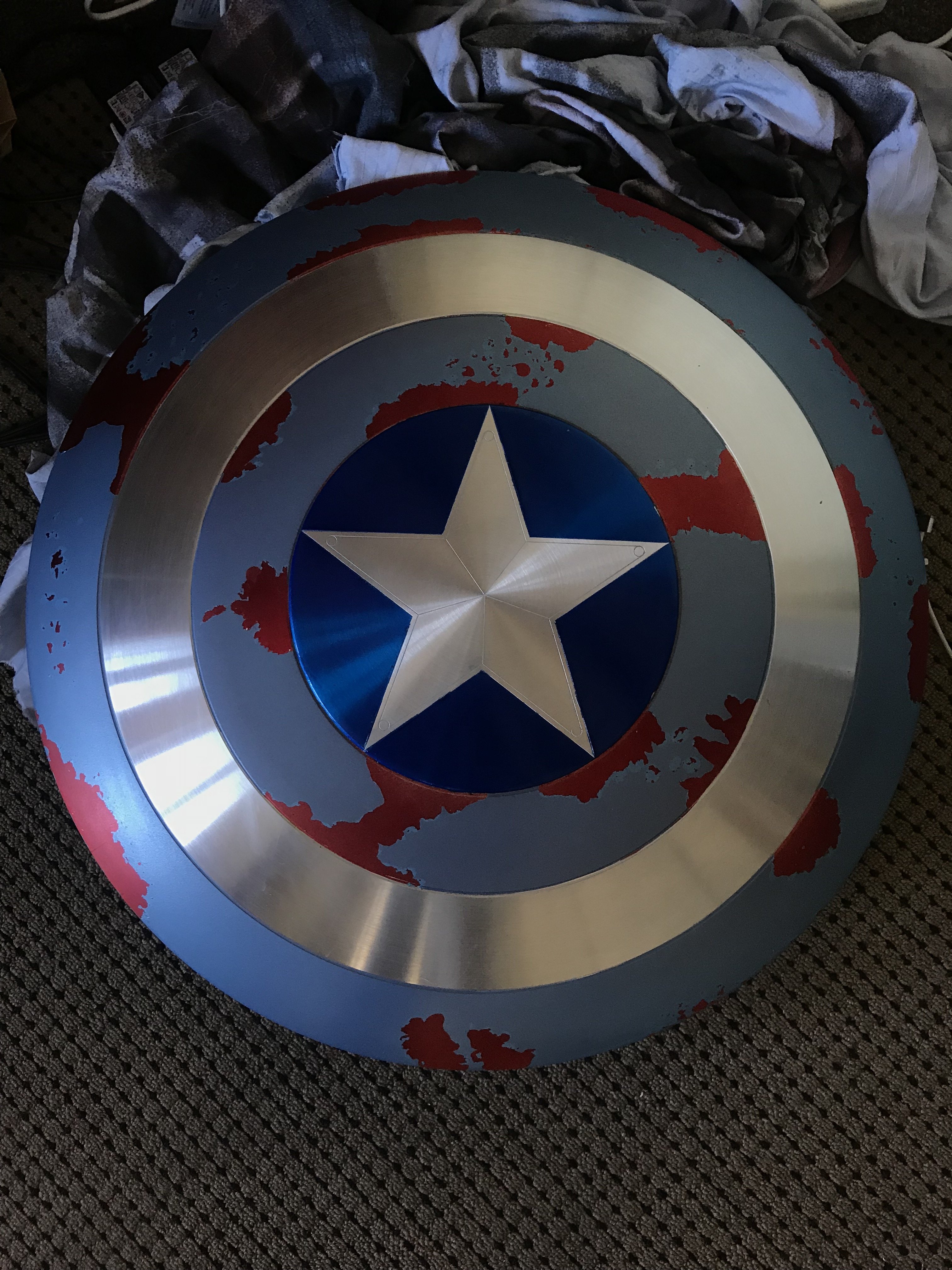

I have always had pretty good success using Dupli-Color Metal Cast Anodized colors for my metal (and plastic) shields. Pictured, is a metal shield I did.
Looks perfect man! Did you clear coat over the metalcast?
