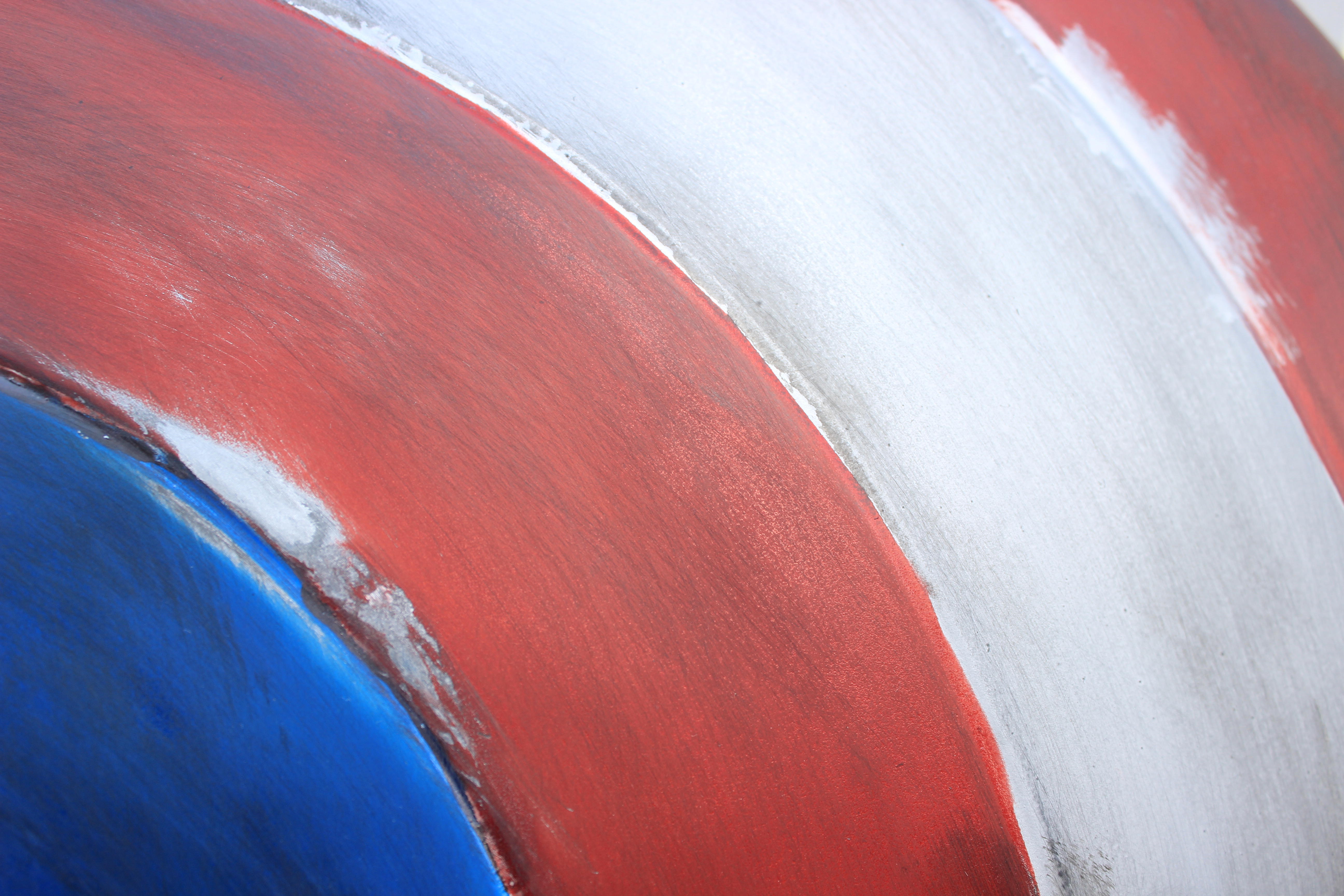

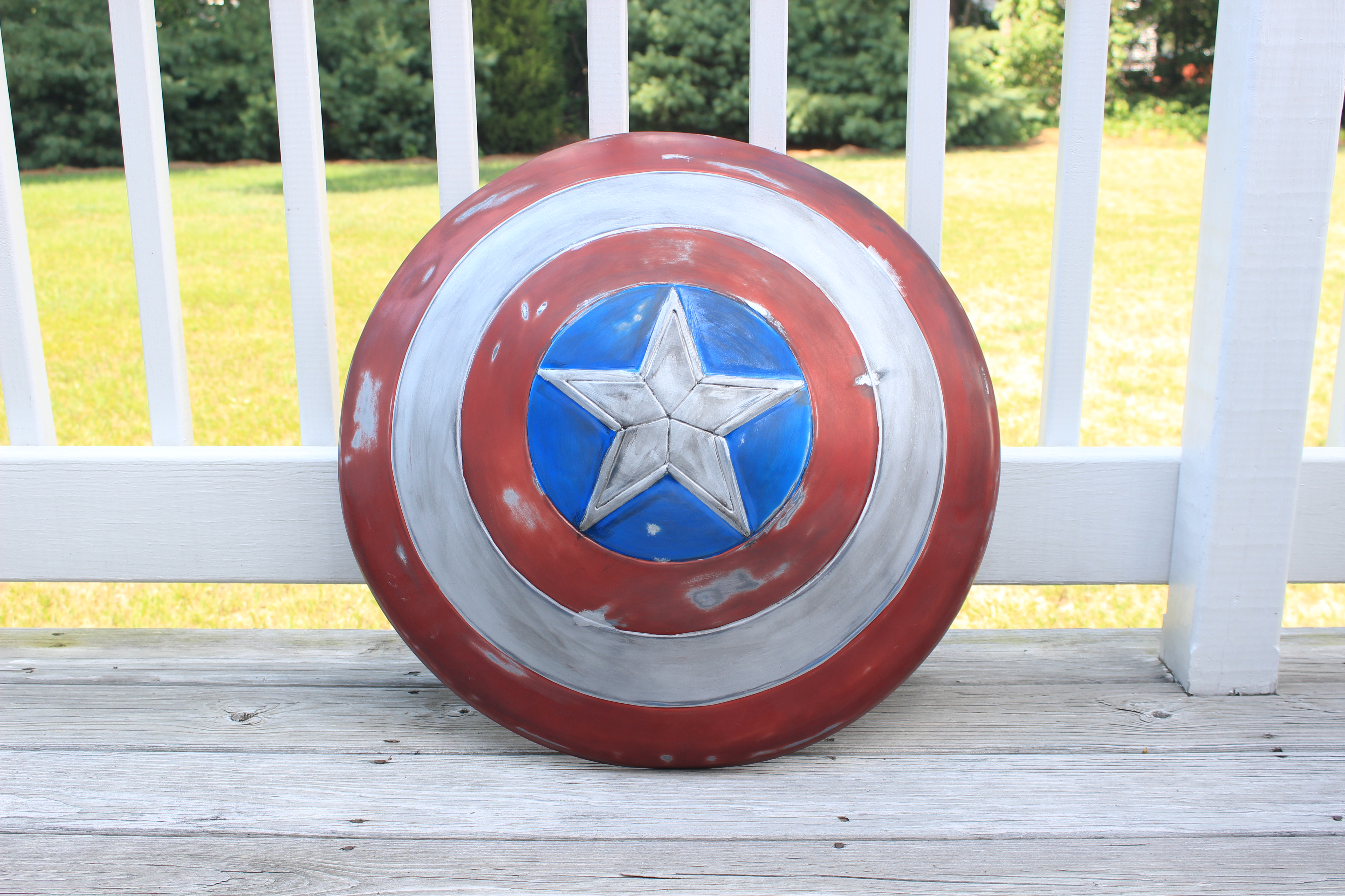

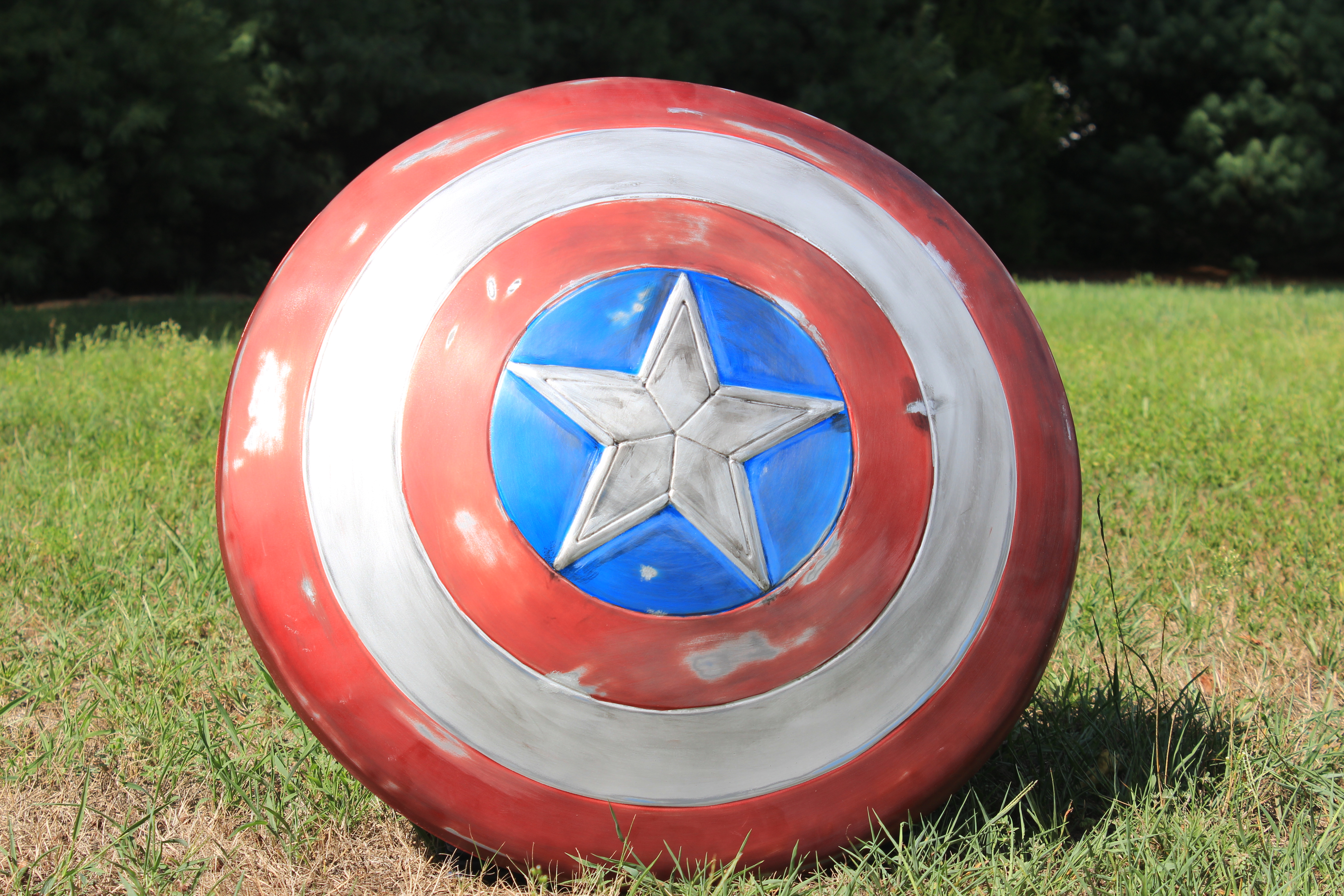

This is a Rubies shield I repainted. I want to get the Hasbro one but I would be afraid to mess it up weathering it so I got this one for that purpose.
Total repaint. I sprayed metallic aluminum as the base and used the Duplicolor Metalcast Red and Blue over that. I wet sanded it down and did all the damage and weathering.
I'm wondering if I should clear coat it.

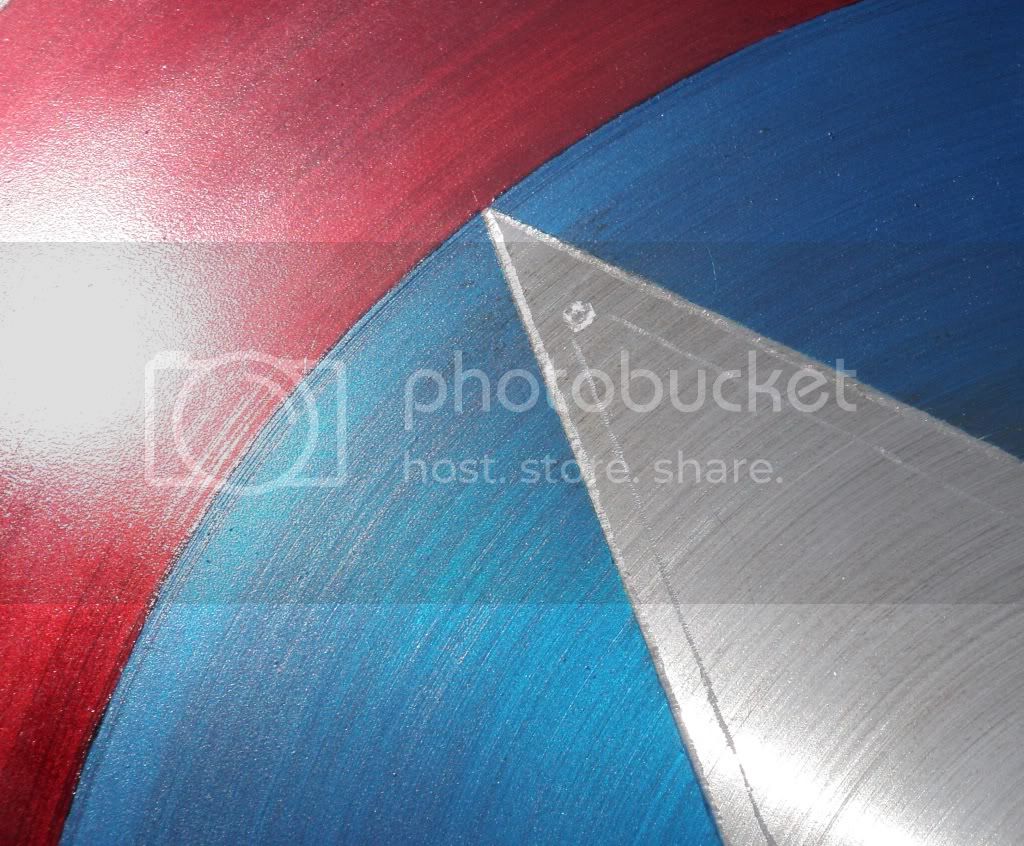

I've just started on my steel saucer shield and couldn't find anything in this thread about engraving rings on to the shield. If there was someone who did it, I must have missed it. I just would like to have some sort of light indentation for the rings.
If you want to try, I would draw it on with a pencil, then score it lightly with a boxcutter or exacto, then use a bigger, wider thing to carve it deeper and wider. That, or use a Dremel, but the thing with the dremel is you'd have to be extremely precise, slow and patient to get the star in just right. (Which is why I personally just ended up goin' with a raised star)
I didn't engrave the rings but did the star. For the rings just used a file and a string but the detail was lost with the paint and shows as a black grove.

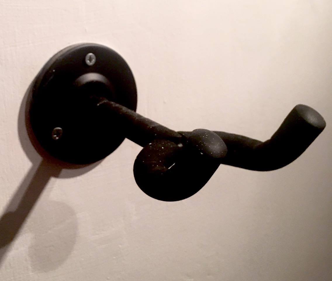

I used a wall mounted guitar stand! Shield currently isn't on there because I want to get something to stop it scraping against the wall, a little bit of foam or something should do the trick; it'll protect the shield!
