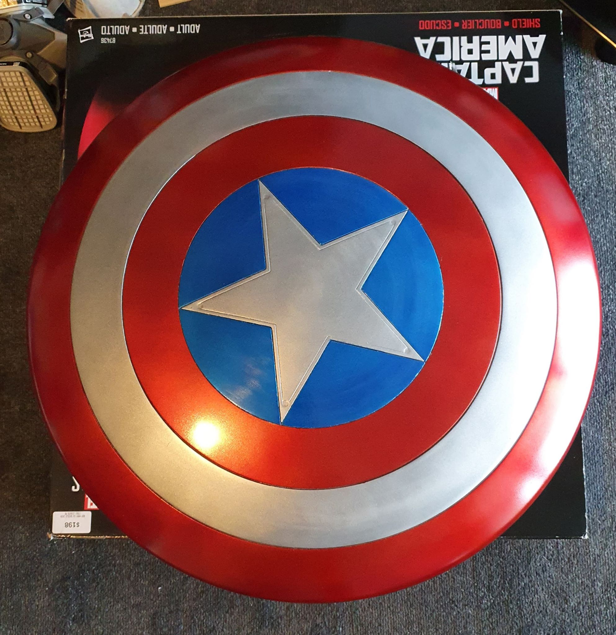

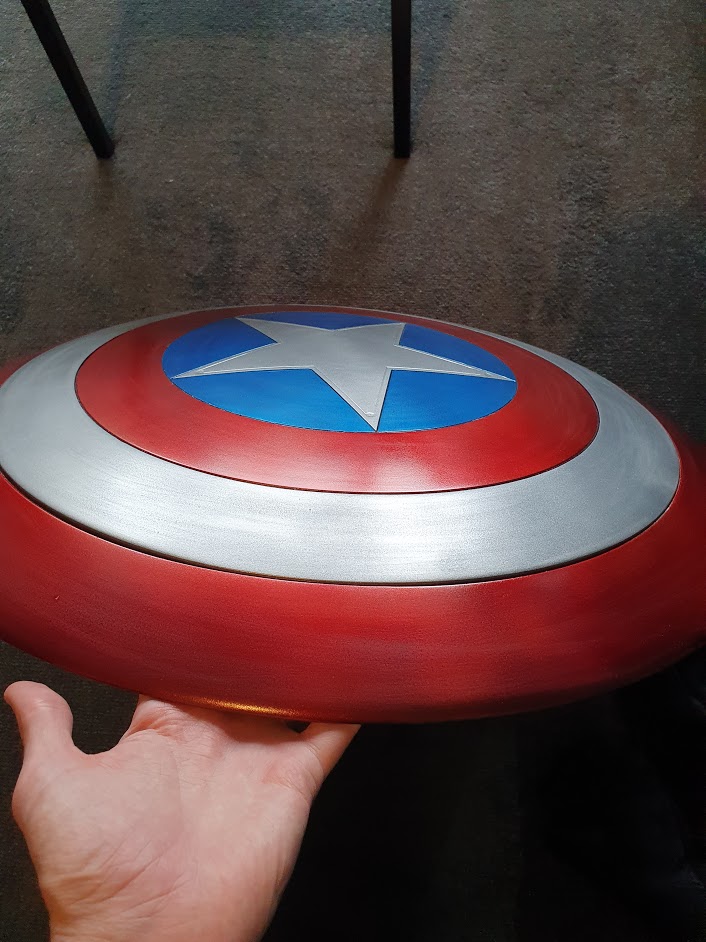

Repainted a plastic 1/4 scale shield today.
Before and After pics

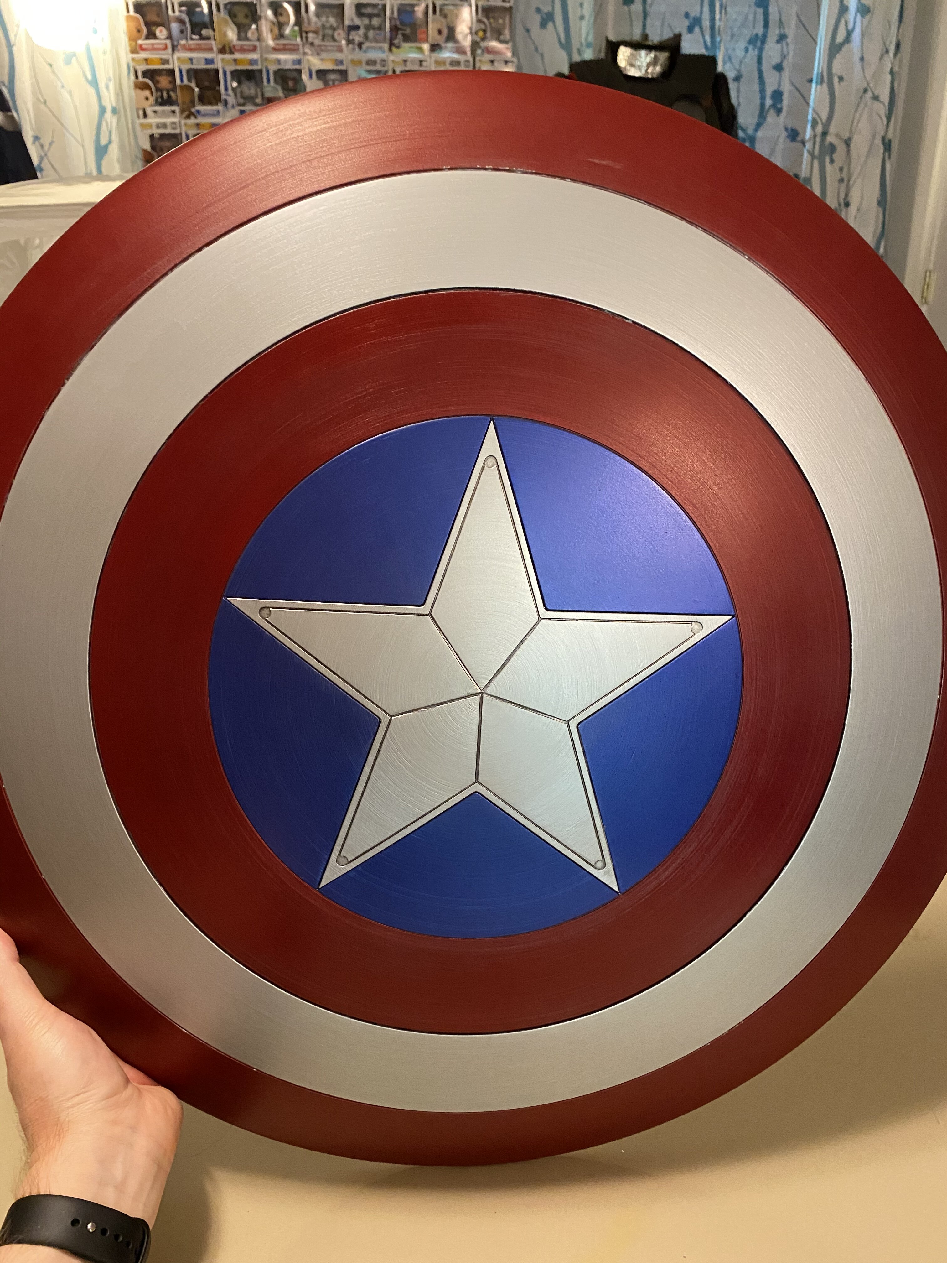

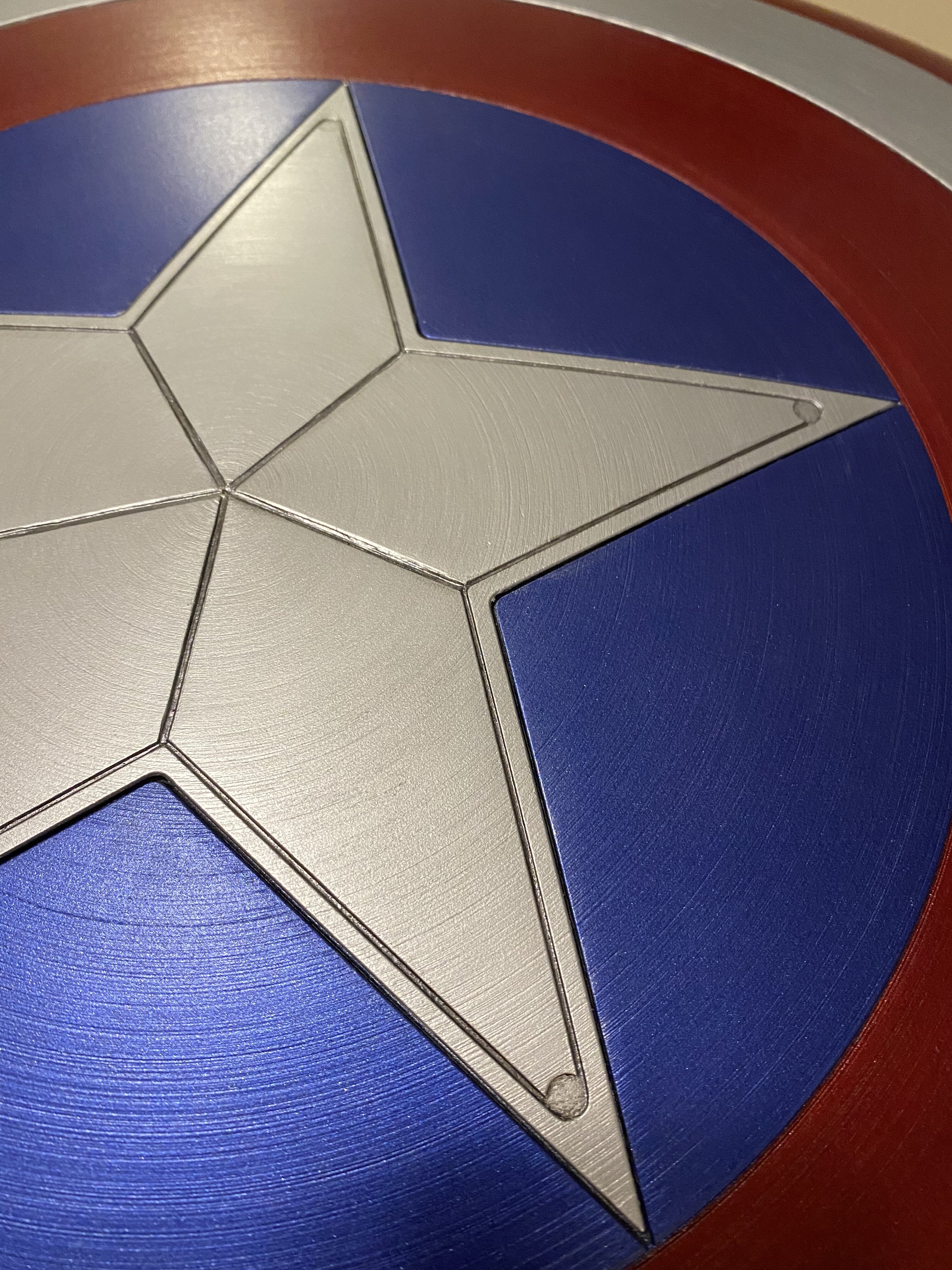

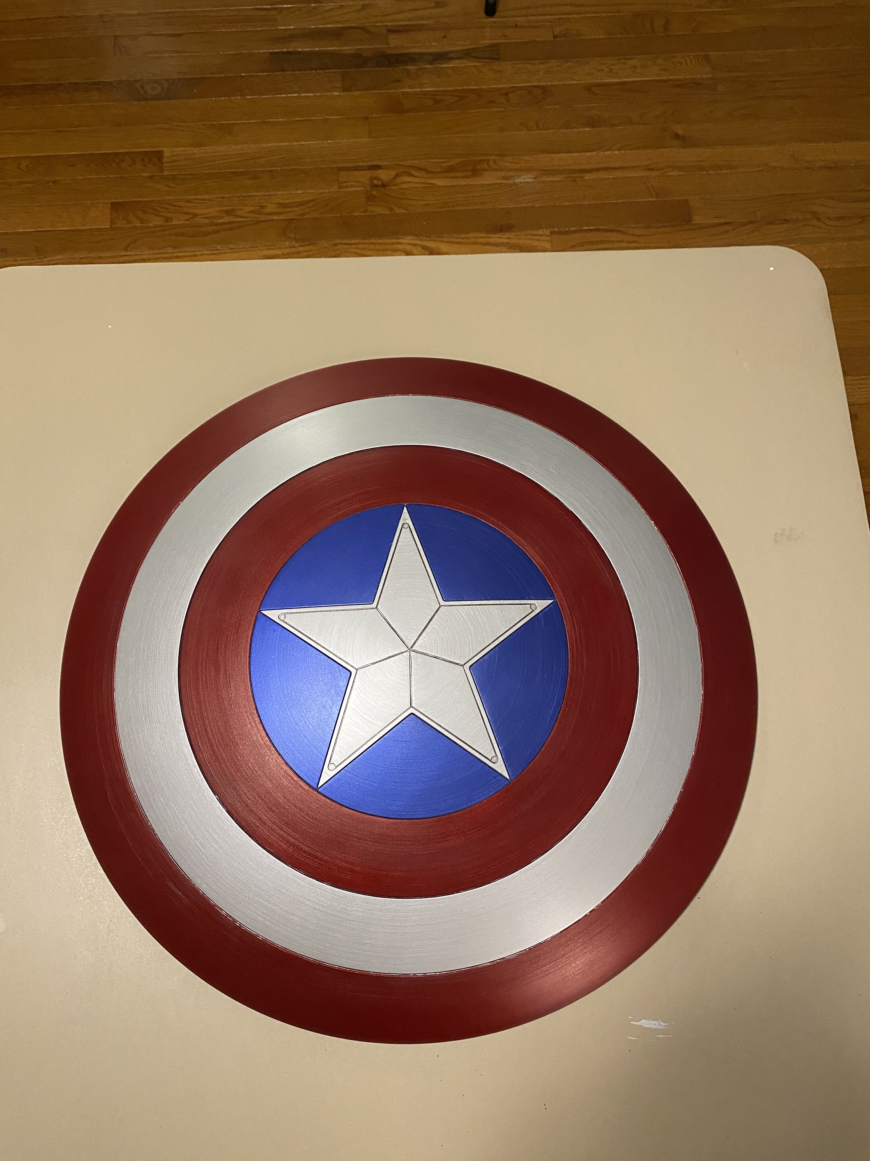

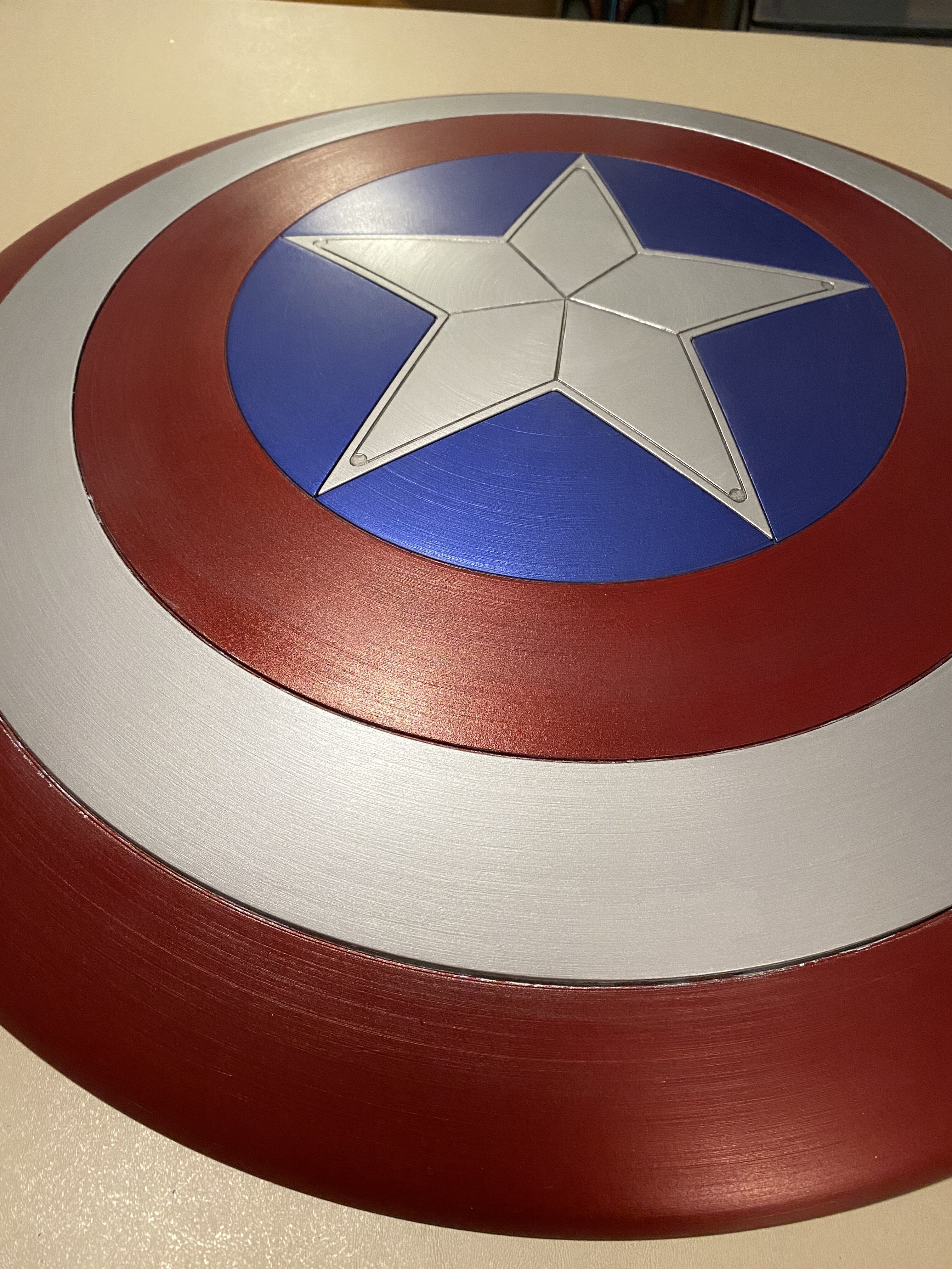

Hey there! This is a pretty good tutorial on getting the sanding done while making it look more like brushed metal (Vibrainium).
I used this for mine and have sanded it down a few times. I used a few different grits of sandpaper (only dry, didn’t try wet), going from lower grit (coarse) to higher grit (fine). The trick is to not put a lot of pressure and go back and forth using the rig set up from the video. I am sure you can get all the way down to bare plastic if you needed to, but I only took the clear coat off of mine and then a little bit of the bare plastic was exposed from sanding. After painting, it was fine. No issues with paint adhering.
Here are a few photos
13EA44E9-AE79-4879-ABB6-119FFB9A16DF.jpeg 7D2F1AA6-1CCA-438A-AE07-837D75491299.jpeg AB4CD4F4-7CF1-4ABA-9AB7-41806F1B3663.jpeg 6C0D6271-1B74-4428-AD2C-55B0CDED51D8.jpeg
Rogu3Wo1f
View attachment 1311850 View attachment 1311851 View attachment 1311852 View attachment 1311853 View attachment 1311850 View attachment 1311851 View attachment 1311852 View attachment 1311853
Wow, this looks unbelievably good.
I think I managed to get the brushed effect, just waiting on the weather to cooperate so I can paint it. Winter in Australia so it's a bit of a pain. And I have no where in doors to paint.
I'll be sure to post some photos of mine once I've gotten the other colors on.

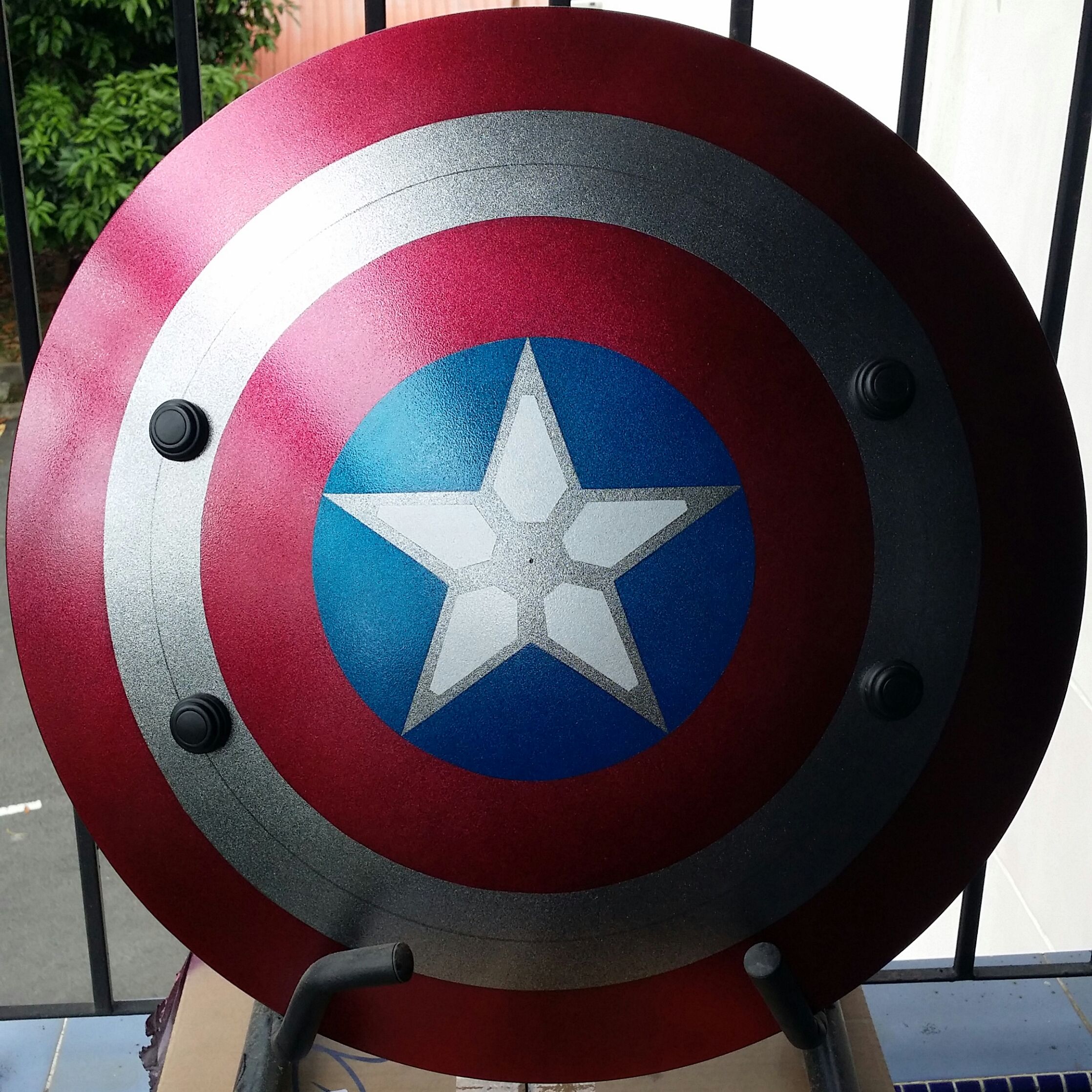

I have finished the shield.
Third attempt at painting this properly. I'm really happy with it. Considering it's plastic I am really happy with the finish I was able to get, though difficult to capture on my camera.
Paints:
Rustoleum flat grey primer
Duplicolor Anodized coating base coat
Duplicolor Anodized coating metallic red
Duplicolor Anodized coating metallic blue

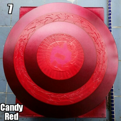

Any tips on getting metalcast to not go on too dark? For my blue it went on too dusty so I suspect I wasn't spraying close enough, and with the red I think I put too many layers on and so it's a little dark. Is there a way to wet sand the red so it's lighter or should I strip and start over?

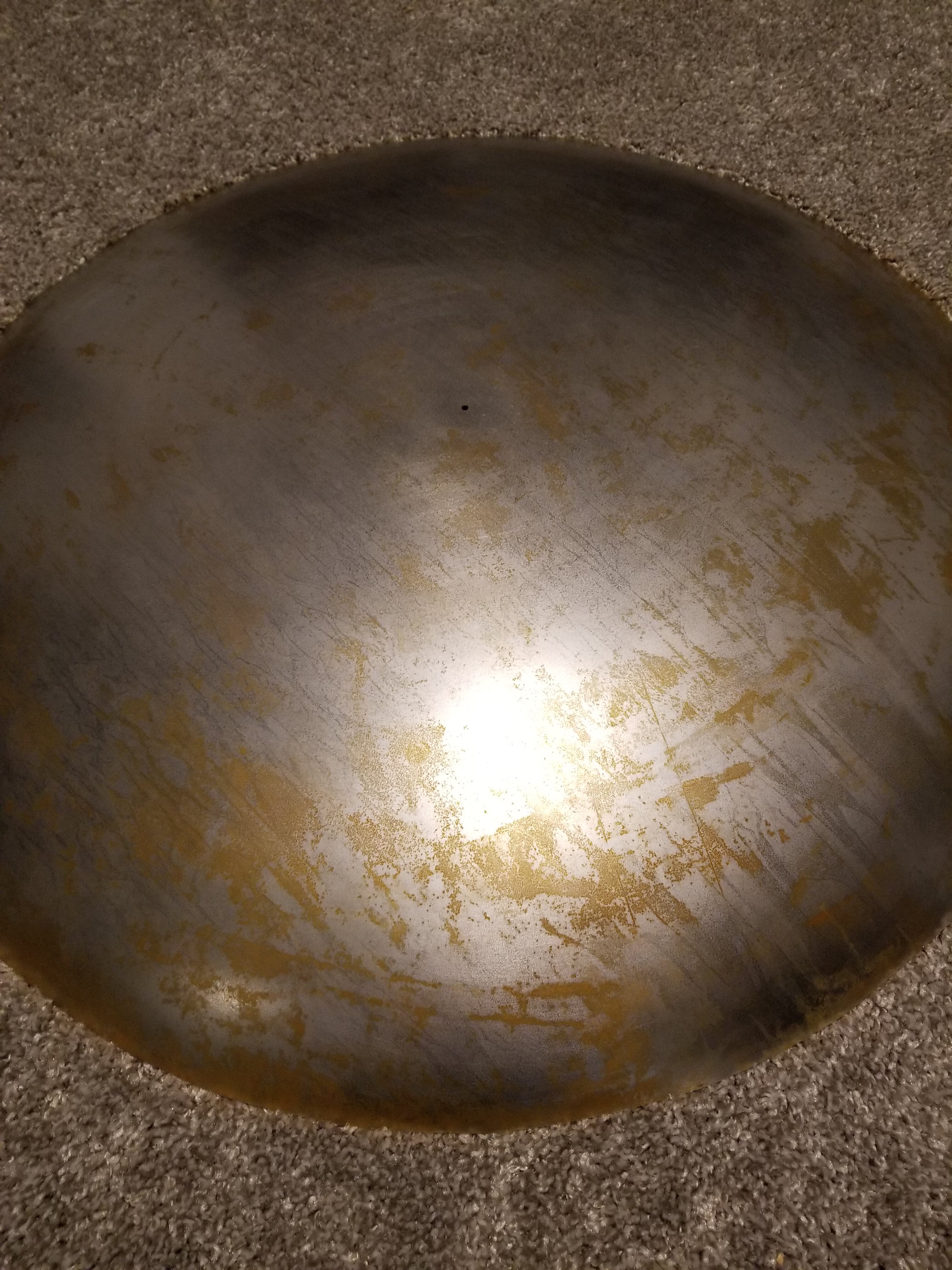

Can anyone please help? I am making a Cap shield using the flexible flyer sled that so many tutorials use. After stripping the paint, I sat on the project for a while and the shield became discolored. I cleaned it using a 1:1 ratio of water and white vinegar which did wonders at first but now the vinegar itself seems to discolor the shield. I only scrub with the vinegar for a couple minutes and it cleans it pretty well, then I rinse it thoroughly under a hose and then dry it. But everytime after a few minutes it will begin to discolor again, sometimes worse then before. Any suggestions?
Don't know if you've solved this problem or not. But this depends on what this is.. is it made of aluminum? If so it's not rust, aluminum doesn't rust, if so it's probably a reaction to a coating that was on it that wasnt removed all the way.. in that case get some fine steel wool and go back over then sand starting around 600 grit up to 2000. If it's some kind of steel iron mix get something like gold metal kleen kettle cleaner or a rust stain remover, then clean up and prime with a rust shield primer. You could also use bondo over it but never been wild about that, not flexible enough.. have fun!
