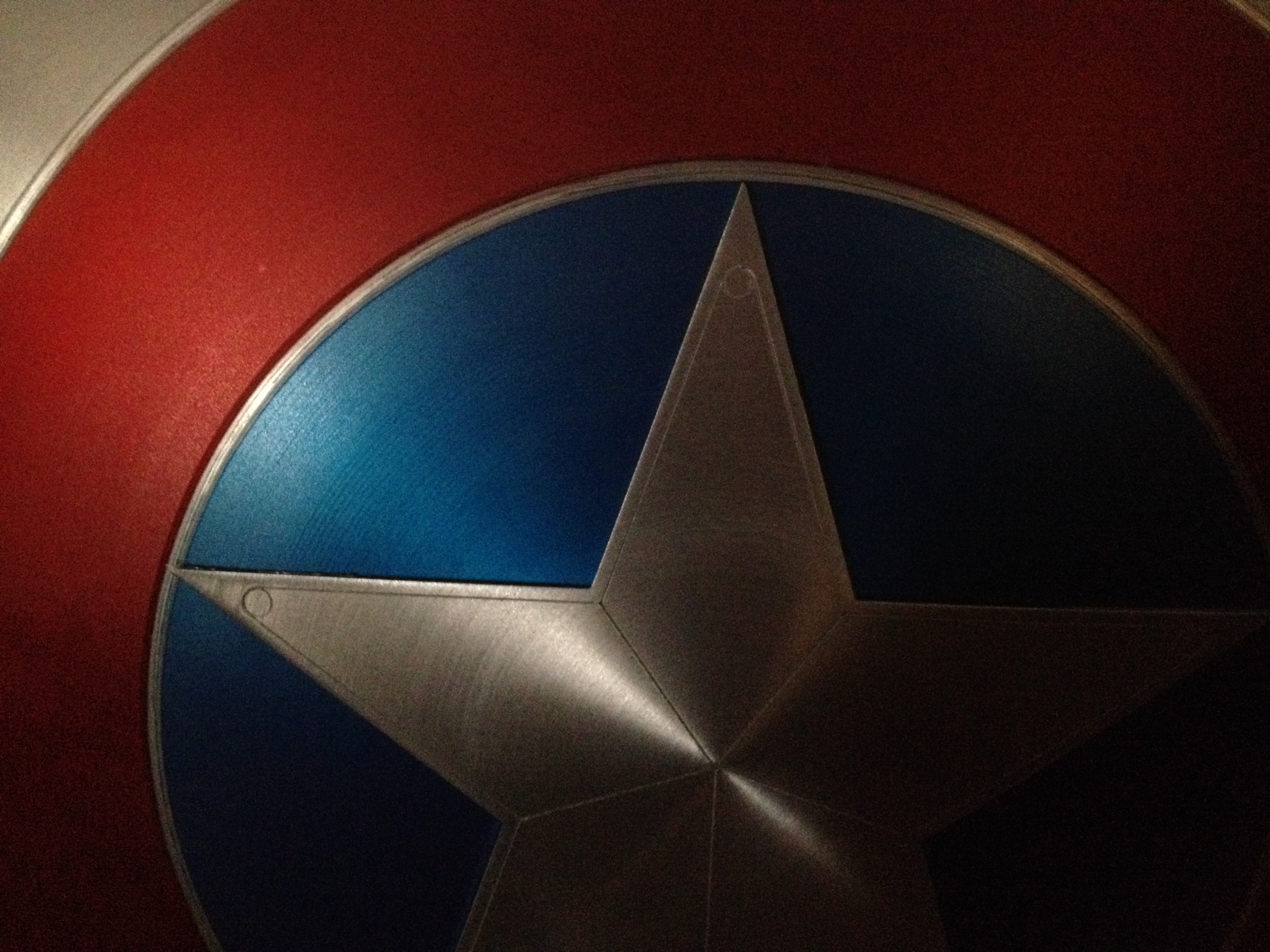

WP_20160511_09_32_59_Pro.jpgI did mine in anodized colors.
I apologize in advance if this has already been asked, but I didn't see it so I figured I'd ask. I saw someone said to clear coat the aluminum shields when finished. But I had two quick questions. 1. Front and back? 2. How many coats? I'll be using a Kylon satin clear. Thanks in advance for any and all feedback!

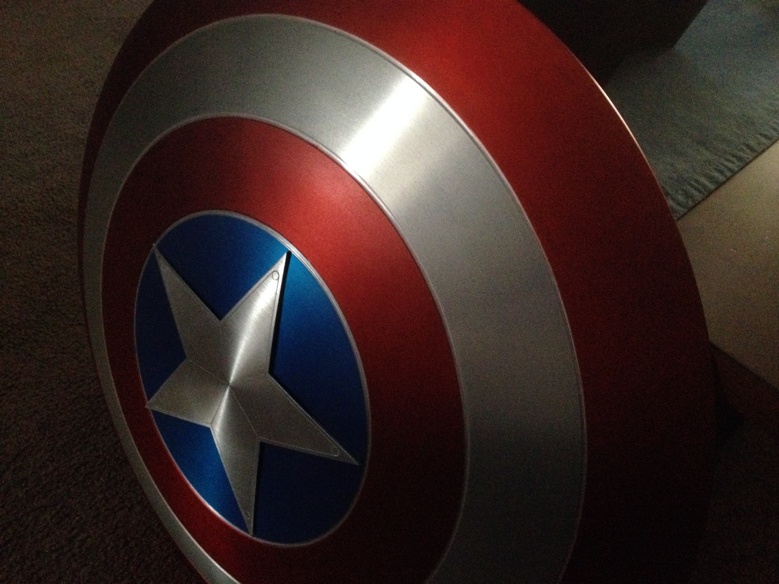

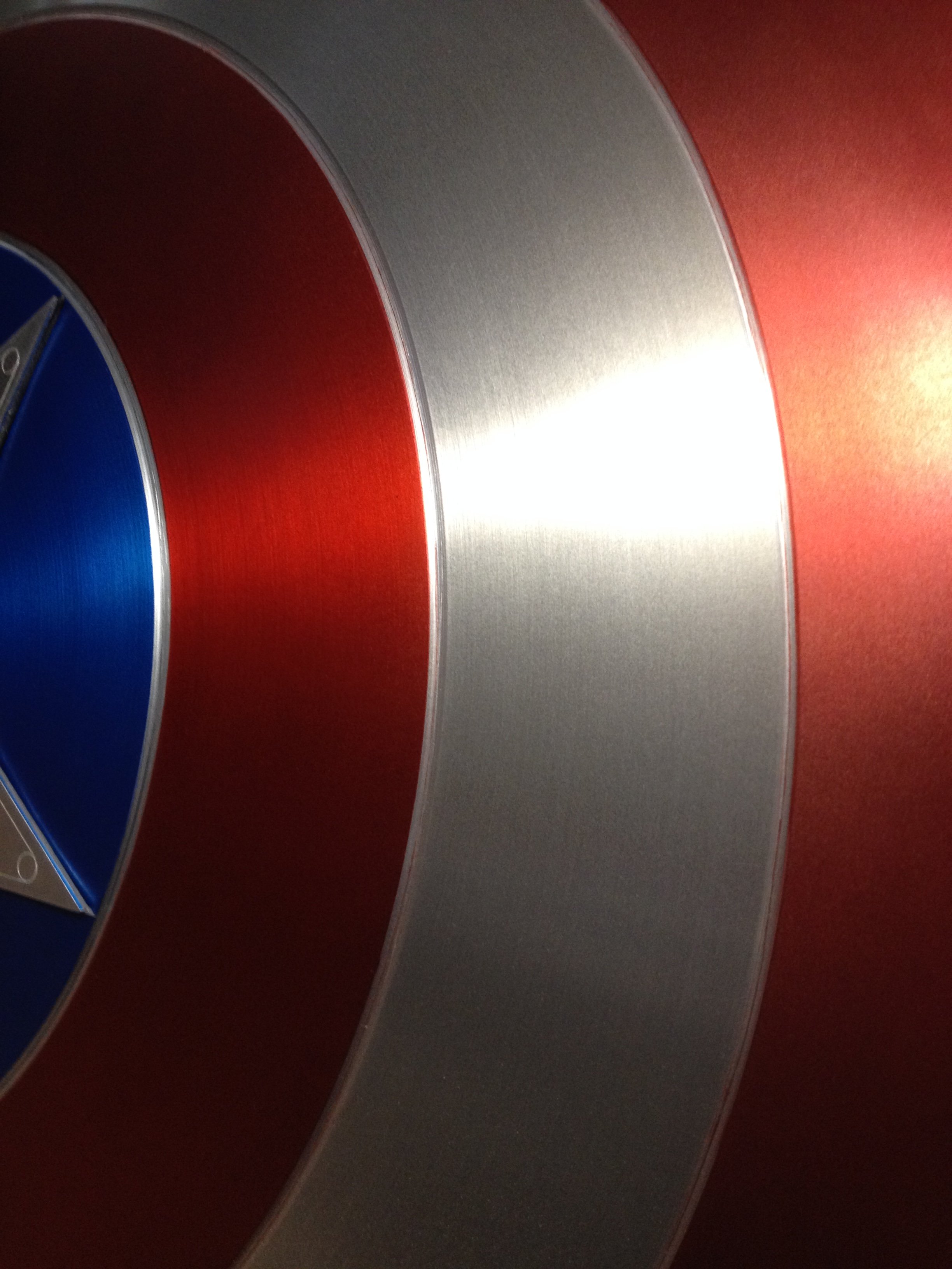

First of all the common 'I'm sure this has been asked before'. Now I clear coated my shield and it really dulled the spun look for a general silver grey. I'm so scared to sand in case I dull it more or take off paint. Any suggestions or step by step instructions would be greatly appreciated. (See above photo)

the clear filled in your spun look. a very light high grit sandpaper will restore the scratches. be very slight as not to sand through your paint and sand with the direction of the circle.

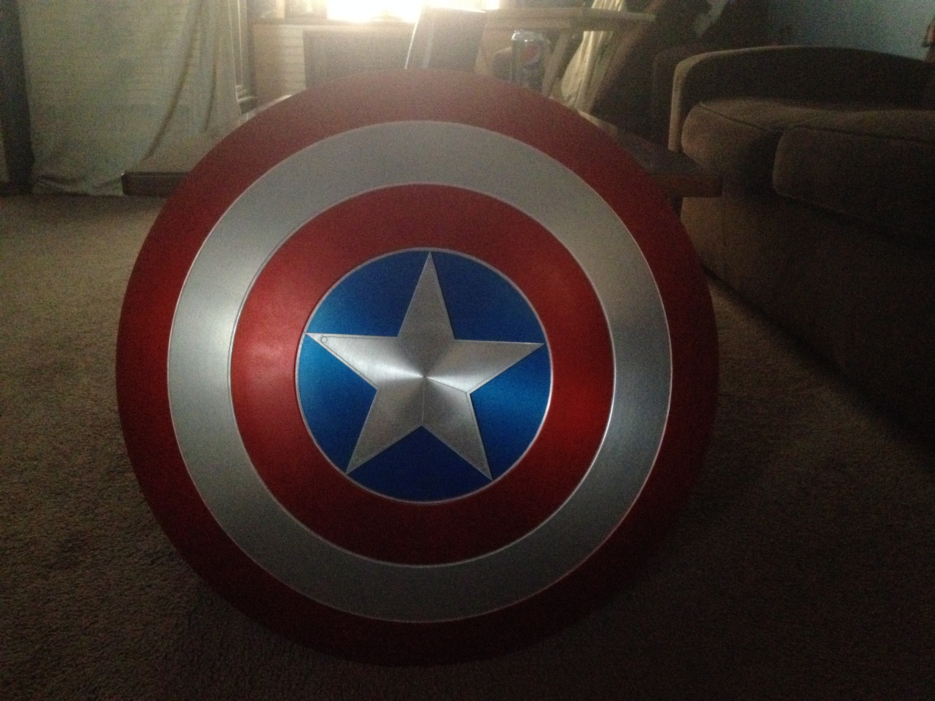

Starting painting my shield this weekend. Heres the centre being masked ready for a lovely candy blue ive found. Ready to spray in a bottle.
All painted with the candy blue. Not sure it shows up in the pic but you can still see the machining marks on the surface through it which is exactly what I was after.
Gonna leave that for a few hours to really go off before unmasking. Then its time for the shield with same type of candy paint in cherry. Then I'll assemble the shield and cover in gloss 2k laquer.
Wish me luck.

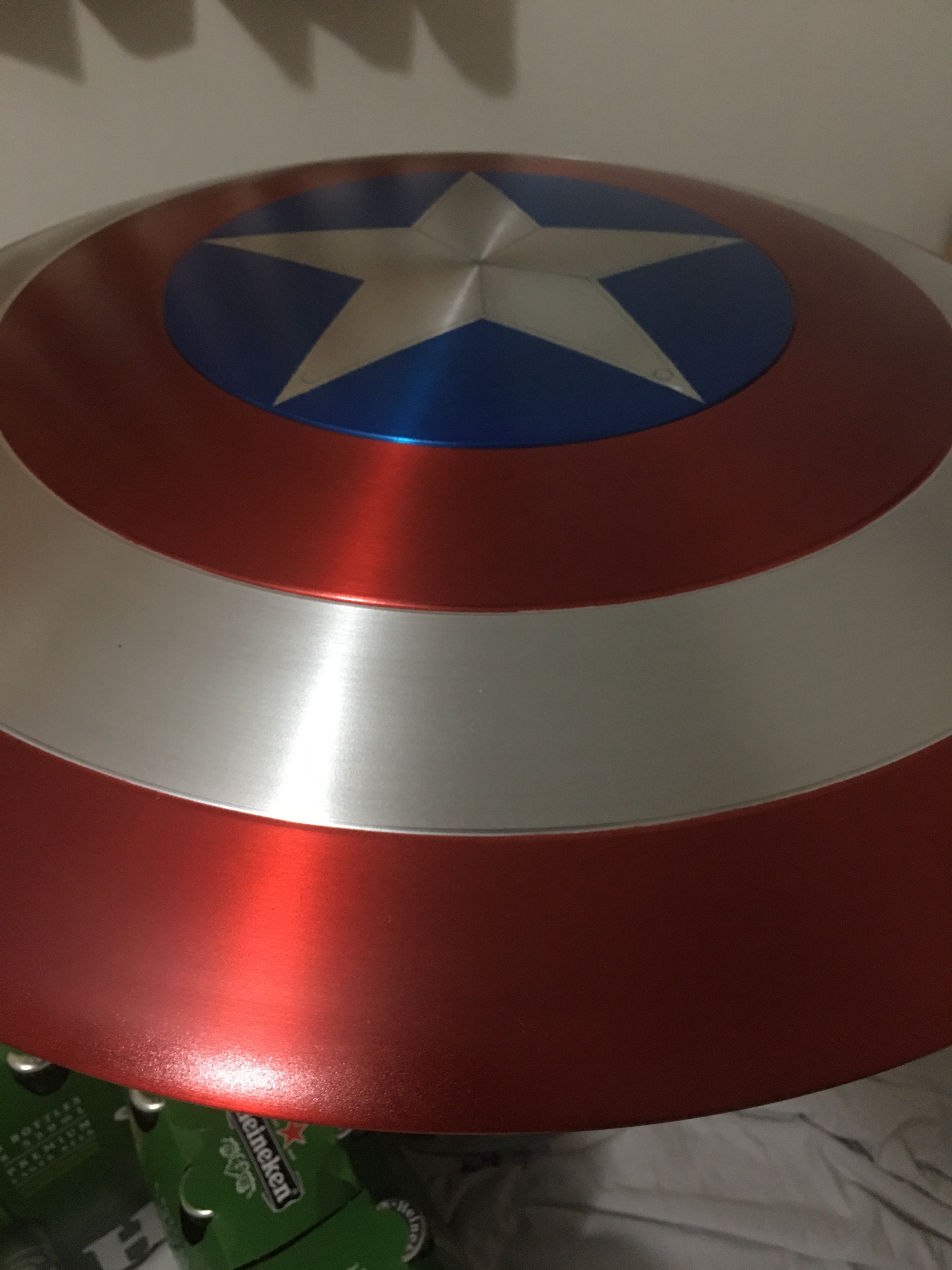

Centre unmasked, im quite happy with it. Gonna paint the shield today as well... wasnt going to but hey.... what the heck.
First coat applied, quite thin just to ckeck there are no frog eyes appearing..... then larup it on....lol.
And paint laruped. Going to assemble it tomorrow and laquer it. I'll see what it looks like gloss but I might put a final satin laquer coat on but I'll test it all on a scrap piece of ally first. Its much more red in real life not the orange it appears here.... I really must buy a better camera.
